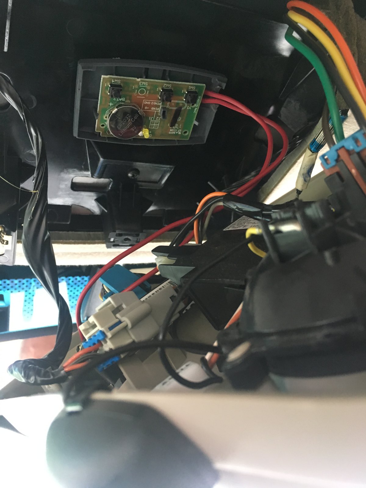

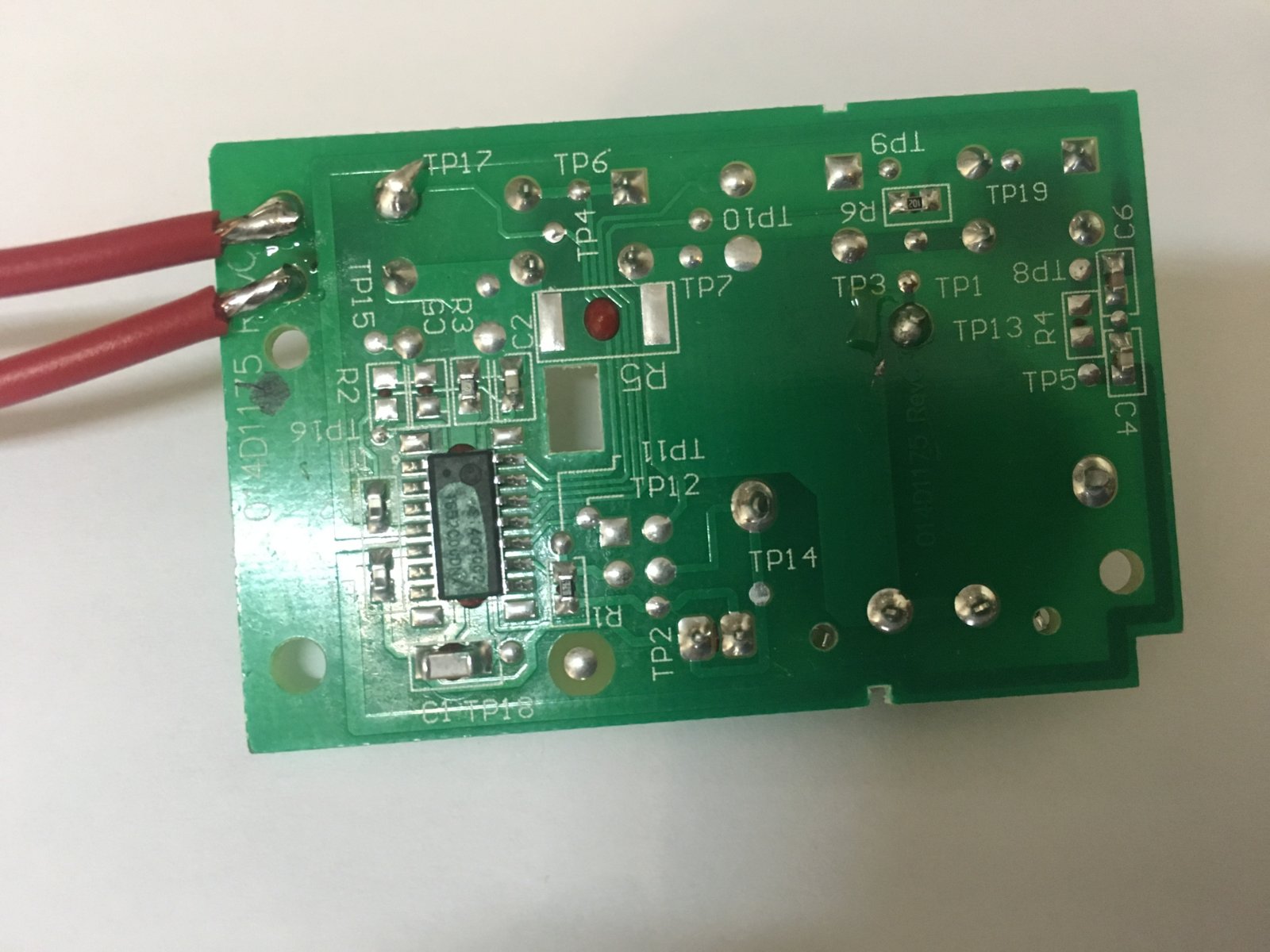

Way too many bad reviews on the Homelink bridge. I think I'll just crack open the opener and wire up a momentary switch that I can hide under the dash or in the console. Who knows, I may figure out a way to tie it into the old Homelink button. With the new opener, I can open my garage from a block away now, I couldn't do that with the Homelink.

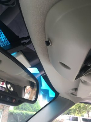

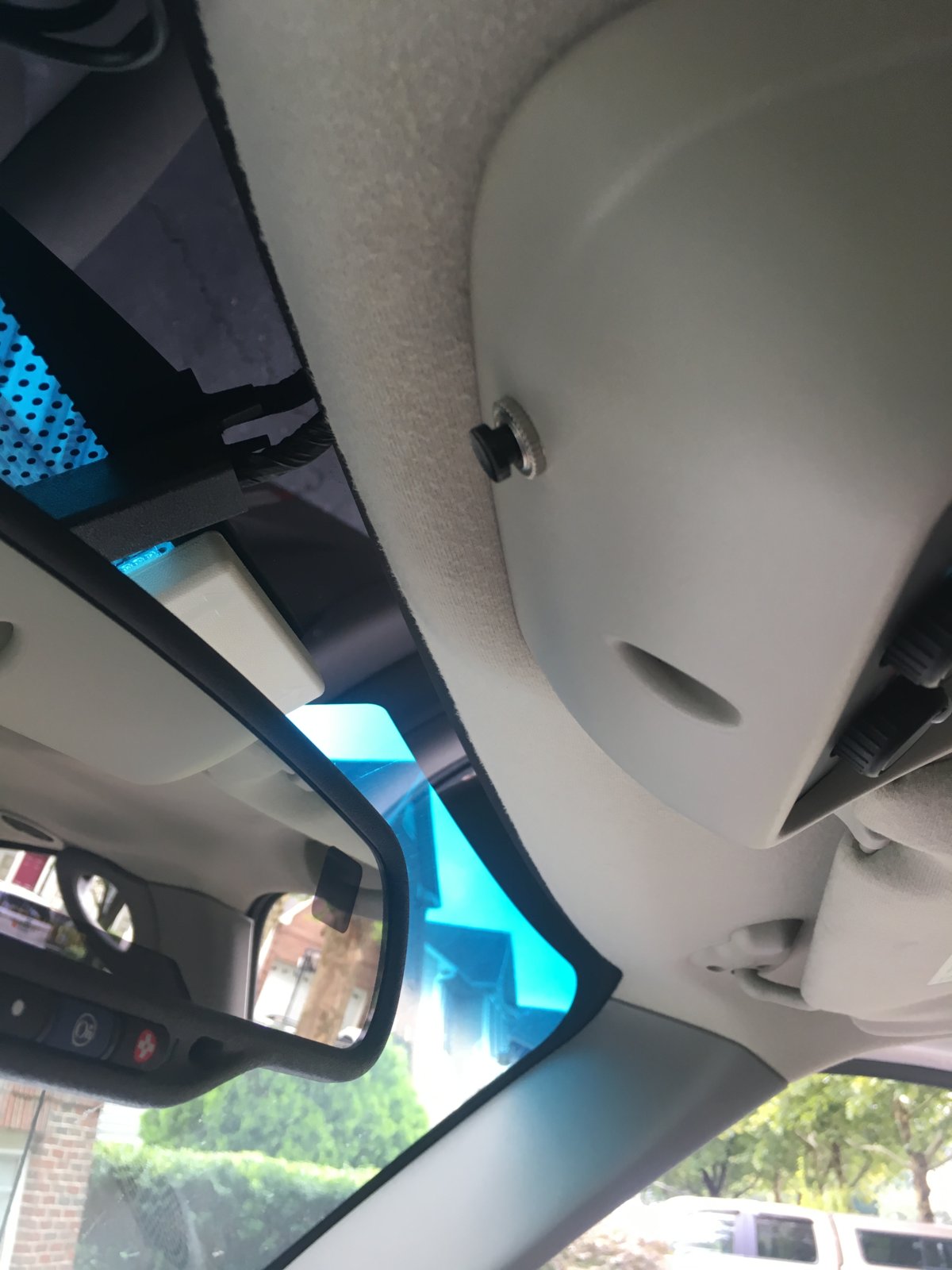

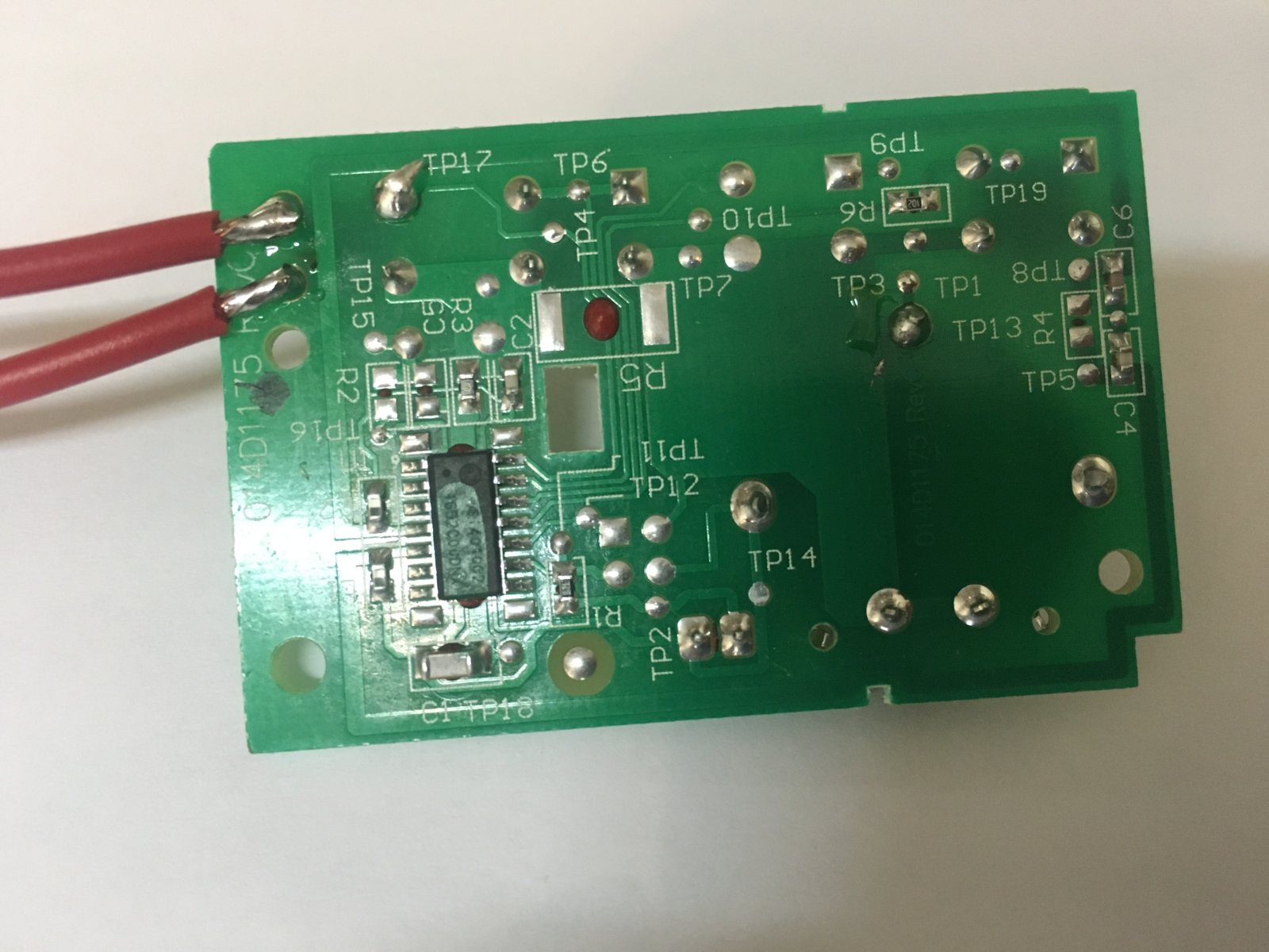

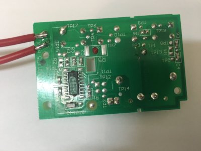

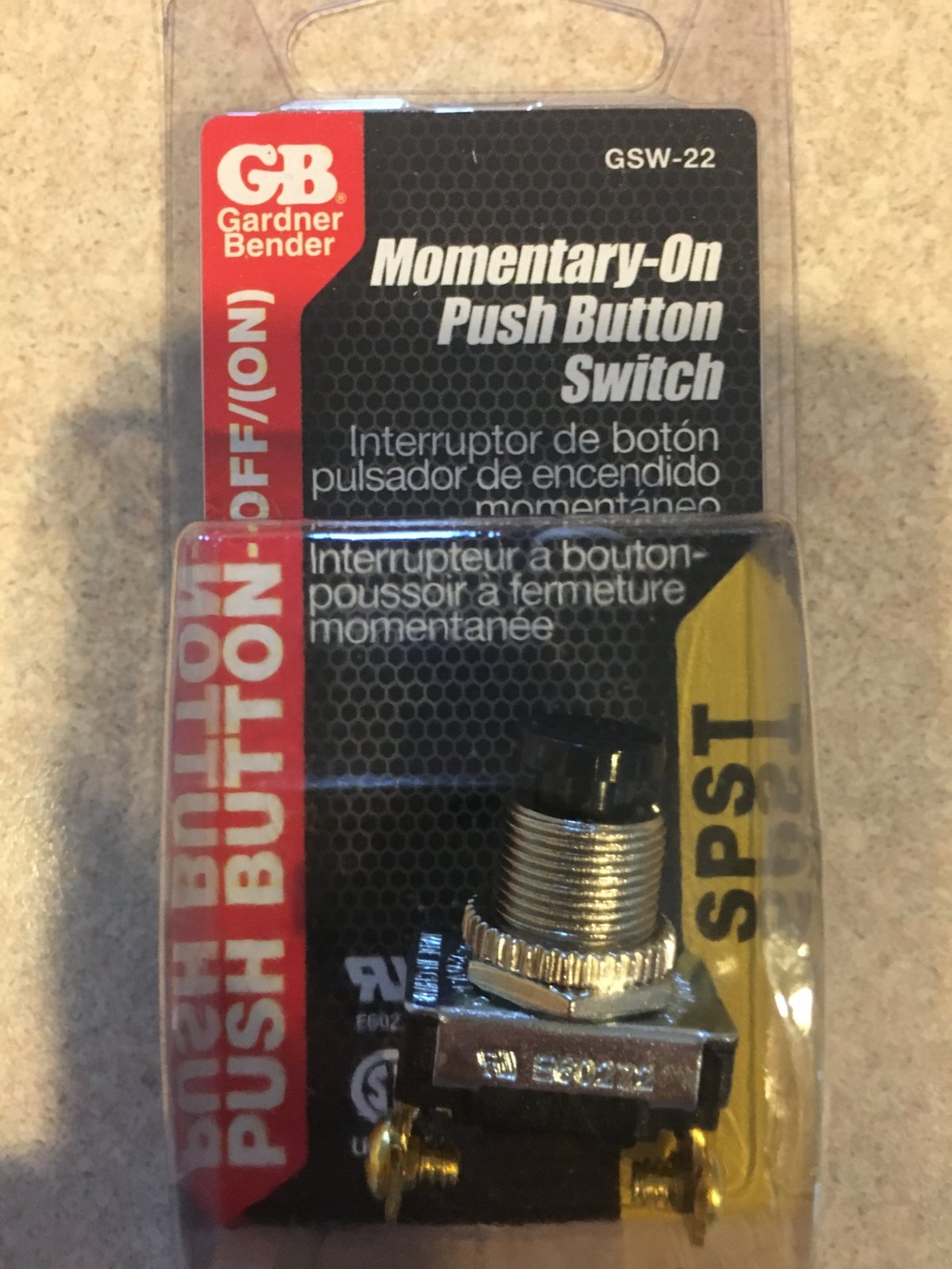

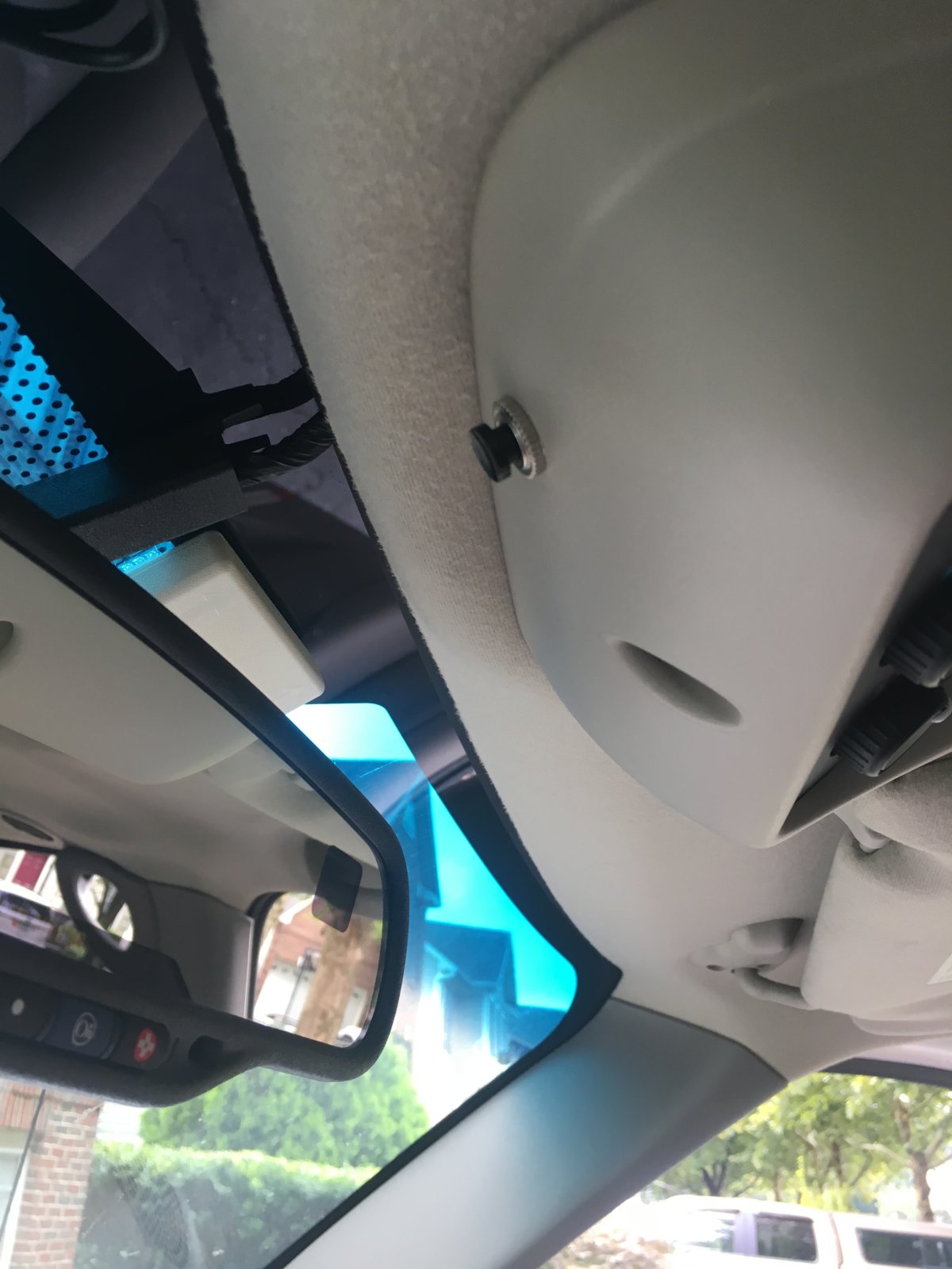

I decided not to spend $40 for the Homelink Bridge. After watching a few YouTube videos, I went to Home Depot and bought a $3.50 momentary switch and wired it to the opener. I hid the switch behind the overhead console. The range is much better than I had with the Homelink system. Anytime I need to change the battery, I just have to pull down the console.
View attachment 180945 View attachment 180946 View attachment 180947 View attachment 180948
I did this yesterday. Even used the same GB switch.. Now, I can open / close the door from probably an 8th mile away..! :party52: View media item 27535
