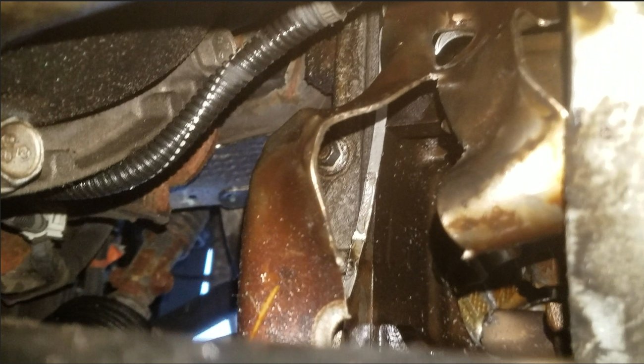

I got this crazy hole in the oil pan (should be an oil pan)..

here is the hole

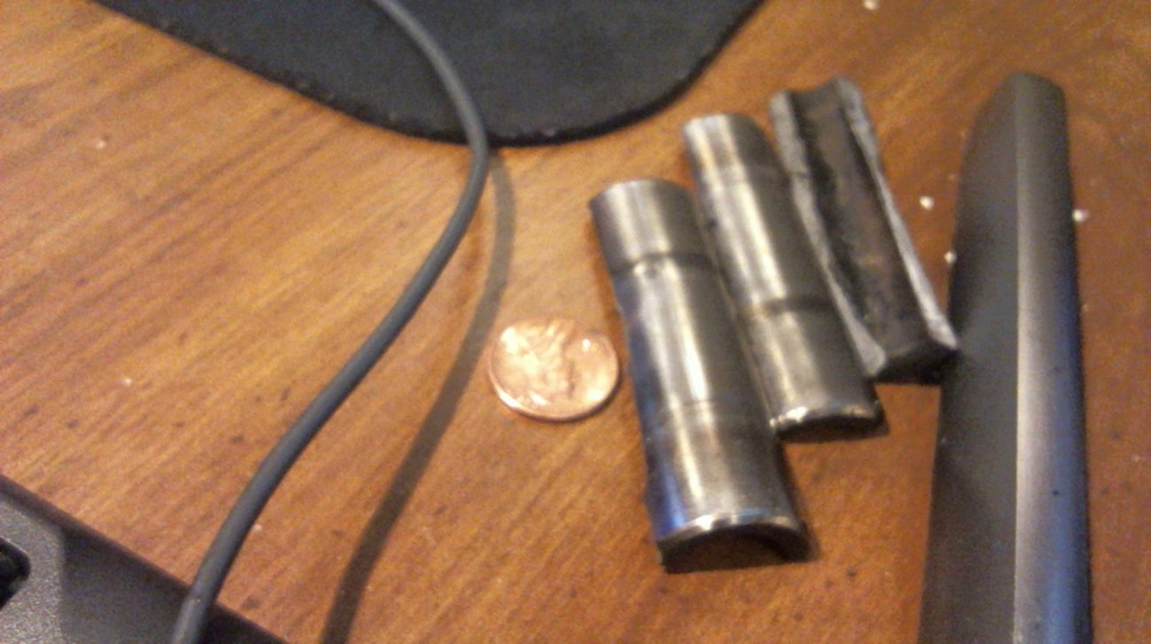

and here is that strange part I found on the ground

agree on that part.
nice cars btw!
curious if someone has an idea where that metal stick is coming from. or (just maybe) it could be just something random due to the truck was sitting God knows where.

Bullet hole from transplant motor and some of the shwag that fell into the bay during the process. Ha!

im in agreement but how would it still drive?
Considering the hole in the oil pan and that there is no oil left, it won’t start for very much longer. The wrist pin holds the piston to the rod. crank is still spinning and moving the 7 other rods and pistons normally, even the broken one to an extent, so it will start, run and drive......until the bearings seize due to lack of Oil.
I definitely wouldn't do that :eek:, but I will pull down the oil pan today and will see what is going on from the bottom. Can be a little bit challenging due to the damage but will see.
I have a feeling that whoever had this car (according to the crams, fries, chicken nuggets and etc) was running on low oil and it cause that damage. So, if it is, I would need to change all the pistons, wrists and etc. If I understand it right, if I would fix just one, others could pop any time. Nobody knows what damage was done to that engine generally.

If the rest of tge truck is good, body and drivetrain... get a junkyard motor and toss it in. Considering the wrist pin broken, at the minimum that cylinder is toast. Id start looking for a motor. Imo

The piston has come apart as had the wrist pin and the rod is banging against the cylinder wall. I don't think a hone would fix that! You're best bet is to get the engine out onto a stand and take it apart for a detailed inspection. I reckon though that it will cost less to replace it than to repair it but you won't know for sure until you open it up.
