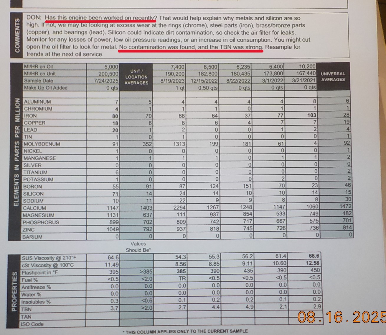

Waiting on the used oil analysis report to arrive.
Here's the latest UOA report, about 2 qts VPB "Restore" mixed w/4 qts M1.
Blackstone nailed it :)
Yes, I had the intake, valley cover, valve covers, timing cover, and oil pan off 1000 miles into this oci.
Power/mpg are normal, 15+ mpg locally and 18+ hwy.
Oil consumption is 1/4 qt/5000 miles
1oz in the catch can/5k miles
Crud/gunk in the oil filter and in the bottom of the pan again since running a mix of VPB "Restore" starting 2 OCIs ago, Sept 2023 and10k miles.
A little concerning to me are these slightly high metals:
Chromium this oci = 4, last time 2
FE this oci = 80, last time = 80
PB this oci = 20, last time = 14
Cu this oci = 18, last time = 14, although BS shows universal avg for the engine to be 19?
Sept 2023, two oil changes ago, I started running 1 qt of VPB "Restore" with 5 qts M1. I also removed the oil cooler, engine oil bypass oil filter setup, and the extra 4 qt oil sump, all of which I had installed in 2021, and went back to stock. I also stopped running a larger full flow oil filter with a higher bypass psi (22) rating, and started running the shorter oil filter # the that parts manuals call for with its lower bypass psi (15).
I underlined in RED in the comments area some important points.
I changed the oil to 3 qts VPB "restore" and 3 qts M1 and went back to the larger oil filter w/22 psi bypass rating.

The chromium and iron (fe) are definitely interesting. Off the top of my head, the chromium.... Do you think that could be from chromoly rings? Valve stems? Needle bearings in the trunions if you still have the OEM ones? A piston pin maybe?
