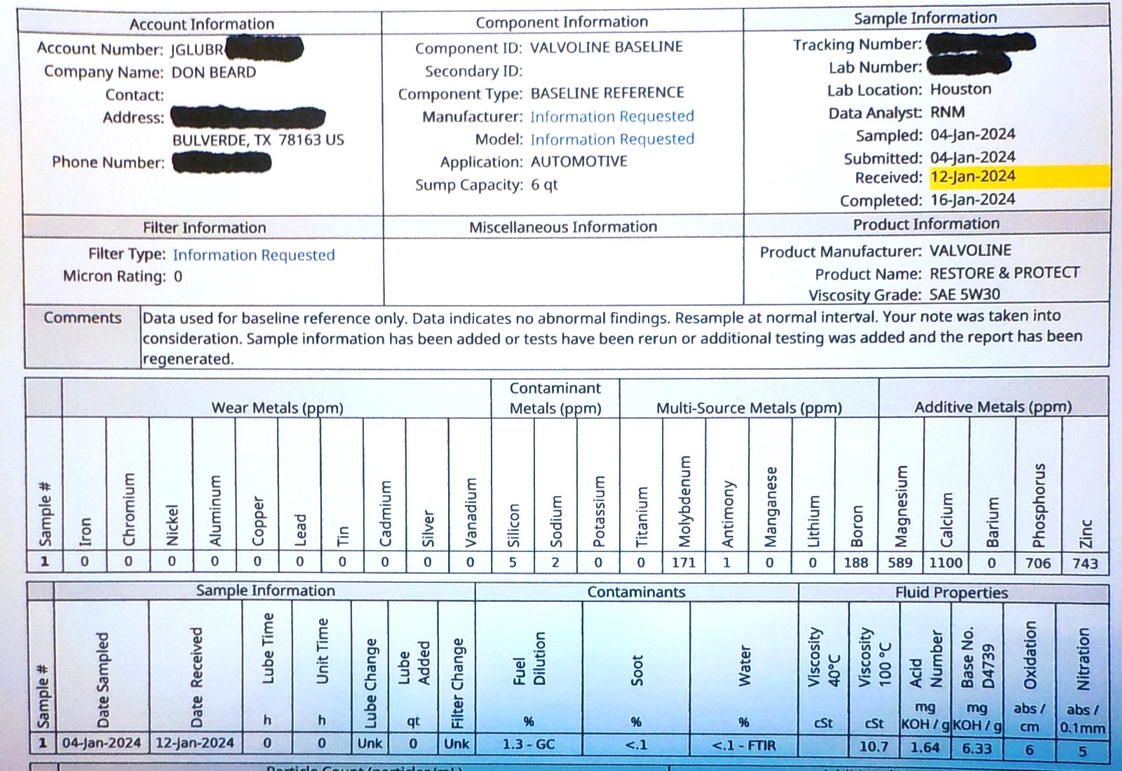

I wouldn't run VRP longer that about 3k miles in our not so good mpg TYE.
VRP doesn't have much staying power (group 4 oils).

Here's the virgin unused report for VRP. Starts with a low base# that depletes rapidly, and oxidation indicates no group4 base oil (ester, etc).
My other vehicle is easy on oil. A 5k mile oci is all VRP can go in it.
