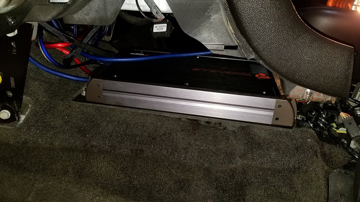

I bought a cheap ass Rockville 5 channel amp that I heard good things about. It that has high level inputs and auto signal sensing so the remote turn-on doesn't have to be connected. It fit perfectly where the old subwoofer was. I grounded it to the front bolt that the subwoofer enclosure was mounted to. Just used a wire wheel and drill to get the paint off and it works perfectly. I ran my power close to where you did. I'm just waiting on the DSP now. I'll post some pics later this evening.

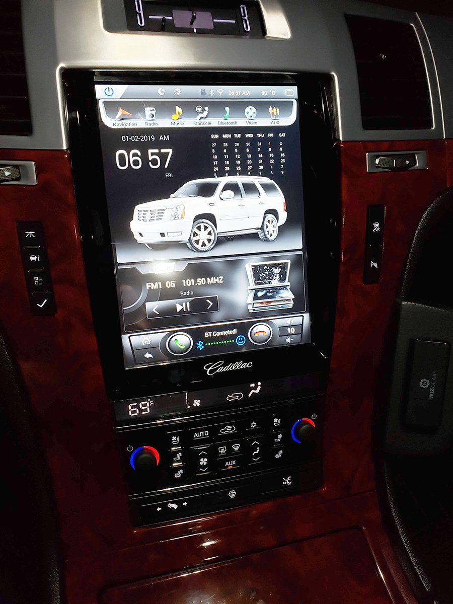

Ok, so after having to completely customize the "Tesla Style" head unit's mounting brackets that I got from AliExpress, I finally got everything else installed. Connecting the 5 channel amp and the Android head unit to the Bose system was kind of a pain in the ass to be honest. And the bass knob that came amp wasn't really built for custom installs, so I did my best. I had to buy a different knob to make it work with my set up and it's a littler bigger than I'd like, but oh well. I'll have more pics in a build thread for the Escalade when I get some time, but here's a few for now.

That is a very interesting setup. I looked at the install instructions for that thing and interesting how it uses parts of the factory radio.

Yeah, it's interesting AF and I still don't quite understand why exactly it keeps part of the factory radio. I had to completely make my own brackets for it to fit too. The seller was of no help and acted like that was totally normal. I've heard that is pretty much how it goes with sellers on these units.
I grounded my amp to the front stud that the old subwoofer was mounted with. Just completely sanded the paint off and it seems to work great.

Ok, I was going to figure out how I could ground to one of those studs and still use it to mount the amplifier. It looked like you didn’t have the room so that’s why I asked.

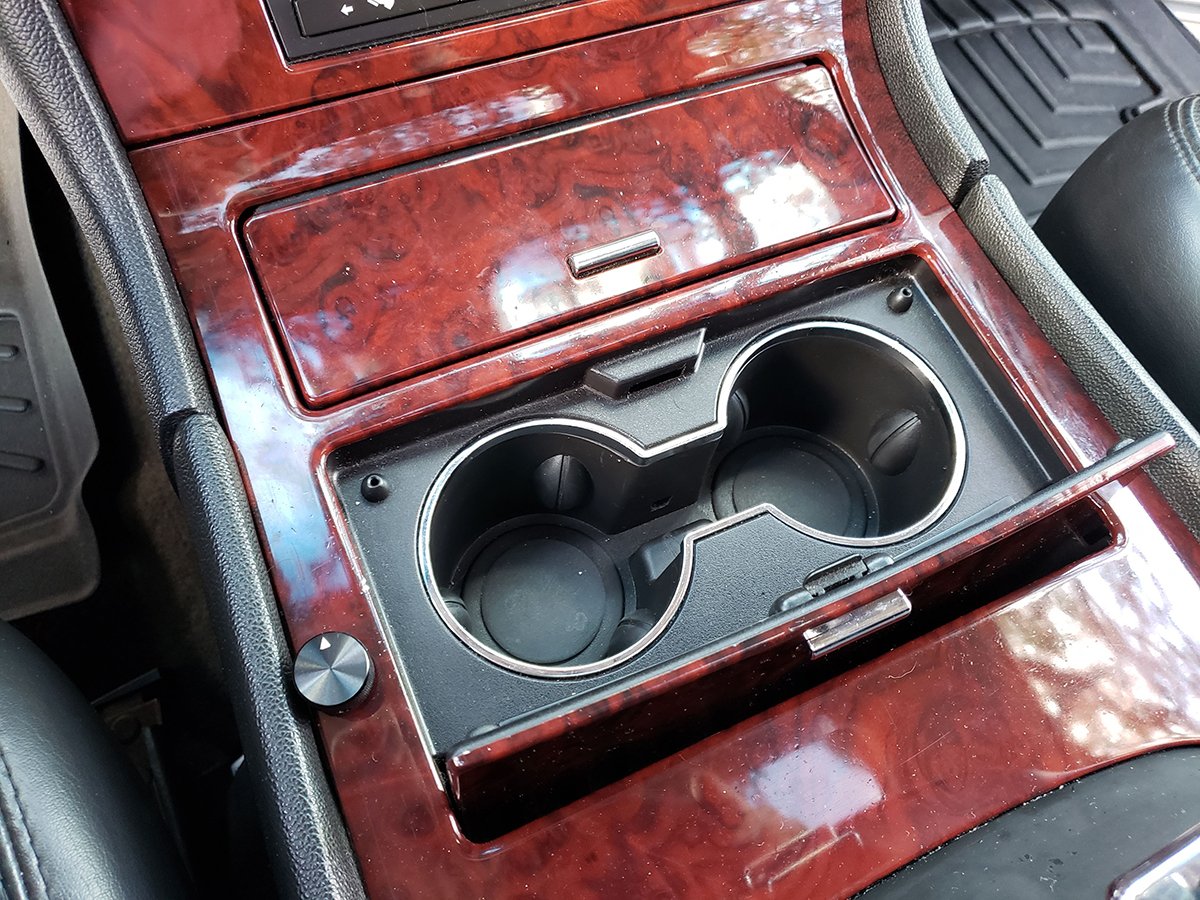

Oh sorry, I guess I should have said rear stud! I used those front 2 to mount the amp. I meant the single stud that was just below the cup holders.
This is exactly how mine is setup.
This unit looks sick! It would be great to have a unit that can run 2 sources at once like Navigation on top part where truck shows and a video feed of some sort at bottom. Wish I had the customizable knowledge to do this.
