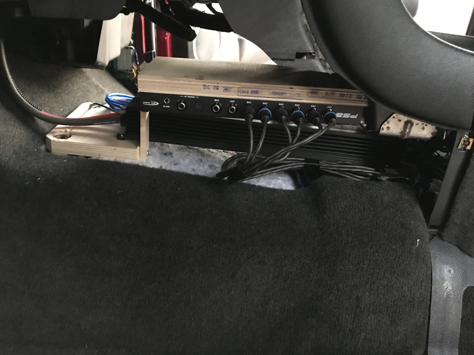

The bracket Def makes the console sturdy. I took mine out and it was Hella wobbly
Meccanoble
Oct 3, 2016
1,166
355
Georgia
Interesting...so the bose lux trucks dont have brackets? What do those 3 screws you have connect to? I was really hoping to use whatever you used but I'm heavy armed lol and dont know if I'll be happy with no bracket....
91RS
Nov 15, 2009
2,851
2,299
GA
Without having both consoles side-by-side, I couldn't say. I wouldn't say the Escalade console is wobbly, I think its mainly the two part console lid that feels flimsy. I would have to imagine that all the Chevrolet/GMC consoles have the metal bracket regardless of the type of amplifier.

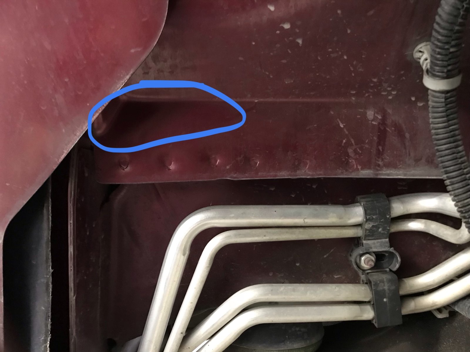

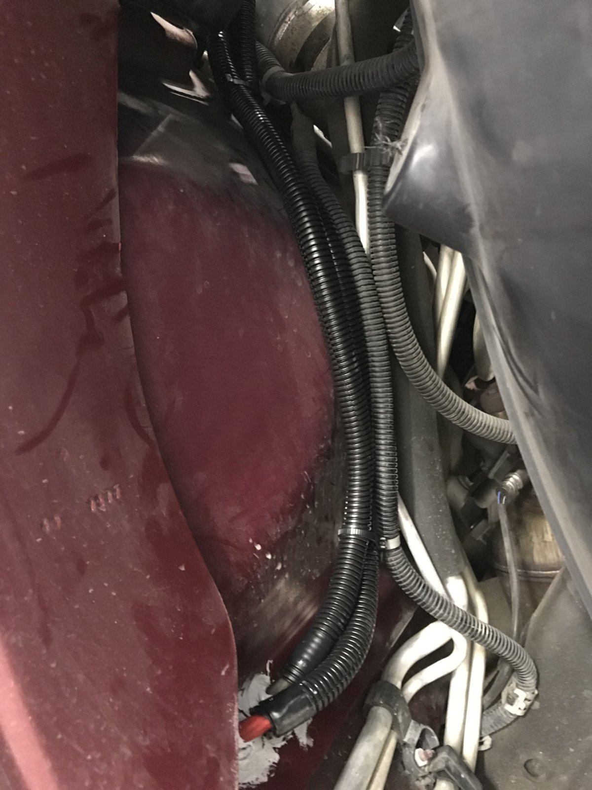

Is this the spot you're talking about for running the power wires through on the passenger side?
5F184ACD-3F8F-4187-9620-4204D615859E.jpeg 467876D9-352A-4C7B-A7DD-10C992B3F3DB.jpeg
Meccanoble
Oct 3, 2016
1,166
355
Georgia
I went slightly up and more towards the middle of the car. I definitely drilled in the textured area, not the smooth part. I would say 4 inches to the left and 4 inches up from the circled area on the left.
91RS
Nov 15, 2009
2,851
2,299
GA
I figured drilling through the sound deadener might make the grommet sit funny or something. I decided to go ahead and order new cables rather than use what I already had and I also decided to go ahead and run the ground all the way to the battery rather than grounding to the chassis so maybe I'll get the wires run this weekend and then I can get going on the rest.

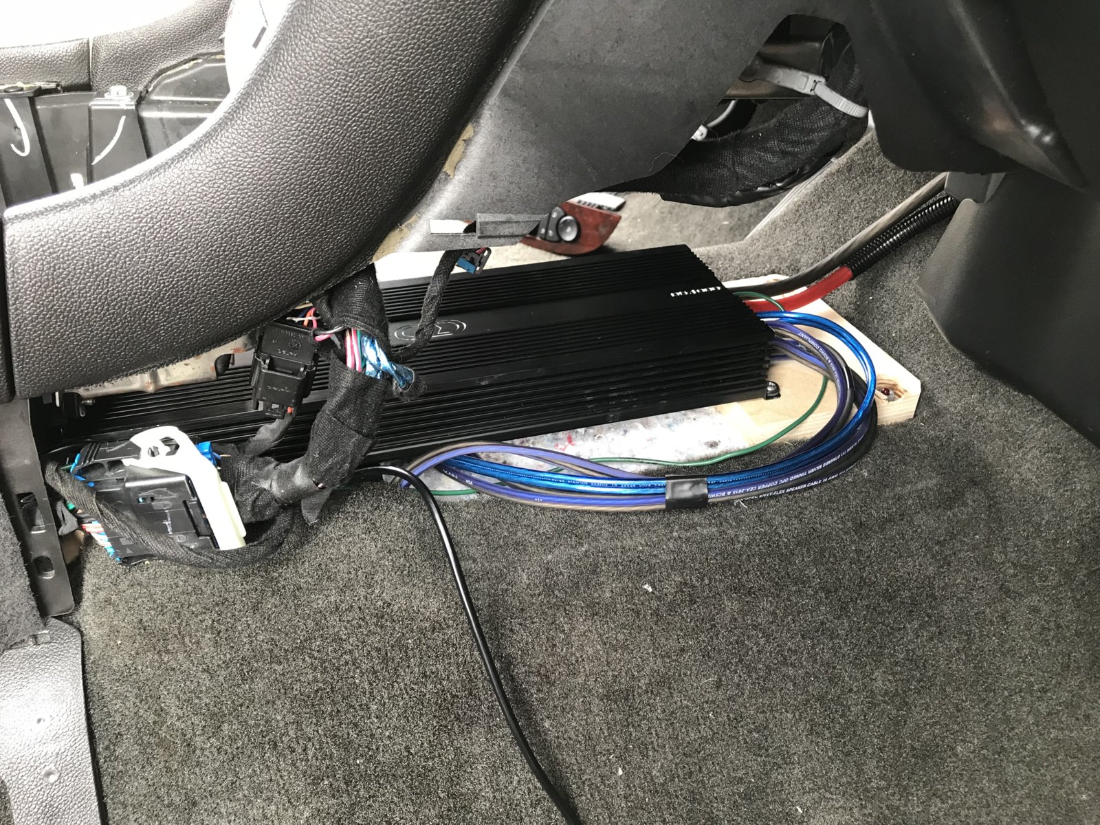

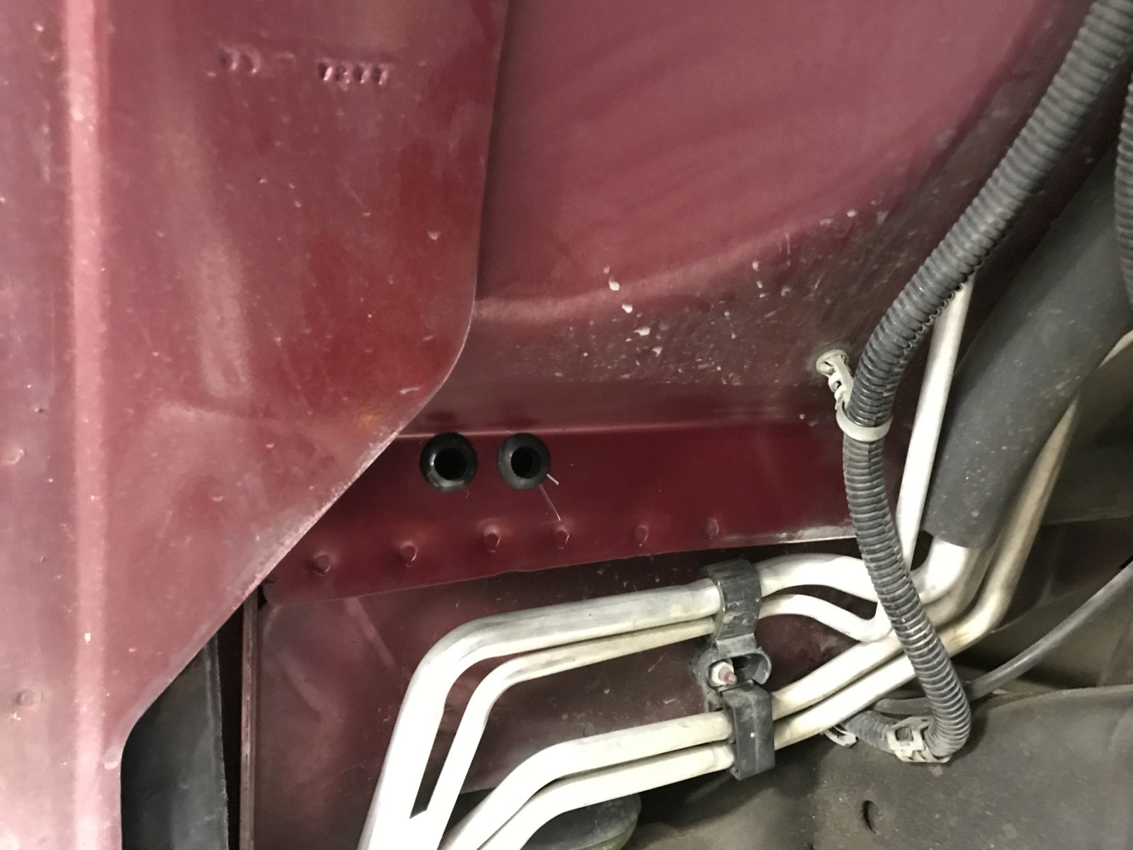

I got my holes drilled yesterday and didn't do my usual thing of mucking things up! It went well and other than going a bit crazy with the RTV to make sure there will be no water leaks, it looks nice a professional.
I also built a new factory ground cable (from the battery to engine) and replaced the ground strap (from the engine to the body) with 1/0 welding cable. I was going to replace the cable to the generator also but my early truck has the mega fuse on the firewall so there's no point unless I also replace the short cable from the other side of the mega fuse to the battery. A future plan will be buying a new factory positive cable from the newer years with the mega fuse attached straight to the terminal and then upgrade the generator cable. It may not even be necessary, we'll just see if there's any issues with dimming lights or anything like that.
Hopefully today and tomorrow I can get the majority of the rest of the system done. I hope I have enough speaker wire left over from my other car or I'll have to order some more of that.
