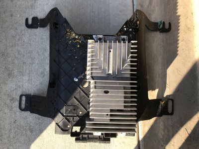

Here's my stock amp (yes, the console was disgusting). It is just over 12" long, 6 1/2" wide, and 2 5/8" tall. The DD D5.1000 is 15" long but I think it should work. Now I've either got to wait until someone decides to sell a used one since DD has discontinued them or change the amps in my car (ugh) to use the D5.1000 in the Escalade.

That definitely looks longer than mine. Any pictures of the bracket that sits on top of the amp? Same bracket that bolts to the center console/arm rest area?

What do you mean by bracket? Maybe the Tahoe/Yukon console is more different than I remember. The compartment for the console is held onto the base with four screws. There isn't much space between the top of the amp and the bottom of the compartment. So far I've had no luck finding another D5.1000 and so far I haven't found another 5 channel that is as powerful on the sub channel and as small. I really don't anticipate needing that much power but it'll cost me more money and time to buy a different subwoofer...
Right, when you unbolt those 4 screws, there is a silver metal bracket underneath the console but on top of the amp. You would have to remove that bracket just to get that view of the amp you have. The bracket is what keeps the arm rest/compartment section from wiggling so much. If you have to unscrew those 4 screws in the storage compartment just to lift the center console, you most likely have the bracket....unless your truck with the longer amp uses something different to bolt the center console down. Hope this makes sense. Its possible you are unbolting this bracket from the sides and it goes up with the center console but if you had to unbolt the 4 screws inside the storage section, you should have seperated the center console from the bracket.
If a chain of events happen the way I plan in the near future, I'll be able to take more pictures. The bracket I have is super shallow at the bottom where the amp is and literally wouldnt let anything more than a micro amp fit under the bracket if my memory is still good. Some people get rid of bracket just to fit an amp down there but I'm hoping the trucks with the LUX amp have a bigger bracket to handle the spacing for their larger amps....or maybe part of bracket can be cut and still be strong enough to stabilize center console....

The Escalade console doesn't have any metal bracket over the amplifier.

When you open your arm rest and take the storage compartment stuff out, there should be 4 screws (or holes?). I think those were the same 4 we have been talking about in this thread. Are they screwed down to anything? On my LT Tahoe with only Bose (not LUX), they screw down to a metal bracket which is bolted into frame. Those 4 screws, do they connect to anything?

I only have three screws in mine and it's all plastic underneath. It would probably be more sturdy if it had some metal...
