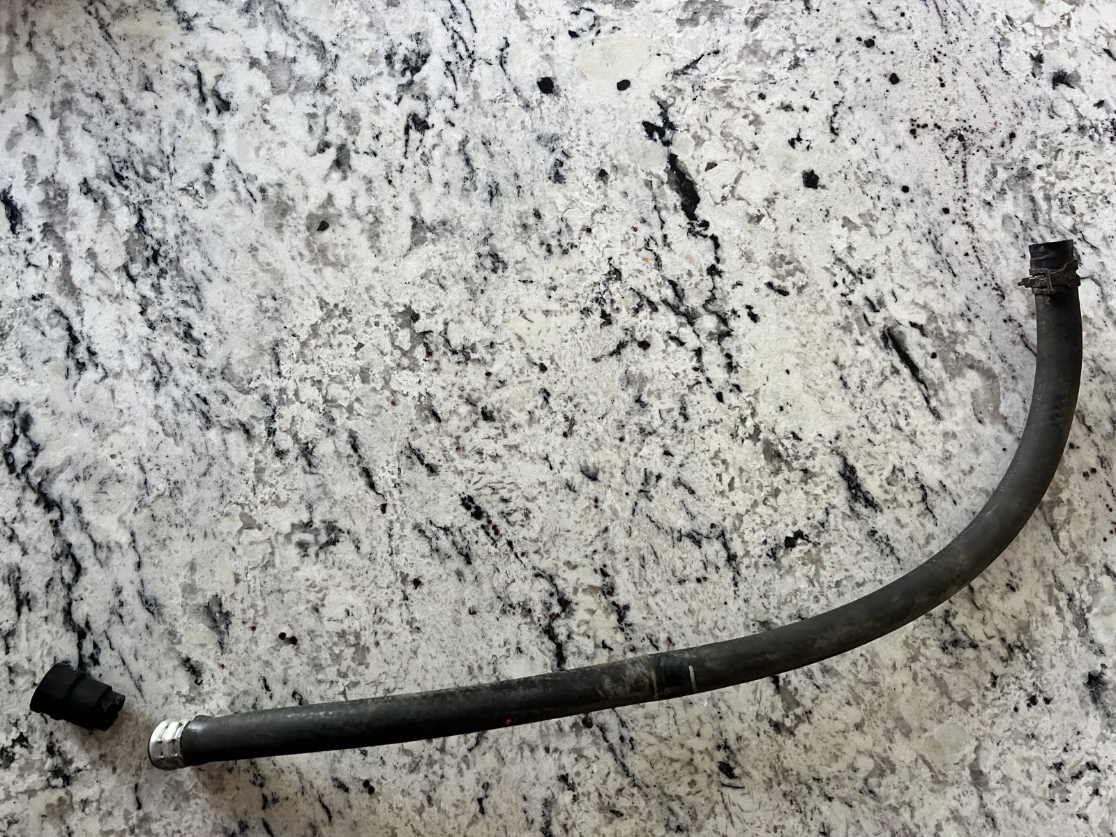

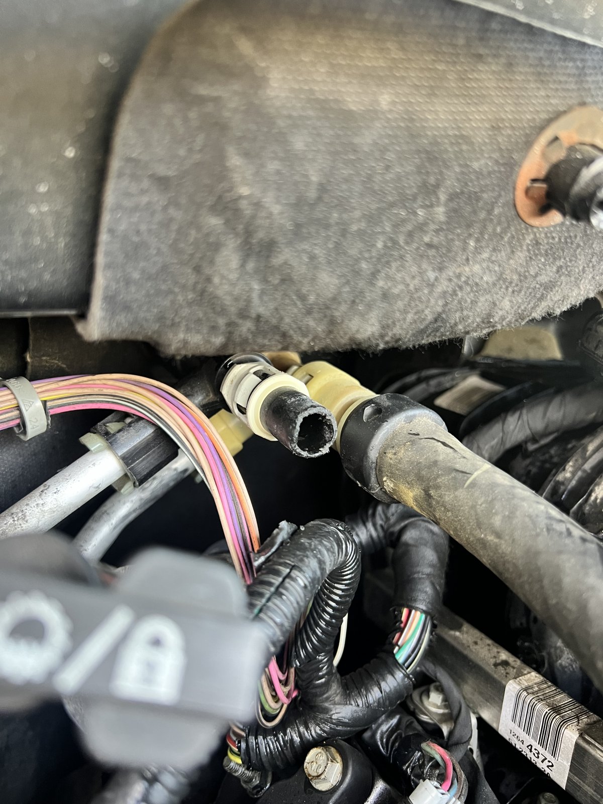

So I was laying on top of my engine fixing the dreaded exhaust manifold bolt issues and my elbow slipped only to get caught by a heater hose and I broke the connector. Pretty upset but it happens
What’s the best fix for this? Is it to buy a new coolant hose or is there something else?

Pinch the two tabs on the broken off piece, push towards the firewall and then pull toward you and it should come off. Take it to your local auto parts store and match it to the one they're going to sell you. It will have a hose nipple on it for the heater hose to slide on, and use a hose clamp.
Judging from the looks of the other heater hose, I'm thinking you need a new set of heater hoses. One of them goes down to a Y fitting, where one part of the y connects to the water pump and the other part has a hose that goes up to the coolant reservoir. You'll get lots of feedback about reworking that y-pipe with an aftermarket metal one. I'm assuming you just need to get it going for now? If so, most auto parts stores have that heater hose with the y.

Note: the heater hose that does not have the y usually comes with another quick connect fitting. Just pinch those two tabs, push towards the firewall and then pull outward and it should come off. If it's original it will have a spring clamp holding it to the fitting down by the water pump.

Judging from the picture, it's well past its service life. Those cracks in it are definitely not a good sign. If your radiator hoses look similar, might as well do them at the same time.

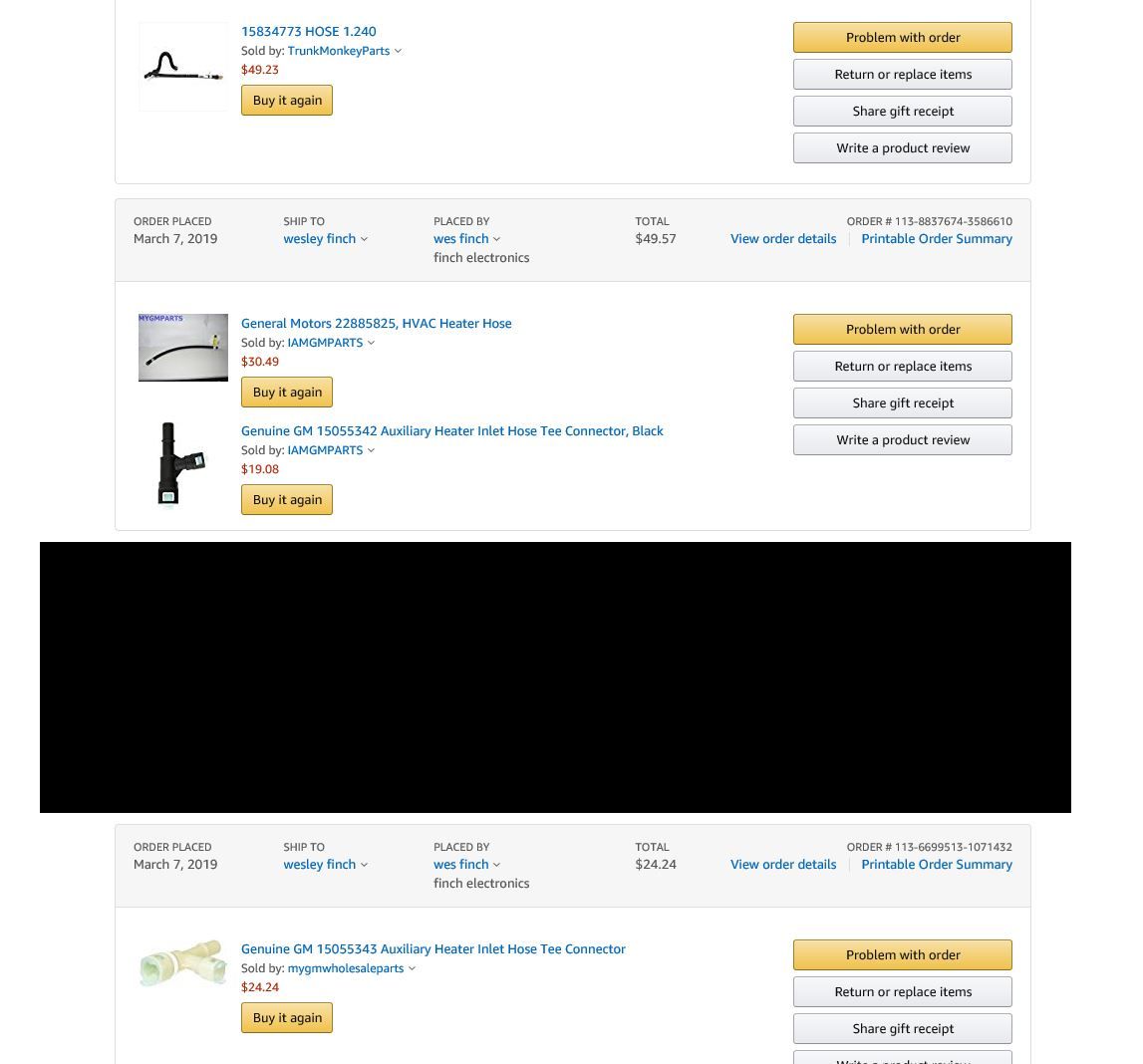

THESE ARE THE CORRECT PARTS THAT YOU NEED, 1 OF EACH. BEST TO USE OEM FOR THESE
30,698
48,334
Thank you. I already ordered everything and am using OEM hose but went with Dorman connector, maybe not the best idea but it was half the price as the OEM is now $30+
I found each of the T's went up $5 on amazon, since I last bought them in 2019 the black one now $24 and the white one now $29

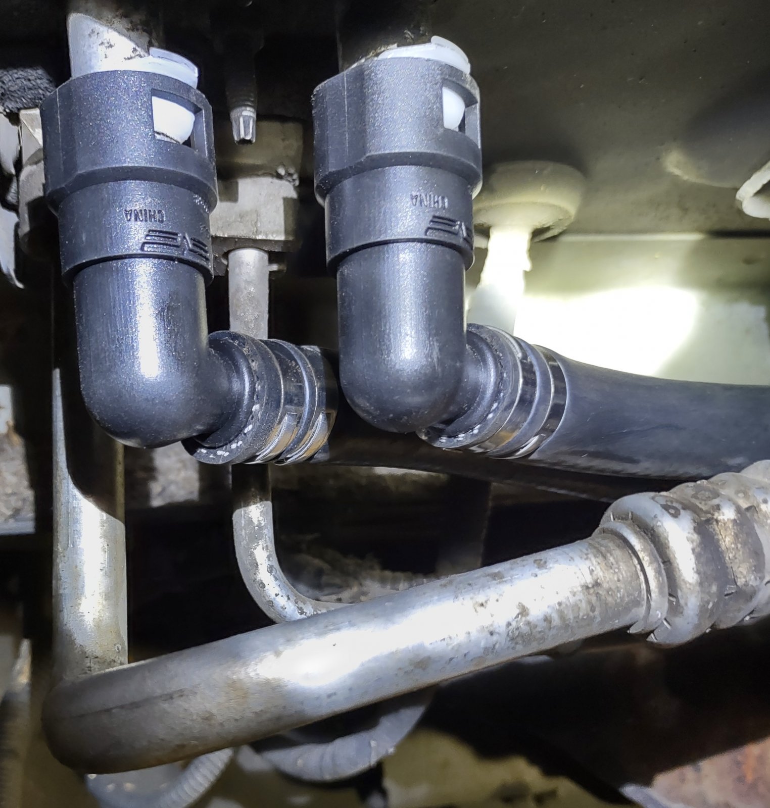

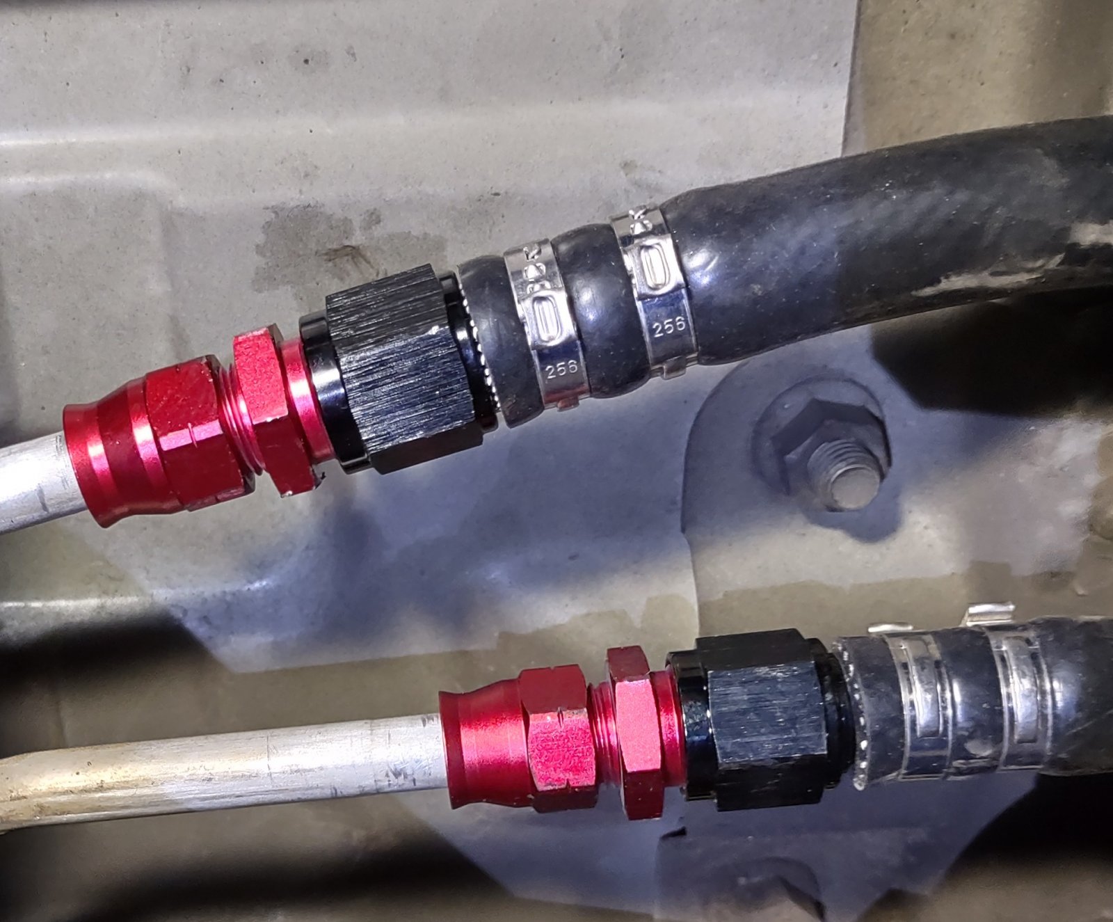

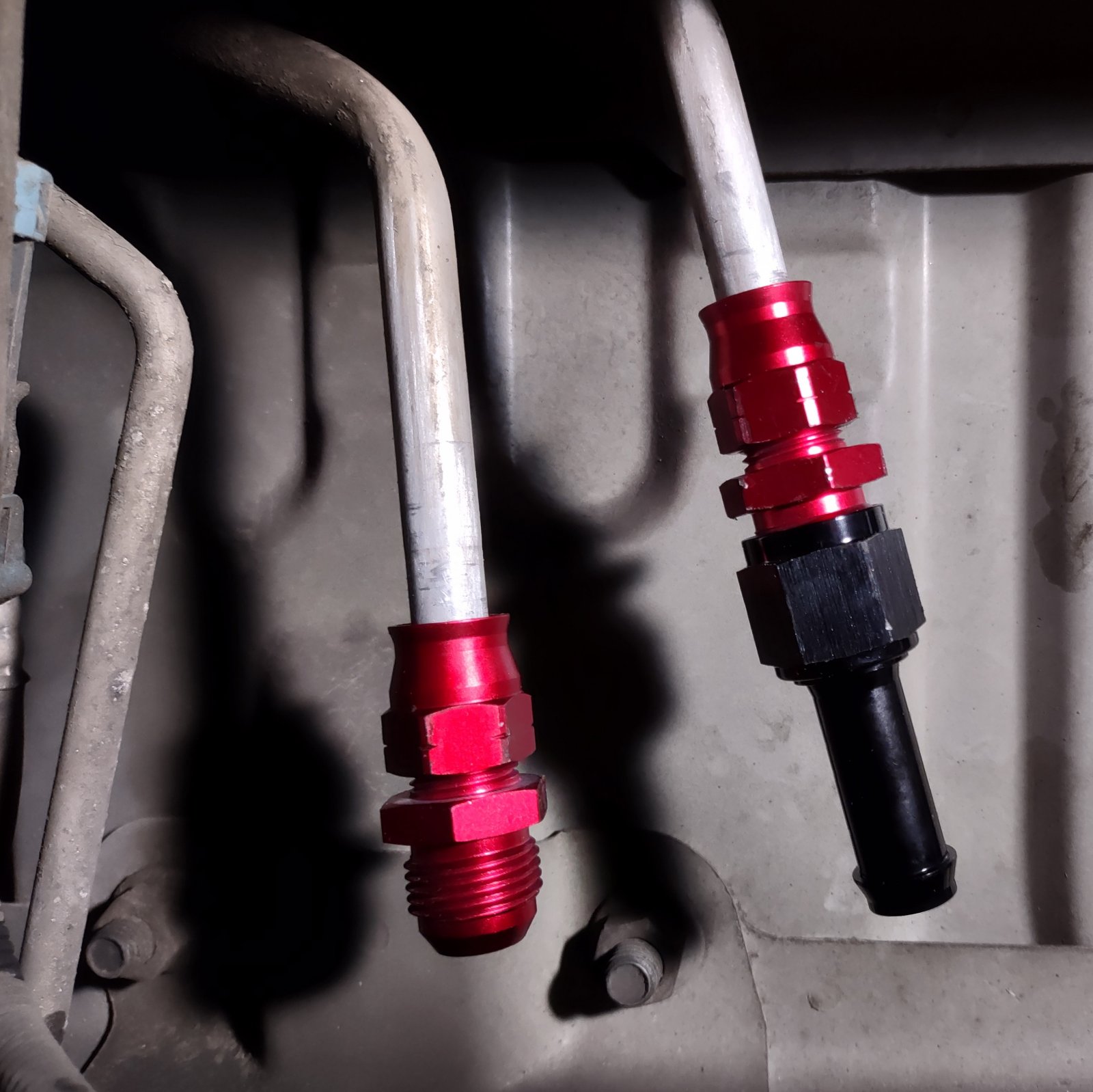

And by all hoses, let's not forget the two that nobody thinks about till they're on the side of the road. The two hoses they're exposed to road spray and exhaust heat constantly. The ones behind the right rear tire that go up to the rear heater core. While they're only available as a complete line set with the metal tubing to the engine bay, they're easily modified from above the spare tire with a half inch compression fitting to a half inch hose barb.... And Dorman sells the 90° 3/4-in quick disconnect to half inch hose barb. That way you can just use any heater hose and makes for a easy repair.
I'm amazed how many people don't even know those hoses are back there till they see coolant dripping behind that tirethe Usually on the side of the road in the middle of a long road trip!
