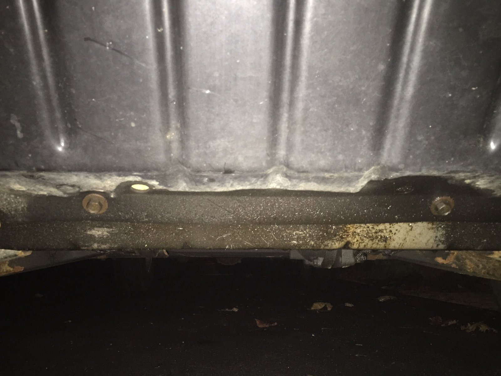

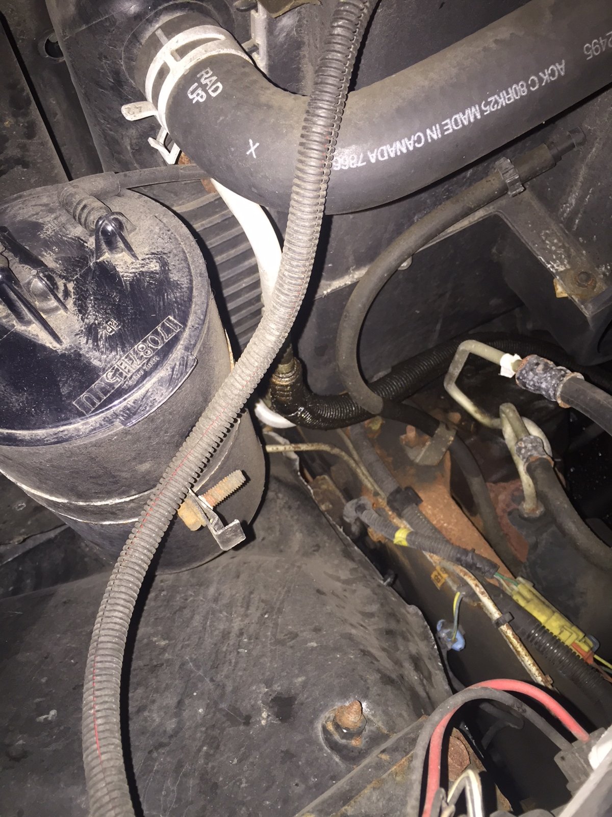

Just bought a 1995 Tahoe and noticed a few drops of oil on the driveway, maybe 2-3 per day. Got under the truck and noticed a "collection" of oil on the frame, right underneath the belt pulleys. The leak appears to be from one or more of the lines on the driver's side, see pictures below. Whatever is leaking looks to be wrapped in that threaded black plastic covering. I am not sure if these would be called oil cooler lines, radiator lines, transmission cooler lines, etc. I have heard those terms followed by "leak" many times when discussing this generation of truck (I've owned 3 previously). Any input would be appreciated. Thanks.

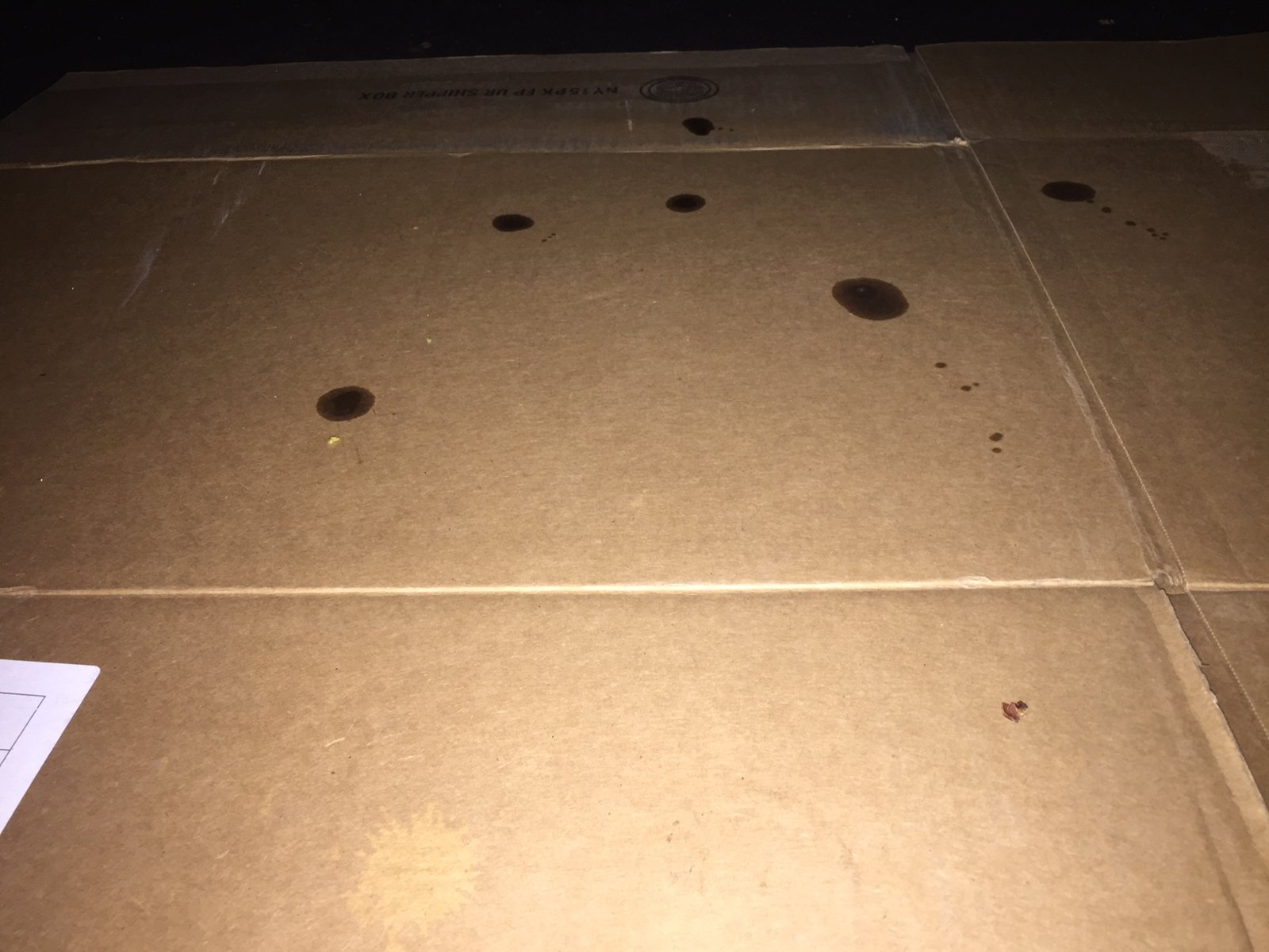

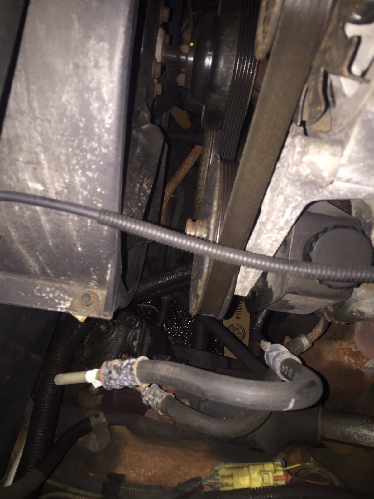

I actually did put some cardboard under it, only a few drops leaking in two days. The spots are dark/black. I'm guessing the next step is to smell them? To me coolant smells like pancake syrup and oil smells like...oil lol. You are right, hard to tell exactly what it is just by looking at it.

Yeah, it could be oil cooler lines (left side of radiator, shown in your last photo) or the adapter at the oil filter. Your lines wouldn't be the first, they often leak where the hose is crimped.

Don’t think it is dripping at the back at all. But, the front main seal possibility does concern me. Is it less likely with a truck that only has 66k miles like this one does? I was thinking of trying some ATP Reseal. We had a rear main seal leak on our 99, tried some of that stuff and it hasn’t leaked in well over a year. If I peak underneath this one though, there looks to be a trail of oil that follows the frame right near the driver’s side tow hook. From there it seems to sit on that piece between the two bolts in my first picture. You can see and touch a few droplets of oil just waiting to fall. Reminds me of rain droplets on a gutter or something like that.

I've had those oil cooler lines leak at the crimped connections and at the radiator. Maybe it was the transmission lines leaking at the radiator... I think I'm on my third set of oil cooler lines in the 13 years that I have had my rig. 1998 2 door.

After doing some careful peering around in the engine bay, I'm almost certain it is coming from these lines only. It looks like I need two of the connectors total, one for each oil cooler line. The other end of each line has the screw type connector and o-ring built into it. $75 bucks worth of parts from Amazon and free 2-day shipping, can't beat that.
