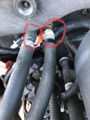

I always have issues getting them apart. No damn room to get in there. I use a flathead screwdriver and/or a long pair of needle nose pliers to break the thin black pieces off holding the white locking tabs. I just replaced both of mine back in July. Use GM parts not the Dorman stuff. You need the 2 tees and there is a connector for the inboard hose. Here is a parts list:
Here is a pic of mine installed. Black is outboard white is inboard. The steel lines coming up pretty much line themselves up where they should be but you can mark them with a marker for orientation in reassembling if you wish.

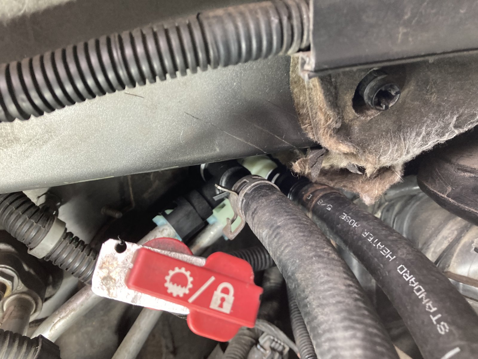

I used a hacksaw blade to cut off the tabs (as stated above). I tried a few different 'tool' made for that purpose, and they failed. Be sure to wear gloves, as that firewall insulation will itch your hands for a few days. Do NOT buy Dorman replacement Tees.

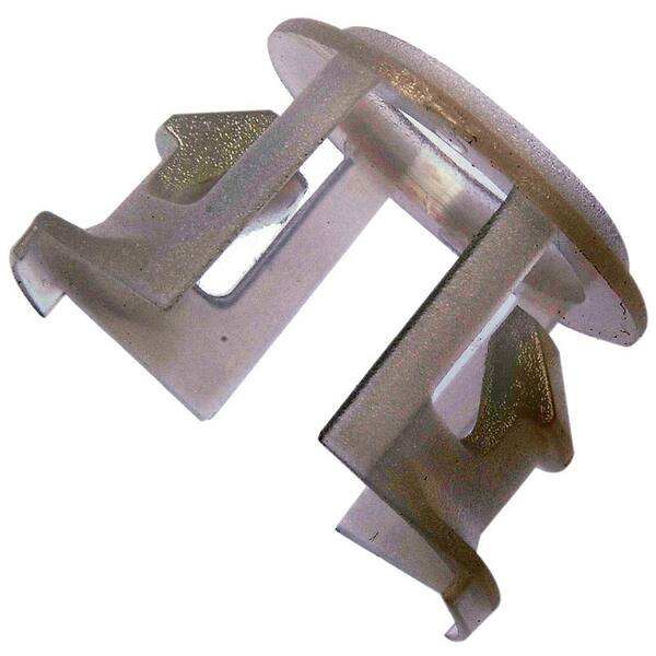

There is no going away from those plastic clips unless you do a full delete and swap over to hoses, clamps and metal tee's.

I appreciate all the advice. But this was not difficult at all. I'm not trying to be rude, but it really wasn't hard. Of course, I do all of my own work to all our daily drivers as well as my muscle cars I've owned. To give an idea, our Tahoe has 173K on it and those lines have never been changed. We've owned it since 20k miles. I think where most people go wrong are how they go about disconnecting the clamps. You have to push in first, then squeeze the tabs, then pull hard and they typically pop right off. Some will break due to age and constant hot/ cold. And I will admit, I have had some like the fuel charcoal canister clips that DID NOT want to come off. But these came off with little to no effort.

As stated above, the new Tees should come with a new clip. Mine did.

Yeah I will. Yeah, neither T came with the clips that bring the hose from the pump up to the T. It had the clips that go onto the core and the steel lines, but not the clips that go inside the hoses that connect at the front of the T's.

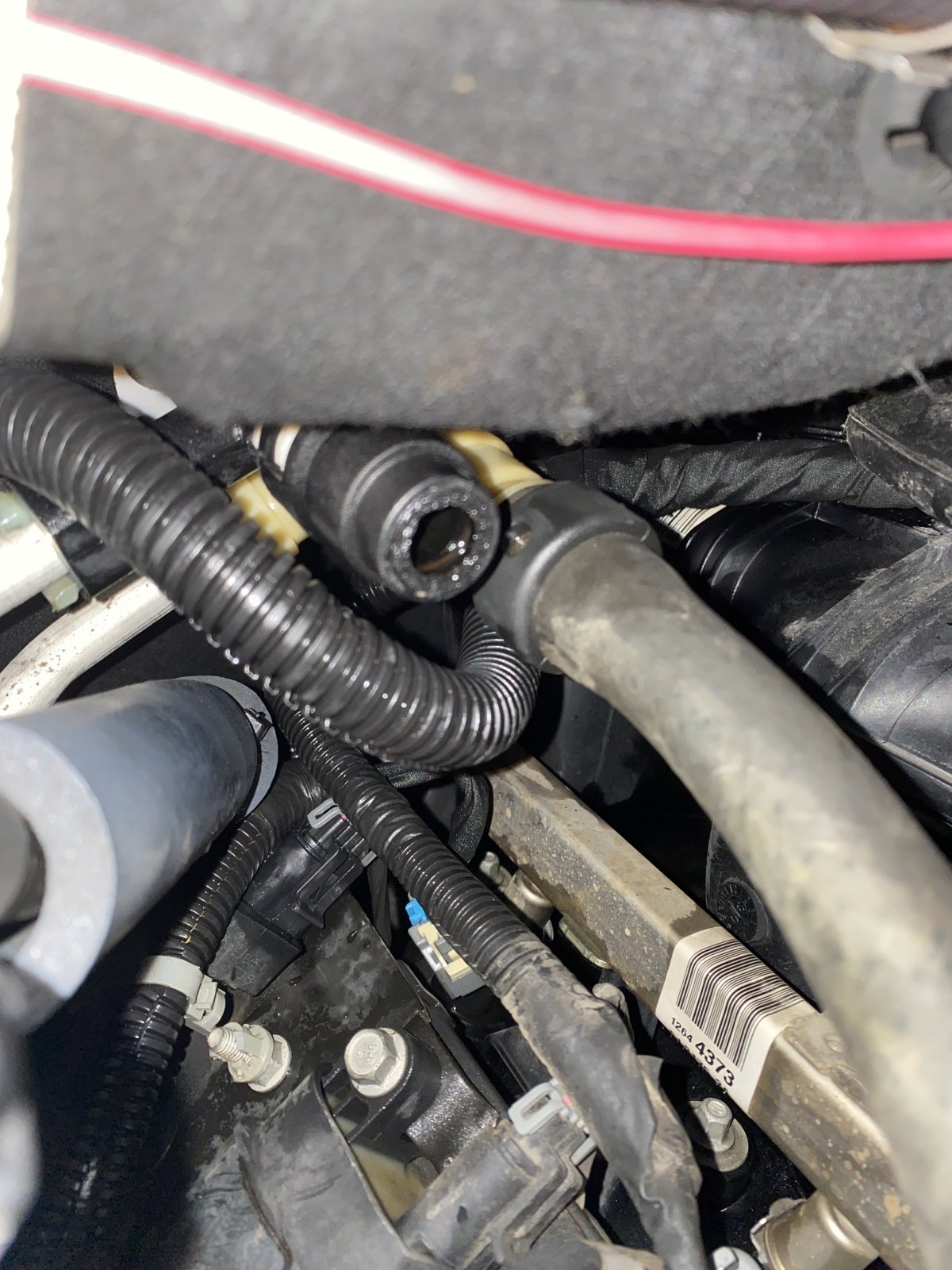

The black one snapped clean off today on my son. Weird thing is it also has a compression fitting on the hose that goes down to the water pump. All suggest the GM one, I see the part #’s here. Gather the white one is around the corner to fail as well. They are a pain in the butt to disconnect. ???The new fittings they come with the plastic tabs or do I need to order them as well??? This truck needs to be back up n running like 4 minutes ago.
