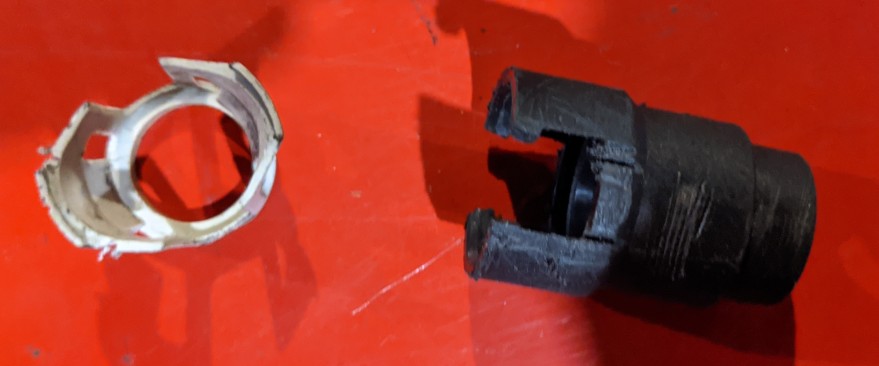

I was unable to post this photo of the connector that I had to cut out in my previous post as an edit, so I'm posting it here in a new post.

The easiest way to do deal with that is to snap those small flat tabs off of each side and then you can either pull the connectors off or or keep snapping some more of the plastic part off until you can get them off, I would replace both hoses and "T"'s with new oem ones seeing those lasted over 10 years. the problem is common due to age and from heat/cold.

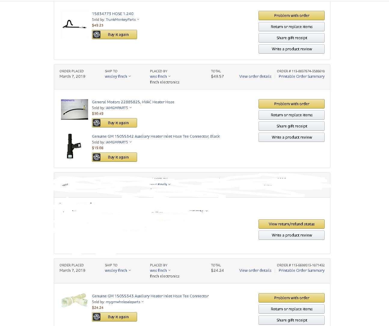

Does anyone know THE OEM part numbers for those quick connects at the heater core? I couldn't find them on gmpartsdirect.com

Thanks for the reply. So does the denali only have the t-fittings? Or does it also use the straight connector too?
Sent from my SM-N970U1 using Tapatalk
all the suv have the T only the silverado's/sierra's use a straight connector, unless it's a older 2 door or something pre 00

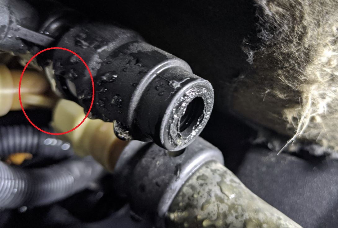

Hi Folks,
I just had a heater hose blow out on my 07 Yukon XL Denali. As the photo shows, it appears to have literally 'torn' itself off, right at the back side of the crimped coupling on the end of the hose, as it looks like there is still hose within the crimped coupling.
Question for you.... Do I need a special tool to get the crimped connector off of the plastic nipple of the coolant distribution block? If so, where is the best place to buy the tool? Part number?
Does it also make sense to change out both heater hoses, along with both radiator hoses? Any other coolant-containing hoses that should be changed out, as well?
All suggestions welcome.
Thanks in advance.
Just use a Dremel tool to cut the oem clamp bracket and there is enough slack to use the existing hose. Then buy a small set screw hose clamp from your local hardware store. Tighten it real tight and walla. Same thing happen to me and that was the fix. Don’t go out and buy another cheap plastic t fitting
Ya that's just setting yourself up for another failure down the road a bit, once the plastic is deteriorated enough to just break off on it's own then it's time to replace the whole shebang and it would be just someones luck to be not really paying attention and have the engine overheat and cause other much more severe problems. bad advice.
i mean if you are in a pinch you gotta do what ya gotta do but that's a short term fix

if you wanted to delete the rear heat for some reason yuo could use the striaght
What does the plastic breaking off have to do with using the existing hose minus the crappy compression clamp from GM? Remove the broke plastic from the hose. I had no issues for a couple years now since using the hose with a screw clamp. The other parts of t-fitting is fine.
if yours has lasted a couple more years great, it's just a matter of time, those "T"s can break off anywhere at anytime once the plastic has become brittle and the T on the rubber hose splitting from off the water pump to the reservoir breaks also. I learned my lesson already. when you have been driving these for 20+ years you see some patterns those "T"'s haven't changed design. in time the reservoir will crack, the radiator will crack, the water pump will leak. the upper and lower radiator hoses seem to last though. The hoses, T's, reservoir, radiator are maintenance items, the water pump is also but generally it doesn't just blow out all the coolant and leave you stranded somewhere usually they develop a leak or a slow dribble giving you time to get it replaced.

Good grief look at all those hose clamps to possibly leak. That does not look like a good solution to just getting new OEM ones that’ll likely last another 10+ years.
They wont leak. That's a bullet proof setup compared to that plastic shit.

The hose(s) that sit above the splash pan have a tendency to start leaking as well. I used the same method for the heater hose w/ screw clamps as oppose to buying a new hose with the crappy clamps gm sell. But to each’s own, my 08 Lade only has 106k miles and I don’t plan on having it pass 160k.
Well if the rest of the T breaks off then I will switch to the billet style over the OEM plastic. As u stated...my option is a quick fix that can be done as you wait on replacement items. [emoji41]
