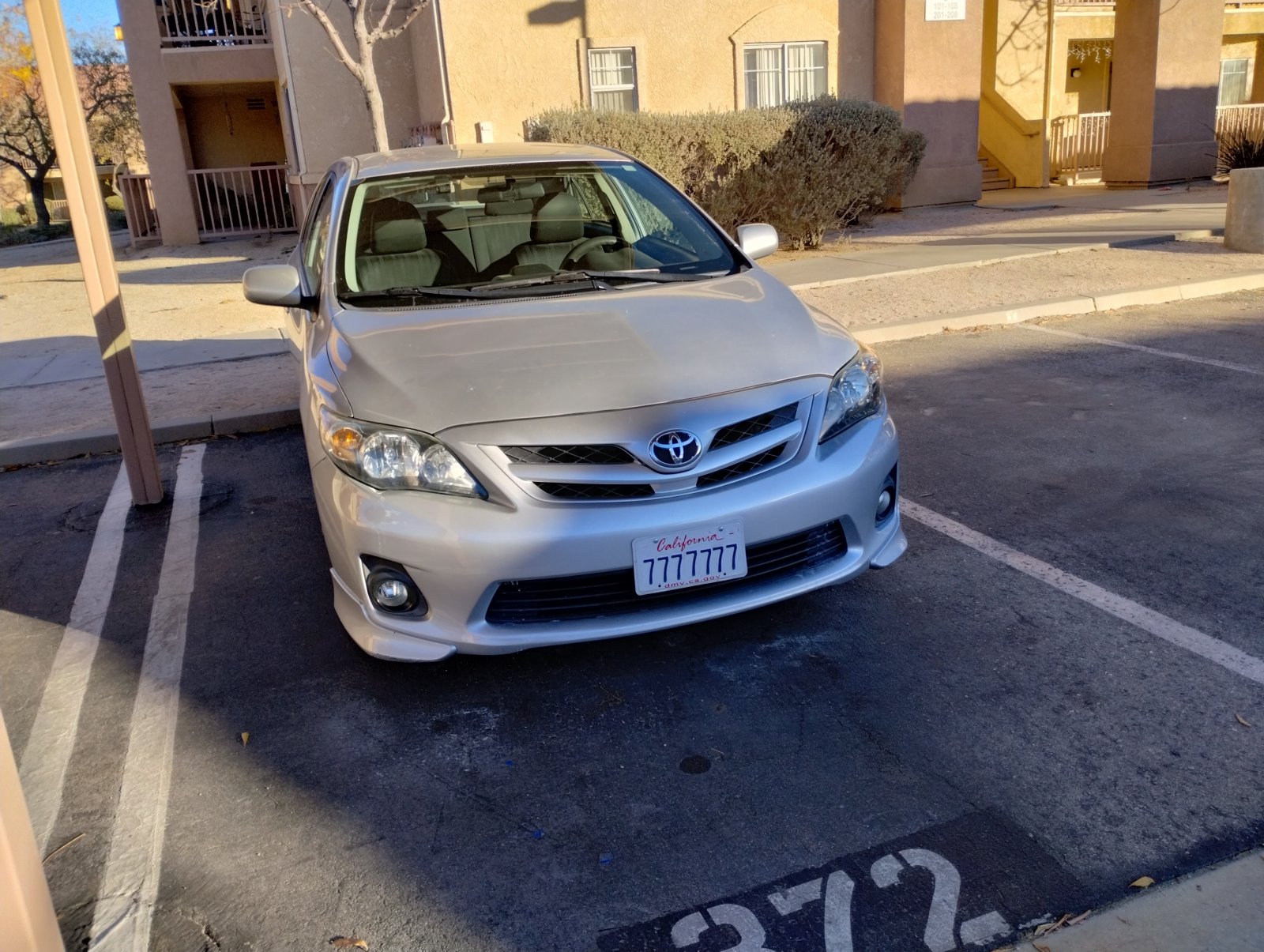

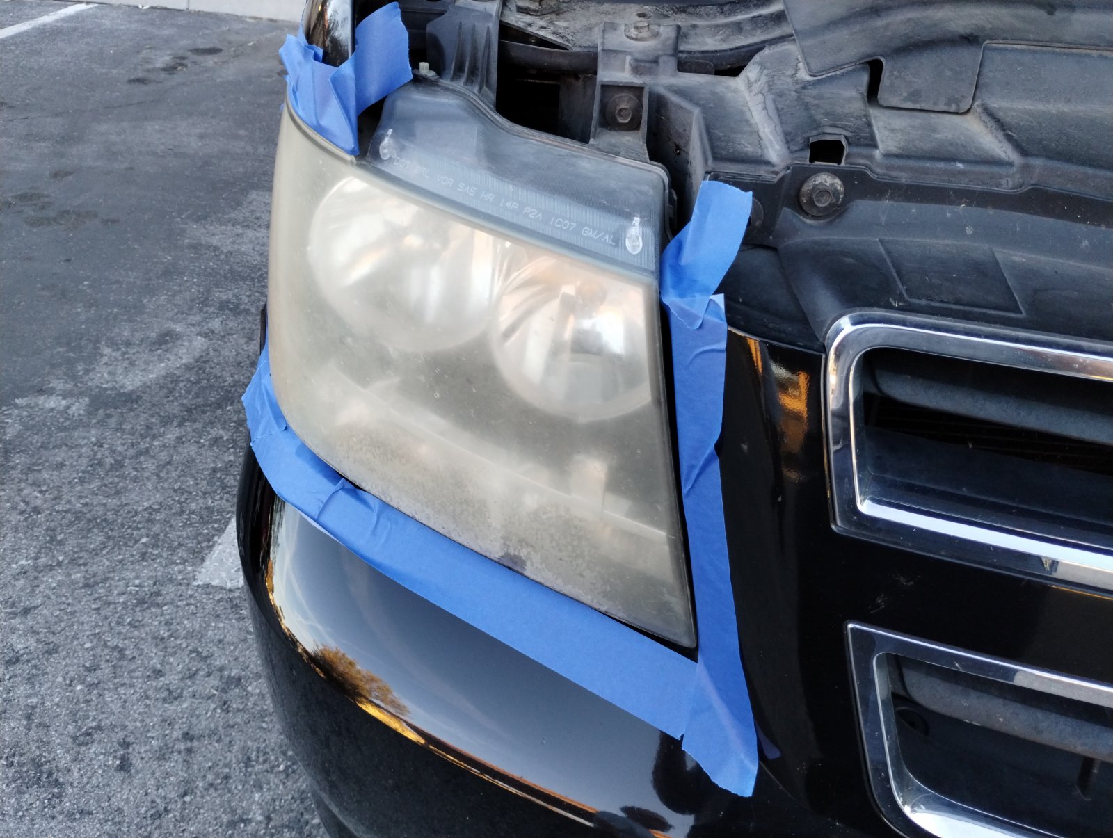

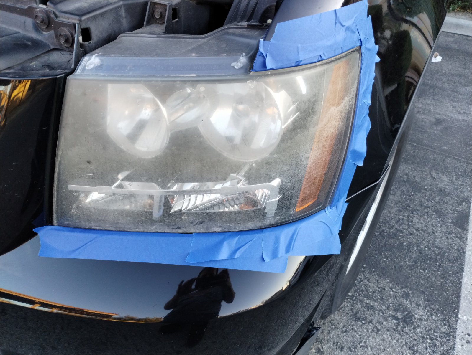

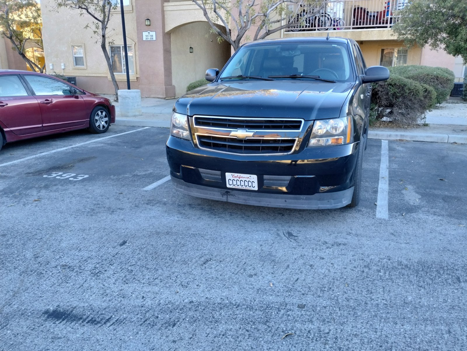

Just cleaned the Headlights
i used CERAKOTE to do it, came out nice
did the corolla as well..
at lest now i can actually see at night 4-HI is also way better.... i can see about 1/8th of a mile down the road with 4HI

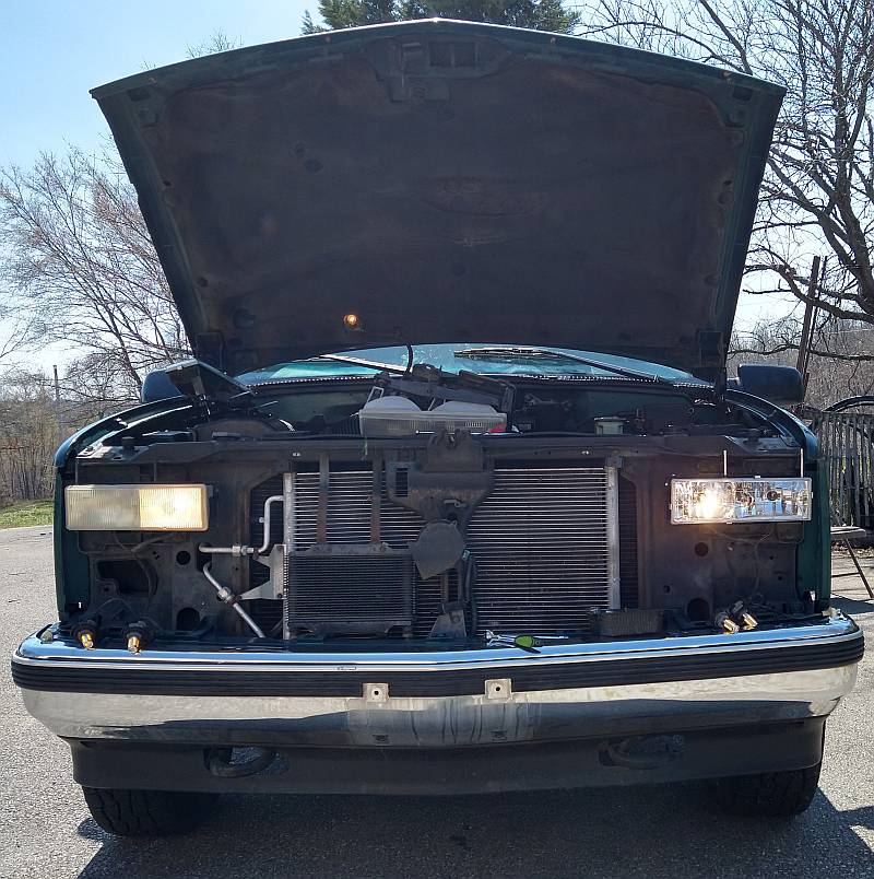

Once you've removed the "skin" on the housings, they'll get cloudy even faster.
I just got new housings. They're pretty cheap at Rock Auto. Sub $200. And to replace them, all you have to do is this... o_O
