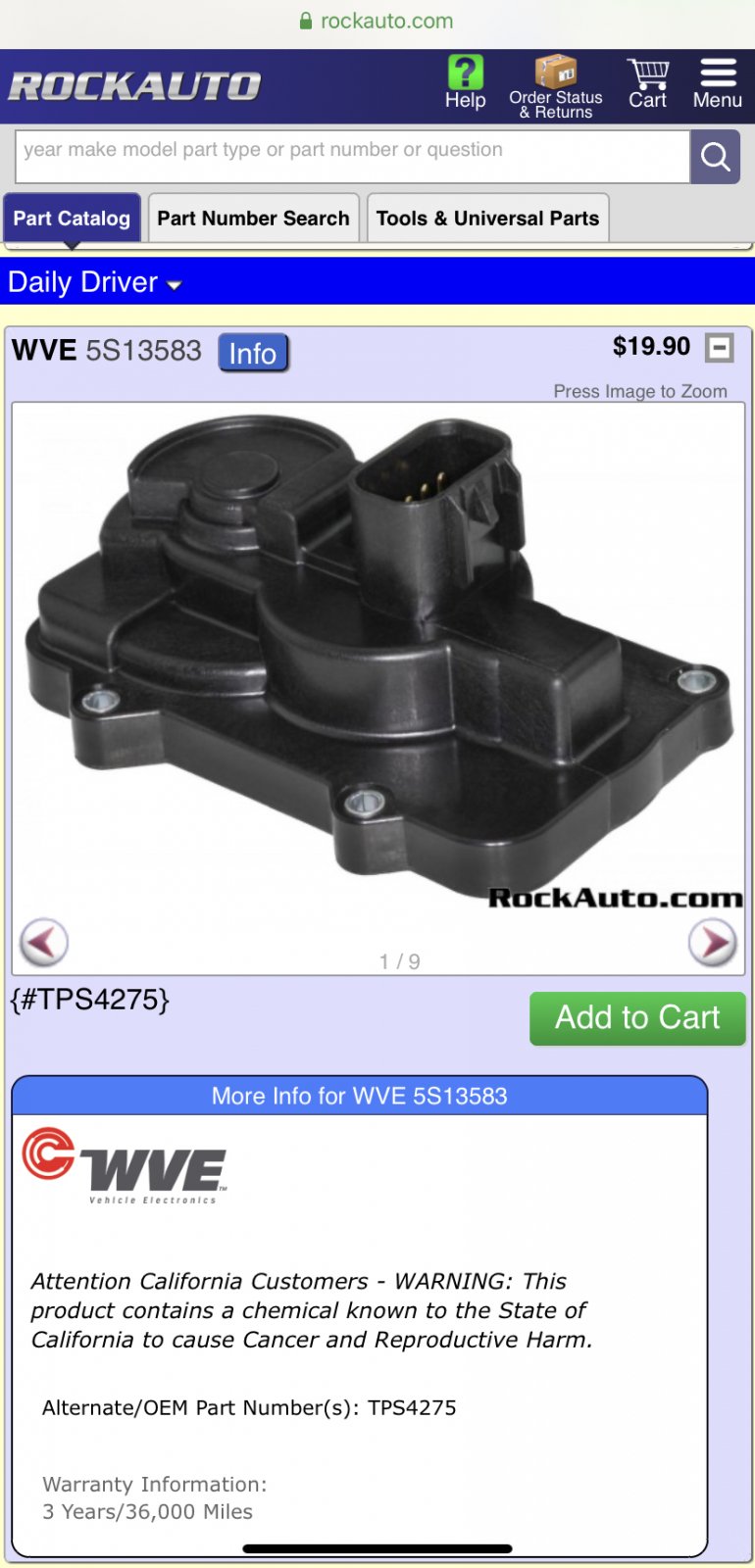

Went to change my tps today and this is what I found anybody know where to get this style.03 Denali xl 6.0

RockAuto has what you need I believe.
RockAuto.com is a great source for parts. They are also a sponsoring vendor. Should check out their thread in the vendor section.

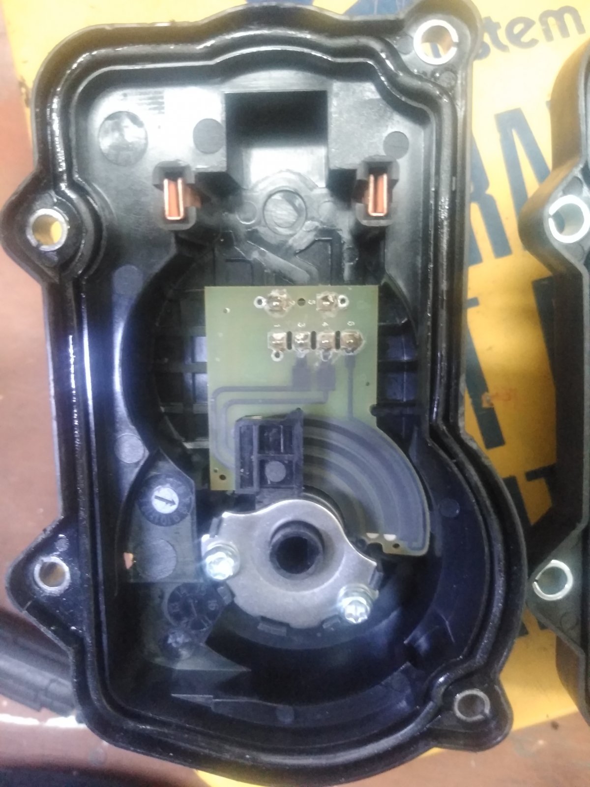

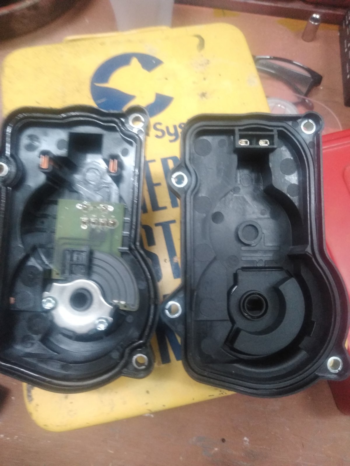

Look inside that one if you can I ran into this problem nobody can find it on their computer at the parts stores or even seen one like this..notice the circuit board and dials with numbers it is adjustable or something and the two plug in connection are in different spots.

Whole throttle body. And a pigtail.
Kinda what I figured lol... probably have to get it programmed also...thank you

either the junkyard if your lucky and find one that will sell it separate or just buy a whole used one from them
the one you bought and doesn't fit is the only one available and is the same for the 4.3, 5.3, 6.0, 8.1 liter 1500, 2500, 3500

Yeah I know I had a 04 Yukon 4.8 took the normal one...just have to order a whole new throttle body assembly ...thanks for your info

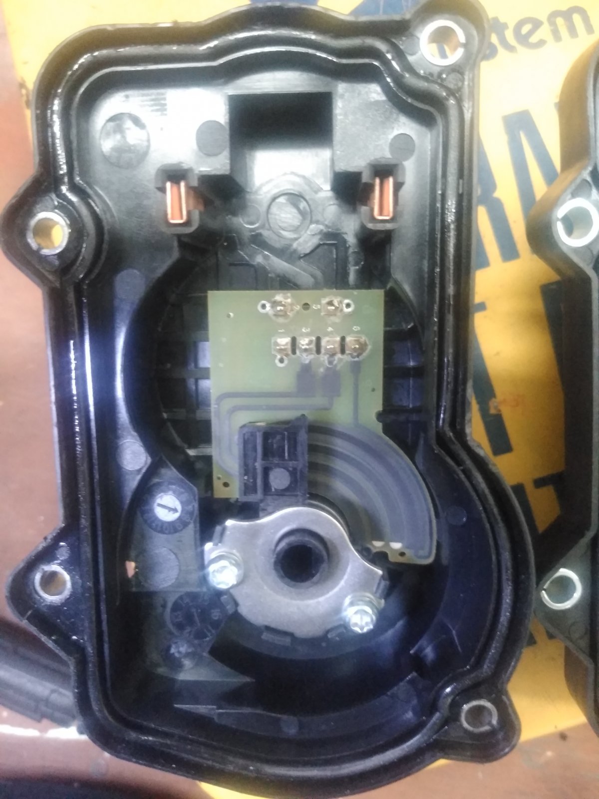

I don't really know any more than what I've seen on YouTube, and I might be seeing things, but your old one looks like it might be from an NNBS.

As far as I know it's the original engine 6.0

Might check with your parts guys on the off chance the TB's been changed. Shot in the dark.
EDIT: @Mpsw9mm, my observation was based partly on the configuration of the two connections at the narrow end of the part. Does your part, or the TB, have any numbers on it?
