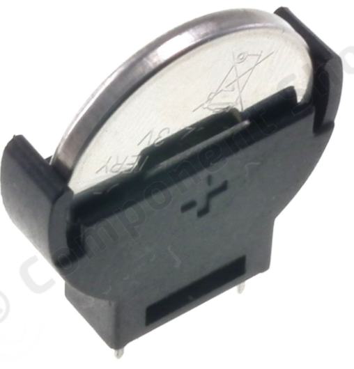

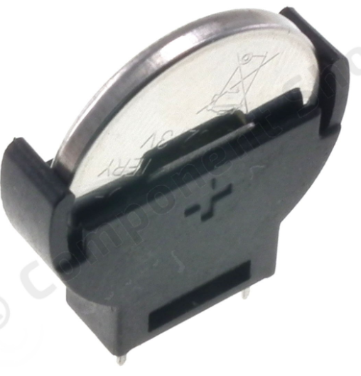

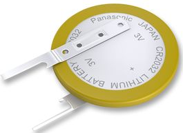

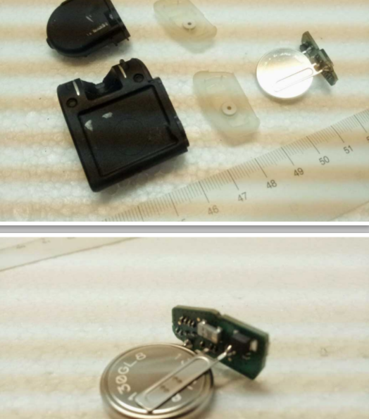

You are righ, any of them have replaceable batteries but these ones have just two contacts soldered to the PCB and the sensor seems easy to open, This kind of batteries are everywhere, you can buy them very cheap. So, I would try to replace the battery before changing the whole sensor, I even would try to add a battery holder in there so it can be easy next time. The problem with the old sensors is that they are glue together with some kind of black epoxy and it is very risky to try to open them. I am planning to play with my old sensors just to figure out if I can replace the battery as well.
View attachment 181697 View attachment 181698
I'm sure you'll beat me to it. I never gave any thought to just trying to replace the battery. One of mine, the one that failed first, apparently came apart. I had a piece of plastic removed from inside the tire when I had them balanced a while back. So, I'll need at least one. I'll most likely wait to get 4 new ones for when I get new wheels. In the meantime, I should see if I can replace the batteries in my current ones and replace the one broken one with whatever's cheapest but functional. Maybe I can have a shop break the outer beads off the wheels for me so I can experiment with the sensors.

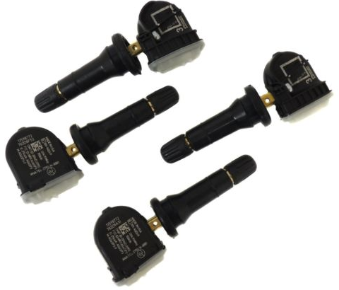

Bought four new takeoffs from a guy on ebay. Must be a fleet manager of some kind. They are part number 13598771 and dated 10-16. They are made in the USA too! Look likes the ones in Post #13. Installed two of them the other day and work fine.
45,011
Very good info! Thank you!
