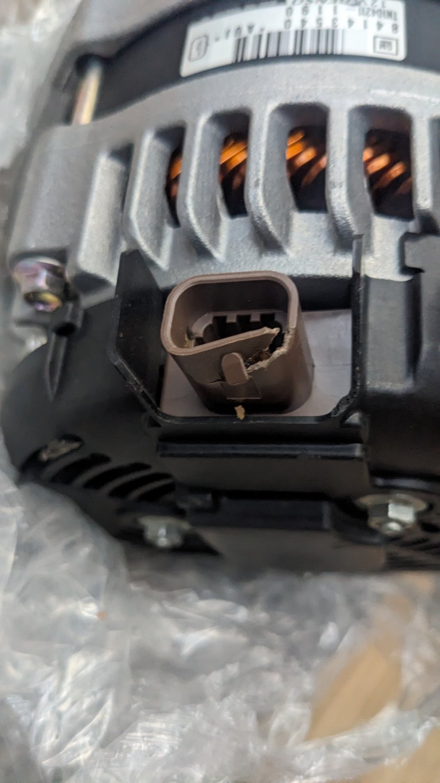

I'm still working on seeing if it works. they sent me one with different damage than the pics had. this one the 2 pin plug top is broken off, so there's no tab for it to clip on. I'll take some pics and email them about it soon. other than that the thing looks brand new, super low miles.
Dammit! The cracks in the plastic cover and chipped piece of the lug tower wouldn't have meant anything. That broken connector is a legitimate problem. What's so difficult about getting what they're advertising and what you paid for?!
Not to disregard the fact that they should make good on it, but, I suppose that plastic piece isn't an easy swap from your stock alternator?

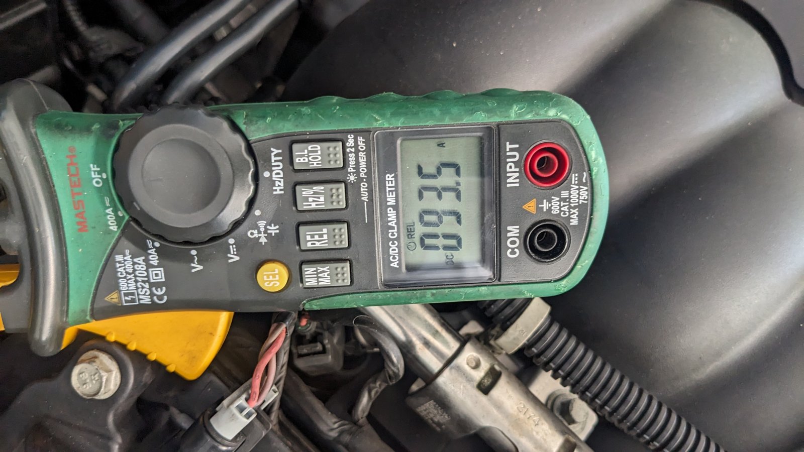

either ways, just setting at the default 13.7 at the terminal, up to temp after a 20mins drive in 100deg Temps, pull in the garage, turn the ac down to max, open the doors so everything ramps to max load, all lights on. saw 92amps and that's with the larger pulley, idled down to stock idle, 700 I think it is, 10% under drive crank pulley and it's solid.. no fluctuation at all in voltage at the terminal. at that load I'm getting about a half volt less at the battery itself and 0.8 less at the dash. only about 0.5v at the dash display when I wasn't going for max load test. might clean up the grounds and terminals, but these cars are dumb and have a small 14g fuseible link inline between the alt and starter, then up to the battery and fuse box. lot of places to drop voltage at 90amps. well cooling fan is straight to the alt terminal, so probably only 55amp or so thru that link. but this is by far the most solid voltage this car has had. I do wanna bump it up to what the agm wants at the battery itself, byond that. it seems worth the hassle to make it work. I swear the car runs smoother, that could be in my head thou haha.

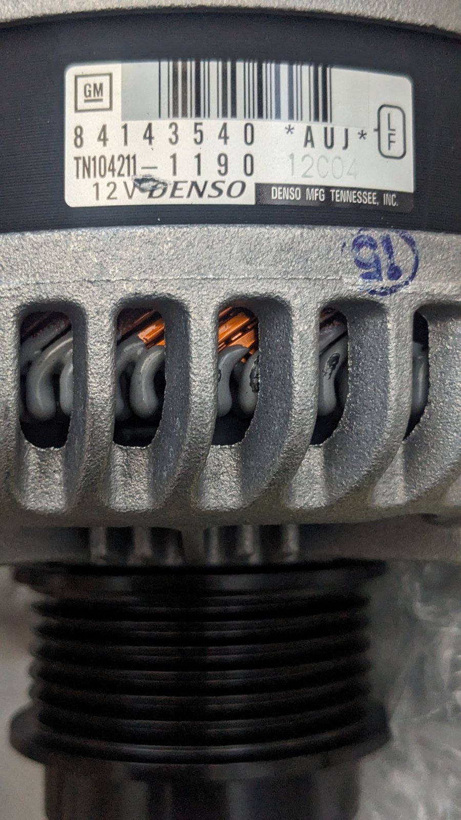

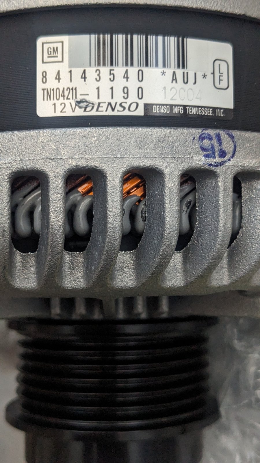

so you got any into on this part number?
the eBay seller send me a new one, it showed up today. totally different alternator. mint looking, has the clutch and a smaller pulley.
but funny thing is, the plug is broken on it too. I had to laugh lol. PXL_20230804_204741866.jpg

at this point I'm not sure what to tell them haha. I have 2 completely different ones. both with the plug clip damaged but both look brand new besides that.
but funny thing is, the plug is broken on it too. I had to laugh lol. View attachment 405369
I ran across that one when searching and sorting these out. I'm a fan of Denso and had that on my radar. But, The info I found said it was a 170A alt.

170 is what came up when I Googled the part number. I sent them a message saying it wasn't the part number I wanted 220amp and at this point I'll keep the first and if they want to send a FedEx label, I'll drop this one off.
I'm half expecting them to just say keep both and stop bugging us haha.
