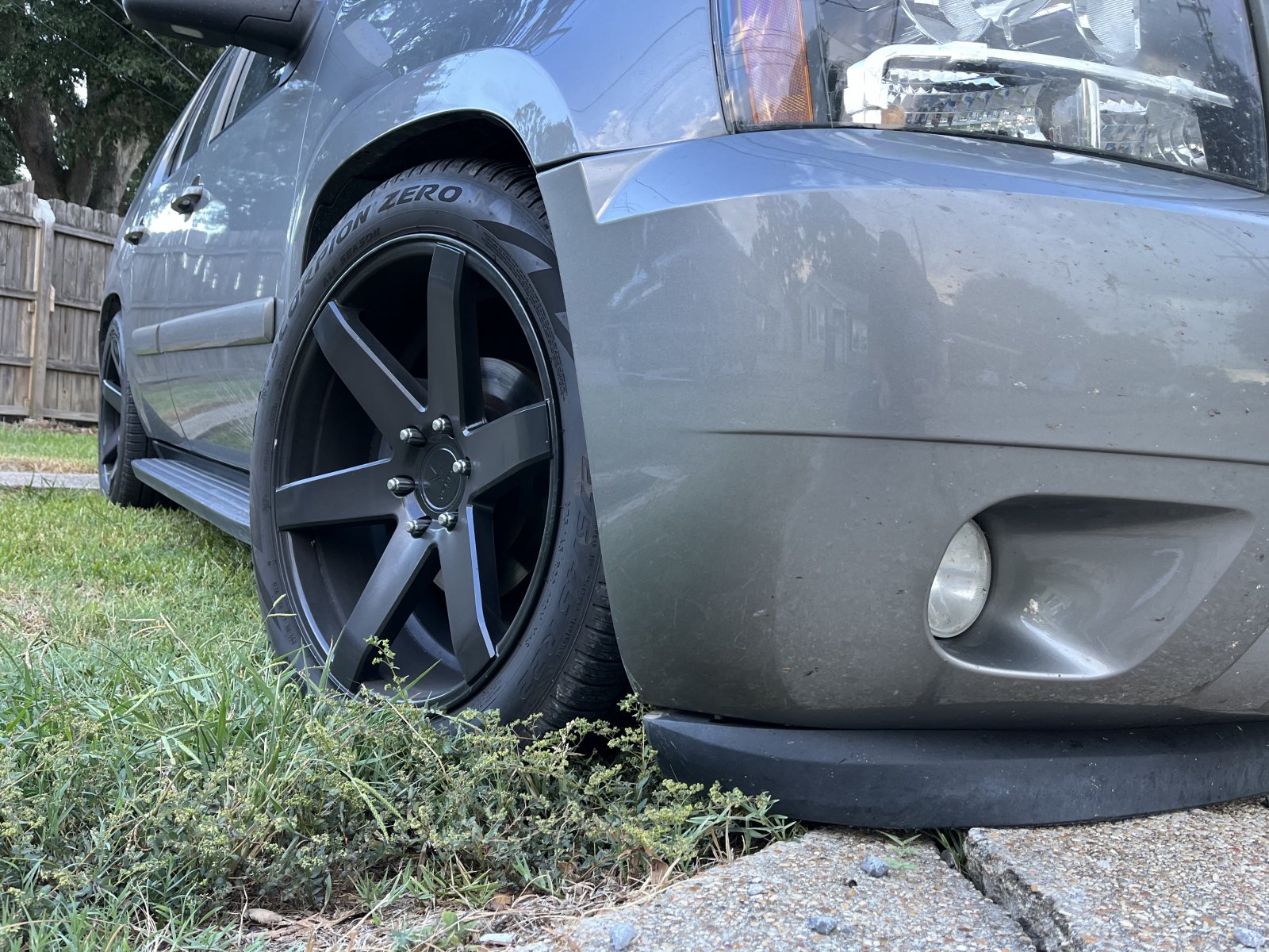

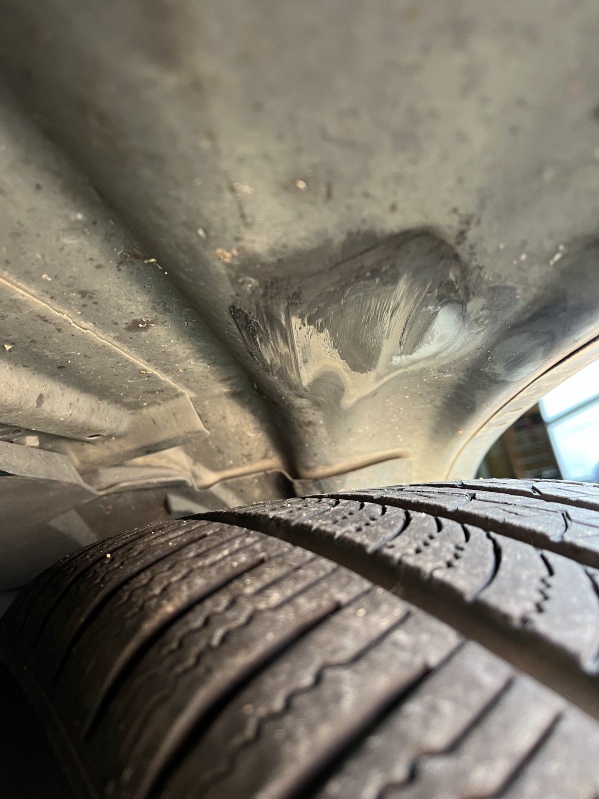

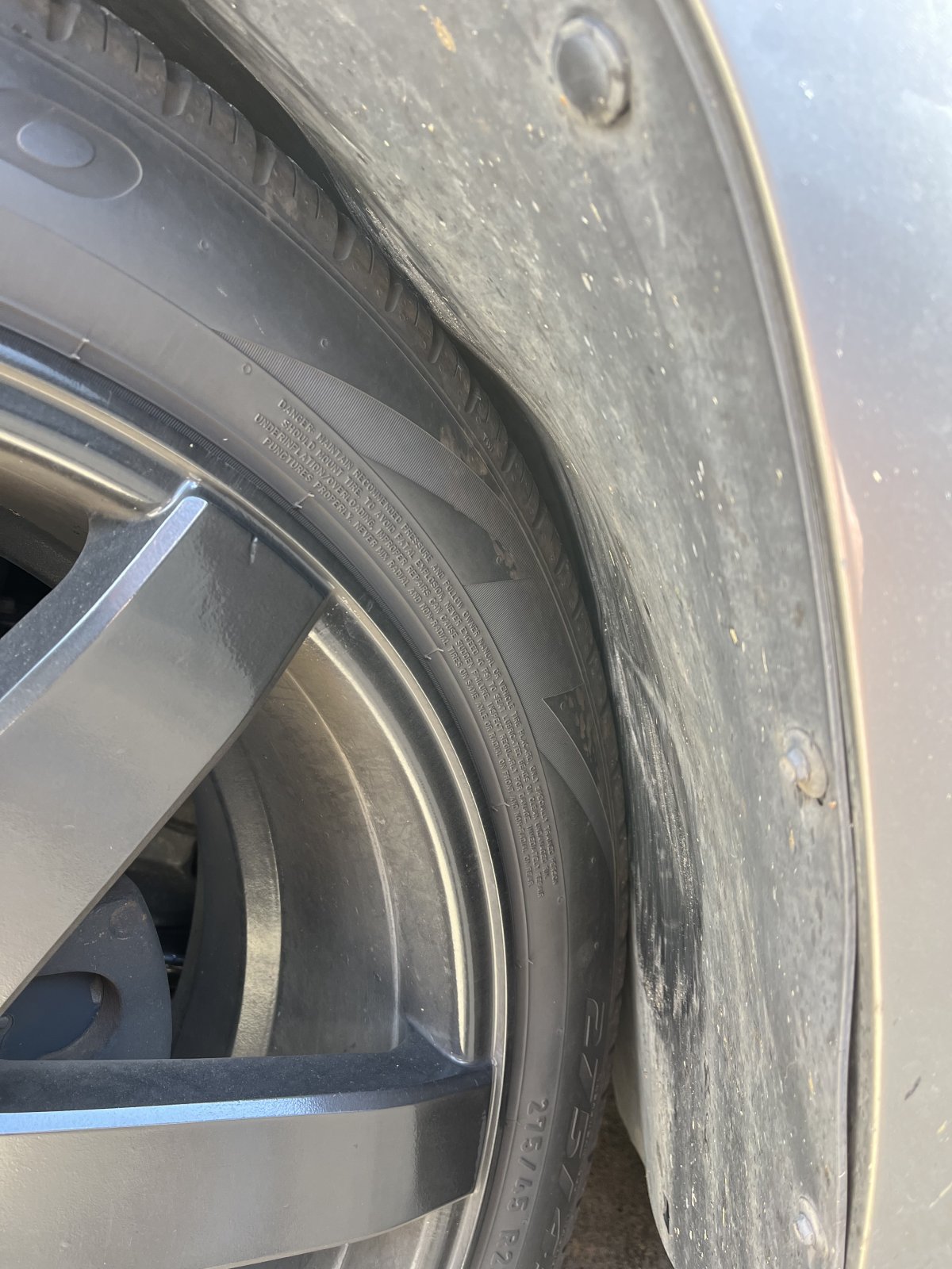

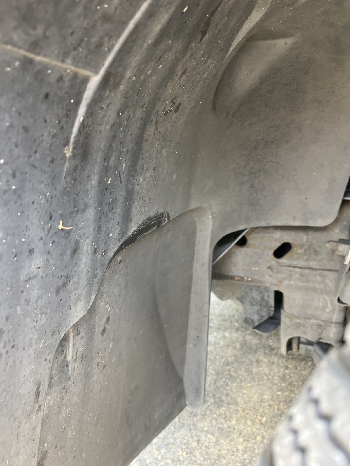

45,013

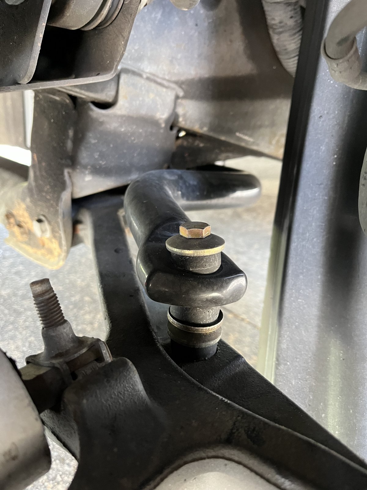

Had it parked outside with the wheels turned a little, so I snapped some pics of all the rubbing spots in the front just to document. And here I am still talking about going ~1/2" - 3/4" lower:
Not a rubbing spot. Just spotted that thicc bar and them eeny-weeny, teeny-weeny ittle wittle short short links.

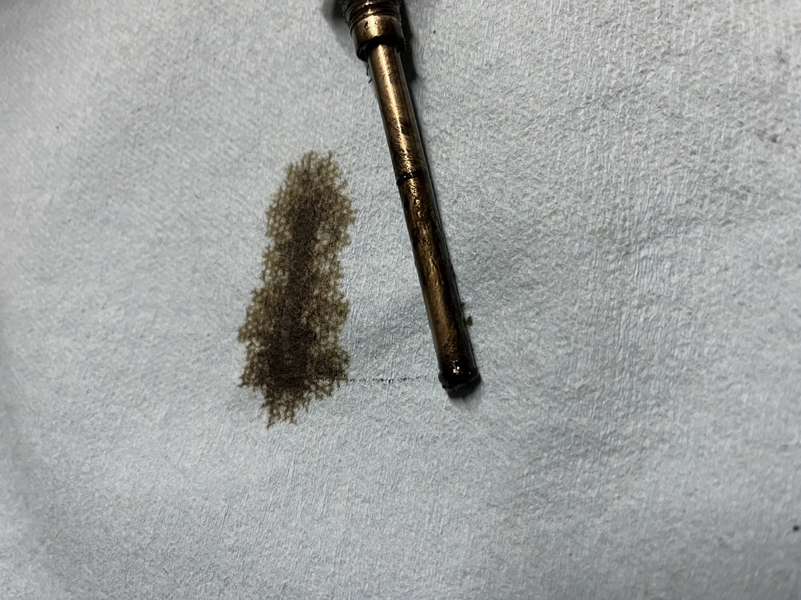

5K service yesterday. It was actually closer to 6K. I changed it a little early back in November before my trip to Tampa after having that valve spring failure. Oil was the darkest it has ever been that I can recall. Maybe some remaining contaminants from when I had it opened up? Or maybe it's from running E85 almost exclusively since? Got two ounces outta the catch can. Collected a sample for Blackstone. Rotated the tires for the first time since installing the 22s and Pirellis. Blasted the dust off the brakes and gave everything a quick inspection.
Plug magnet was as expected:

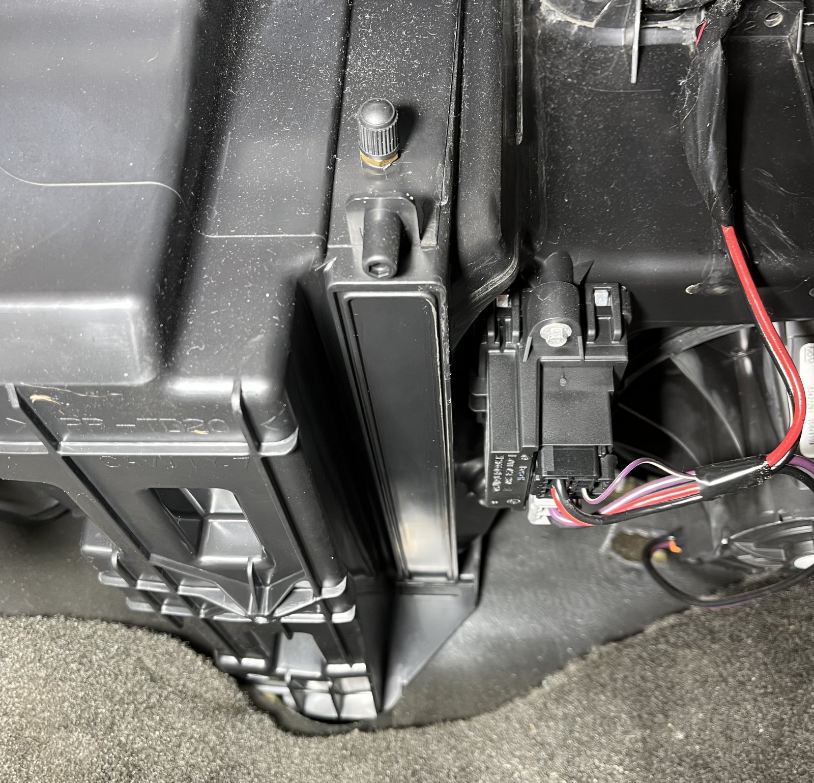

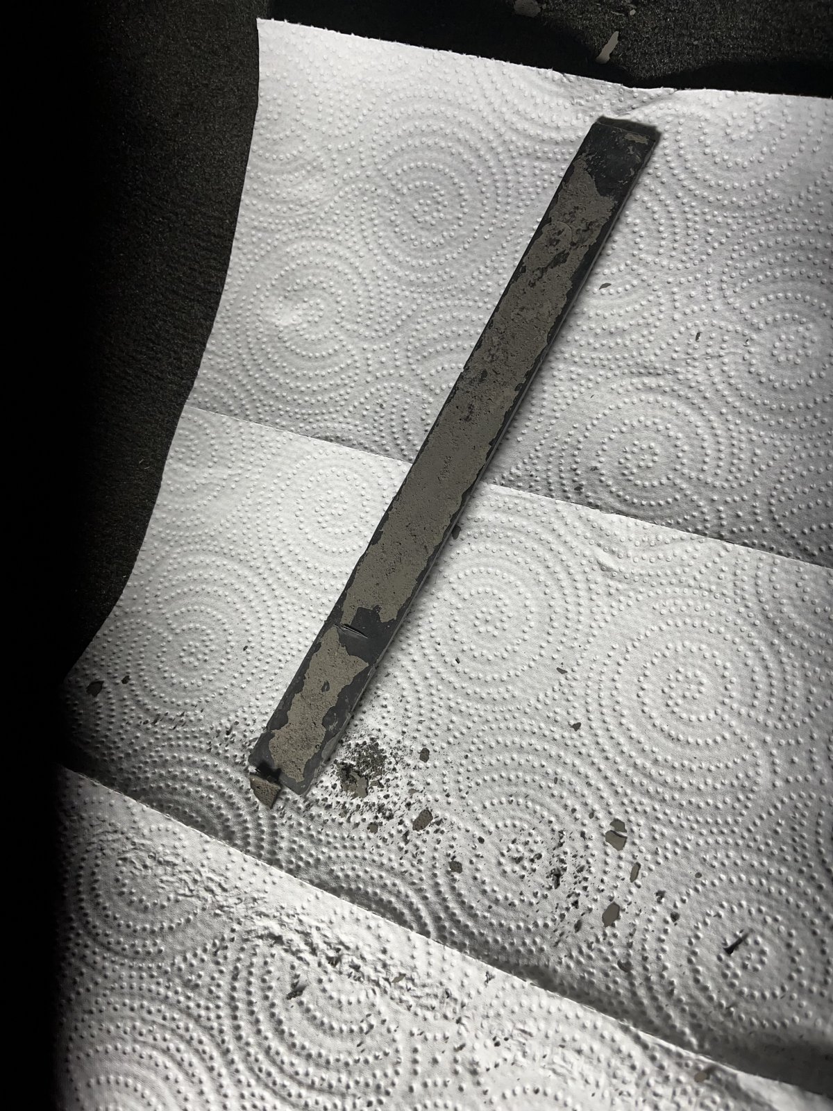

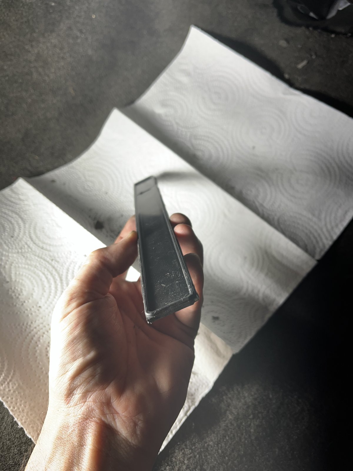

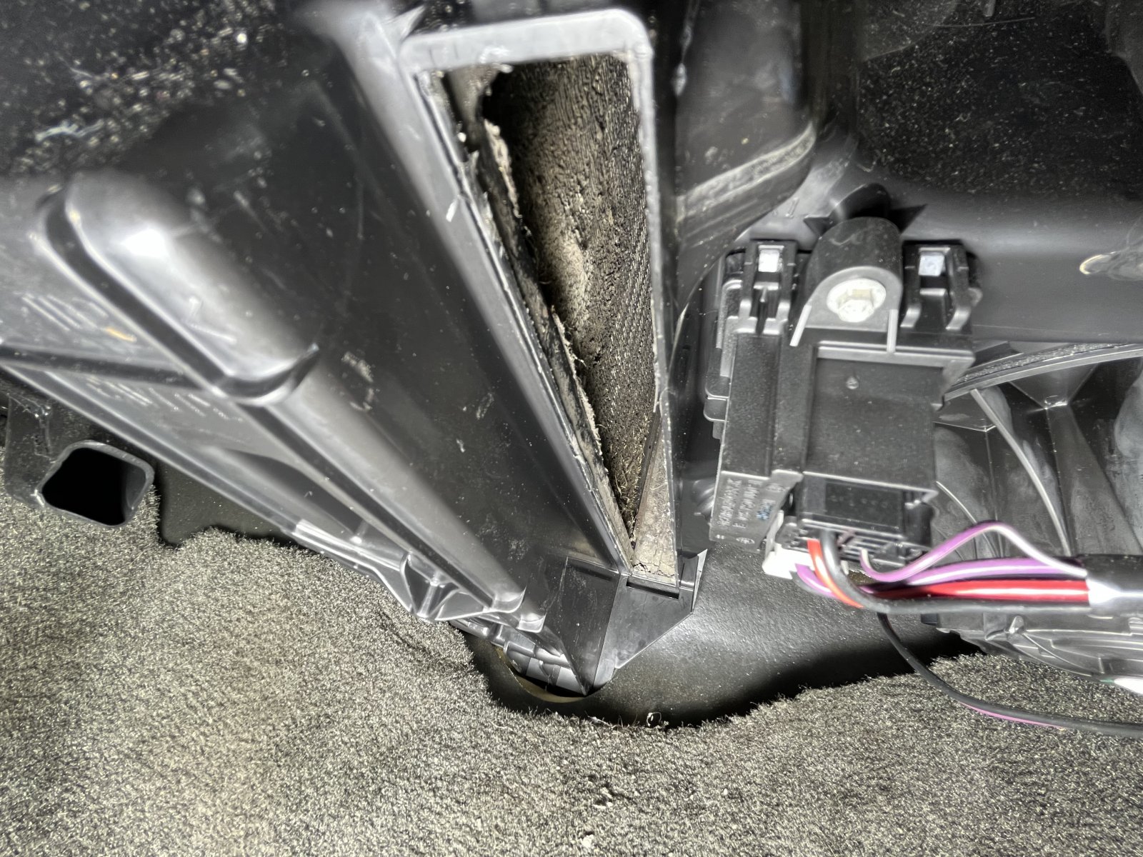

Cancelled a date yesterday to play with my Hoe.
I've been apprehensive to install the filter retrofit because (1) It's a difficult location to work in and (2) I was afraid of what I might find and the subsequent snowball. Well, "it ain't gonna install itself" so I decided to just get it over with.
The target:
I used my EDC utility knife with a fresh blade to score the four straight parts until I could press the blade through and drag it to cut straight lines. Then, pushed up on the center a few times until the rectangle piece cracked loose on one end. I worked it up and down until the other end cracked loose then let it fall out:
Seeing the flakes of dirt fall out confirmed my suspicions of what I was getting in to. Flipping the removed piece over, the dried "mud" indicated that someone had used an evaporator coil cleaner at one time, which is what that port with the valve stem cap just above the screw boss is for:
Either the cleaner didn't really work or it was done long ago. I was worried that adding the filter would reduce the air flow. After seeing this, I doubt the filter would reduce the flow any more than what this build-up is doing. It was late so I stopped at this point to formulate a plan to clean it out without pushing anything deeper into the fins. I'm thinking a strong initial vacuuming followed by a gentle brushing with vacuum, then spray cleaner, more vacuuming, etc. would be best. If I knew how thick the coil was and what was on the other side, I wouldn't be above cutting an access slot on the other side to back-blow it with compressed air:
Until then, I'm just gonna install the lid from the filter retrofit kit so it's operable. I'll leave the HVAC cover in the second row floorboard as a nagging reminder to finish this project.
The target:

Just had to go back to make sure I didn't miss a page. I'm HVAC dumb, so forgive me...what the hell are we looking at here?
You said evaporator coil, so that makes me think AC system?
45,013
Hi, you must be new here! :p
So, GM deleted the cabin air filter for the GMT900. It might have been optional in the GMT800. Anyway, the slot for the filter is still there and, instead of an access door, the slot is just sealed off. You can cut out the rectangular portion sealing it off and install the filter. A retrofit kit will have a closure piece (the "access door") that is essentially identical to the factory piece. The boss for the screw to secure the closure is even still there in the HVAC housing.
Take a couple Advils and/or Ativans and slide up under the passenger floorboard. The HVAC cover is secured by three screws (7mm, IIRC). The rightmost and center are easy to remove. There's a third tucked up under the dash, in front of the center console- "good luck", you'll figure it out. Remove that cover and you'll see everything I pictured. I bought the cheapest filter retrofit kit Amazon had. No complaints at all with what I received. I don't see any functional difference in this $13 kit versus the $40 Dorman kit. Cutting out the door is a hassle. But the real chore is cleaning the crud out of the fins of the evaporator without shoving it deeper into the fins. You can only access on side of it and you're working through a ~1" x 8" slot, in the footwell up near the firewall. Ideally, you can find something the same height as the floorboard (bucket, ice chest, etc.) to place next to the door sill, sit on it and lean backwards into the floorboard to work. I've been tempted to remove the passenger seat. But I gotta suffer the hard way first.
