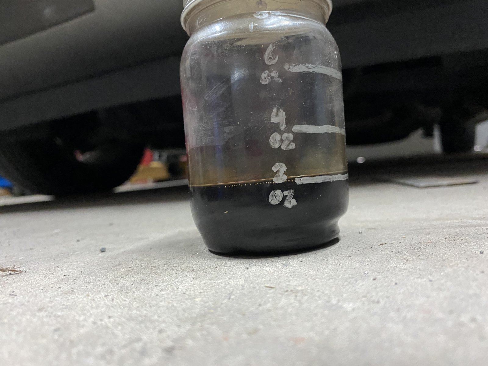

Only four ounces low. I was supposed to drain this into a clean container to give to my neighbor to run in his, but I forgot and drained it into my jug out of habit:
It must've burned two of those four ounces cuz the catch can had two in it:

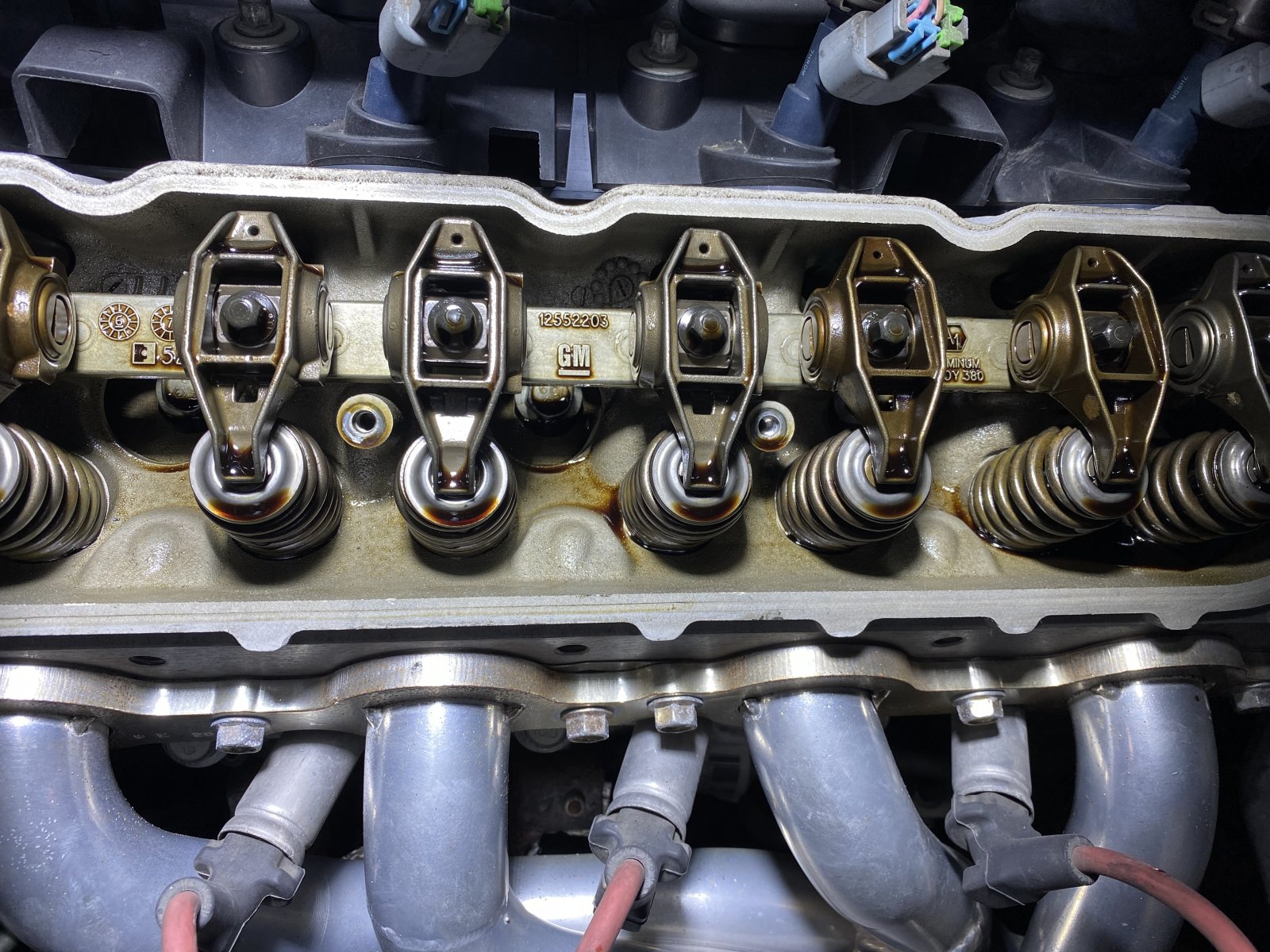

Popped off both rocker covers to inspect. Not sure what's up with some of the rockers being darker. They're the originals and maybe they were on other cylinders. But, I swear I kept them all in their original positions. It appears to just be oil staining as it wiped off. :

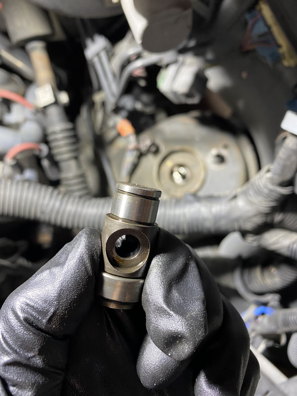

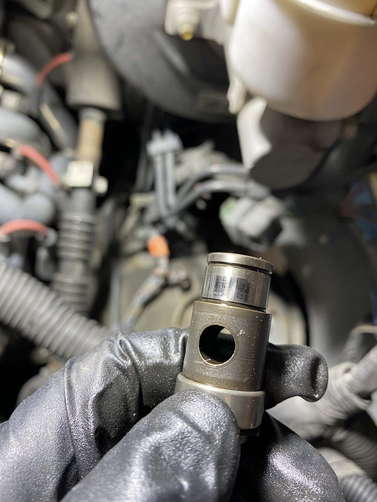

I wanted to swap in sturdier rockers since I'm running the originals. Back in 2010ish, I had some ~20K-mile rockers fitted with a Comp trunnion upgrade kit. I never finished that build, sold the motor and those rockers sat on a shelf for 9+ years. A couple years ago, I put them in my brother's truck since his were damaged from loss of oil pressure. Not long after that, I stumbled across a bunch of old horror stories of how that Comp kit was failing- the trunnions were getting chewed up by the bearings, possibly from improper hardening. The issue seemed to be from around that time period. Playing it safe, I swapped 'em for some new OEM ones I had slated for mine. He only ran 'em for about 10K miles. Yesterday, I took a couple apart to inspect and saw what I believe is the beginning stages of the aforementioned failure.
The top/low-load side appears fine and you can see the band from where the needle bearings ride:
The bottom/high load side is definitely worse. There was some pits (ignore the paper towel fibers) in the bottom centers that I could feel when I lightly drug a razor blade across them:
I decided to not use them. I'll be getting something else, if not just another new OEM set.
I remember reading a few years ago about the Comp rocker downgrade failing people with mild cams, it's a good thing you caught that early! I have a set from CHE which is supposed to be "the best" but I will be inspecting them when I pull the heads this weekend.
Every set of OEM rockers I've seen one bank is always stained worse than the other so you may have gotten some mixed up. I looked into the different color causes and the general consensus was that it has to do with the PVC being on the driver side.
I don't even know what I was looking for when I stumbled upon that info when I did. They felt fine and I couldn't feel any slack, so I figured those failures were with high pressure springs on donkey díck cams turning 7,000 RPM. So I was gonna clean 'em up and roll with it. Glad I took some apart!
That makes sense about the rocker color. Two are darker, then two are light, then two more are dark, etc. I must've mixed 'em up.
