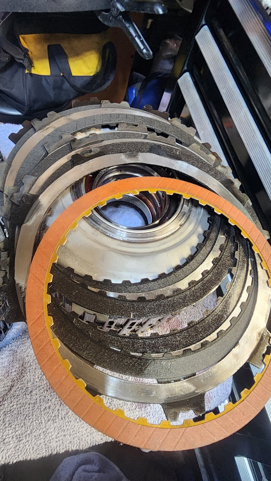

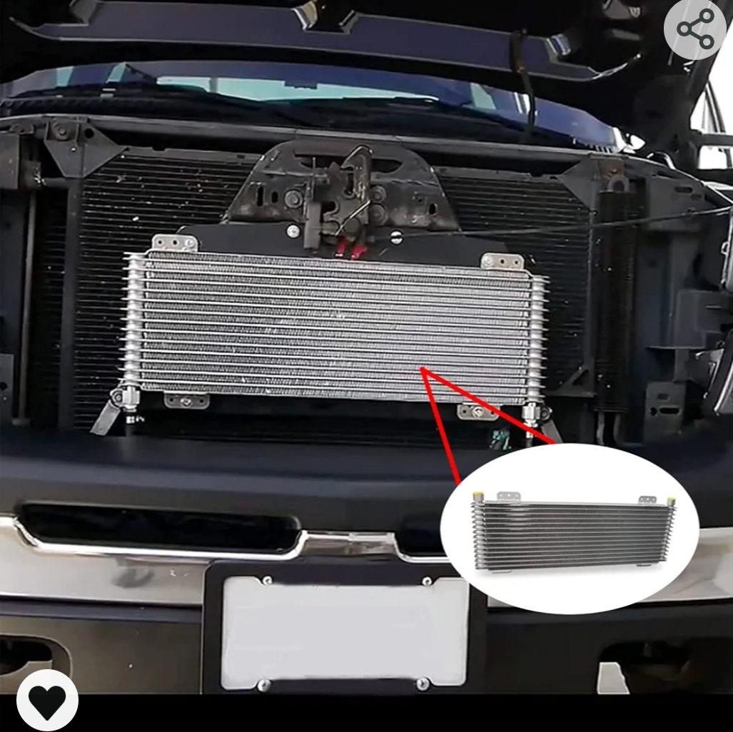

Pics is to this upgrade cooler and how my 1234 clutches look.

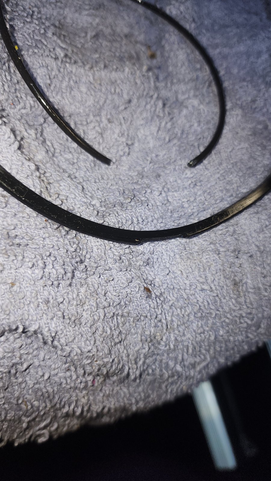

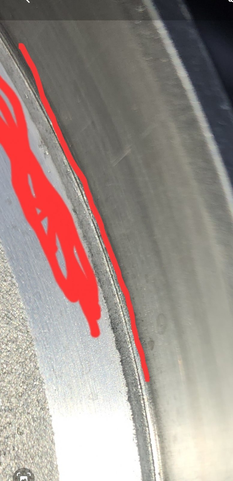

Found the culprits... Didn't inspect the 1234 piston well enough, and I'd say the broken ring and punch ring didn't help the situation at All.
Glad you found it - would have been much more stressful not to have a clear smoking gun to explain the problem.
