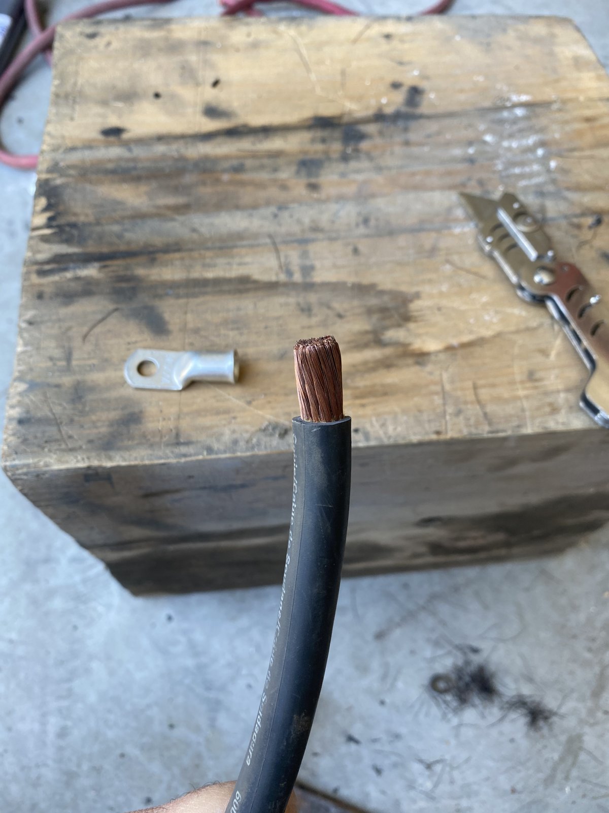

Did my Big 3 today. Well, most of it.

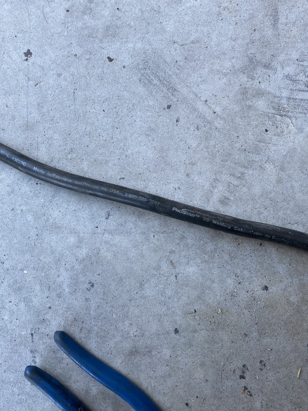

Used some 1/0 welding cable, hecho en USA, no less:
Cut the insulation to fit the lug, but not all the way through to avoid cutting any copper:

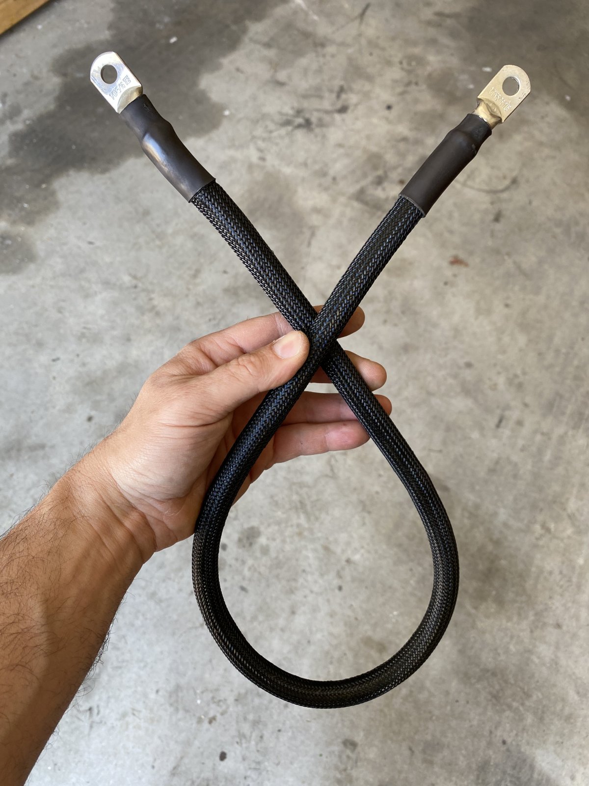

Clamped the lug in Vice Grips and filled the cavity in front of where the copper would go with solder to remove air space and to secure the tip of the wire in the lug. Crimped with hydraulic tool, added the braided sleeve and secured with heavy-duty adhesive-lined heat shrink tubing:

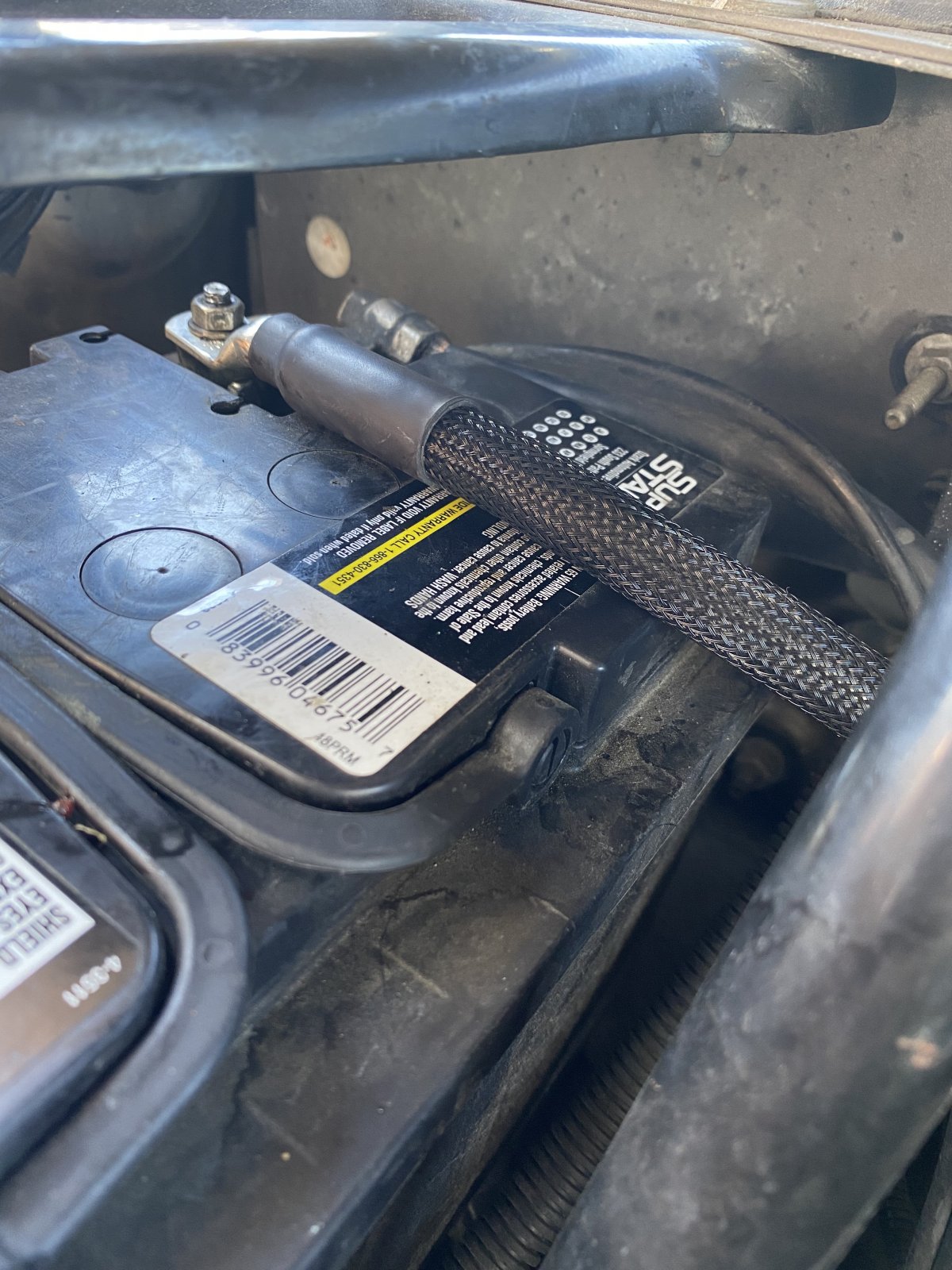

Attached to the factory terminal for now. This one runs from the battery negative to the frame, under a strut mount nut:
Attached to the factory terminal for now:

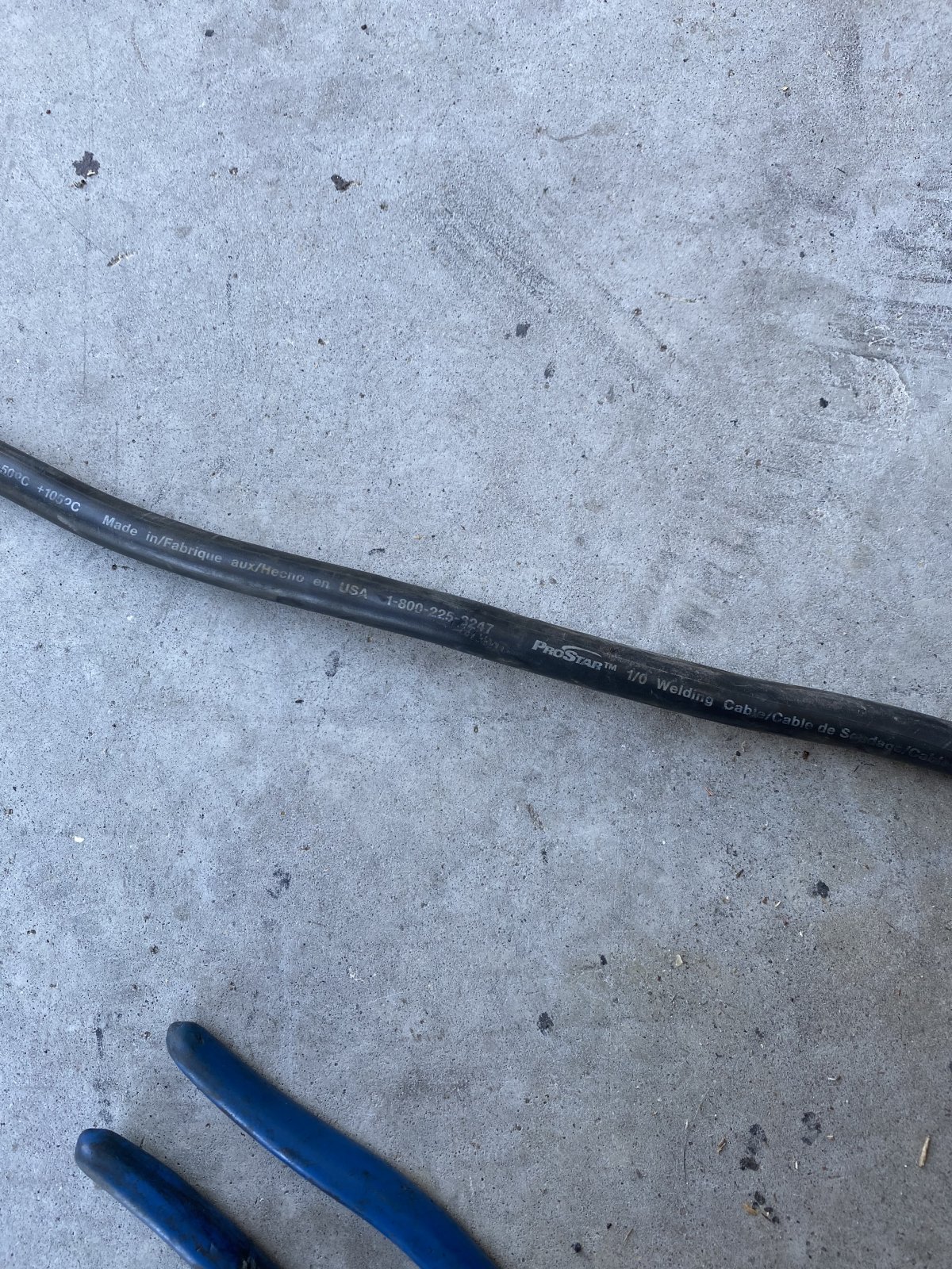

What's the overall diameter of the 1/0 cable and jacket (without the shrink or braided sleeve)? Wondering if my small DC amp probe would fully close around it, it's a 1/2" opening.
It's definitely larger than 1/2". I think the copper alone is about a 1/2". Lemme grab my caliper and give you some hard numbers...
*EDIT*
Correction: I was thinking of the 2/0 I was originally gonna use for this, but am reserving that for the golf carts. The OD of this particular brand of 1/0 cable and jacket is .530".
