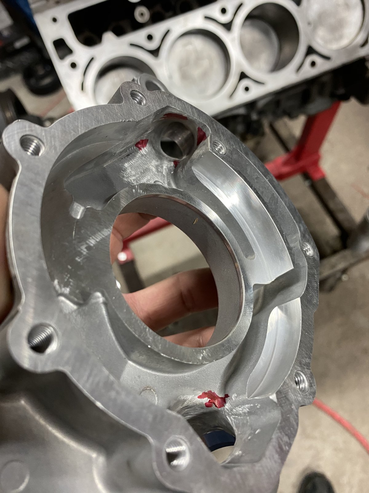

Current small update-

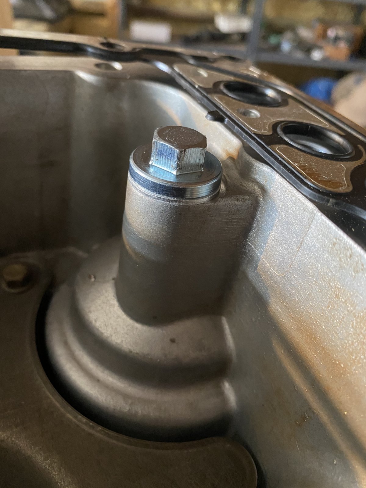

Took a closer look at the oil pump last night and marked some areas I want to improve:

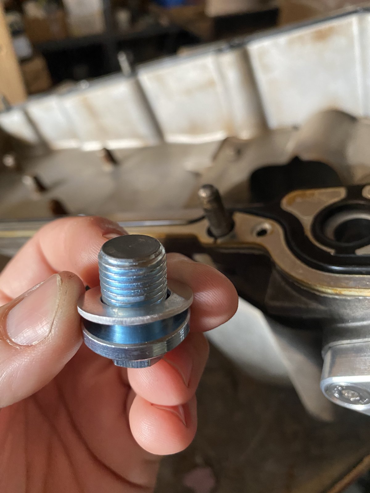

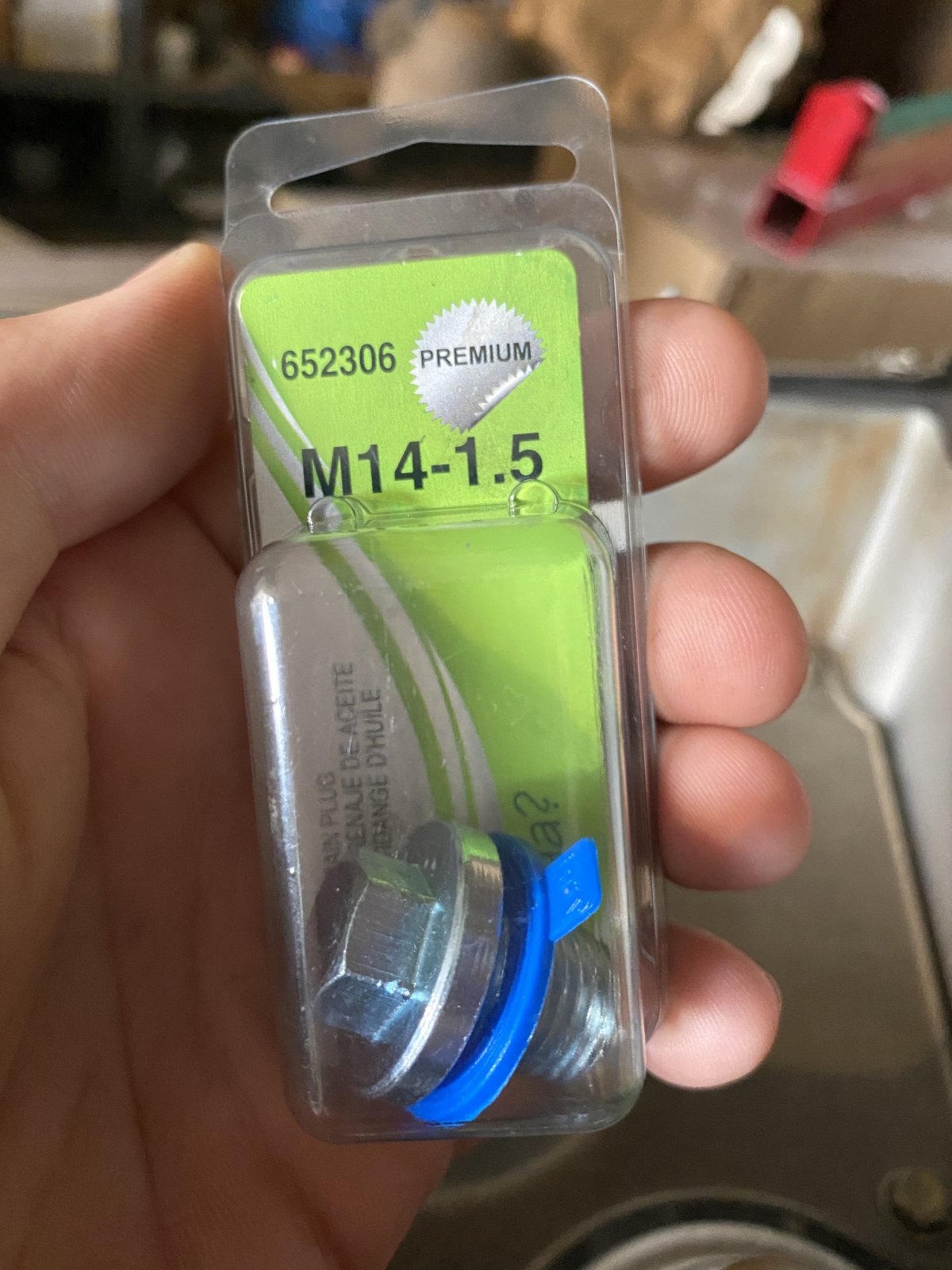

Had a service call at an Autozone today so I grabbed a bolt (oil plug) to replace the AFM oil pressure relief valve in the oil pan:
I used an aluminum washer instead of the plastic one that came with it:
Torqued into place with red Loctite. Looks like it was made for this purpose:
What oil pump did you go with? I'm getting closer to pulling the motor on the avalanche. A buddy of mine has several parts thats he has left over from various builds

Melling M295HV. Also ported it. My oil pressure was fine and, as far as my research showed, the M295HV was the direct replacement for the pump used in the AFM engines, which used a high volume pump. There's no need to try to peg out the oil pressure gauge. It's just excess load on the engine and stress on the seals. ~40psi +/- 25% is fine.

Pics and details of the oil pump porting, timing chain comparison and tower tapping are within the last few pages here.
