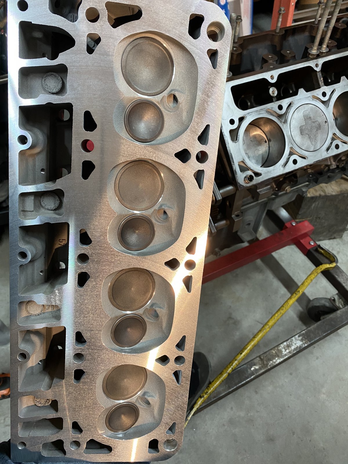

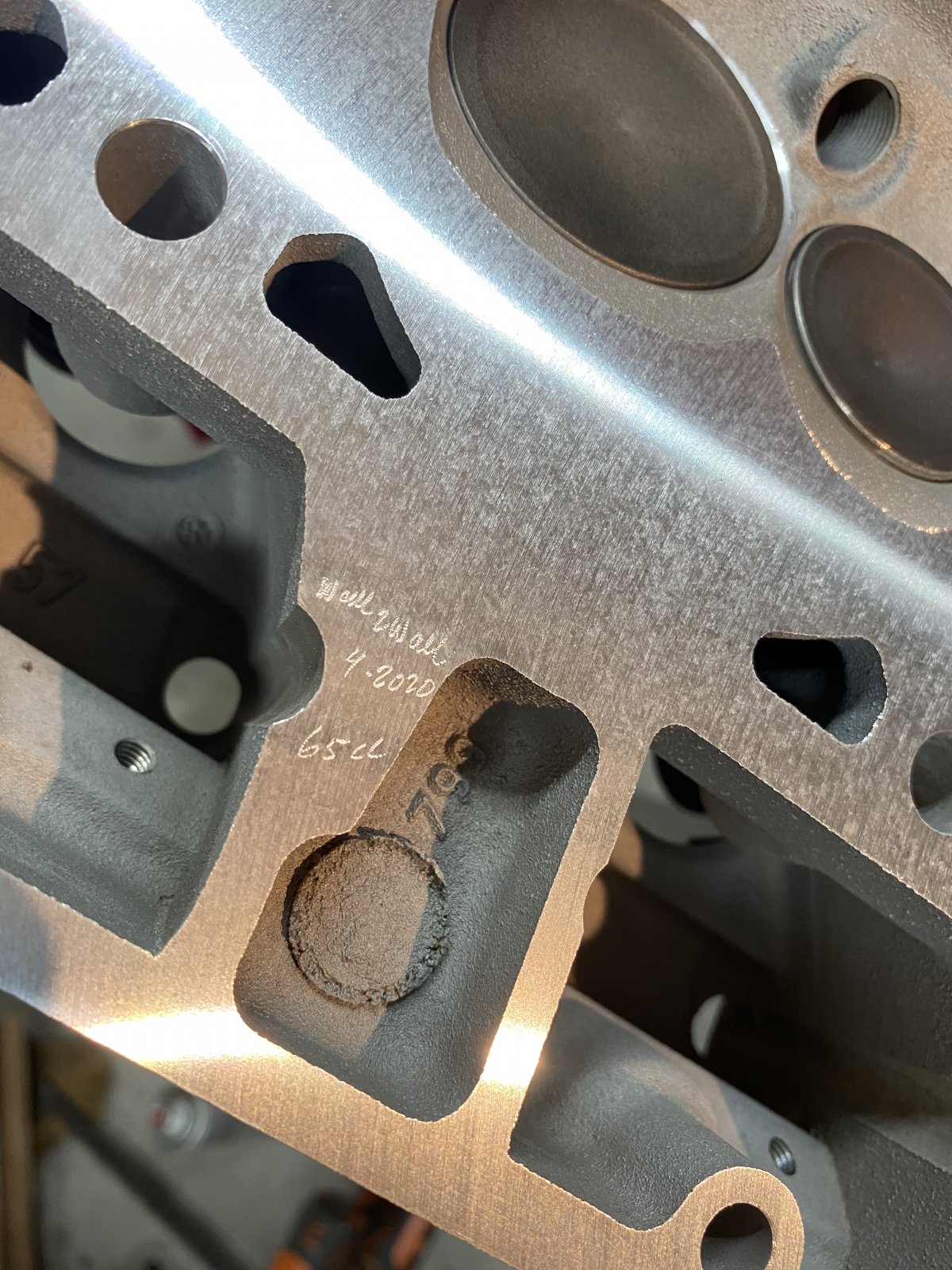

Picked up the heads Monday a week ago. The Cometic .045" head gaskets were delivered the Saturday prior.
They're actually really smooth. The camera exaggerates the cut grain.
Been too busy to make any progress. I did bolt a head down with nine of the old bolts- three at each end and center, on an original stock gasket to try to measure for pushrods. It was late and things weren't adding up, so I left it and haven't had a chance to get back to it. After pushrods are ordered, I'll clay a chamber to check PTV clearance. Finding modeling clay has proven to be a task at this time. I'll probably end up ordering from Amazon.

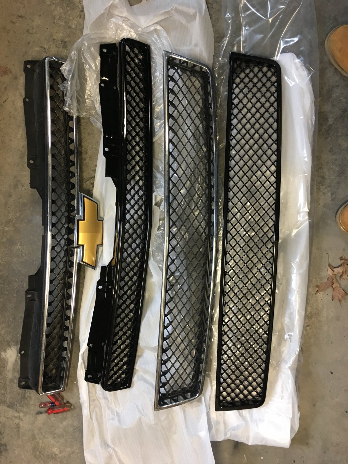

Looking forwards to seeing it on your color truck. Is the grill plastic or metal?
PG01
Nov 6, 2016
15,849
21,628
Up here to the right
Do you still have the box? How much for your old one? I hit a crow last year and my JB weld job looks like hell.
Yeah umm, im one of those morons that saves oem parts to put back on in case i sell it.... but then sell the vehicle and still have the oem parts sitting in my garage ..... i can sell you the oem tail lights/door moldings/badges/chrome tag lights/lock closeout off my ‘01 hoe if ya want...or you can wait a few years for me to sell the ‘13 and ill gladly sell you the grille... sorry bud
