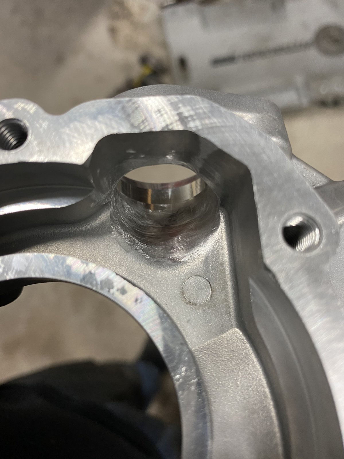

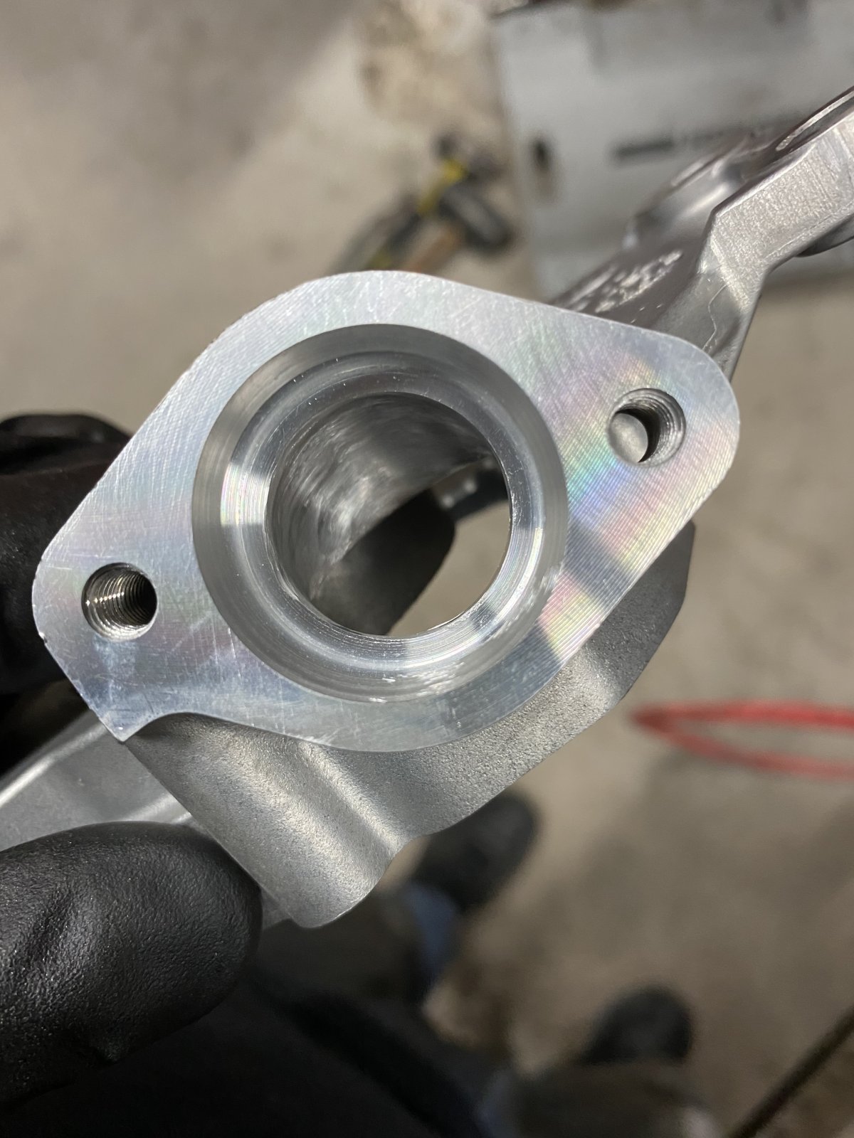

I cleaned up the oil pan, front and rear covers, and intake manifold to finish my outside work. Back inside, I went after the oil pump to port it. I practiced on the original pump to get a feel for it and learn what NOT to do.
Removed the step and smoothed the transition on the inlet:
I may see if I can round off that left side a little better, but it's really not so necessary since it's the inlet and, therefore, low pressure side. Regardless, this is a huge improvement over stock. I didn't take any "before" pics, but you can Google them if you want. There's a rather obtrusive step just ahead of where the pickup tube ends:
The bigger benefit is opening up the outlet and smoothing that transition. It may not look like much here, but compare it side-by-side to stock and you'll see how much better this is. The metal isn't anywhere nearly as rough as the pic makes it appear. I rubbed it with my bare finger trying to convince myself that it needed finer sanding, but it's actually really nice:

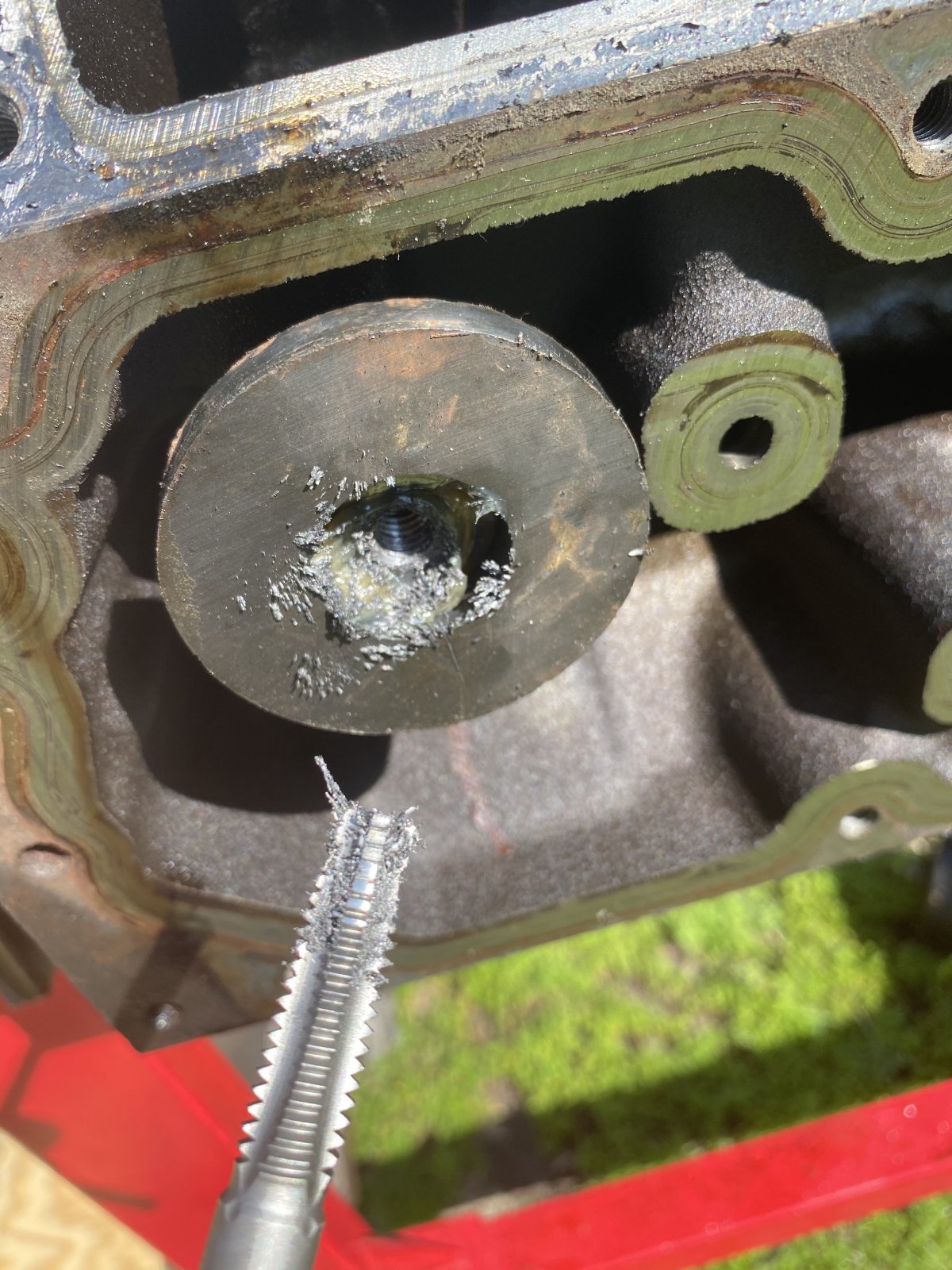

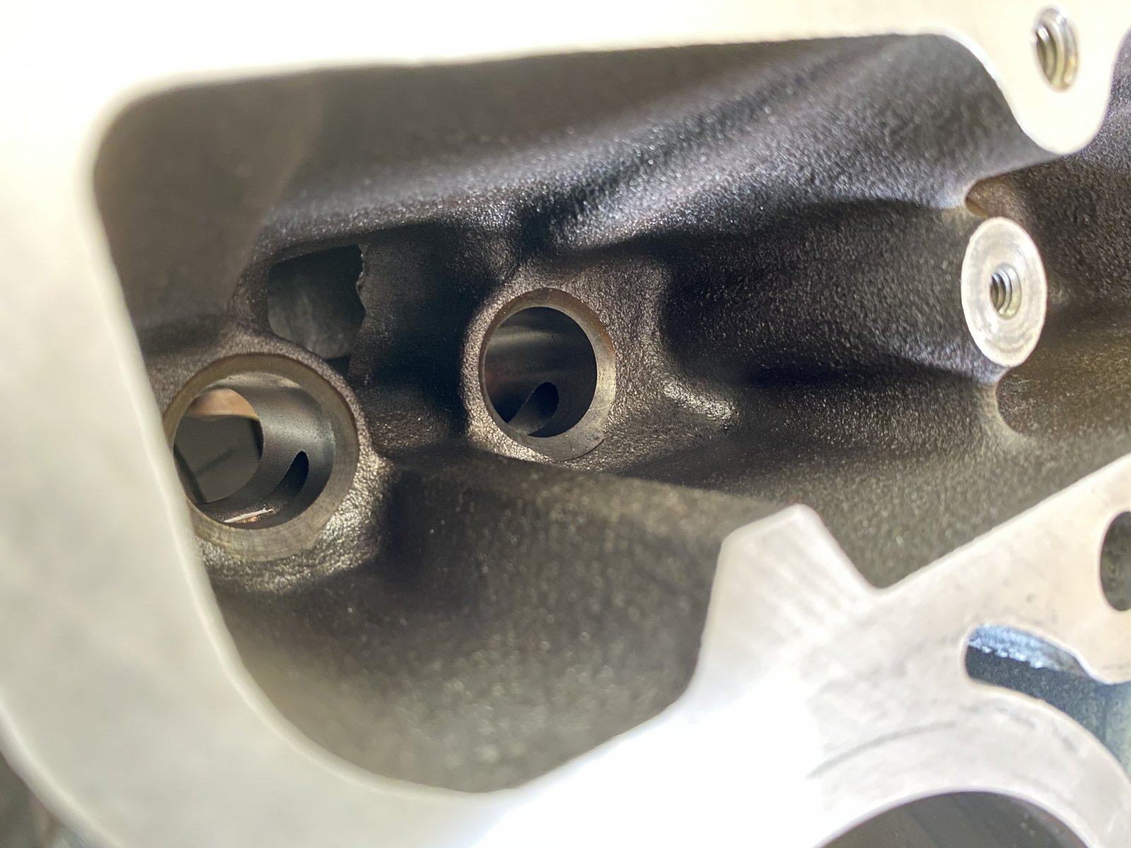

Started by rolling it outside to do the dirty work. Turned the block sideways on the stand, stuck a donut magnet to the AFM towers and tapped the galleys with a 3/8"-16 tap dipped in axle grease. This size is ideal since you don't have to drill them- the galleys are already the right size for this tap and the iron taps really easily. Before I removed the magnet, I slid it in circles around the hole to catch more shavings:
Blew the tapped galleys out from the inside with my high-flow blow gun, sprayed them with brake cleaner, then another blast from the gun. When I rolled the engine over to do the other towers, I did so that they faced downward so if there was any speck of loose metal, it would fall out instead of in:

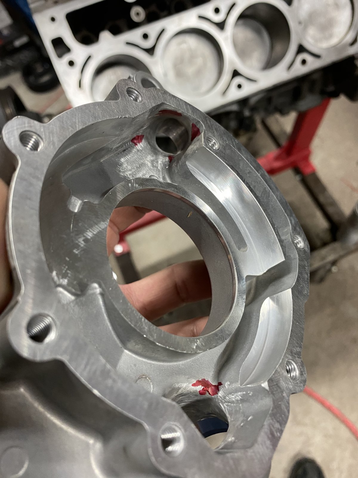

Took a closer look at the oil pump last night and marked some areas I want to improve:

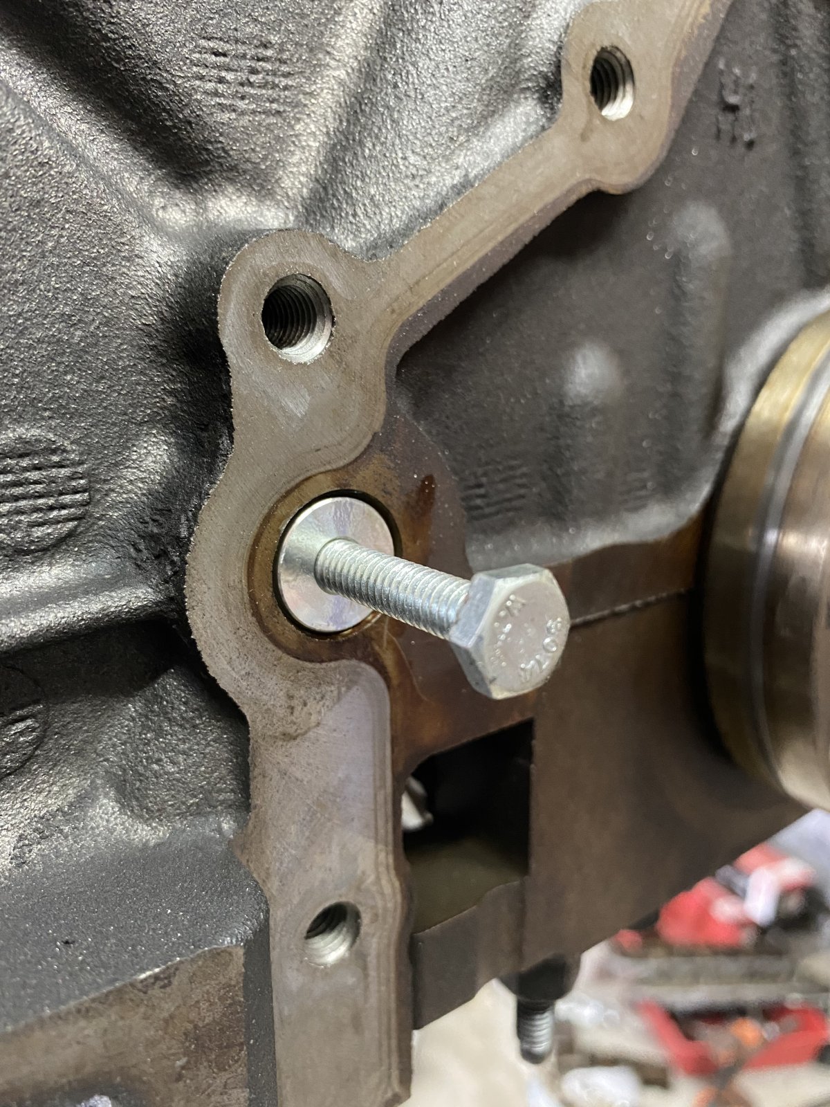

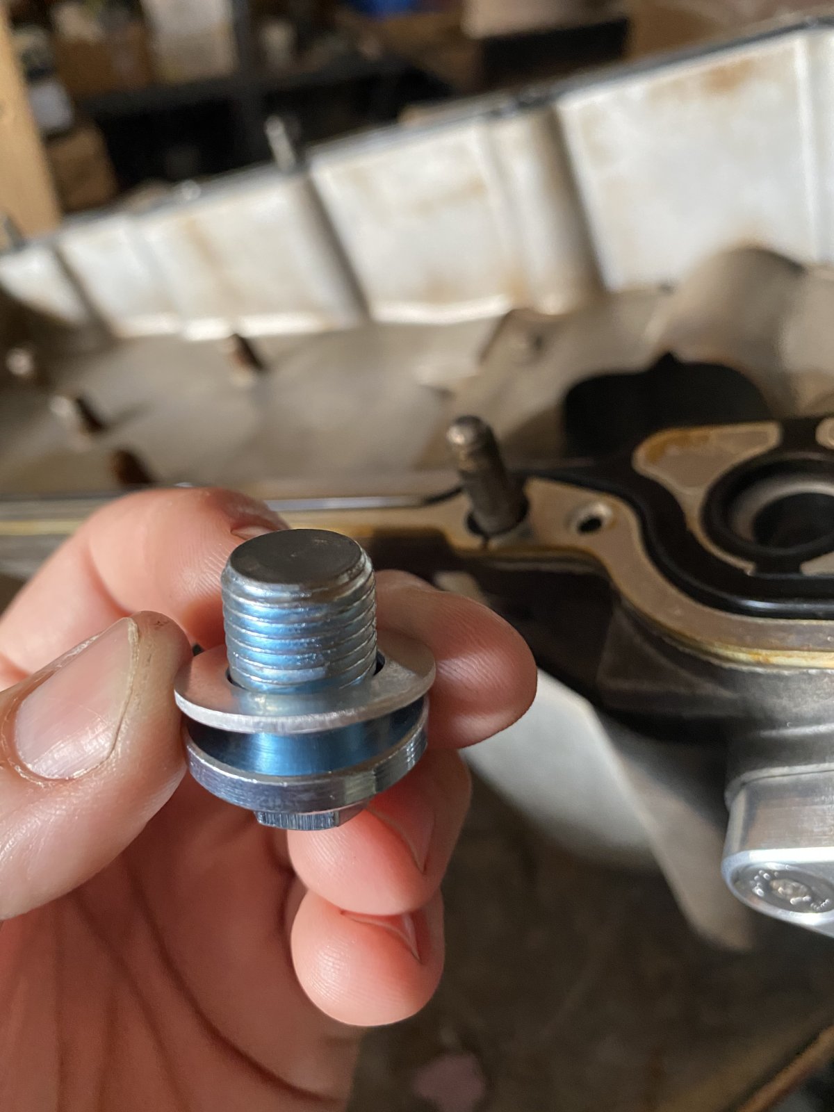

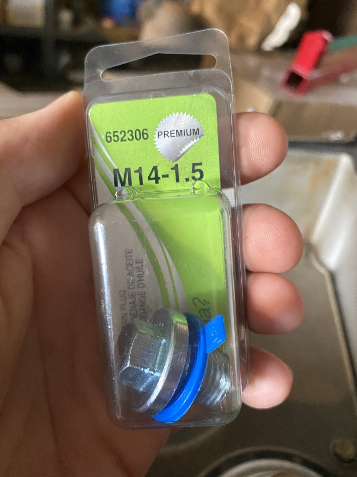

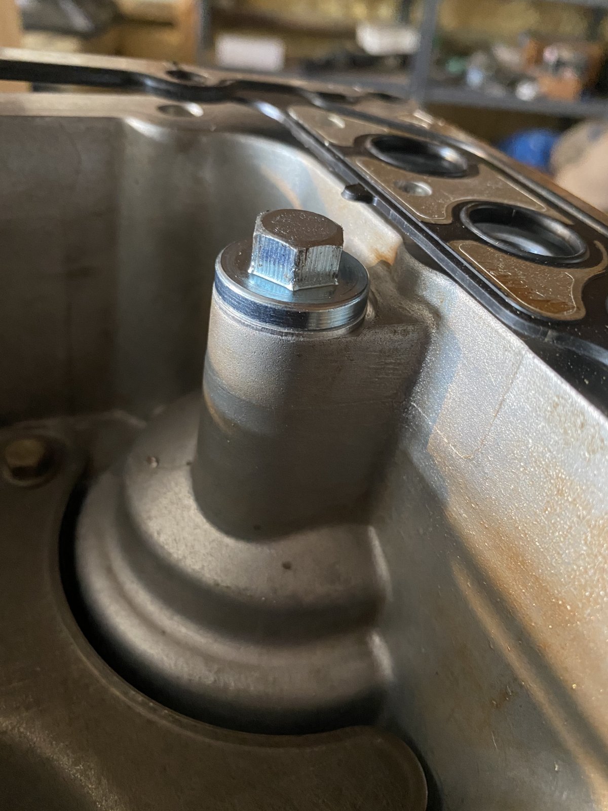

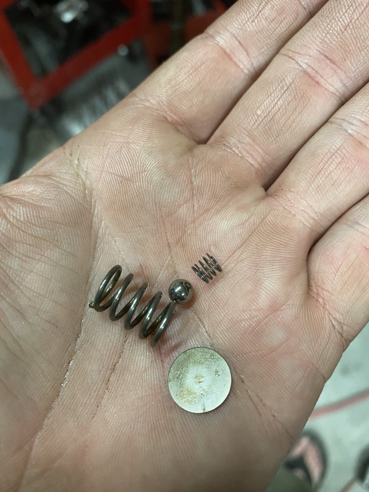

Had a service call at an Autozone today so I grabbed a bolt (oil plug) to replace the AFM oil pressure relief valve in the oil pan:
I used an aluminum washer instead of the plastic one that came with it:
Torqued into place with red Loctite. Looks like it was made for this purpose:

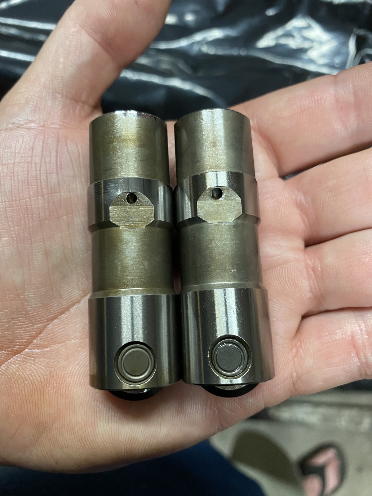

With all the counterfeit parts being sold online, I had to compare the new lifters to the originals. Either these are an impeccable clone or they're genuine. The new ones mic'ed .001" larger diameter, so I'd say it's just that the originals are worn down .0005", given their age:

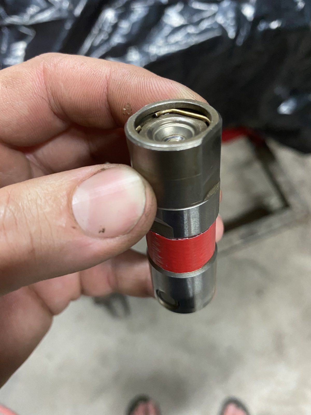

Took an old lifter apart and removed these parts:

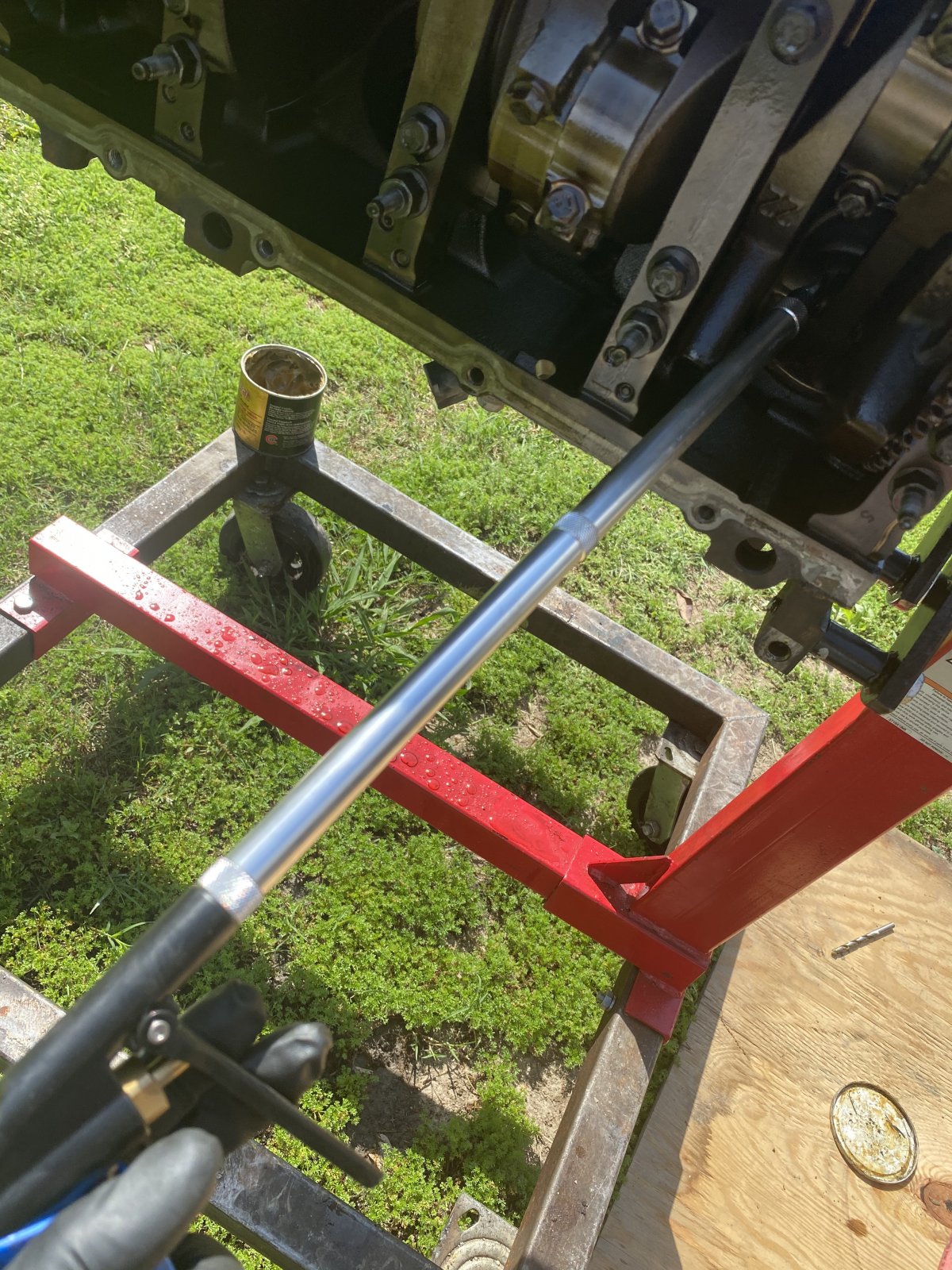

...and reinstalled the internal plunger inverted to make a solid lifter for measuring the pushrod length. I marked it with red duct tape since it's now a tool:
Installing the Sac City billet barbell:
Screwed a 1/4"-20 bolt into it as a temporary handle, lubed it up and slid it in while turning it to ensure the O-ring went in smoothly without binding:

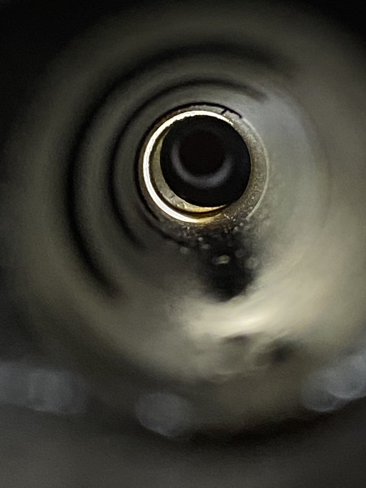

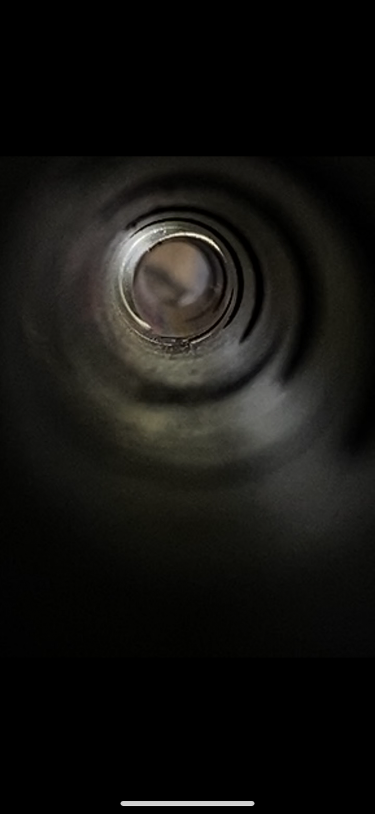

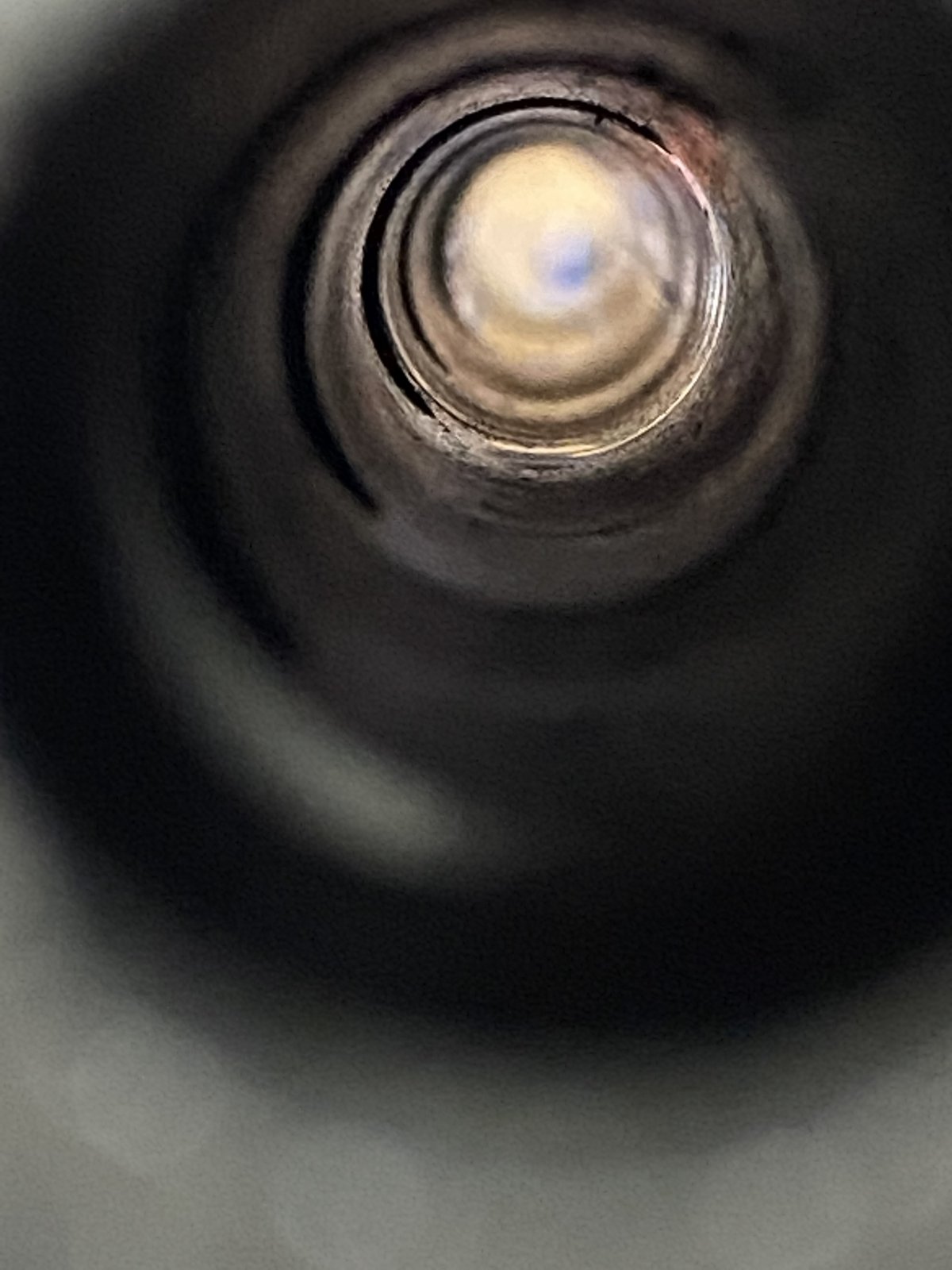

This was interesting. I guess the oil galleys that feed the lifters are drilled from the front and back and meet up in the middle instead of being drilled all the way through from one end. Something was a little off when they drilled the left side galley as they don't exactly match up. This created a crescent-shaped reveal midway in the galley. This is the LH galley as viewed from the front:
...And as viewed from the rear:
The RH galley is aligned:

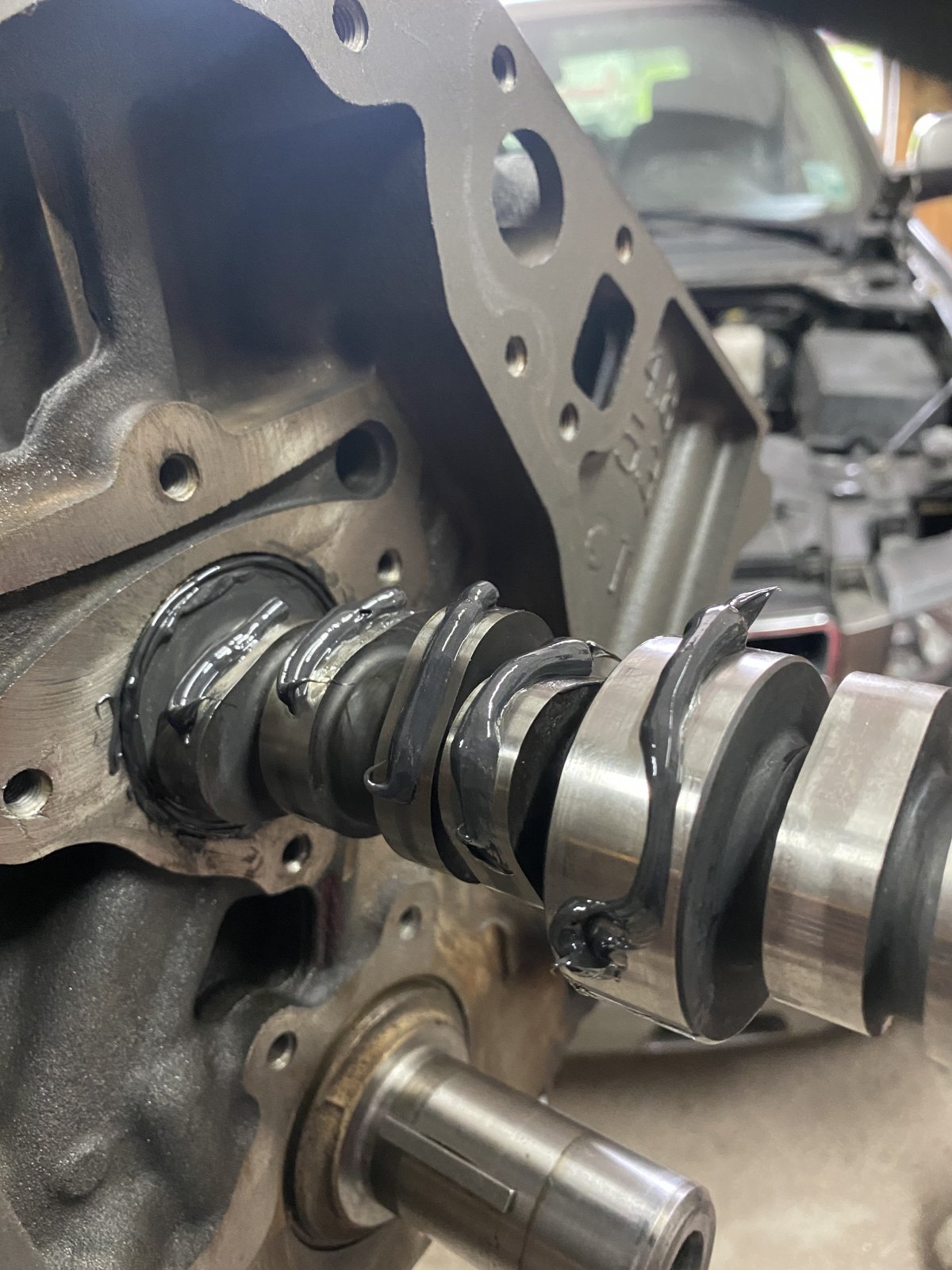

Slid in the cam with lots of assembly lube:

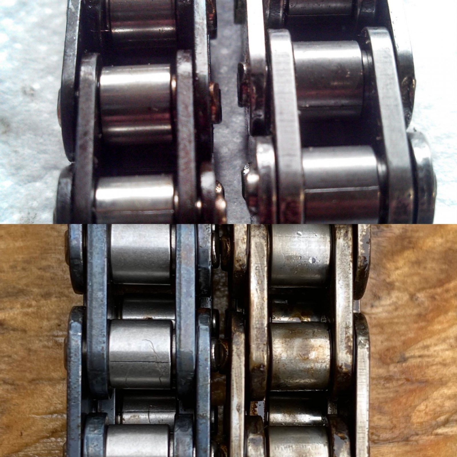

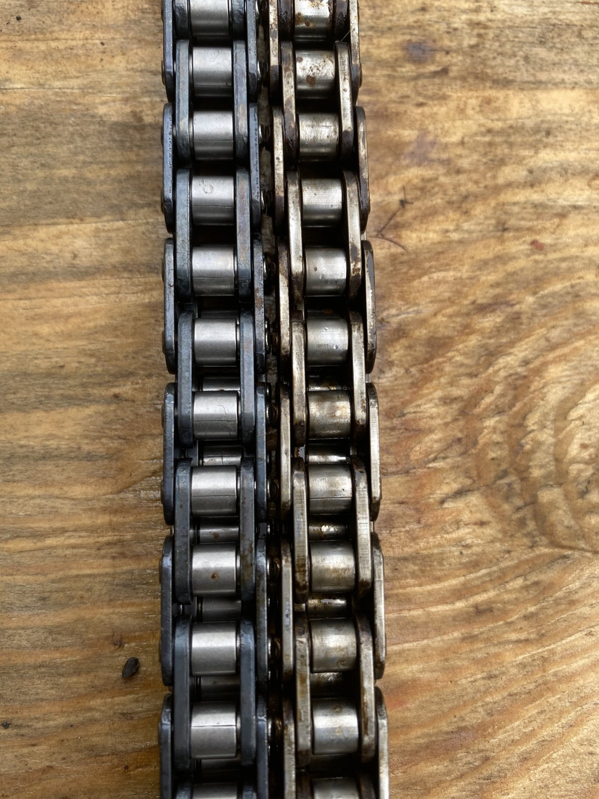

Speaking of counterfeit parts or just not getting what you think you ordered, I compared the supposed LS2 HD chain to the original. It looks and even measured out to be the exact same. Either the LMGs got what we call the "LS2 HD" chain or they just sent me a standard replacement. I hope it's at least a quality part:

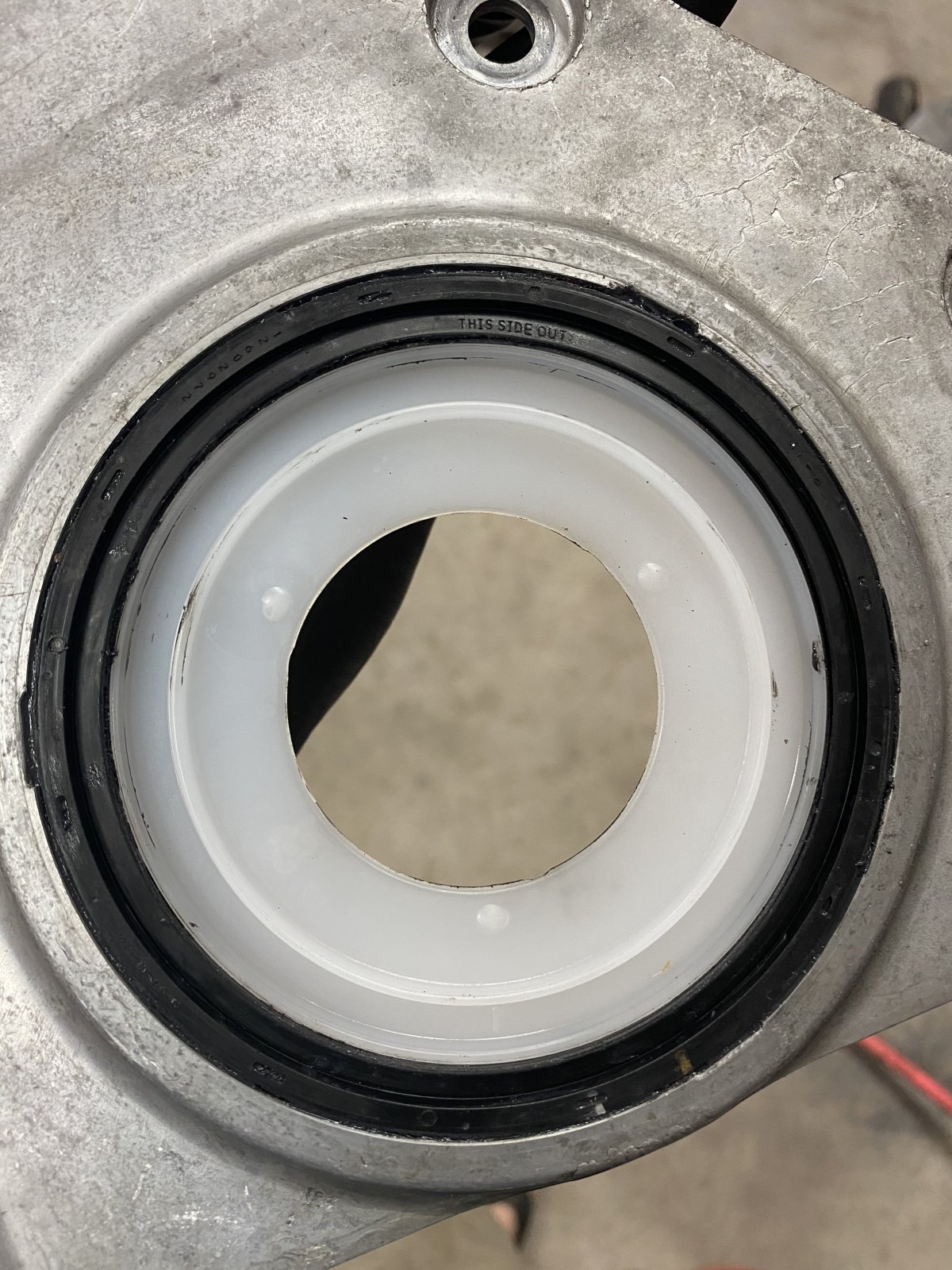

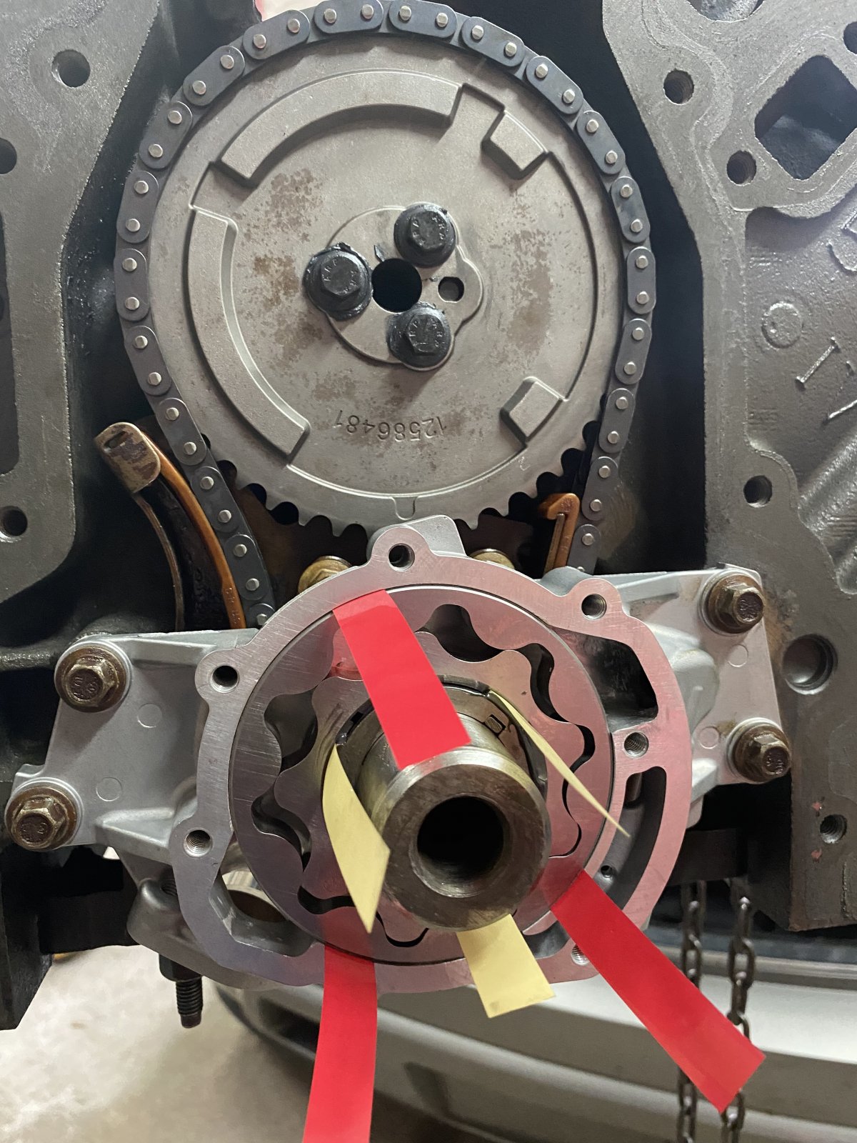

Timing set installed with Loctite on the bolt threads and ARP lube under the heads. I may be crazy for reusing the original timing chain tensioner, but I like it better than the LS2 dampener since it keeps constant pressure on the chain. I figure if these things are going for 300K+ miles on the original equipment, then I should be good for a long time. I would've liked to use a new one, but I had to get this thing assembled. I feel okay with it. After shimming and torquing down the oil pump, I packed the rotors with assembly lube and installed the cover. Also lubed the timing chain before installing the front cover with it's new crank seal:

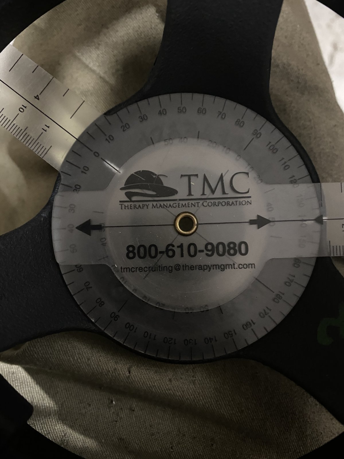

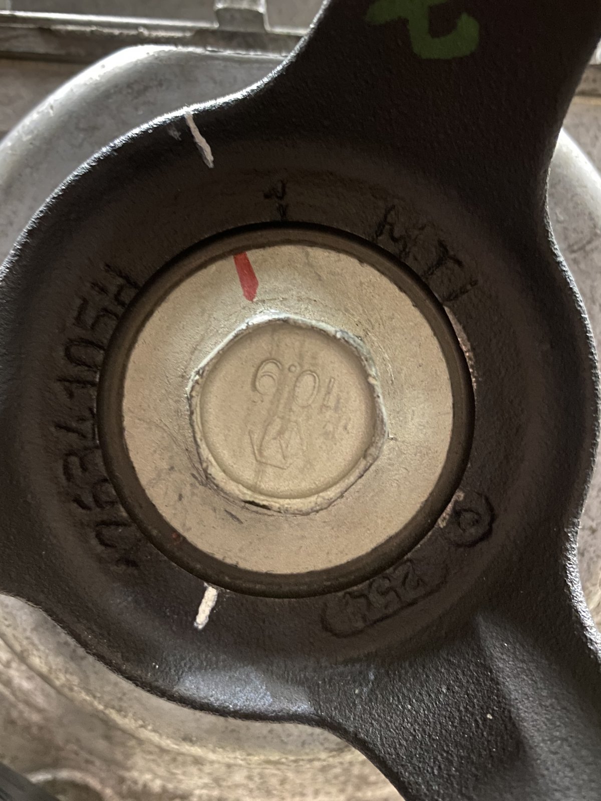

I have this protractor intended for measuring a physical therapy patient's range of motion. It fits perfectly in the center of the crank pulley so I use it to make my torquing marks:
Used the old bolt to press the new pulley on and tightened it to 240 ft. lbs. Then I measured to make sure it was pressed on within range:
Installed the new bolt, torqued to 37 ft. lbs. and marked the bolt at my "0" mark:
Used a breaker bar to turn it the final 140°:

There's nothing I can do about it now, but I wanted to compare a pic of an LS2 chain to what I have. On top is what someone posted of their chain next to the LS2 chain. Below that is my stock chain and supposed LS2 chain.
I still don't know for sure what I have, but it's no smaller than my original so I'm comfortable with that.

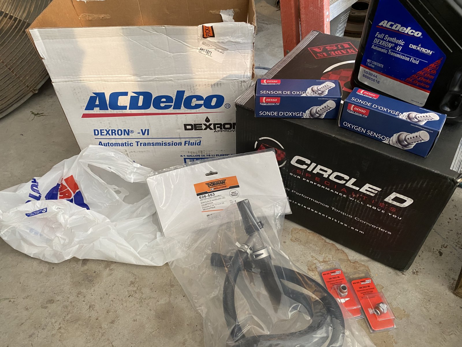

Four gallons of full synthetic Dexron VI ATF and two upstream Denso oxygen sensors delivered today. On the way home, I ordered and picked up the Dorman heater hose assembly for its aluminum "Y" and two adapters to connect the stock transmission cooler lines to the external cooler that's en route.
I also ordered some other parts that would be really cool unless they don't work as planned for some unforeseen reason. I'll hold off on the details for now.
Still need to order the upper and lower rad hoses.
