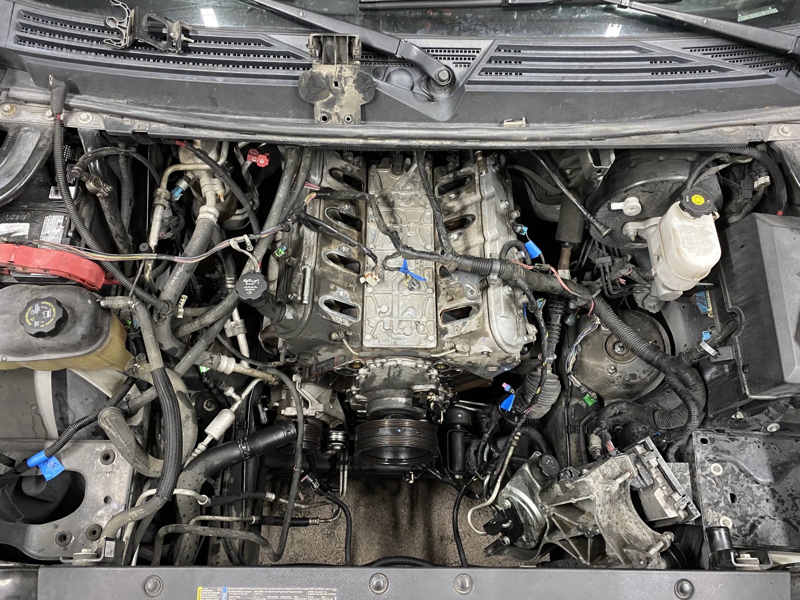

As of last night:
Battery disconnected
Oil and coolant drained
Belts removed
Fans removed
Harness completely unplugged
Intake manifold removed
Water pump removed
Alternator removed
Accessory bracket and power steering pump unbolted and moved to side
Starter removed
It'll be ready to come out after the A/C compressor/bracket, mounts and bellhousing are unbolted. I'm gonna see if I can get the top four bellhousing bolts with the heads in place and not through the bottom with all the ratchet extension acrobatics. If it takes too long, I'm pulling the heads. Tonight's goal is to have it on the stand and maybe running the compression test.

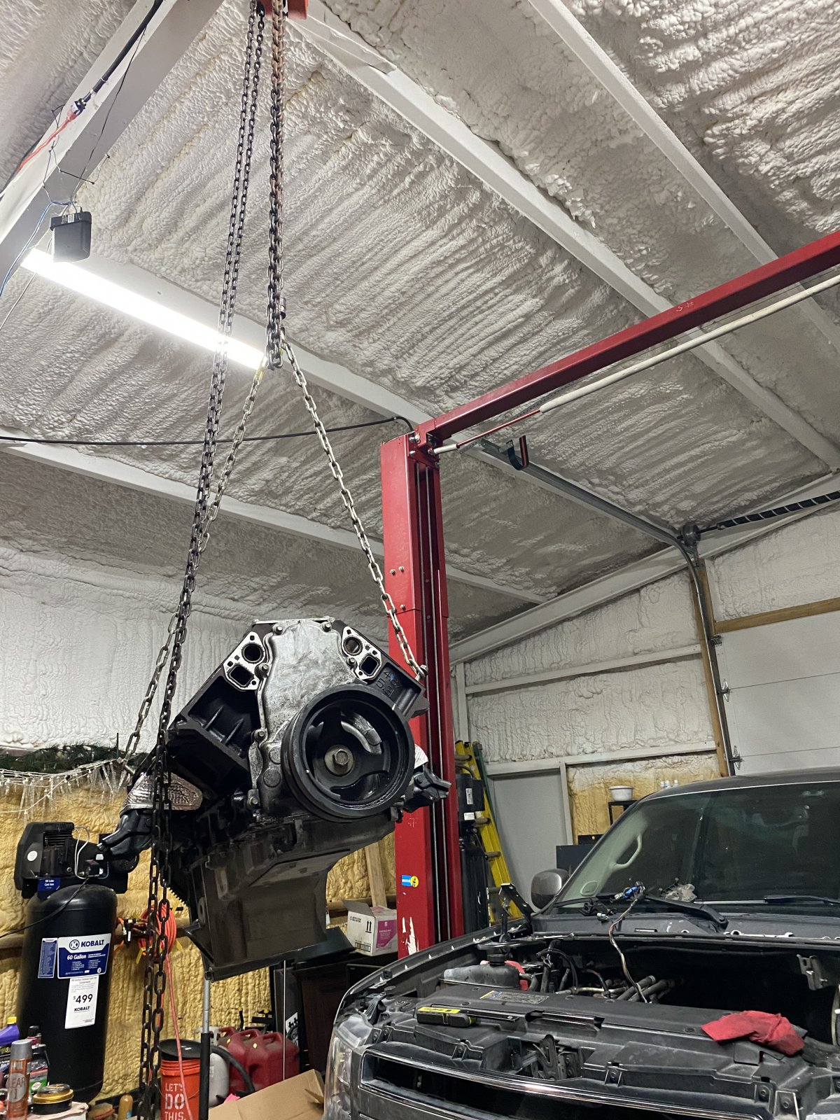

Lifted motor until it's weight was almost completely off the frame and gave it a few tugs and wiggles forward to separate it from the trans
Lifted motor a little, rolled Tahoe back a little, lifted motor a little more, rotated it sideways and pulled it out
Lowered motor and bolted it to the stand

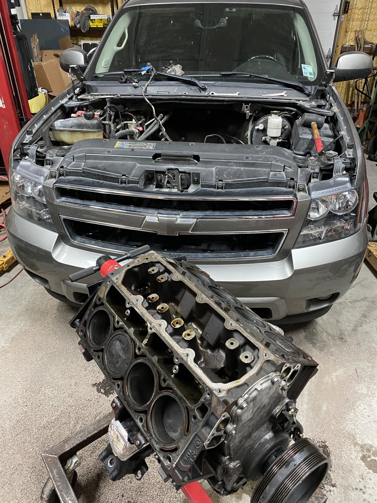

I wasted too much time trying to access the top three bellhousing bolts with all the extensions and wobble socket circus acts, so I defaulted to pulling the heads and removing those nuts and bolts with ratchet wrenches.
The head gaskets stayed in place, so I wiped them down, cleaned out the bolt holes and reinstalled the heads using the original bolts and just torquing them down with my 3/8" impact. Zipped the starter in position, screwed in the compression tester and hit the starter terminals with the jumper cables. I gave each cylinder 6 pumps each. All cylinders were 210-215, and this was on a cold engine sitting on the stand. They all held pressure, too. I thought for sure it'd have a much larger variance and expected #7 to be lower than the others. Nope. All good.

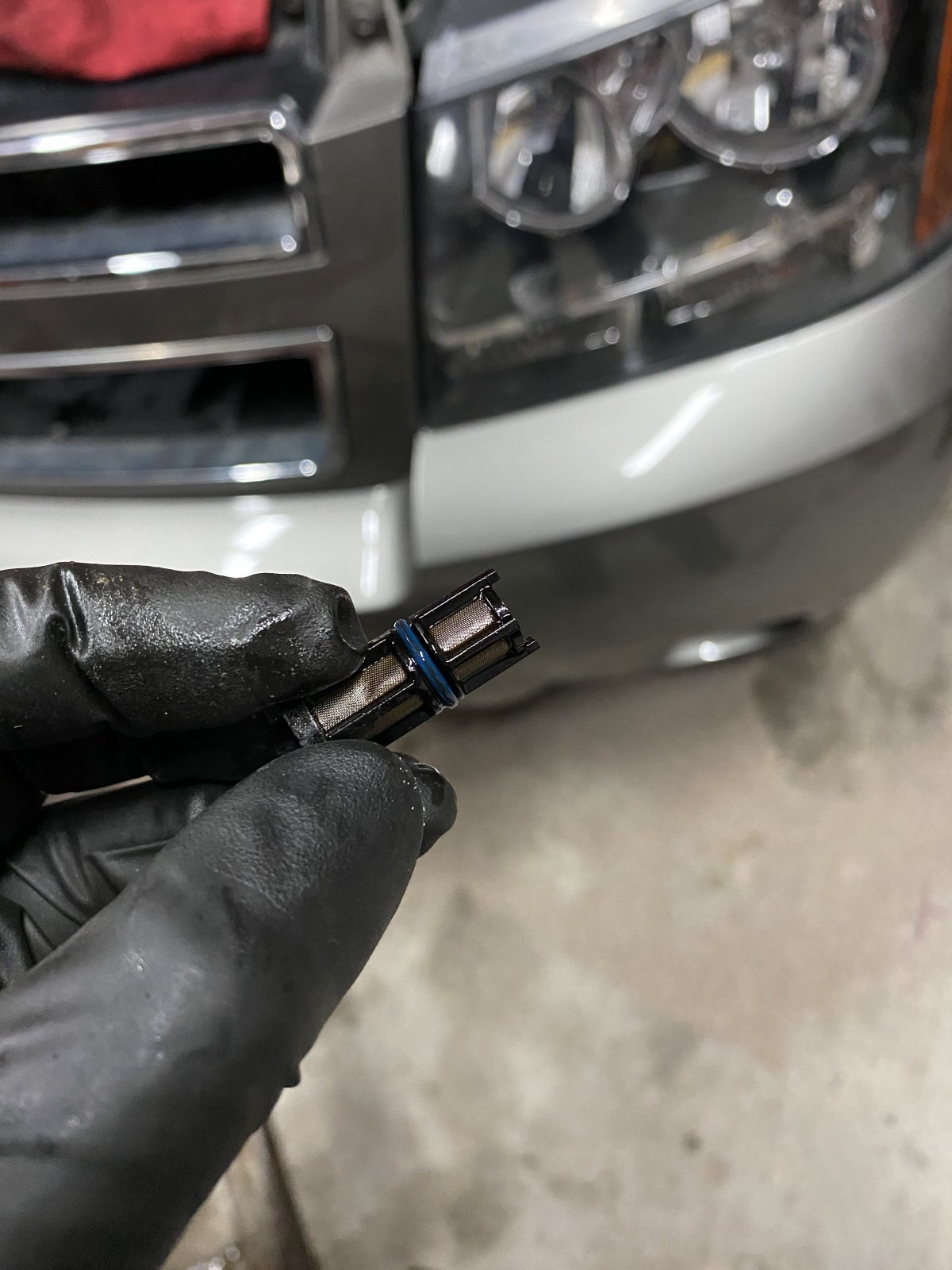

It's hard to believe this is the original engine. I know for sure the VLOM has been replaced (dated 2014) but I don't know about the lifters. I know the oil pan was off, probably to get the AFM relief valve shield. I'm trying to find a date or date code on the block and heads.

The screen under the oil pressure sensor was spotless, just wet with oil:
All the piston tops looked to be equally cruddy. I was expecting the rear two or four, and especially #7 to be noticeably worse:
Cylinder walls looked good. This is #7:
