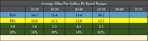

This is my truck's average fuel economy burning E10 versus E85 since 2017 and the differences between the two calculated. As one can see, the difference is a lot less than claimed.
Been playing around with alcohol content and R+M octane rating calculators for some time now. I too read that E85 is claimed to be 103 octane, 113 octane, etc. Many different states and governing bodies have also tried to assign octane ratings to the lower ethanol content numbers and whenever I've made a calculator, the numbers never jived. Until recently! Sunoco markets E85R race gas which is a full 85% ethanol. Street legal never gets higher than 83%. Anyway, the important part is, the cans are marked 99 octane. So when I used that number and made a calculator, it jived much closer to what folks tried to assign to E20, E30, E40, etc.
So having said that, if you get a winter blend of 71% ethanol, the octane rating of that fuel is actually 96.8. If you get 51% for example, the octane rating would be 93.7. Of course if you mix some grade of ethanol with 87 or 93 you'll drag those numbers down. Figuring it out all is tough here because we never know what is coming out of those fuel pumps, even Racetrac has been off lately and our governing body is more interested in running for office than doing her job.
