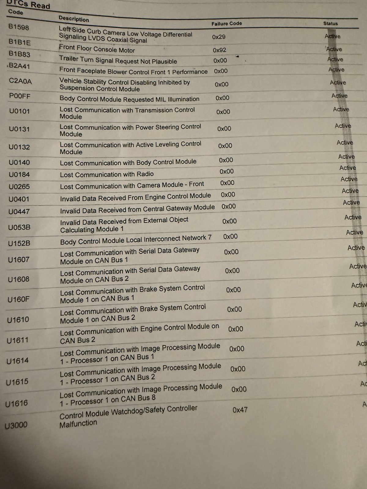

Jigitz
Feb 27, 2023
I had this update done and after that I have had about 20 different codes pop up and my camera on my right side mirror stopped working for a few days after the update. It came back so I did t bring it in.
My CEL came on on Thanksgiving and I brought it in and that’s when they found all of the codes. I found a thread on the gm-trucks forum and it’s 13 pages with complaints some of which are tied to the infotainment. It could have just been done poorly by the dealer too maybe it all of these issues only started with the update.
My car is with the dealer now and they are unsure of how to resolve this. I’m thinking the update was applied and it was corrupt and/or there is some issue with the code itself. It’s a 24 Tahoe High County Diesel.
My money is on a bad battery in your truck. Perhaps they didn't put a battery tender on it when updating? Perhaps you just got bad timing. With all those Comm errors...my guess is low voltage.
