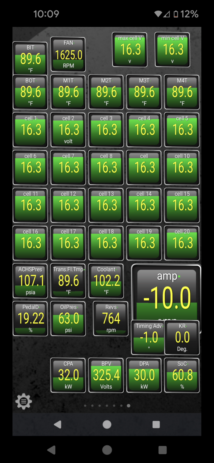

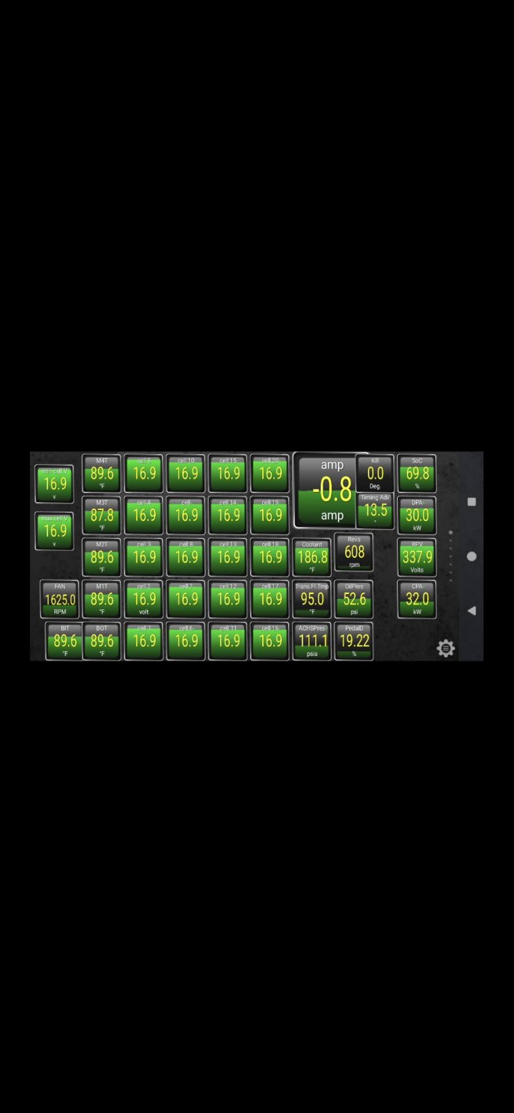

the clone tech 2 that's about 300$ work well with these trucks.
I do use the torque phone app pretty often to keep an eye on battery stuff. gotta add the pids but it's handy. not much for trouble shooting for your case thou.
a volt meter and some of the back probe pins/needles for it are very helpful too. they are thin enough you can slide them thru the back of plugs along the wire and test at the pin while plugged on without damaging the seal or wire. lot of trouble tree diagnostics ask for voltage at pins.
j91z28d1
Feb 28, 2022
4,655
5,900
just curious what you rebuild the battery with? not that I think it's related. Just wondering

your tech 2 will do everything needed. even a 5$ torque phone app will with the pids added and a 30$ Amazon dongle. it will log to an excel file if needed.
this is what my setup looks like. I check it every few days it so out of curiosity.
