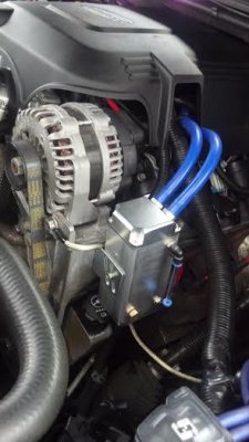

If you over tighten them the O ring will push over and cause a leak. Also, I have the same catch can and they are really easy to baffle. I ran a hose from the valve cover nip down almost to the bottom then bent a piece of mesh like a table so its about in the middle of the can and then cut up the green scrub sponge to lay on the screen/table thing. Now oil runs down the hose and the green scrub pad catches all the oil droplets.

That's a good lookin catch can
