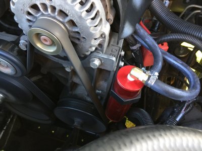

Just got mine today and installed it. I didn't have a suitable bolt so I used a tap and die to add a spot on the side of the alternator bracket. Pretty easy mod, lass than 1/2 hour total for mine. IMG_4770.JPG IMG_4772.JPG

I thought they mounted where that bolt is already there? What size bolt I need to mount it? I didn't get one.
52,954
That ground bolt that's already there wouldn't work on mine- the catch can would have hit the power steering pump. No hardware is included with the can- I had a M8 x 1.5 mm tap and a bolt that fit those threads laying around. You might be able to get a nut on the back if your fingers are small enough so you wouldn't need to tap threads. You'll just have to look at yours and improvise.

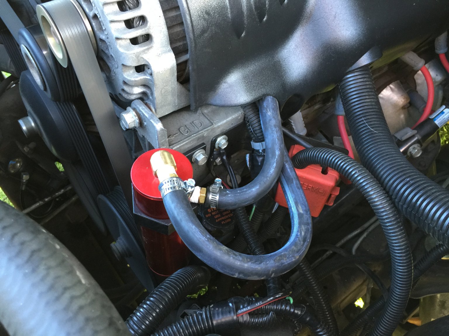

Catch can installed. I wish I would have made the hoses a bit longer though. I think one may be slightly pinched but doesnt seem to affect anything. I didnt think to cut them long enough to come out of the cut out in the plastic cover. So one is tight coming around it and going back to where the master cylinder is. Anyone think this will ever be an issue?
52,954
I would replace it if it looks pinched at all. Hose is cheap and your PCV system is important.

Not collapsed pinched just bent slightly

This is what it looks like. Maybe Im wrong on it being pinched and this is fine. What does it look like to you guys. I mean to me the bottom looks worse than the top but there is actually a bit of room around it.

Replace it. It's restricted. It will take you less time to replace it than to keep asking questions and posting pictures. Again, replace it. Or keep worrying about it. Either way. I'd replace it but....up to you of course.
