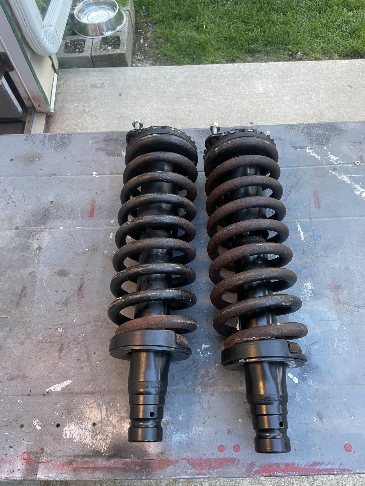

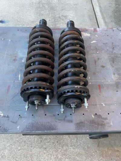

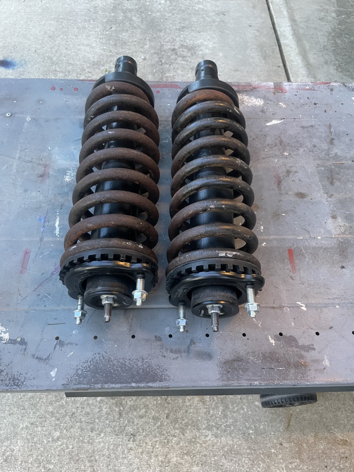

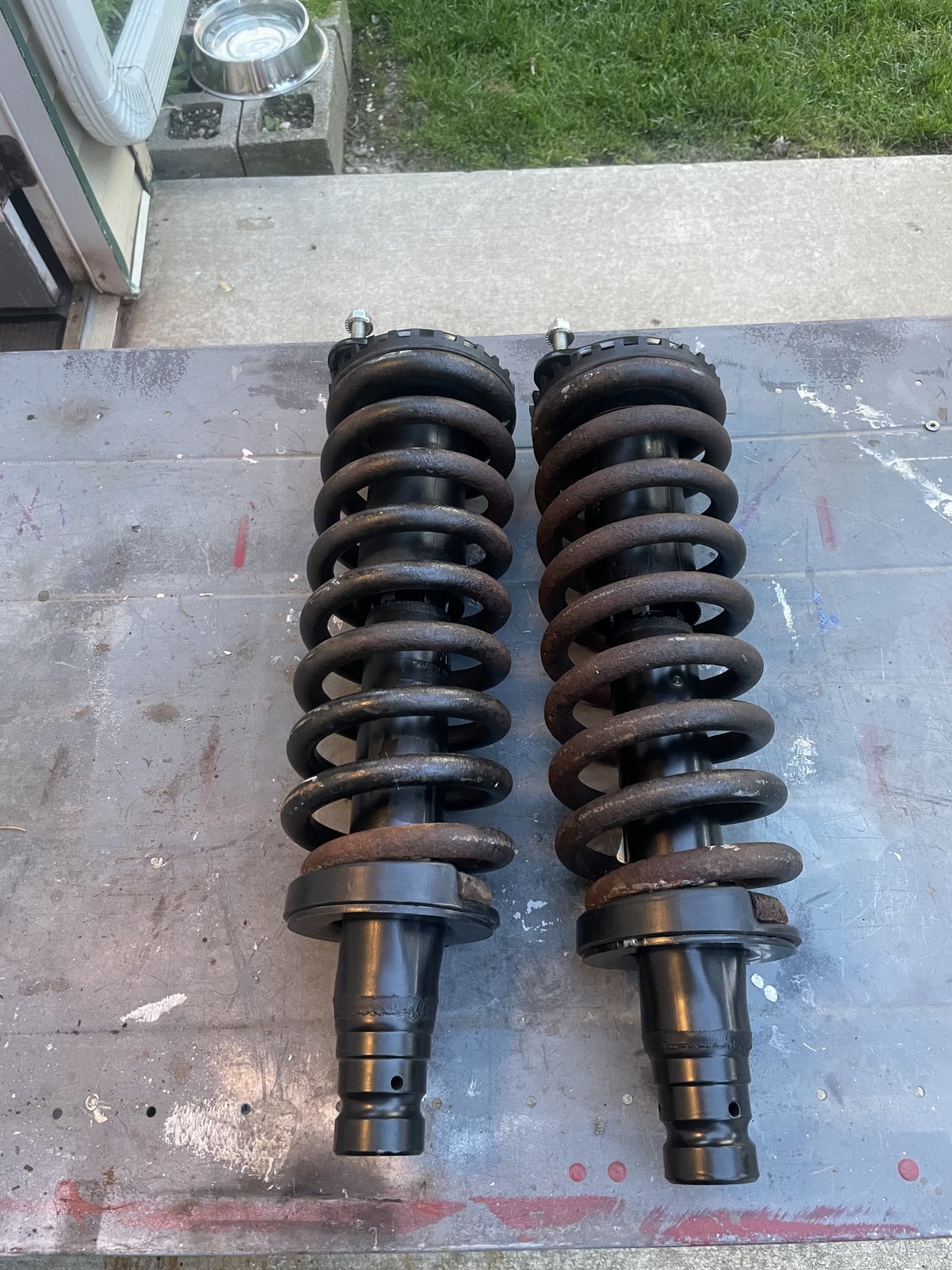

Pulled apart the used struts to get the springs off. The compressor works ok. Thinking I will need some new upper mounts too. The ones from the junkyard struts are junk and I don’t want to try to save the ones from the struts that are on the truck. I will just assemble them complete and then swap them over on the truck.

Now that I am this far down the path of a spring change I notice the Moog 81114 springs on amazon for $90 a pair. I have the used struts all pulled apart and the springs ready to go onto new strut bodies. And, I don’t believe it’s worth a return to the salvage yard even if I reassembled them.
I am usually pretty good at searching for stuff on the web but I missed on this one.
I did note the springs I got have nine coils and the ones currently on the truck have eight.

I dunno. I know we aren’t planning to keep this truck for too many more years but I sure would hate to put another saggy pair of springs on this thing. Heidi would be upset with my cheap ars. I am considering trying a return of the salvage yard springs and ordering the Moog ones. I went out in my jammies and reassembled the struts. Took me 20 minutes including cleanup. I will call the salvage yard when they open.
