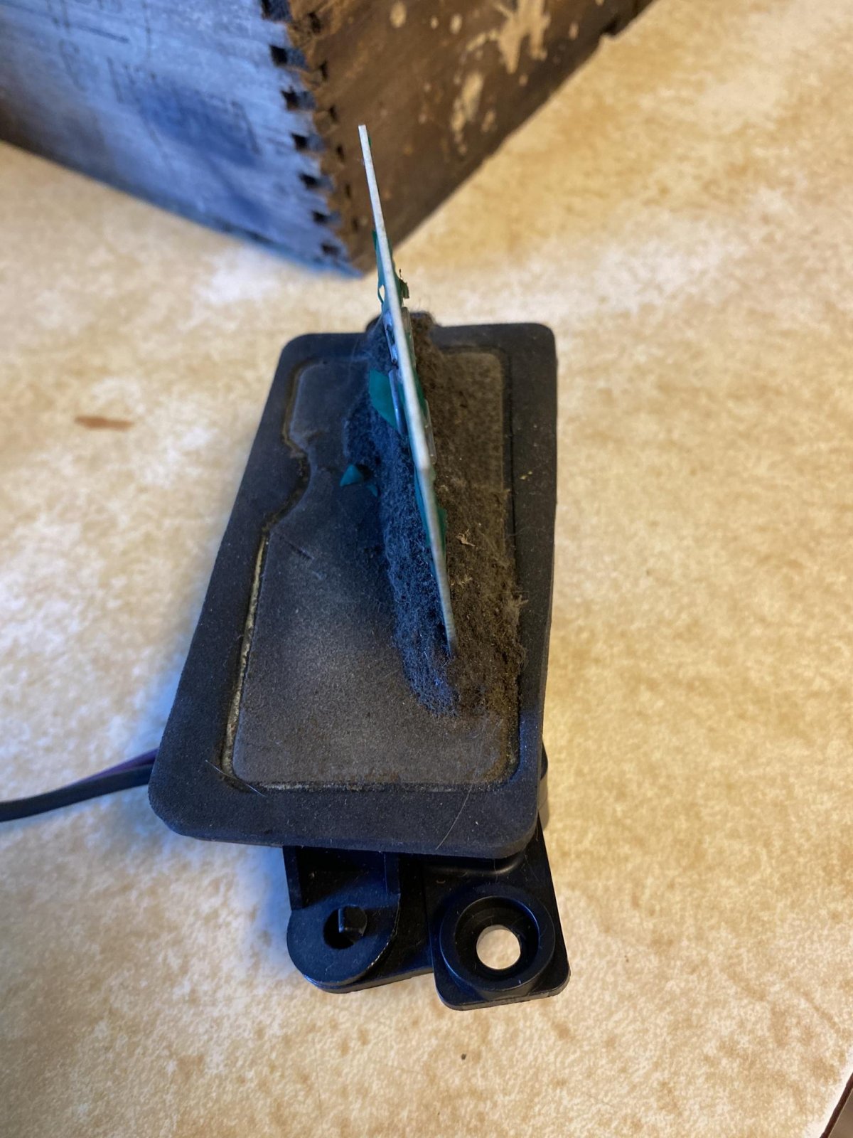

Alright gents. Have some updates. I tried a bunch of different sockets and low and behold the third 7mm socket I tried worked on the kick plate bolts. I only took two out and just spent the entire time kneeling on a towel in my gravel driveway hating life and pushing the semi flexible kick plate out of the way. I swear to god if you ever wanted to do the retrofit cabin air filter1- don't, and 2- take out more kick plate bolts. I did watch a youtube video where the guy used a bungie to hold tension on the kick plate but that would still suck in my opinion.

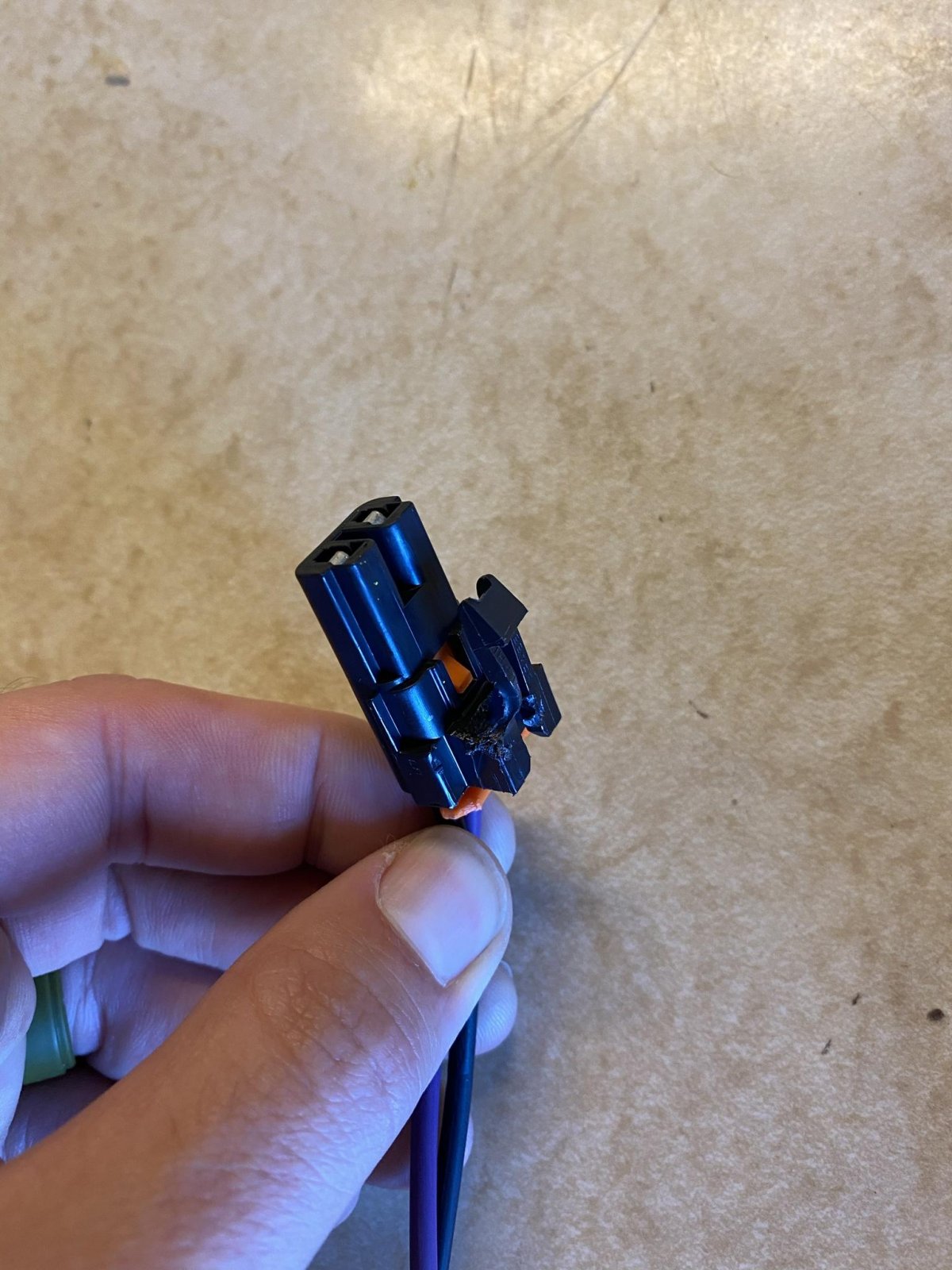

Everything else went smoothly with one exception. The plug that snaked around to the back of the blower motor was a royal ***** to unclip I tried many different angles and screw driver blades to get it to unclip but finally just brute forced it. The new clip went it and clicked so at least I didn't damage the female end on the blower motor. I dont think the video I watched on 1a auto where he changed it in a suburban the blower motor clip location looked the same but maybe it was..
Now every speed on my blower works! A few images for your entertainment.
Look at this crusty boi
My handywork on the blower motor clip on the old resistor
Lastly a little easter egg found in the kickplate!
