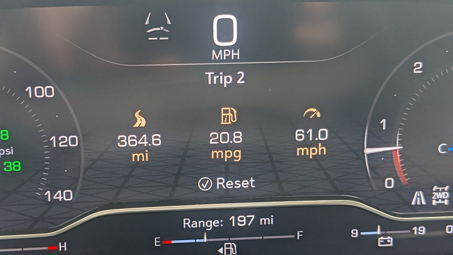

Fuel economy on these bricks starts to rapidly diminish over 65 MPH. The problem is when people are pushing these bricks at 75-80 MPH, you cannot expect much, this is not how the EPA fuel economy is tested.
Additionally anyone that has a 6.2l is likely using the right pedal a lot to get around slower traffic, just bring up the Fuel Economy display and keep it on the dash, watch what the center portion is showing, you will see what happens on inclines or when the right pedal is used. If the vertical bar drops to around 25% on the fuel economy, you are likely into 80%+ engine loading.
Here a shot of a recent trip I took and I was not trying to be thrifty, I had to meet a deadline. I have done better, but it depends on a lot of factors.
I like to keep a similar screen up in the new Tahoe but it doesn’t have the average speed displayed like in yours anymore. I will continue playing around with the display options but I don’t believe it’s available anymore in the refreshed SUV’s.
I told my wife when she was driving on a leg of our trip to keep it below 82 mph to see what kind of mpg we could get on our 6 hr drive. I also believe people are just driving faster without fully knowing the consequences to their fuel economy especially above a certain rpm or mph in these much taller versions that we’re driving now. Our ‘25 Tahoe towers over my ‘01 Tahoe especially the hood area, I almost need a step ladder to reach the dip stick so as to not touch the fender on the new one.
Rpm and how smooth you apply the gas and brakes makes a huge impact on your mileage plus if you live in mountainous terrain or have a good amount of rolling hills you can expect lower than normal fuel economy but your driving style is the biggest factor in my opinion from decades of driving experience.
