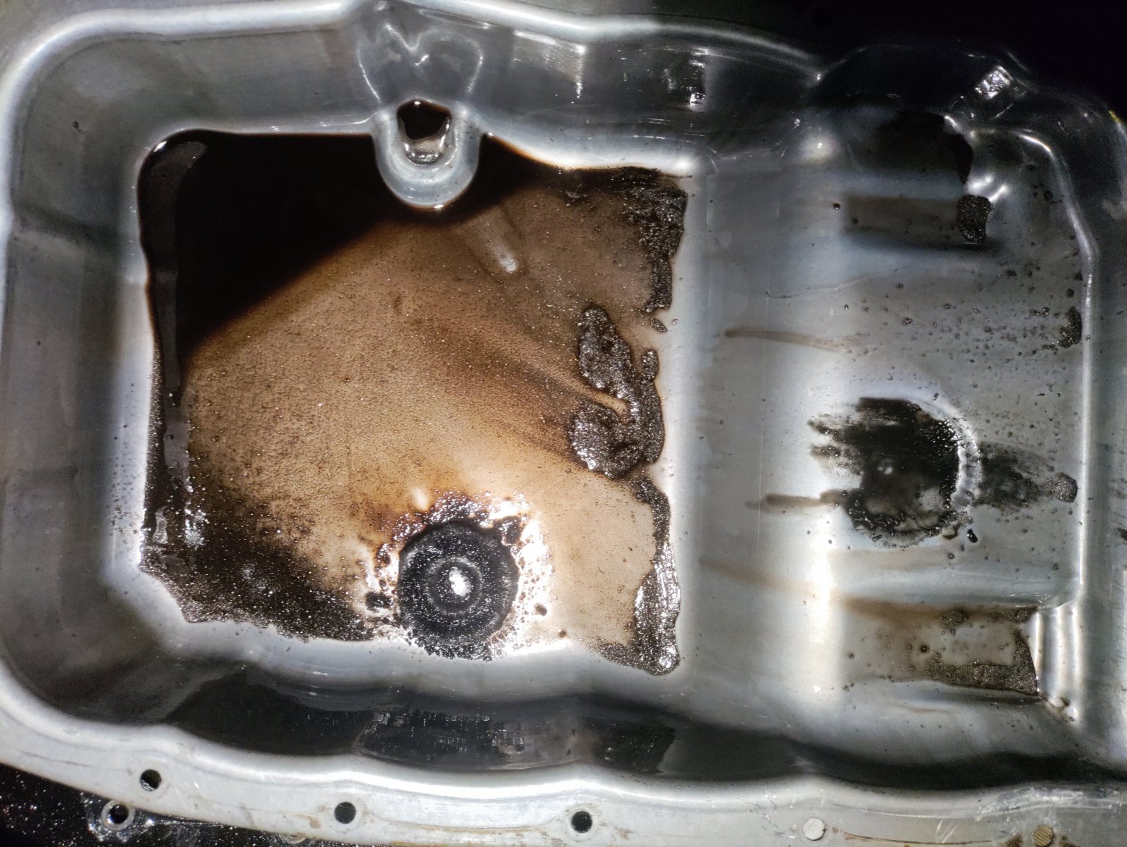

I'm attaching a picture of the pan debris just for reference. I've since been told that the converter did come apart internally and take out the pump and pretty much everything else. The filter was clearly plugged too. I had it redone with a billet converter, upgraded valve body, and some additional stuff. The place I had do it says they have done hundereds of the 6l80s. Hopefully they did a good job.

Yup that pan debris is a pretty bad indicator of a bad failure that will need a full rebuild. Once the shavings are above the super fine particles, then you are into the big money.
Sounds like your shop did a pretty good update with the billet converter and valve body, but you might check with them and see if they did any TCM tuning as well to keep the problem from reoccurring if you plan on keeping the vehicle for a while.
