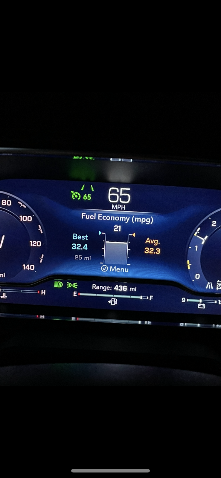

I get about 32 with the cruise at 60 or so, on level ground. 2022 5.3 Tahoe, 4x4.
I am not sure I believe that...you have the distance set at 25 miles, so computer calculating your BEST 25 mile score and your AVG over the last 25 miles driven.
Flip the page to the screen on the current drive or for Trip A, and see what the computer calculates the MPG for over 200-300 miles...
I'd be seriously impressed if your Tahoe averaged 32MPG over a 200 Mile drive...
Agreed. No way will you get better mileage than a diesel. No way. If that is real, GM would buy that truck for a million bucks to see what magic is going on there.

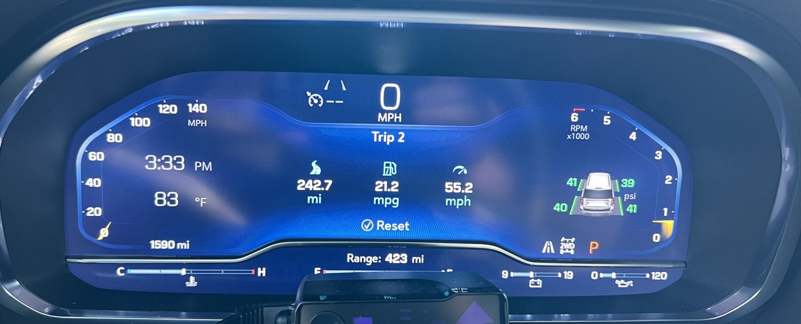

The low-end response I must admit is quite good on the 2024... I haven't driven it much yet since we bought it, but that was my recollection the day of purchase.
Wife is a very conservative drive. Per wife just now...
Our 2024 4x4 with the 3.23 axle gets 15mpg city / 19-20mpg highway... hoping this improves after the break-in period based on previous comments on this thread.
Our 2018 with the 3.42 axle (Tow pkg) 4x2 was used mostly on highway.... we got ~14 mpg city but highway is where it really did wonderful >=26mpg highway. Wife consistently challenged herself to get better highway mpg, and claims to have got even 29mpg during one trip... To be fair we never double checked the mpg indicator with manual calculations. And I must say the 2018 impressed us so much that we stuck with the GM brand for the next purchase. (We lost the AC condenser .. the usual leak on the weld... but I was able to replace that easily... R1234yf was the most expensive part of all that....)
The 2002 Yukon 4x2 I got recently with the 3.42 axle got about 13 mpg city at the most recent fill up.. I keep a close eye on the gas guzzlers I drive :p no idea on highway as I haven't had to drive much highway.

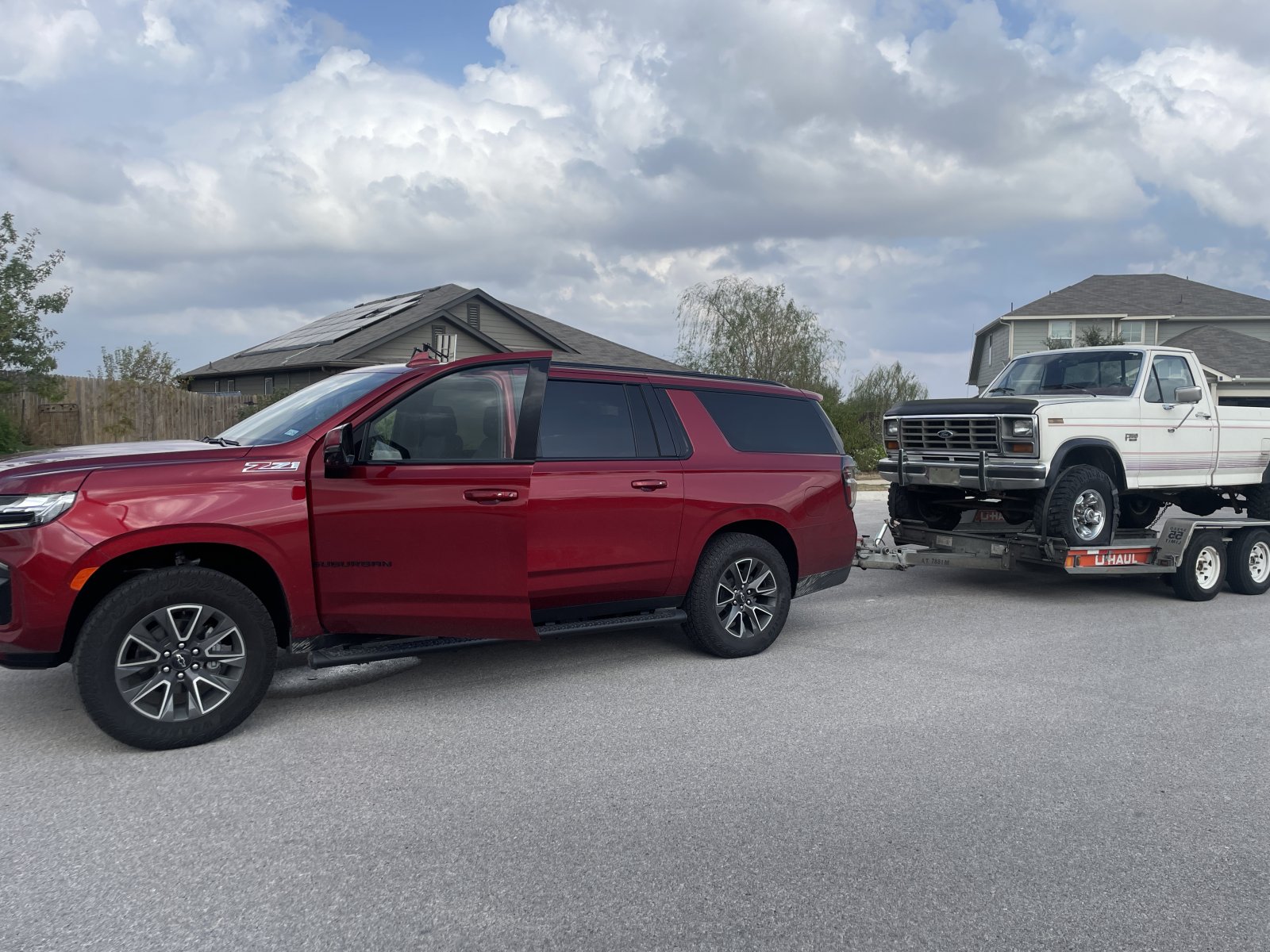

Towed 8200# yesterday with empty trailer weighing 2200#
Averaged 16.5mpg with empty trailer and 12.4mpg with load .. drove conservatively in tow mode 55mph and no higher than 60mph as it started fishtailing
