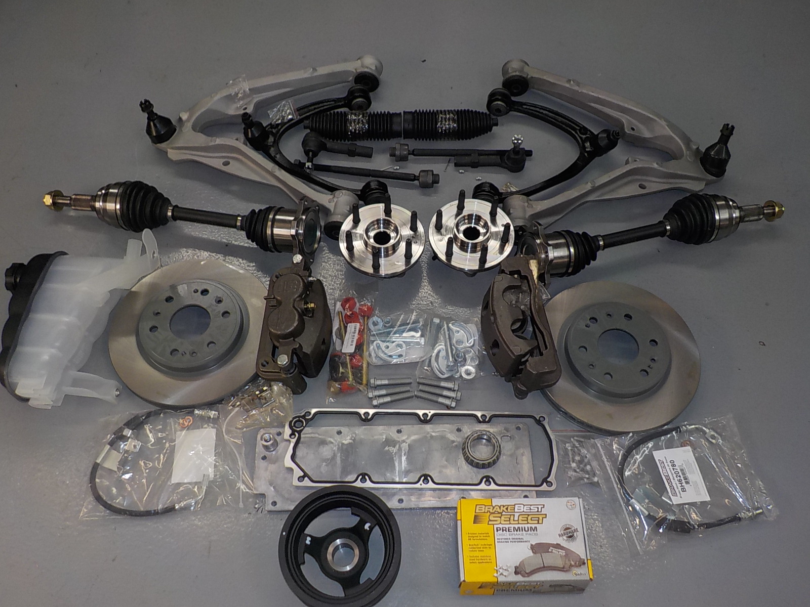

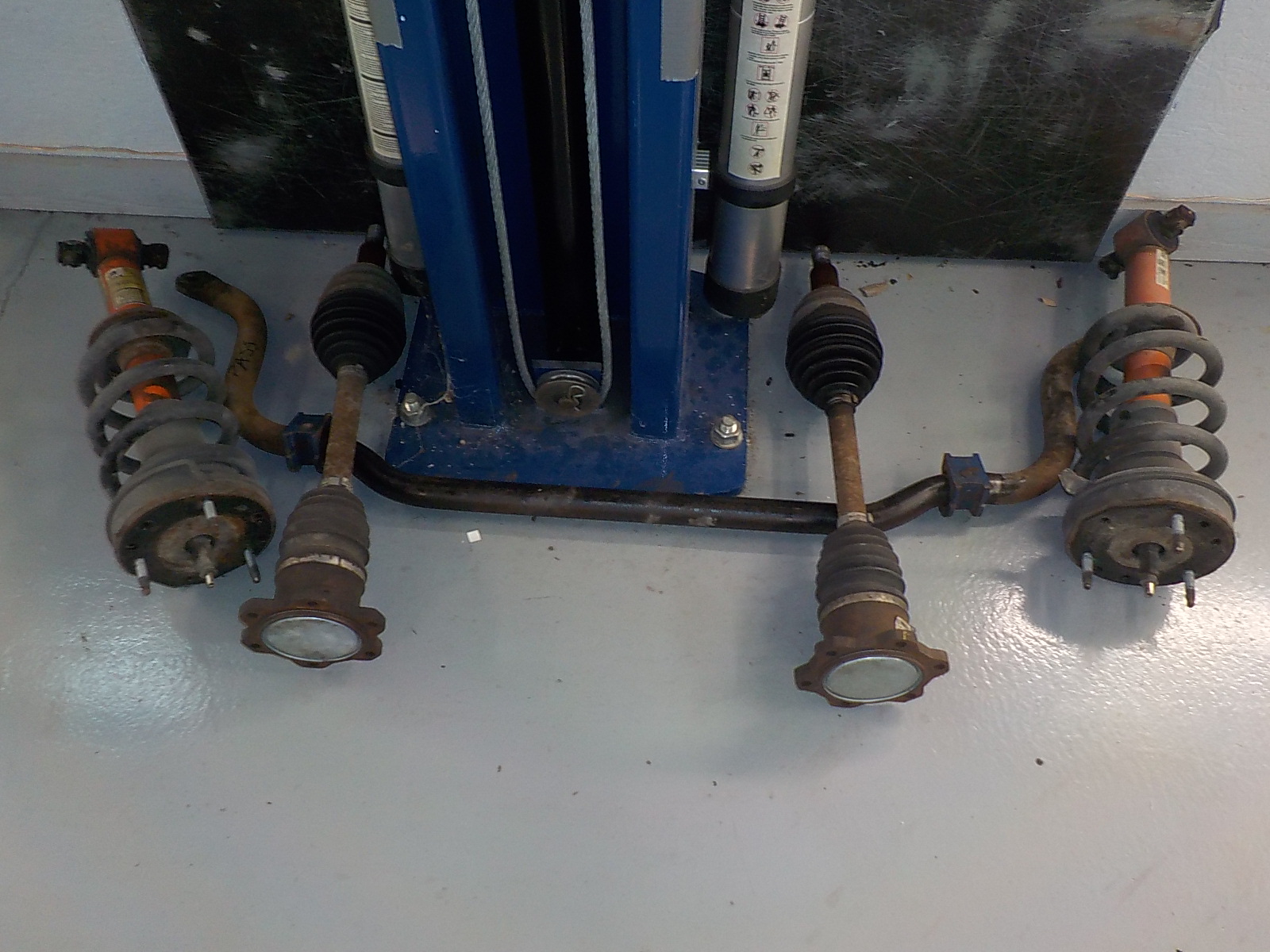

Started tear down to replace:
All 4 control arms w/ball joints, bushings, hardware
CV axles
Bearinghubs and bolts (3)
Innerand outer steering tie rods w/boots
Caster& camber adjusting kits
Rack& pinion bushings and mount
Rotors
calipersw/brackets
brakehoses
pads
do you remember where you ordered the caster camber adjustments parts kit?
I need to get an alignment soon, they look pretty bad.

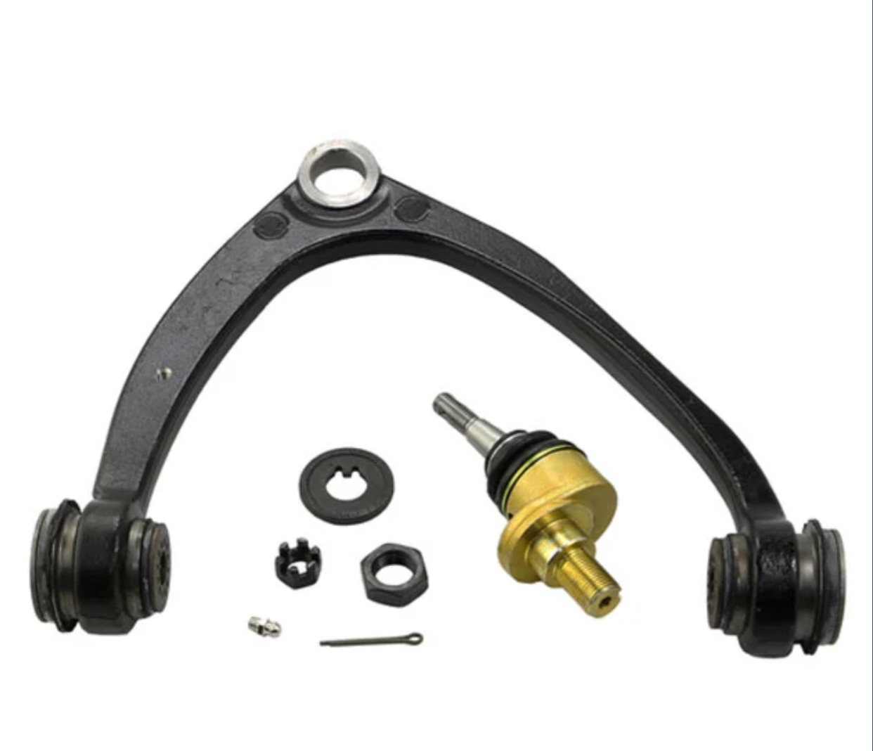

Detroit Axle brand: CV axles, hubs, UCA, LCA, inner & outer tie rods w/boots.
