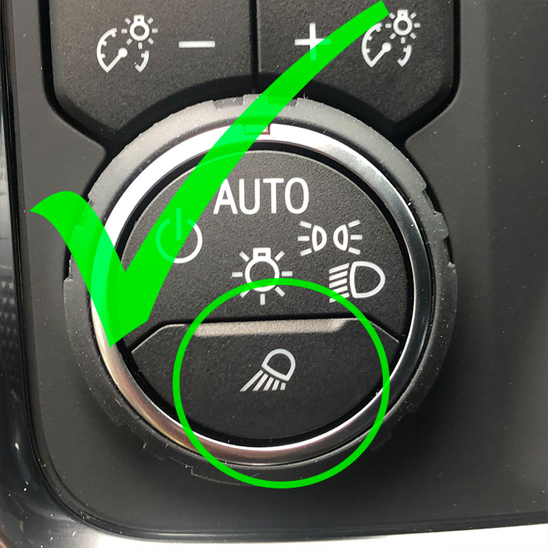

That being said, I am the 21 Tahoe/Suburban Owners Manual and fog lights are no place to be find and not in the index. Looking online at z71 picture and I do not see what GM refers to as the task lighting button that you would see on a Silverado.

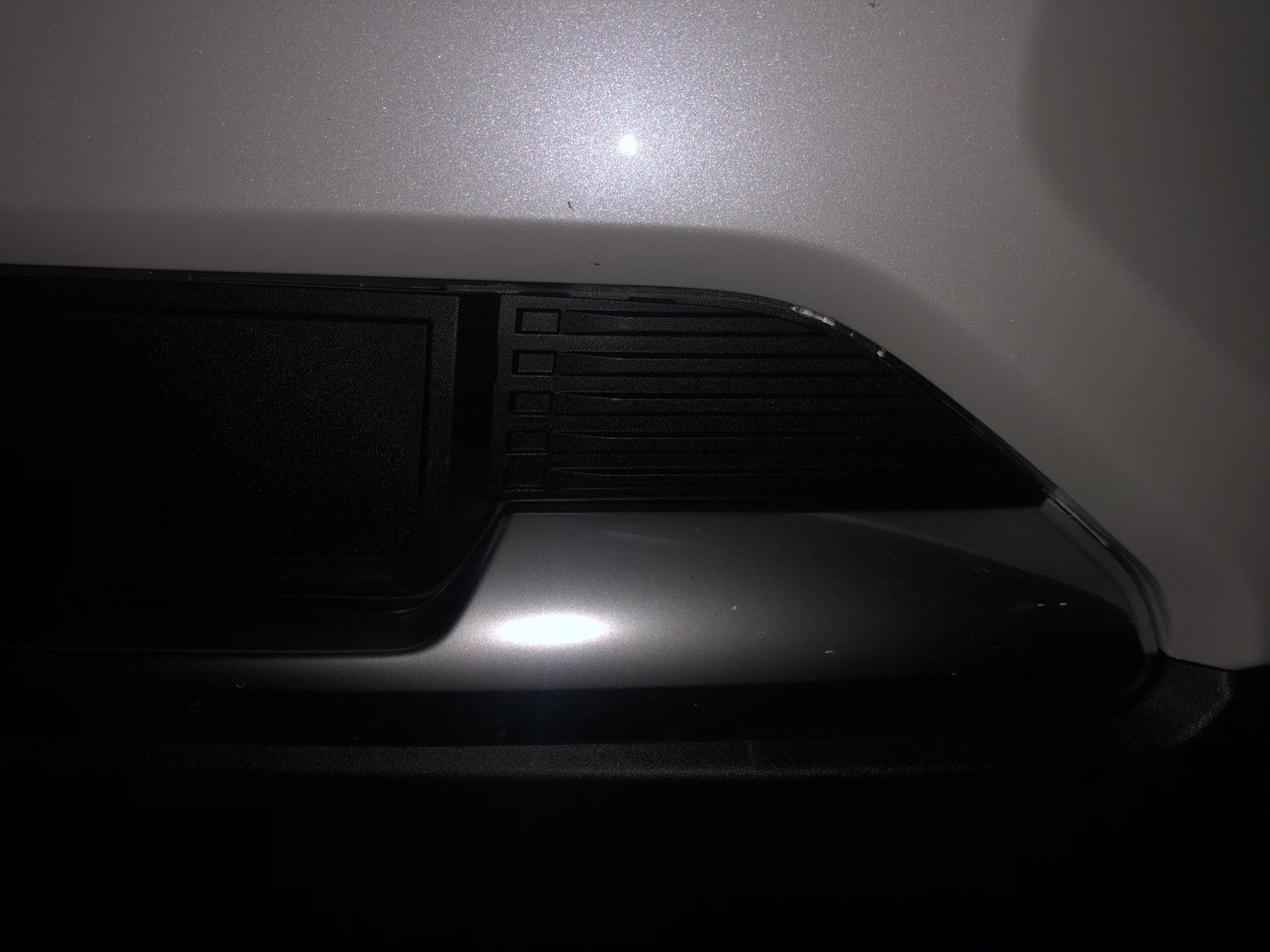

This space in the picture looks like the same place that the Silverado has them.

I wonder if we could replace our Light switch to have the Task light button like on the Silverado/Sierra and then hard wire some fog lights somewhere?
Check out this kit....seems so easy and looks like with have the same area but a bit smaller on the front of the Tahoe.
https://www.ebay.com/itm/Next-Gen-C...amp-Kit-w-out-Task-Lighting-NEW-/273483700856

There are what looks like 2 knock out panels on the front lower face. On the 20 pick up it looks the same. There are tow hooks and fog lights. So your idea may hold water

I may try and get up under there tomorrow. The whole front end has a large plastic panel under the bumper. It will need removed to have any idea what can be done. View attachment 256135
Might be able to cut in some small round/ square led fog or something like this
https://www.roughcountry.com/6in-sl...3G6wIVl-SzCh0ivgieEAQYASABEgK62vD_BwE#280=535
https://www.roughcountry.com/2-inch-led-square-lights-70907.html

I have yet to dig into the that panel. Maybe one of the guys who is looking at front bumper removal for the Illuminated emblem can tell us what is down there. Also, was thinking that those air holes on the right and left wheel well are where the fogs are on the Yukon and escalade.....that piece appears to be trim. Just need a bracket and some small lights and we can do what the F-150 raptor guys have been doing for fogs.

What should have gone in those blank spaces. Tow hooks? Are there holes in the frame for hooks?
Are the spaces easily knocked out?

I found these pic off eBay, where someone was sell the entire front end.
From looking at the pics, it looks like it can be popped out..there appears to be 4 tabs.
