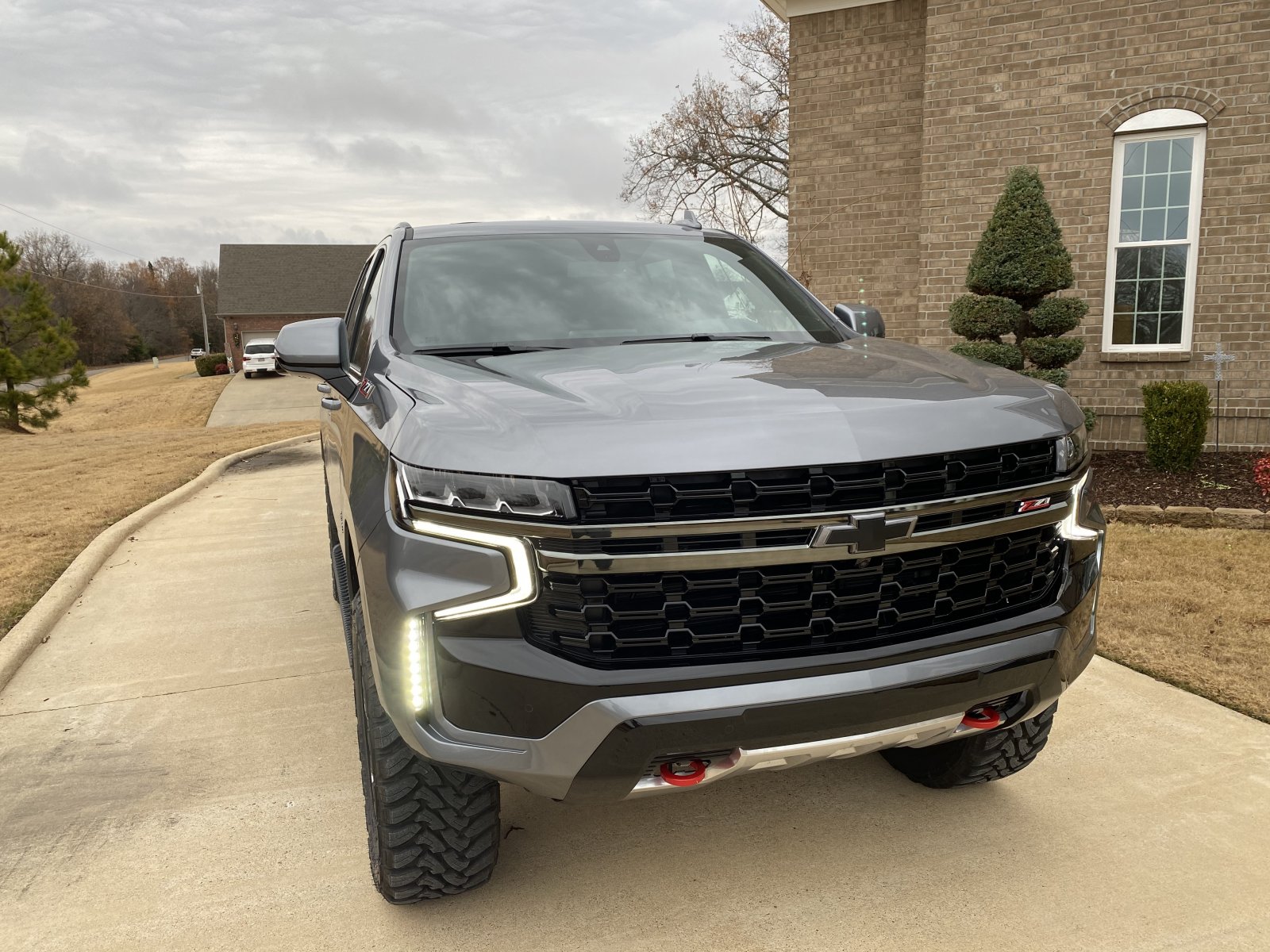

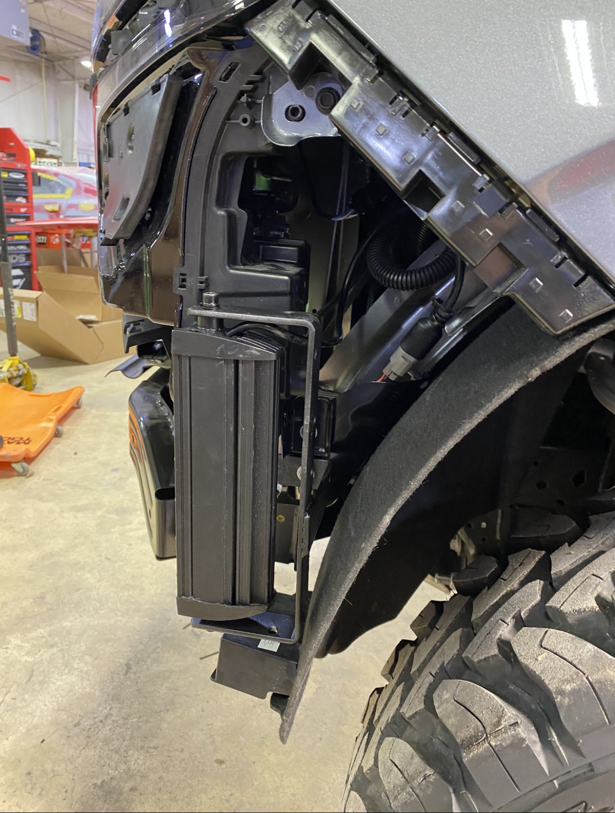

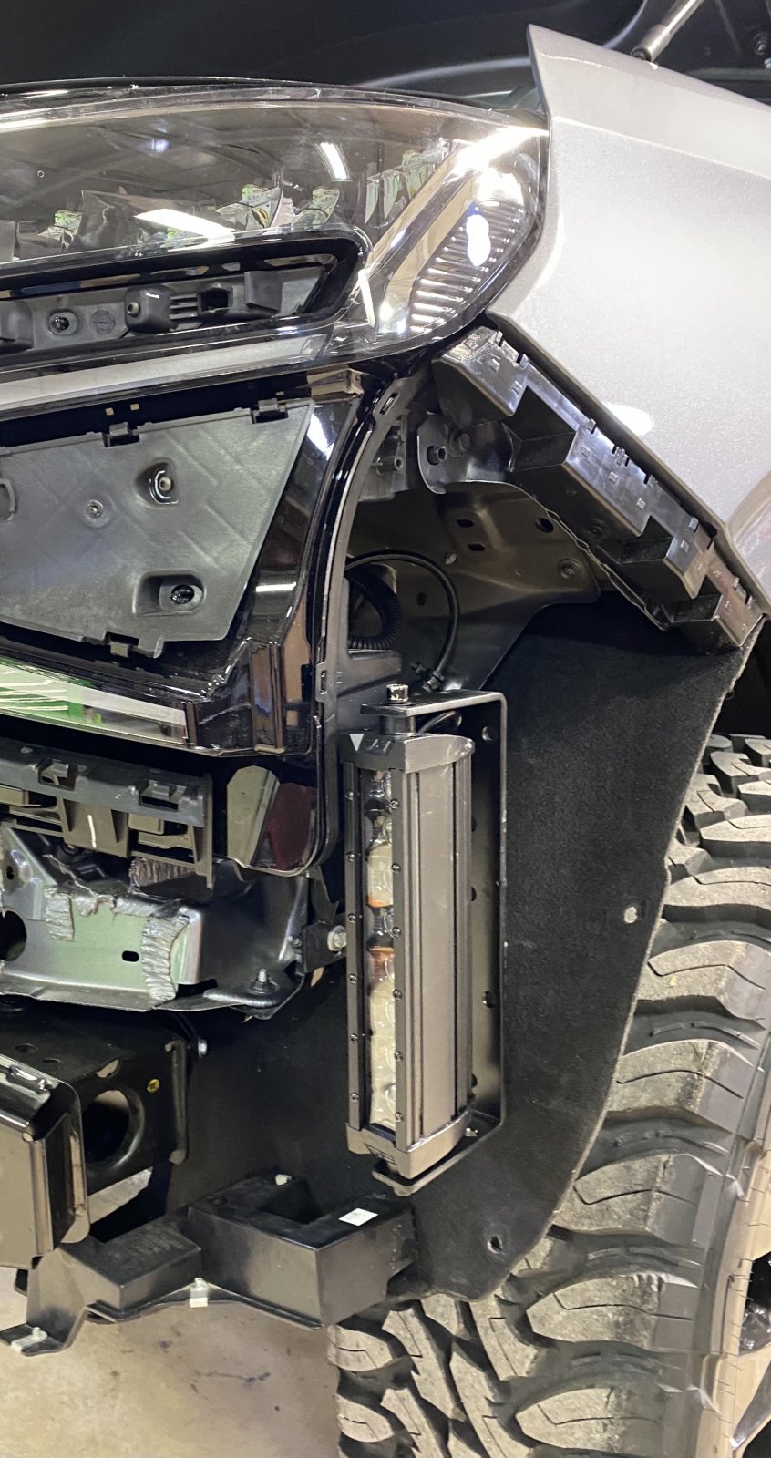

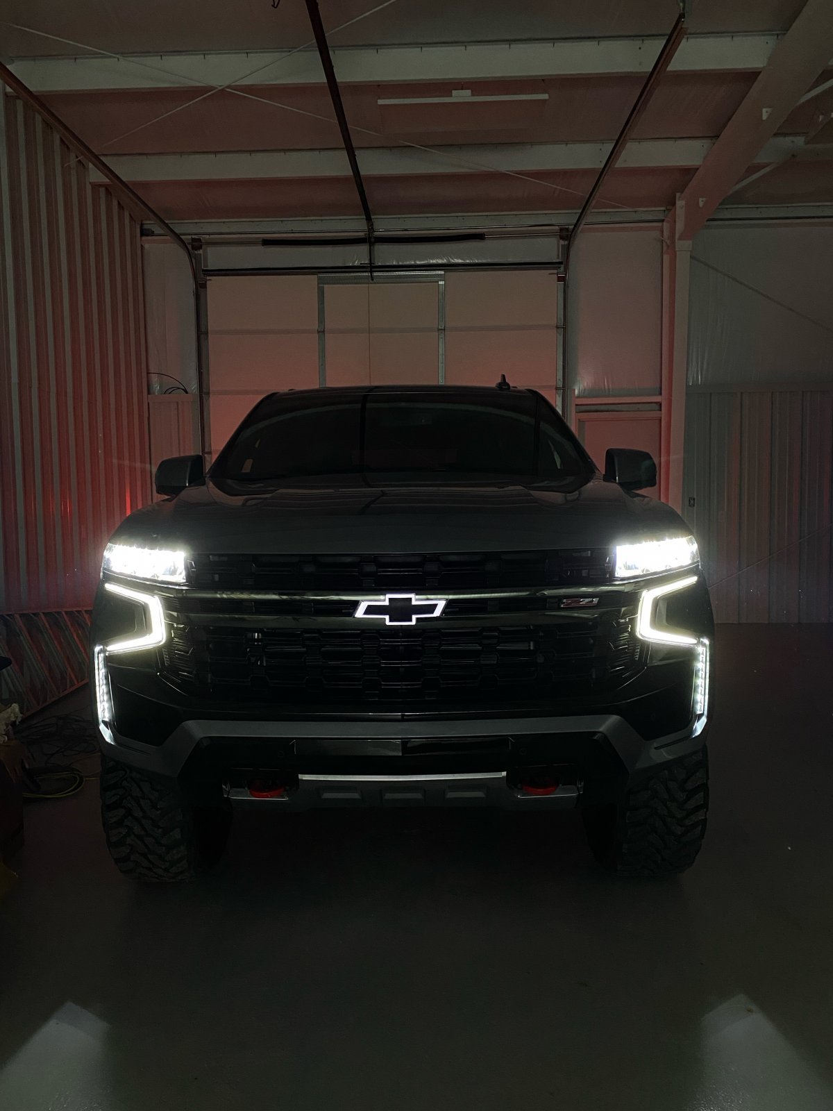

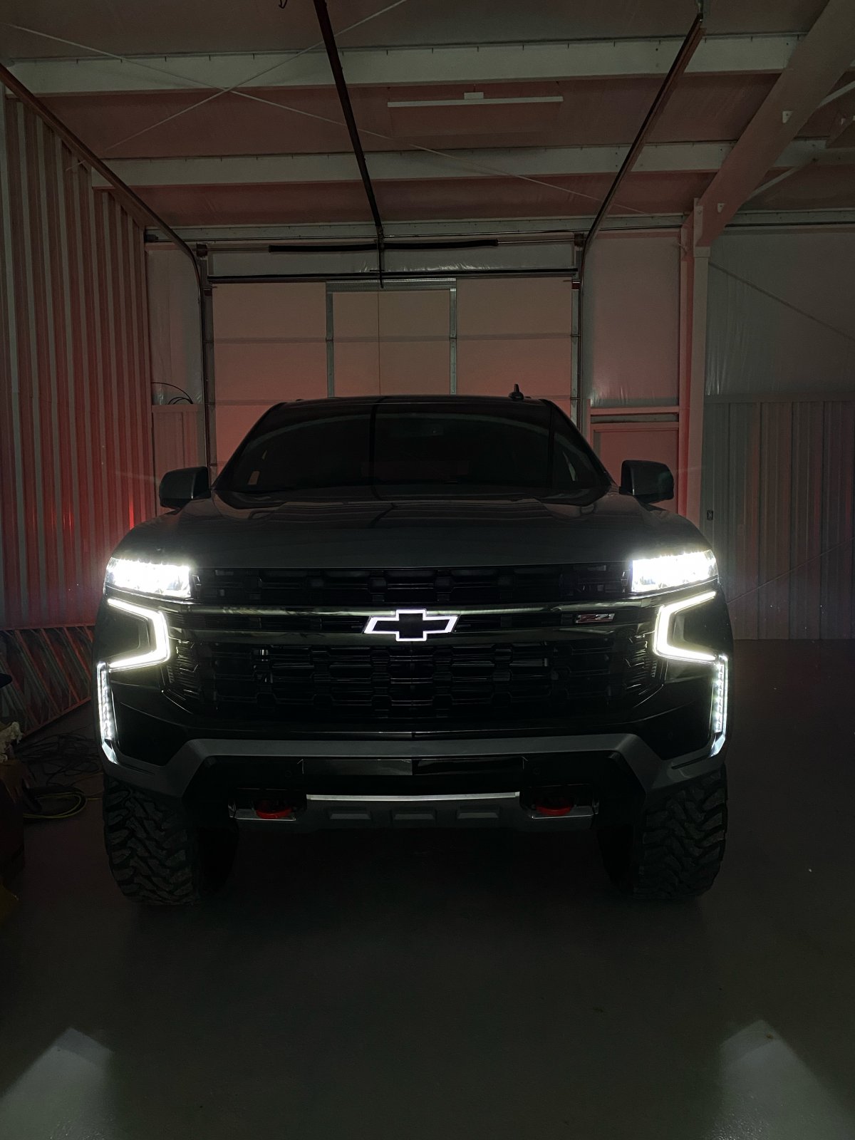

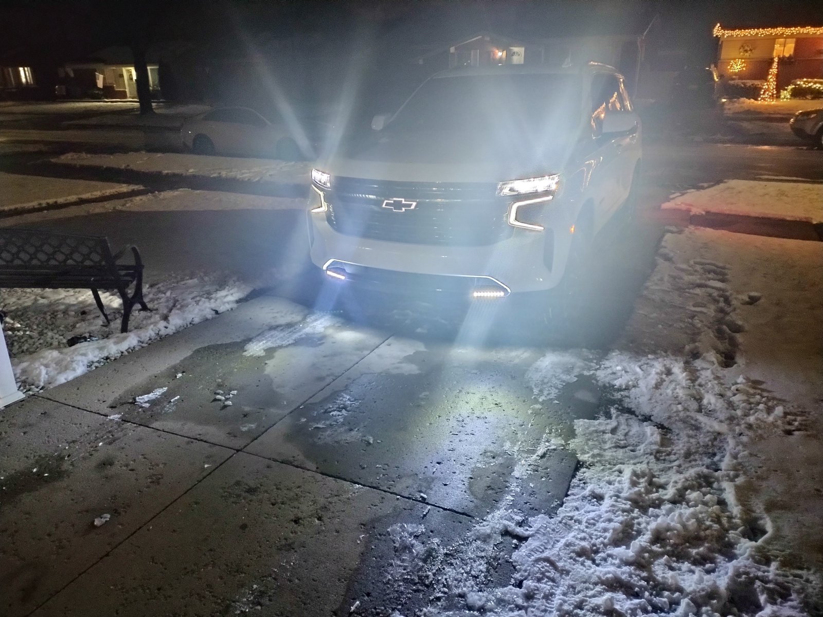

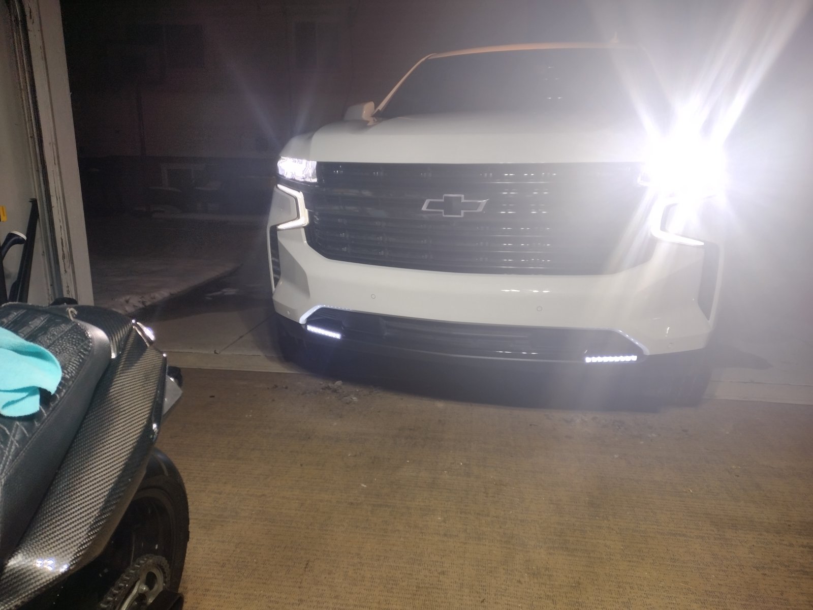

I had to add fog lights. GM messed up not making it an option

so the fake vents cant be removed without cutting?

Those look great, Looks like GMC is putting them on every trim level in a similar location.

On Z71s the vents and the gloss black part of the bumper is one piece. I would assume the non-Z71s vents would pop out though.
I cannot really tell on my high country. I have been trying analyze these pictures from eBay. going to reach out to my service guy as he is good and responsive. What is the going right for a pair of brackets..... I am am sure a few other guys would be interested?

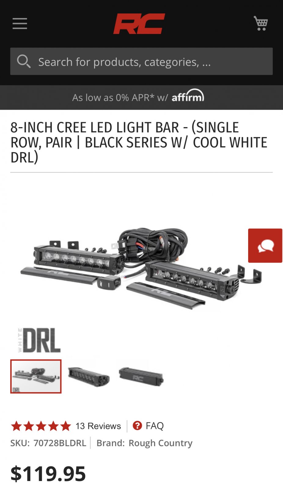

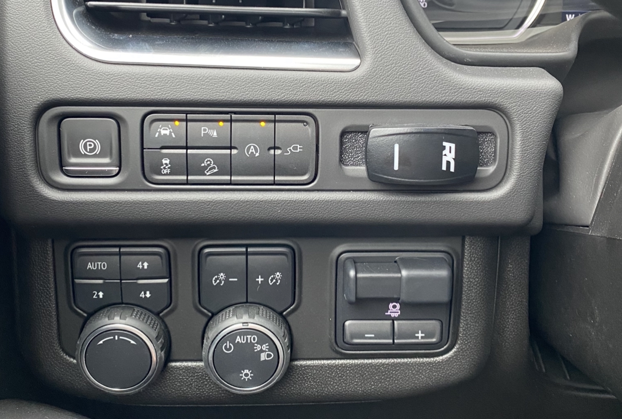

How did the wiring and switch go?
RC gives you a decent wiring harness. The Tahoes’s firewall looked too crowded up to go through so I ran the wires down the fire wall and went though a plastic plug under the driver’s side carpet. And I put the switch where the card holder is on the dash.

It looks like the non-Z71s have functioning vents. You’ll have to remove that duct to see what the vent bezel looks like. And I just bought 6 “L” braces from a hardware store and made my brackets.

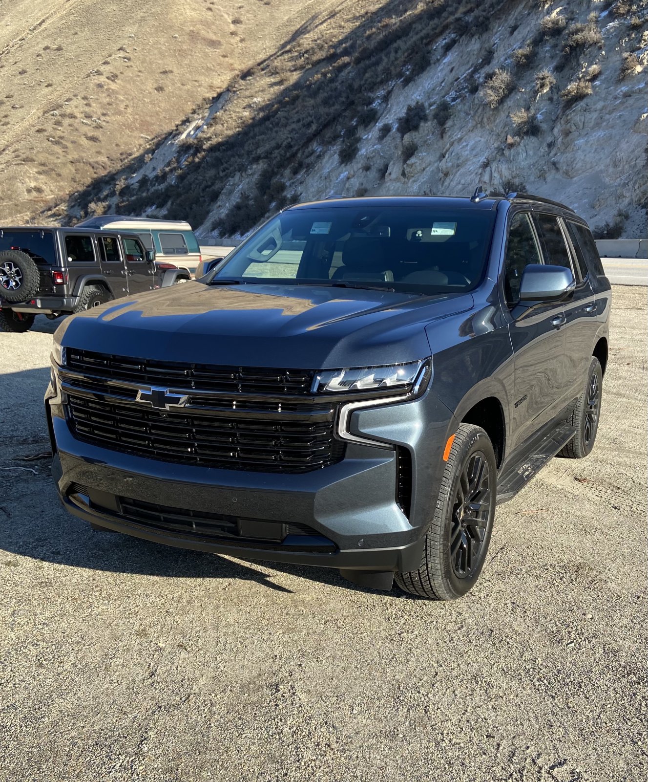

I may need to add fog lights to my RST, that install looks nice!!
Here is my RST, just broke 5k miles in 5 months. Also put a 1k amp in on a custom 34hz box. waiting for FI Audio Xv3 12” to arrive (8-10 week wait).
