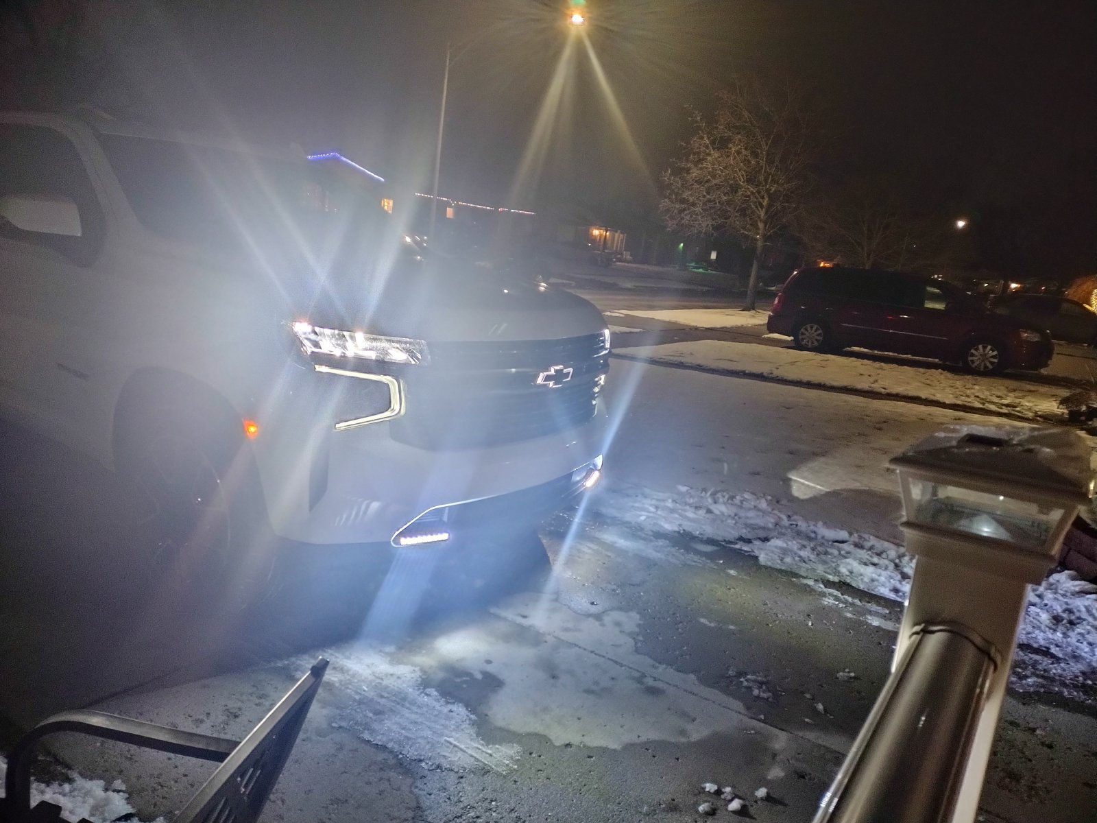

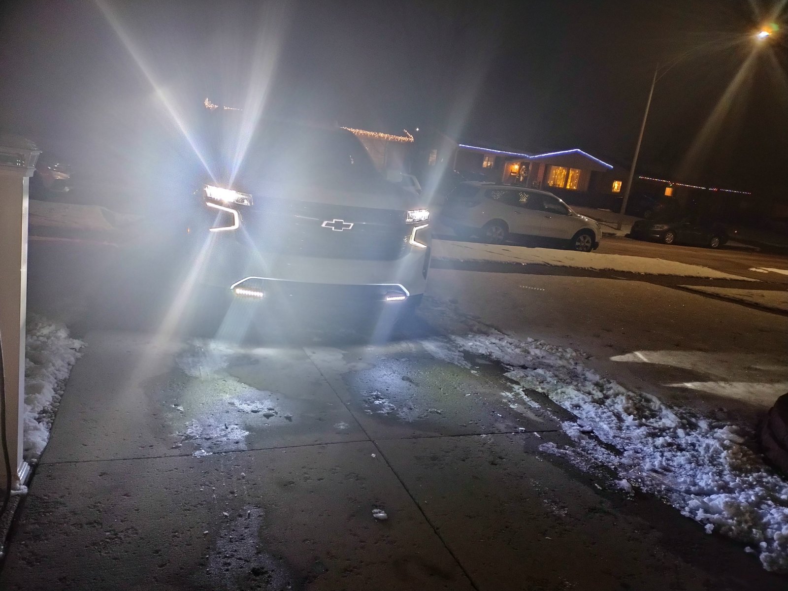

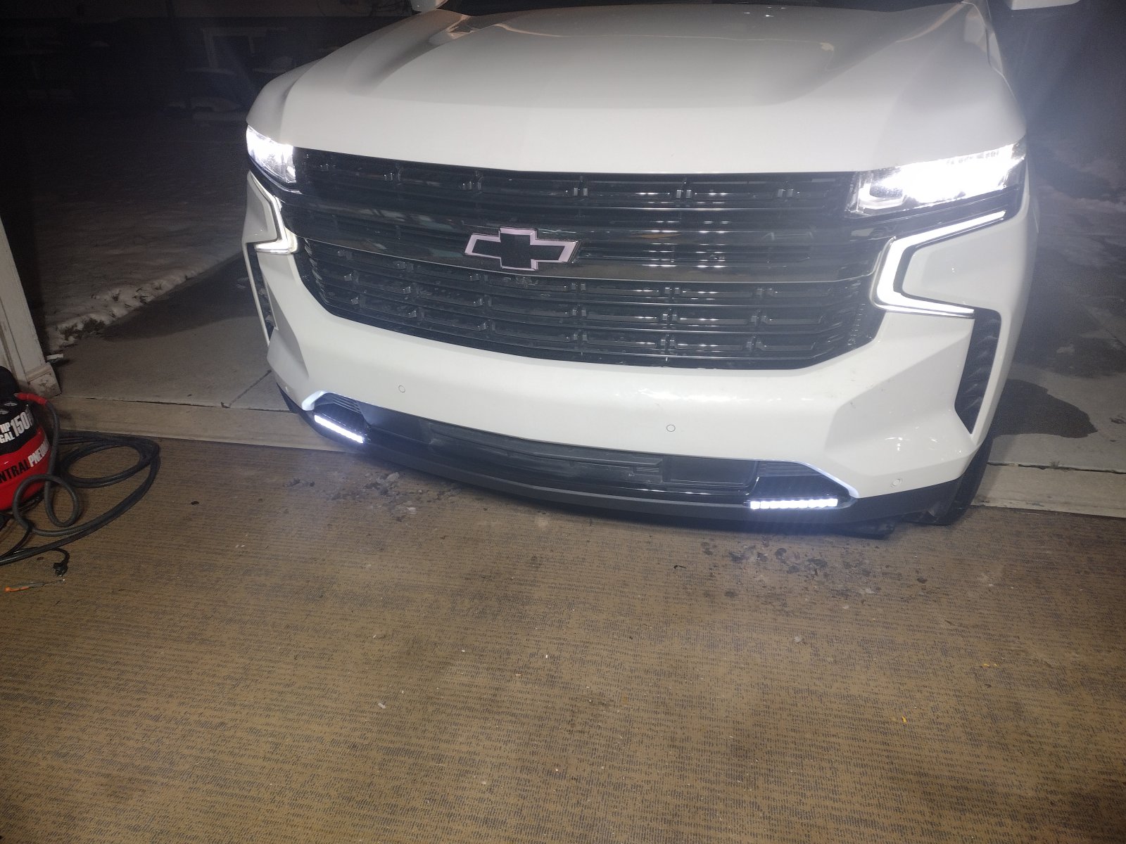

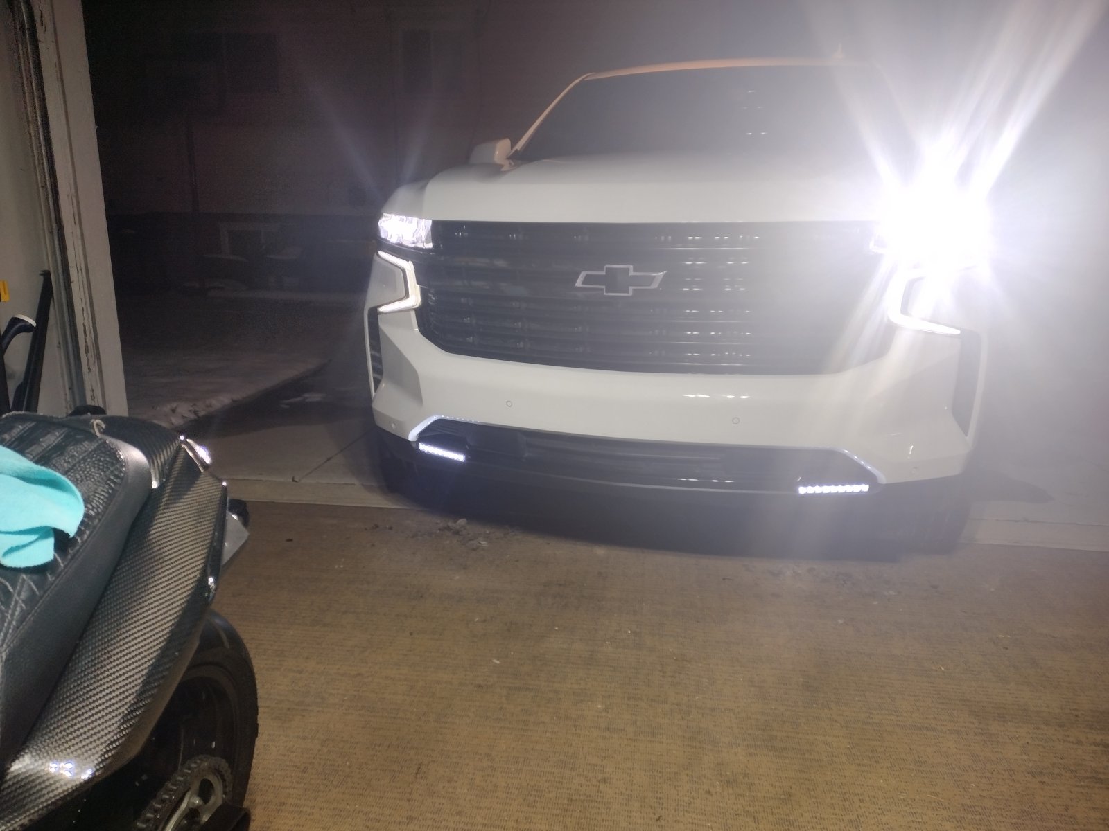

I may need to add fog lights to my RST, that install looks nice!!

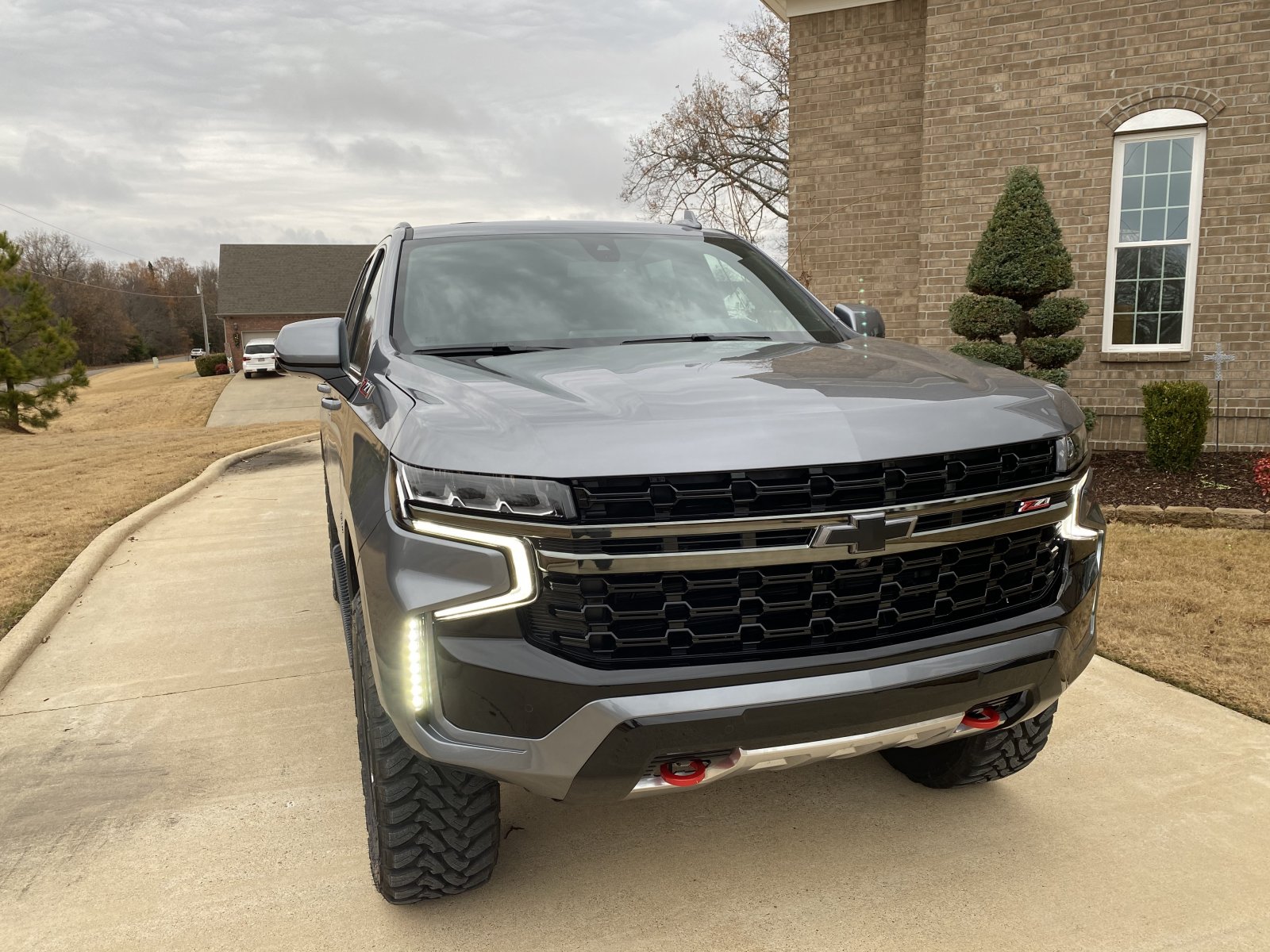

Here is my RST, just broke 5k miles in 5 months. Also put a 1k amp in on a custom 34hz box. waiting for FI Audio Xv3 12” to arrive (8-10 week wait).

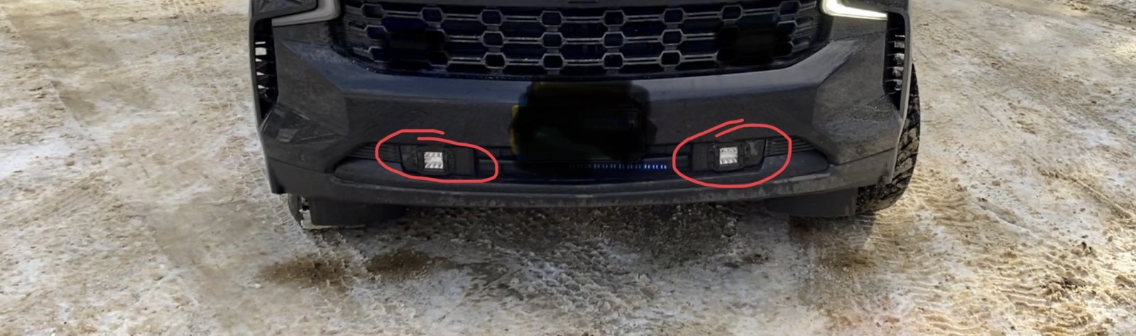

Looks like someone has validate the proof of concept at leas and showed it can be done, just a matter of finding locatio. Between the location, wiring and switch location the hardest part would be finding location. Since I don’t plan to use the off-road portion of my 22 Z71 the tow hook fairing could be closed over with a bracket or containment box. I would want to have a bracket and housing assembly that could be removed if necessary in the event that vehicle does get off road….read snow, ice etc…and may need to be towed. Not removing the tow hooks just covering them over and the lens assembly would fit into the tow hook housing. Something that cen be used as a fairing to keep somewhat neat looking and professionally installed. Wiring would be custom ad the only question that remains is can te Yukon Fog Light switch be connected to the wiring harness. That provides the neat looking instrument panel look without a extra switch And a neat instrument panel. The other option would be the fog light switch on the center console or possibly off to the side within fingertip reach. Thinking out loud but the wiring harness even if aftermarket harness would probably be the least of the figment issue. Fuse tap adapters, relay bock and power supply to switch and battery seem simple. Trick is to get it looking not only neat but out of the way without making the isnetrument panel look too busy.

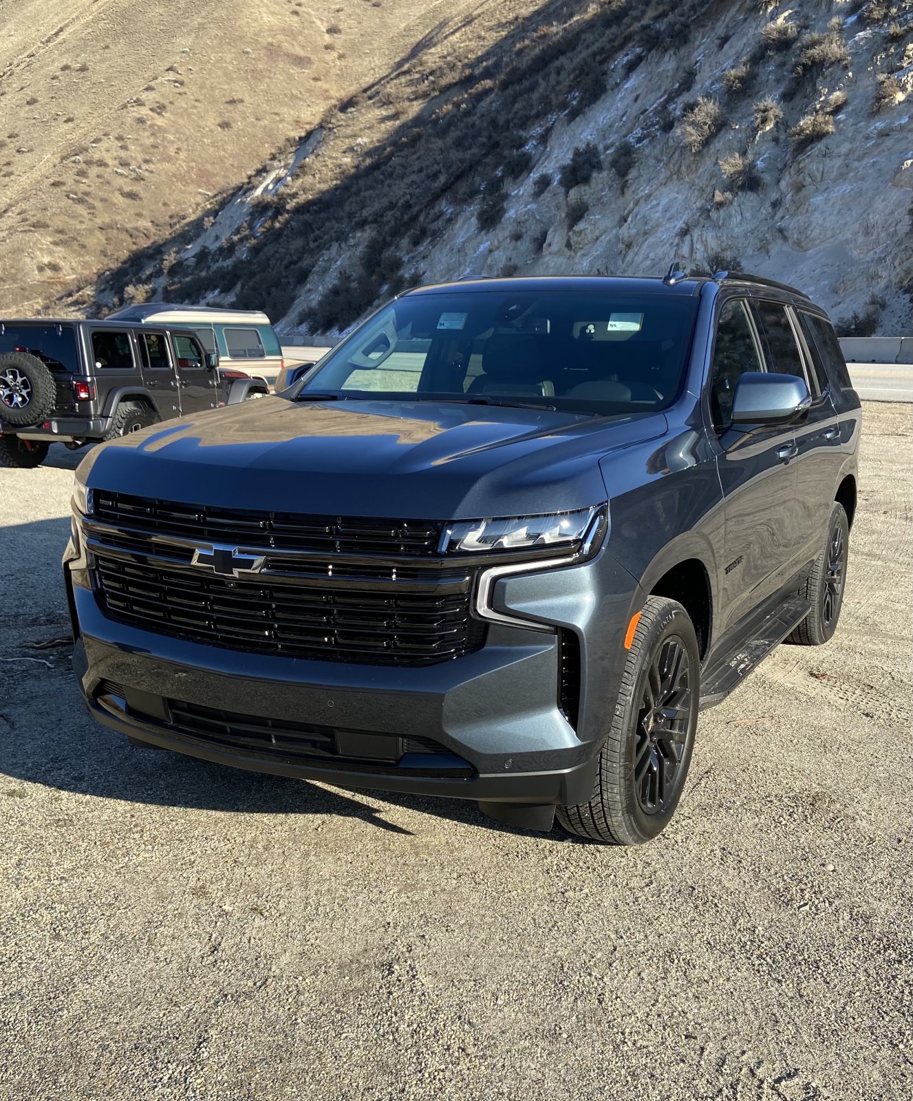

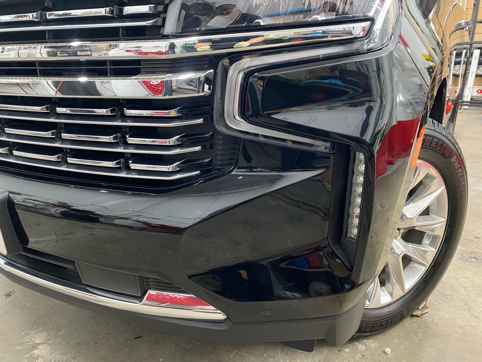

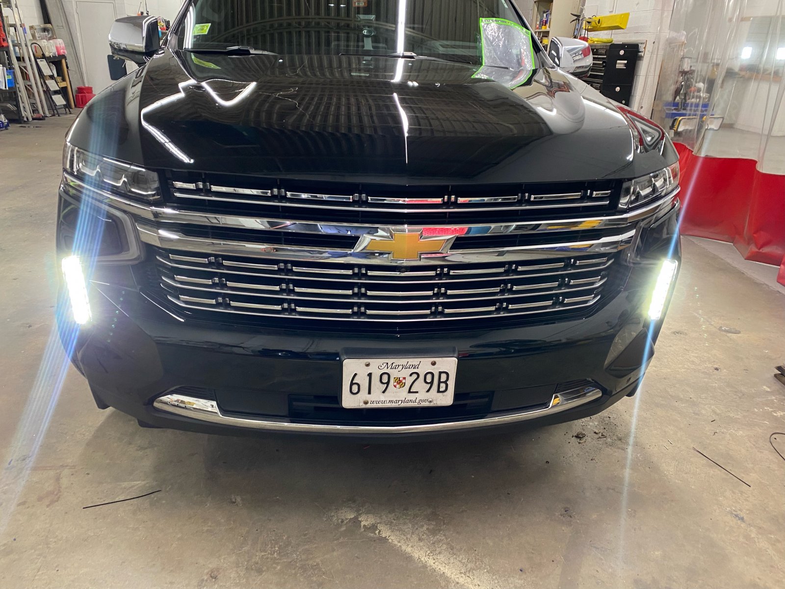

Work take home 22 Tahoe, they added fogs at the bottom in those two blank spaces on either side of the plate mount.

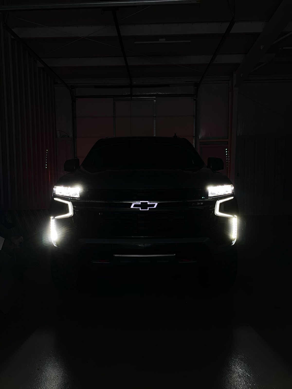

Have been considering a pair of those.
Where are you planning to mount them and will you be using double sided tape or screw/bolt to attach?
In terms of wiring, if white wire is power to switch to signal relay to turn on lights then we need to know if you want a switched power source or power all the time. If switched power source do you want them only on with headlights, running lights or ?
Juanillo2023HC
Jan 17, 2023
29
23
Thank you 66 Galaxie,

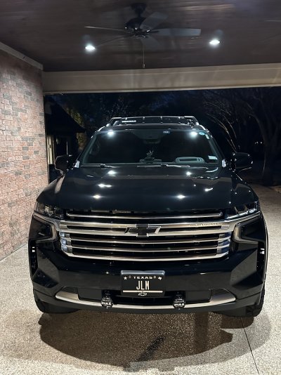

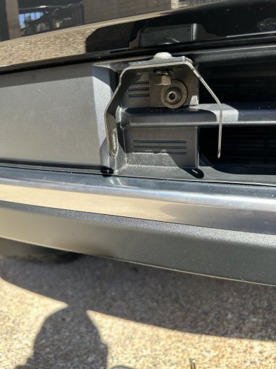

I plan to mount them with some L brackets on the plastic piece under grill, I’ll take picks of the install. Plan on mounting tomorrow.
I want to switch them on with headlights.

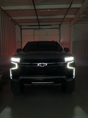

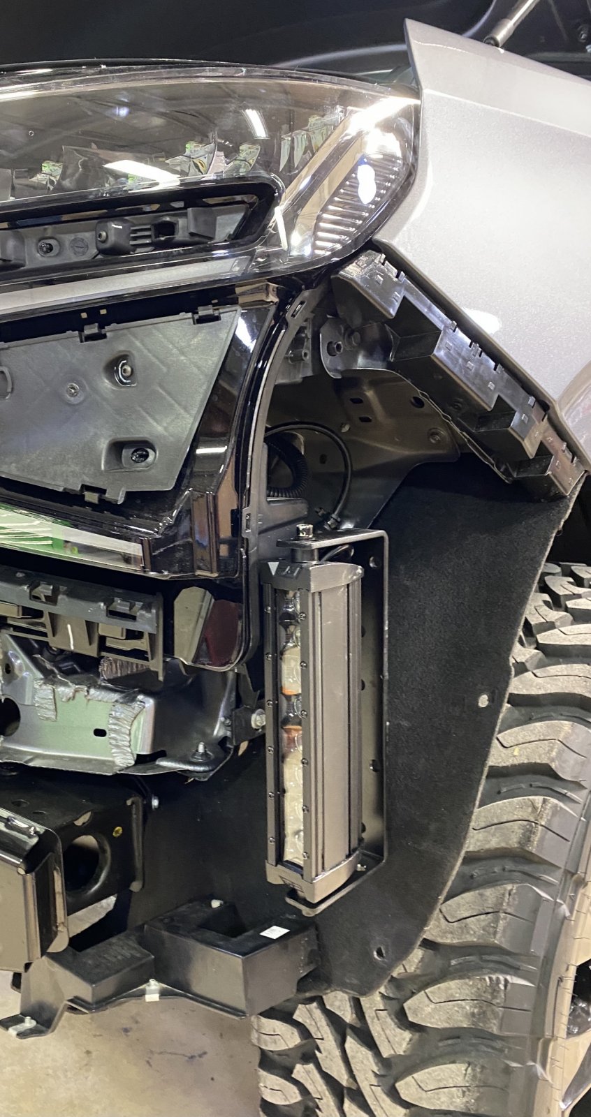

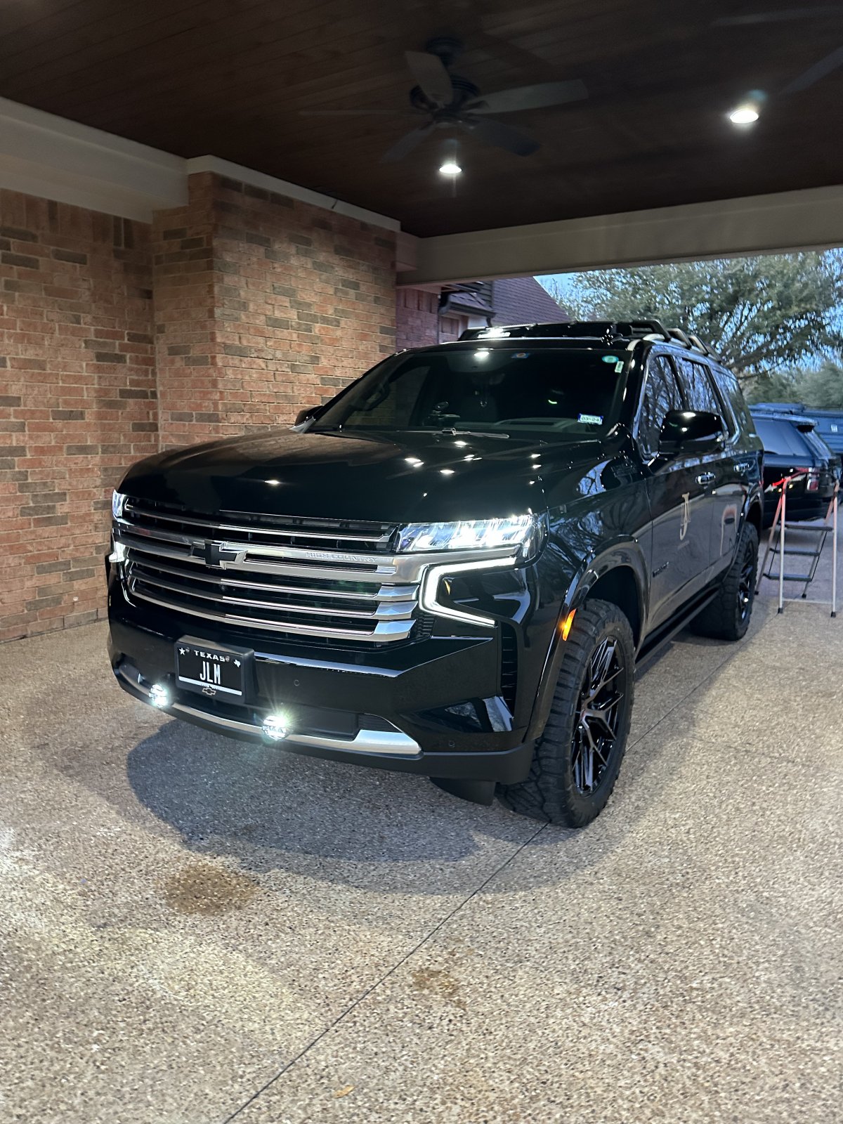

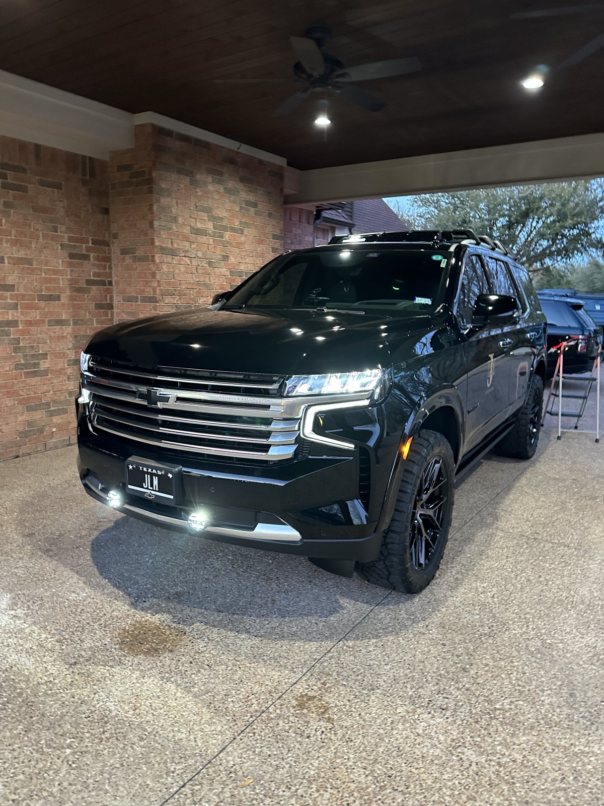

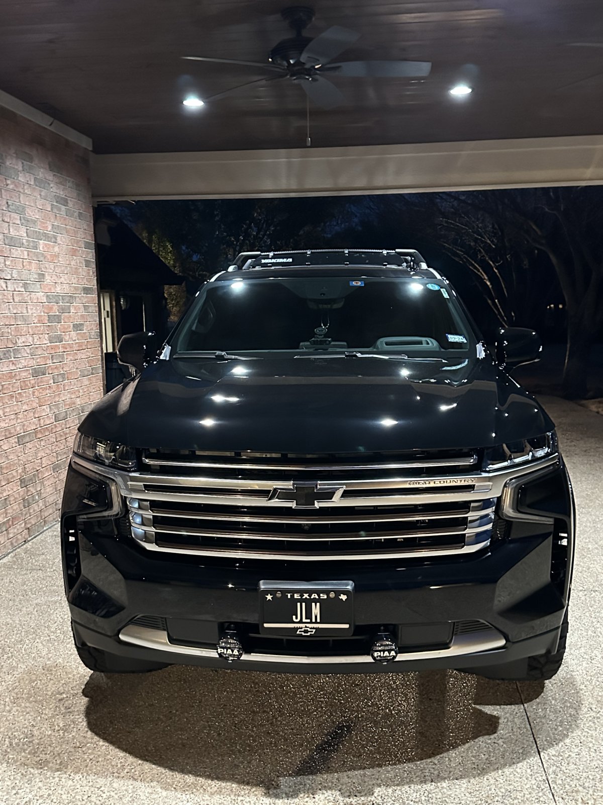

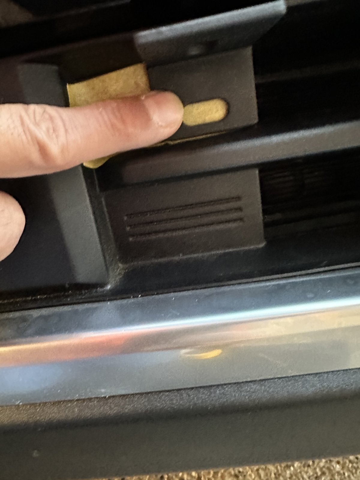

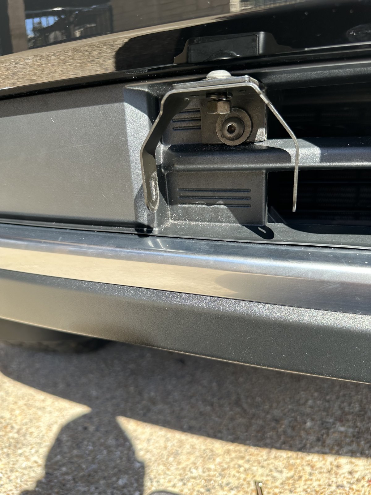

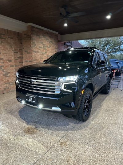

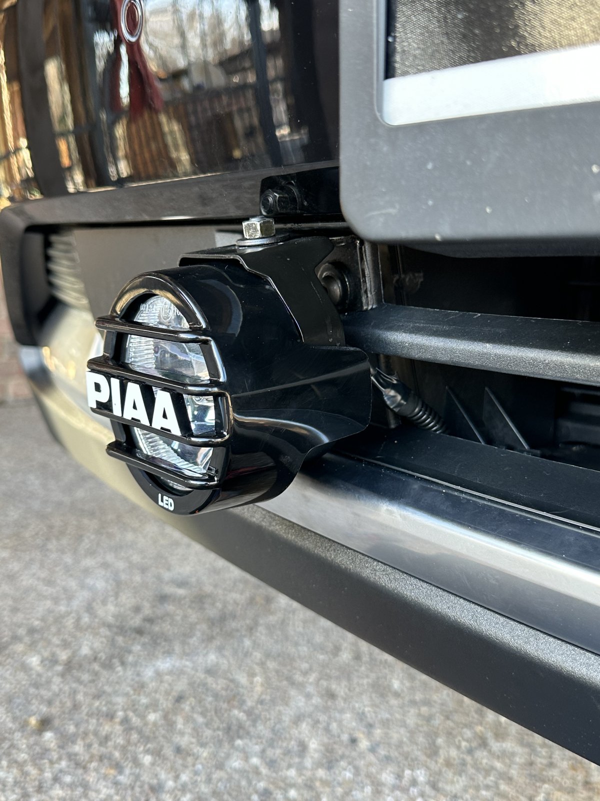

Well installed ‘‘em today, let me know hat y’all think..

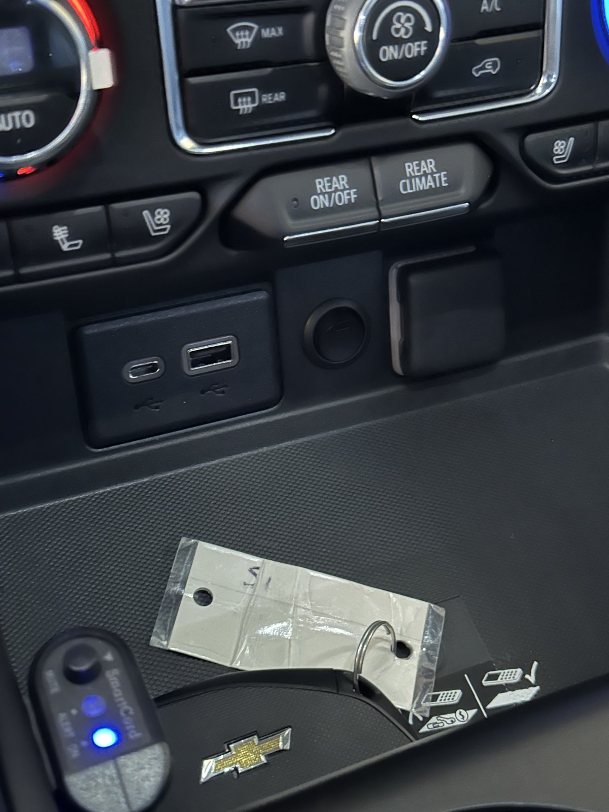

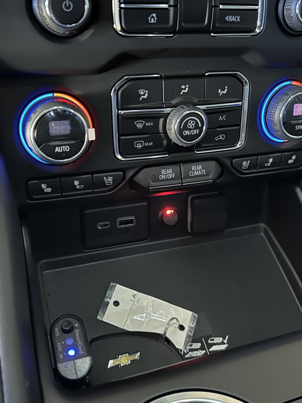

Here’s wher I mounted the switch

Great job!
Which wire did you tap so they would go on with headlights?
Details of how you did switch install??

Interesting, on my ‘22 High Country (6.2) that lower panel is not open like yours where you mounted the grill. Does your truck have max tow package or Diesel??
Juanillo2023HC
Jan 17, 2023
29
23
Tapped ito the fuse marked headlights,
Switch was a simple hole , trick was pulling that panel. There’s room tho. I dint take pics.
It’s a diesel, yep on towing package. Never noticed it on my 22 6.2 I traded in tho. Figure it should be the same.

I think the diesel wants more airflow so bumper is vented below the grill, makes for a sure enough nice fog light bracket location :thumbsup: Any false-positive triggers (from the new fogs) from your front parking sensors ?
