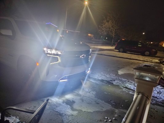

No issues with parking sensors, I wondered the same thing. But all good.
I looked at the idea of them in the grills, didn’t like the dot look, also considered a 6” led bar Piaa makes but to big.

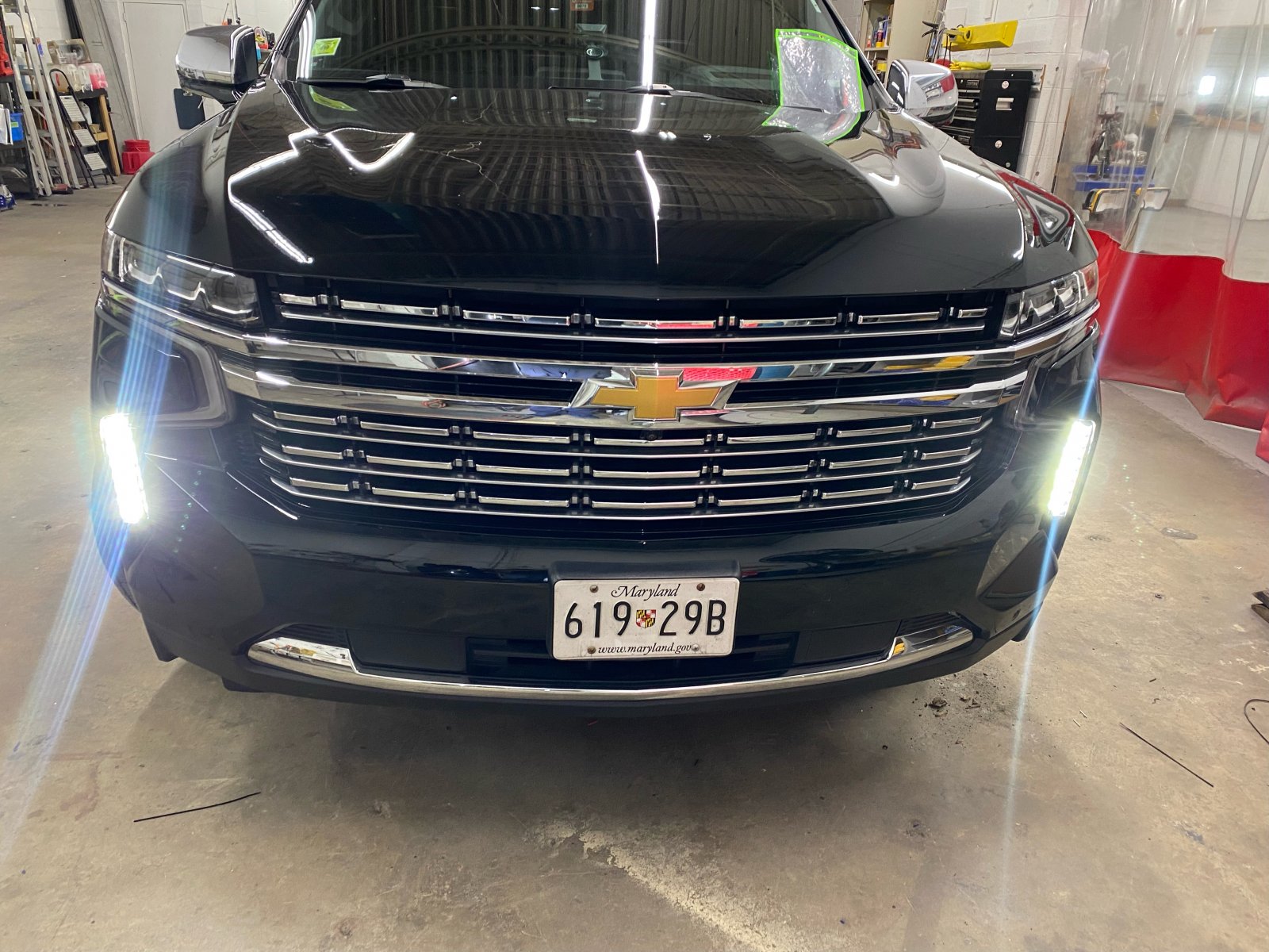

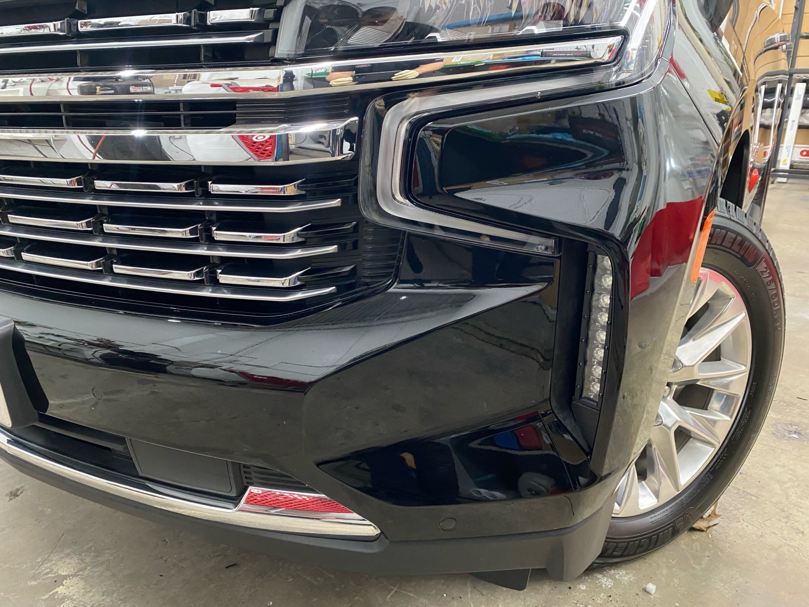

Brade………..i that a Premier or HC? Grilles are similiar. Same request as Juan….. Can you take some night photos from the drivers seat in a area without much supplental lighting….get a true sense of the beam pattern.

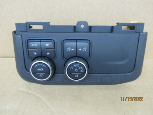

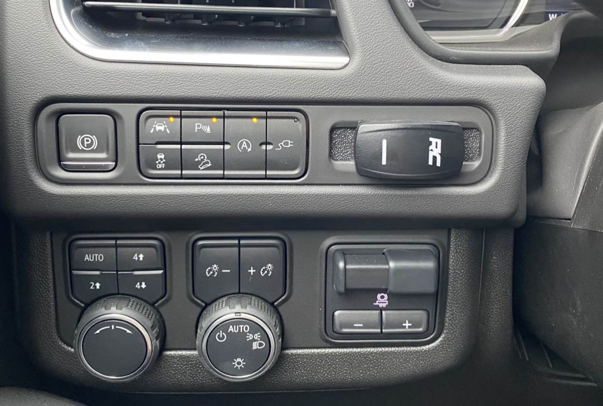

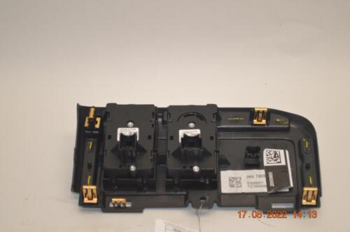

Do you think using a GMC Yukon switchboard would work if the fogs are wired to it? I am planning on doing the same install but wanted a factory like switch.
I don’t think so. That switch is only a momentary switch. It doesn’t lock on/off. Also, it is only pilot duty, it can’t carry a load. It is meant to send a signal to the BCM.
