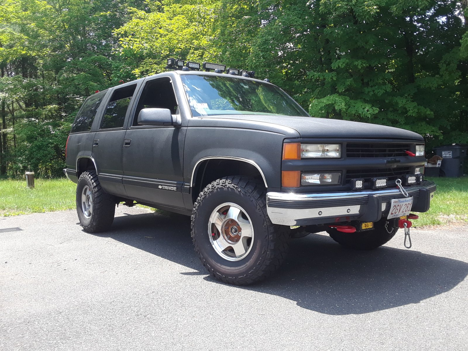

aloha to all...
so,,i did a pretty large rebuild on my 99 Hoe after a failed inspection about 4 yrs back...
failed for balljoints, exhaust leak , lic plate light and a snapped wheel stud...
so 4 yrs later,full suspension rebuild, intakes gaskets, and tons more,,,
im at the evap system....
i have an odd leak failure...
No Codes..say whaatt...
when i do an evap system test on a LAUNCH pocket scanner...i gives a leak in the evap...
No Codes....
Tested the solenoid at canister...purge valve...Both bench tests good...
Installing a new press sensor at the tank now...and testing the harness....
so,,til then a couplepics...best payment for free opinions...cheers Tom

Hi and welcome from New Zealand Lol ‍♂️
Nice looking brake n Suspension upgrade. I dont know about ac system yet, no doubt will learn about that should issues arise.
Nice looking rig
