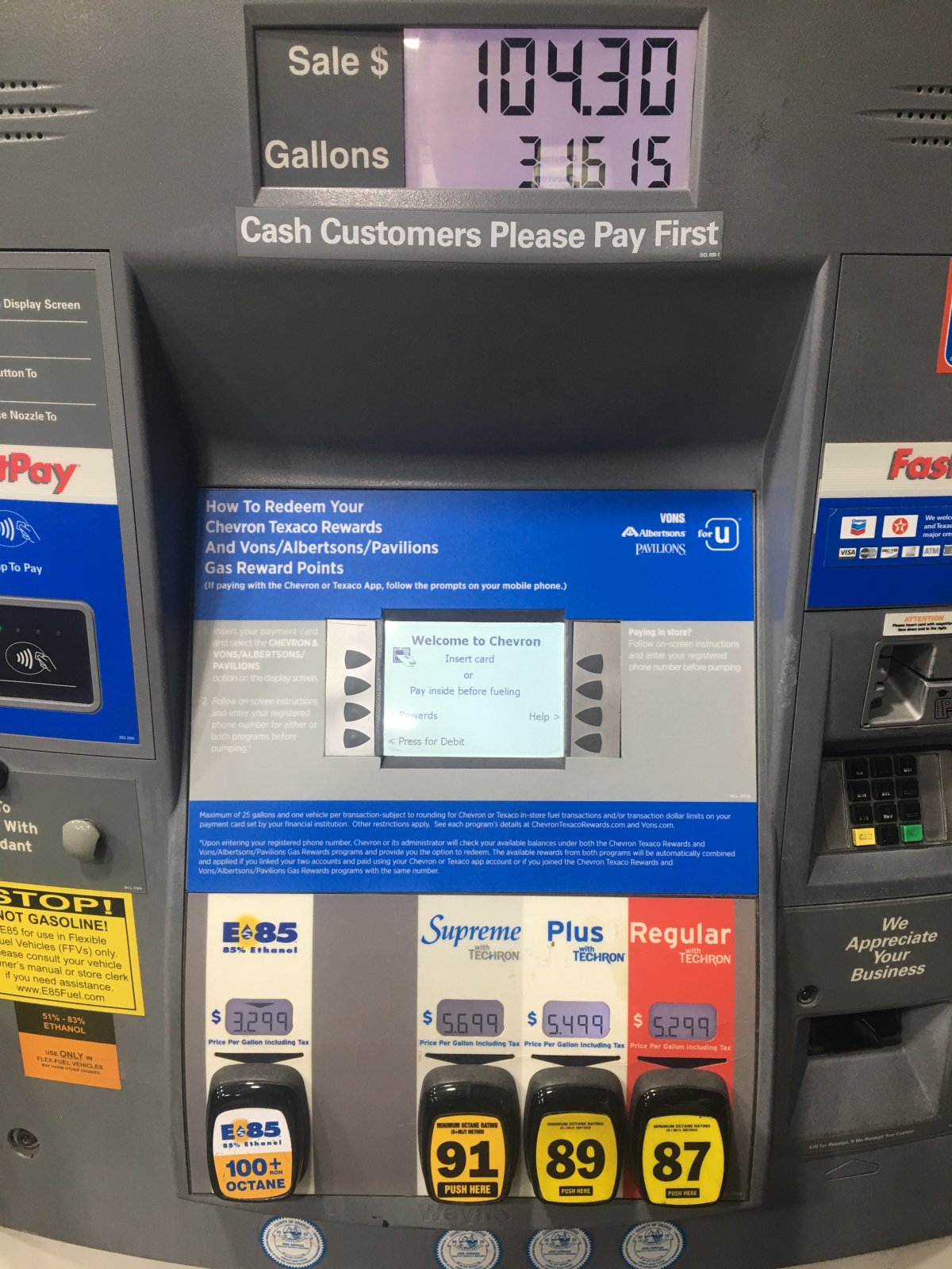

You can’t change the milage but you can change the driving behavior or the fuel. For me it’s easiest to run e85 vs changing the driving behavior.
$104.30 vs $180.09 for 91. Now that the fuel & evap system has been refreshed, the tank will hold a healthy 31.6 gal of fuel. Prior to that I could only get 26 gal in on a bone dry tank. The DIC accurately showed I had 15 miles of fuel left.
thats interesting pricing. I stopped for fuel yesterday, 87 is 3.49 I think it was, 93 at 4$ and e85 was 3.00$
kinda. interesting e83 is about the same as you but the gas is much higher.
it feels like a scam all the time haha.
