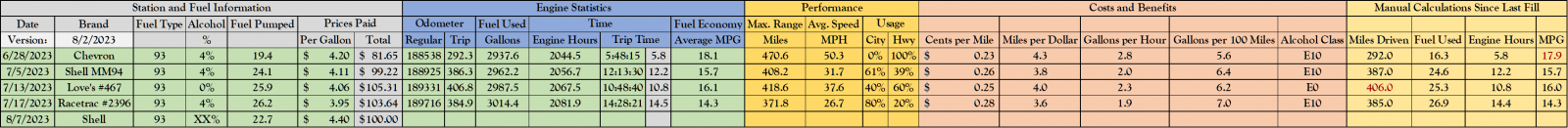

Using the data from your DIC during refueling you can calculate how the engine is performing against how it's being used.
The data in green comes from the gas pump and my DIC. Excel is then used to make automatic calculations some of which are shown to the right.
When we're driving in the city, the truck will go 12-15 hours before requiring fuel again. Out on the highway she can run for about 8 hours before requiring fuel while still having a healthy reserve.
