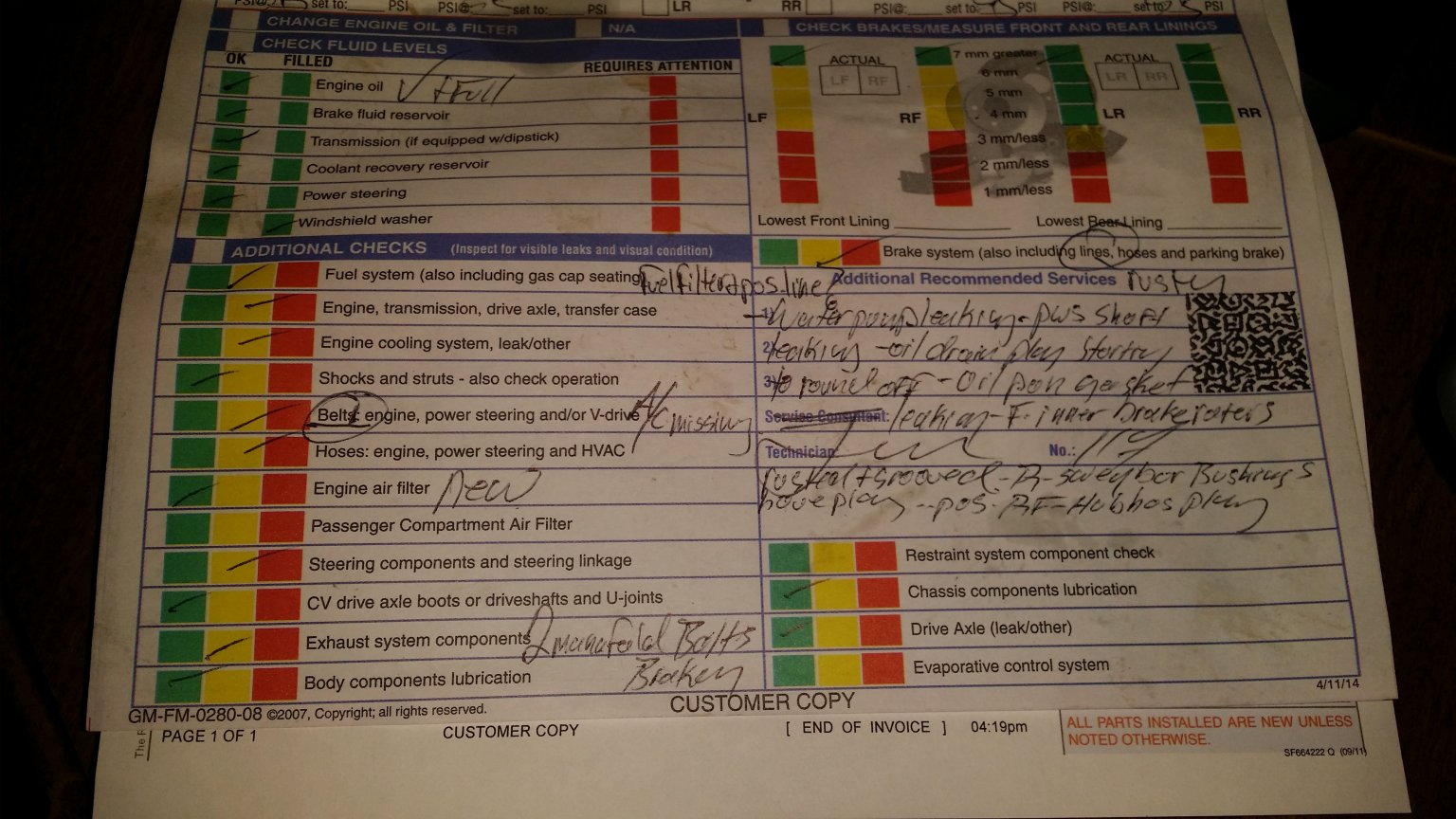

Hi, yesterday I had my first oil change at the GM dealership and I asked them to take a look underneath and let me know what they find.
2000 Chevy Suburban LT around 185,000 miles.
I know there will be issues to address. What are your thoughts on the following?
1. 2 manifold bolts broken.
2. Some brake line rusting.
3. Small leak from water pump.
4. Oil drain plug starting to round.
5. Oil pan gasket leaking
6. Front brake rotors rusted and grooved.
7. Sway bar bushings have play.
8. Possible RF hub has play.
Thanks

Sounds about right, prioritize and knock it out. If you have any will to do it yourself these are all easy pickings...brake line being the toughest probably. Do the brake line, hub, rotors, water pump first. I would also have another inspection done for a second opinion plus drive it, look at it and make your own list. Feels good to take a vehicle with some miles, re-hab it and make it rock solid reliable. Don't forget that list doesn't include maintenance like plugs, wires, fuel filter, fluids, etc.

Doesn't sound too bad. The manifold bolts could be a PITA though.
95escahoe
Aug 2, 2010
5,162
4,466
Sounds about right for the mileage, a few places make SS brake lines for these trucks
This......
But I have to ask about #4, why not just replace it then so, I don't know, to make sure you could get it off next time?

I have no idea why the dealership did not replace it. You would think they would. I will definitely be doing that.
45,016
Common and expected. There are clamps that seem to get positive reviews and are a much easier solution than trying to drill out the broken bolts.
Common and expected. Get stainless replacements if available.
Expected at this mileage. Pumps are super easy to change on these things.
Expected at this mileage. But, yeah, why didn't they just throw one on there while they had it out and the oil drained? It's a $2 part. Well, maybe $13.98 at a stealership.
Expected at this mileage. A bit tedious to replace, but not a priority unless it's pouring oil and/or leaving puddles and that that bothers you.
What's "rust"? lol Regardless, grooved rotors are damaged brakes and damaged brakes are less-than-optimal and less-than-optimal brakes can be dangerous. You don't wanna find out in an emergency stop that your brakes need attention.
Common and expected, but cheap and easy fix. I suggest upgrading to polyurethane as this will improve the sway bar's effectiveness while not decreasing ride quality.
Expected at this mileage. Not difficult to replace if you have an impact gun and the skill level of performing your own brake jobs.

My list looks like yours...but Ive had mine for 100K miles (185K total)...
Manifold bolts - http://kralautoparts.com/product/exhaust-manifold-bolt-repair-kit-kap169
I talked to the owner of this company. Sounds like a great guy that found a great inexpensive solution to a common expensive problem.
I had to have my main seal replaced, and for the repair they replaced the oil pan gasket also. I have a couple of other things going on also, and plan on getting that done this spring (doing it myself...hopefully)
