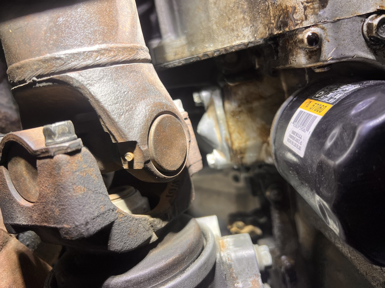

WELL, I think I know where it’s leaking oil hahah.

Don't assume. Where do you think that oil COULD be coming from?
I was about to say the same thing. what's there like 6 places it can leak and show up right there?
the oil filter, the pan gasket right above it is where 60psi oil goes in and out of the filter(where I think mine is from) . the oil cooler/block off above it. the bar bell in the back of the block. the corner of the oil pan, factory had to use RTV on the corners and found some kinda rtv that isn't oil resistant long term, the rear main but less likely and the housing the rear main goes into, more likely.
oh and the oil pressure sensor can be working just fine electrically but leak oil put of the middle of it and run down to the point.
can you hear the annoyances in my post about mine leaking in the same spot haha

You are correct! It looks like it’s coming from the oil cooler block off. I’m going to replace the gasket and go from there.
IMO, I would not reuse the plate because it is likely warped and will leak again. Buy a Billet plate and a new o-ring seal and call it good. Clean the old oil off the whole area and then keep an eye on it for future leaks.

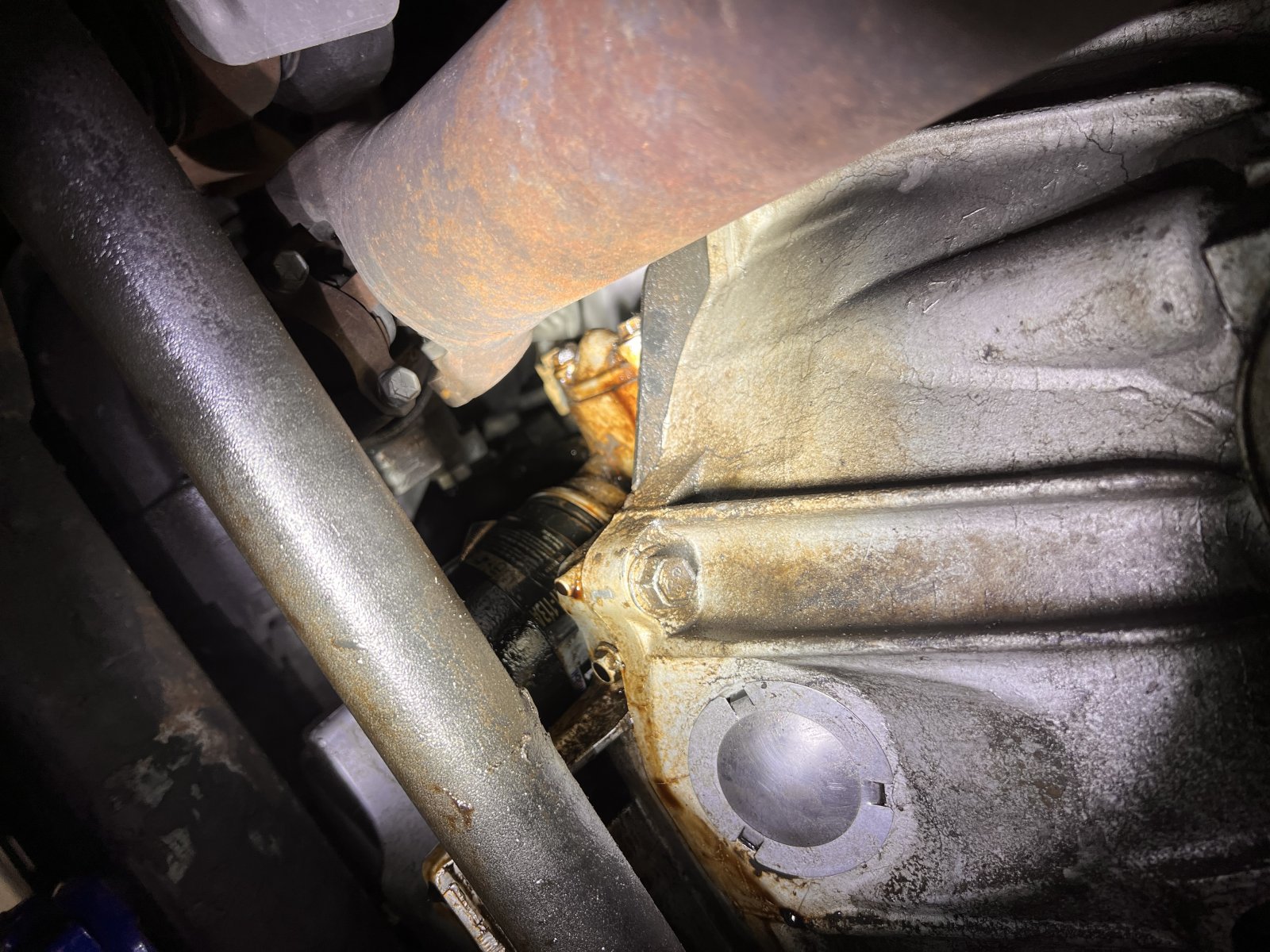

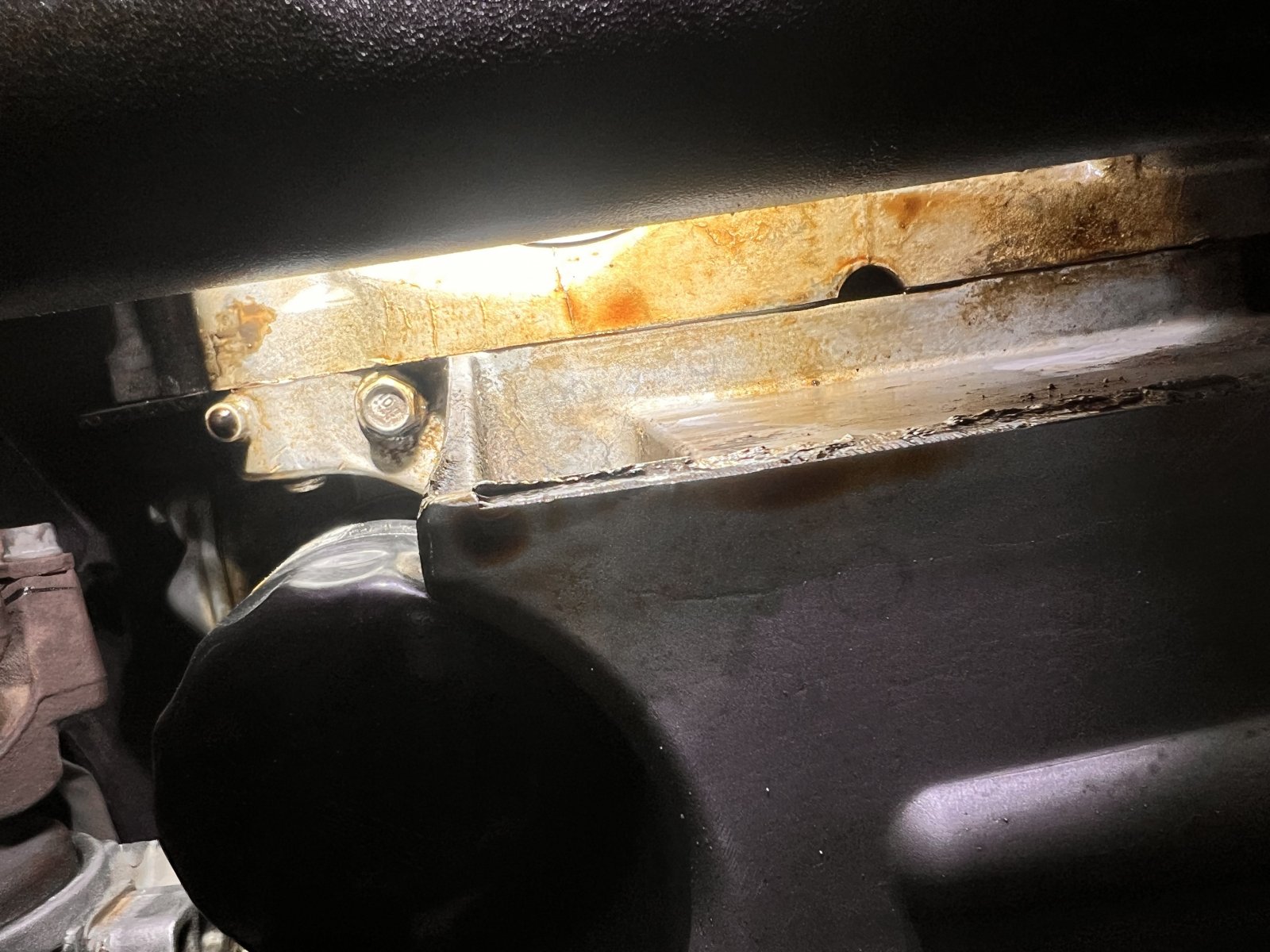

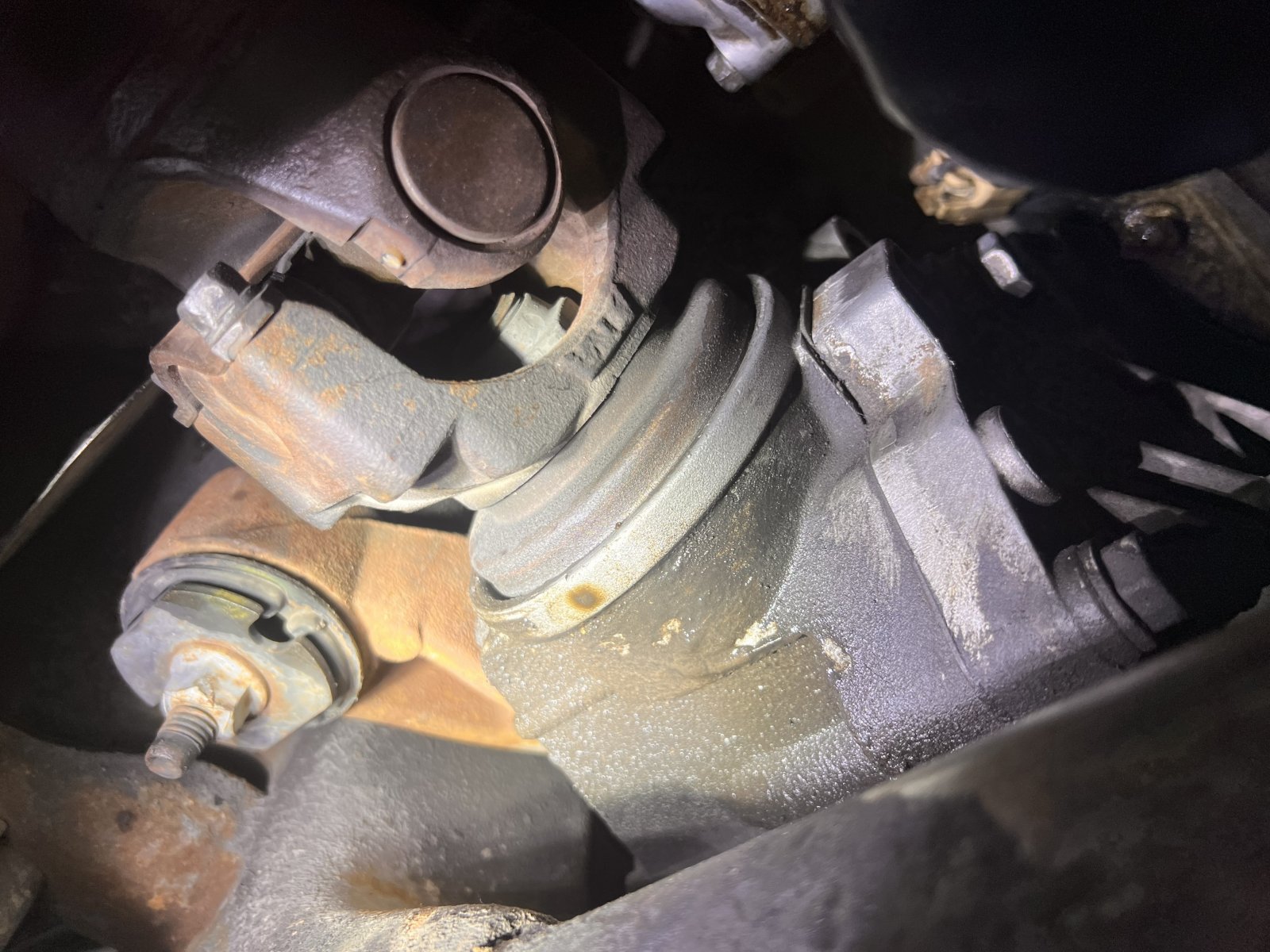

Changed the block off gasket. Drove 180 miles. No more leaks from that section anymore. Now some oil accumulating at the base of the pan and at the top around those bolts. Going to need to track those down, there isn’t oil under the car anymore after it sits for some time. Which seems to be resolved from that gasket replacement.
It looks like there is something accumulating around the diff. I had cleaned that area last night when I changed the oil.

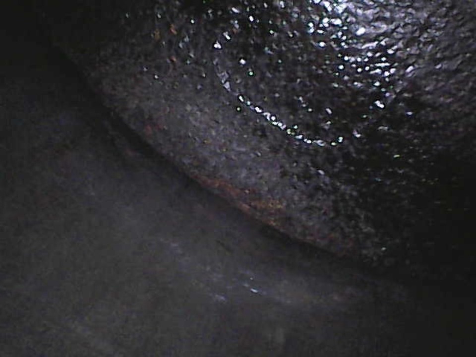

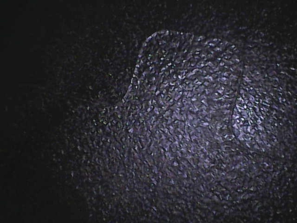

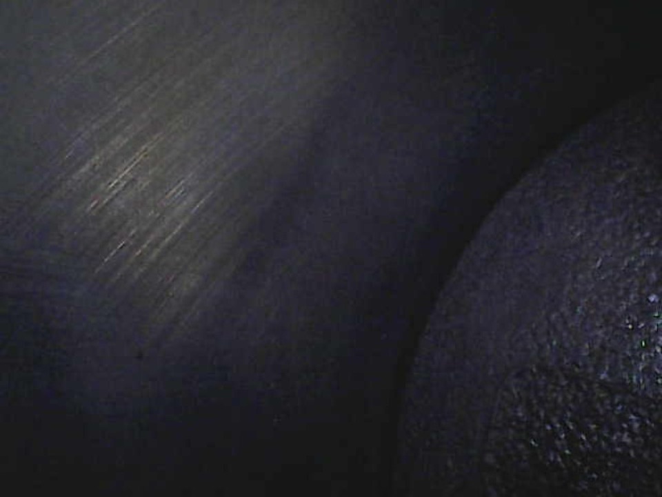

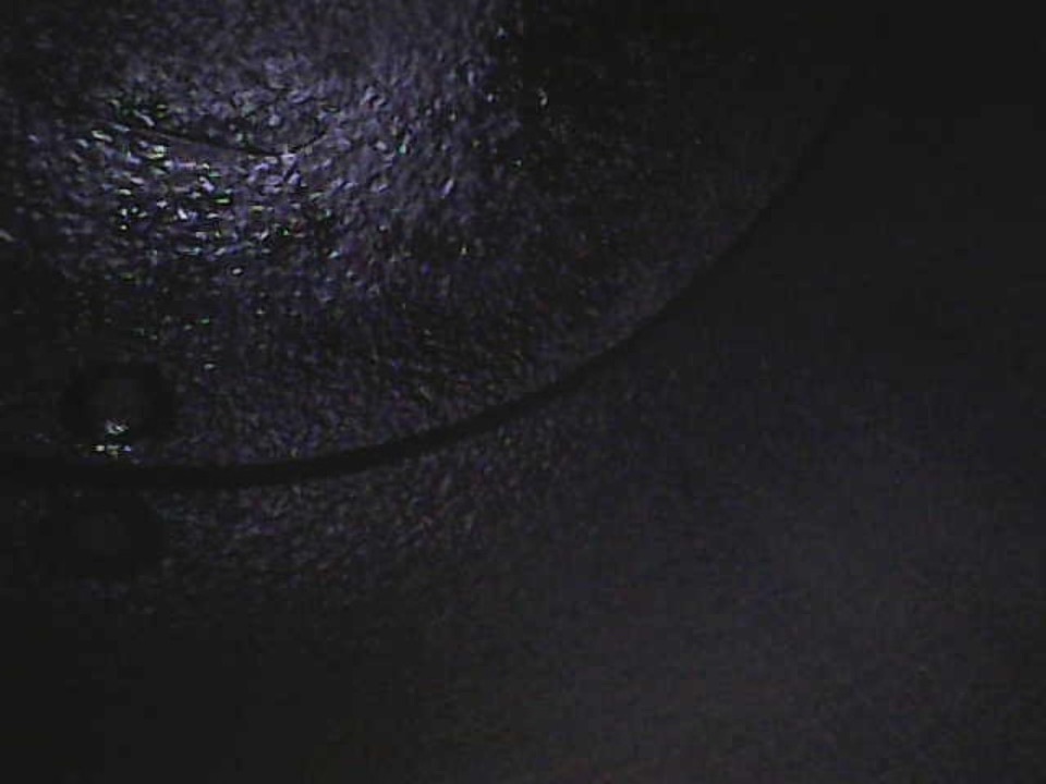

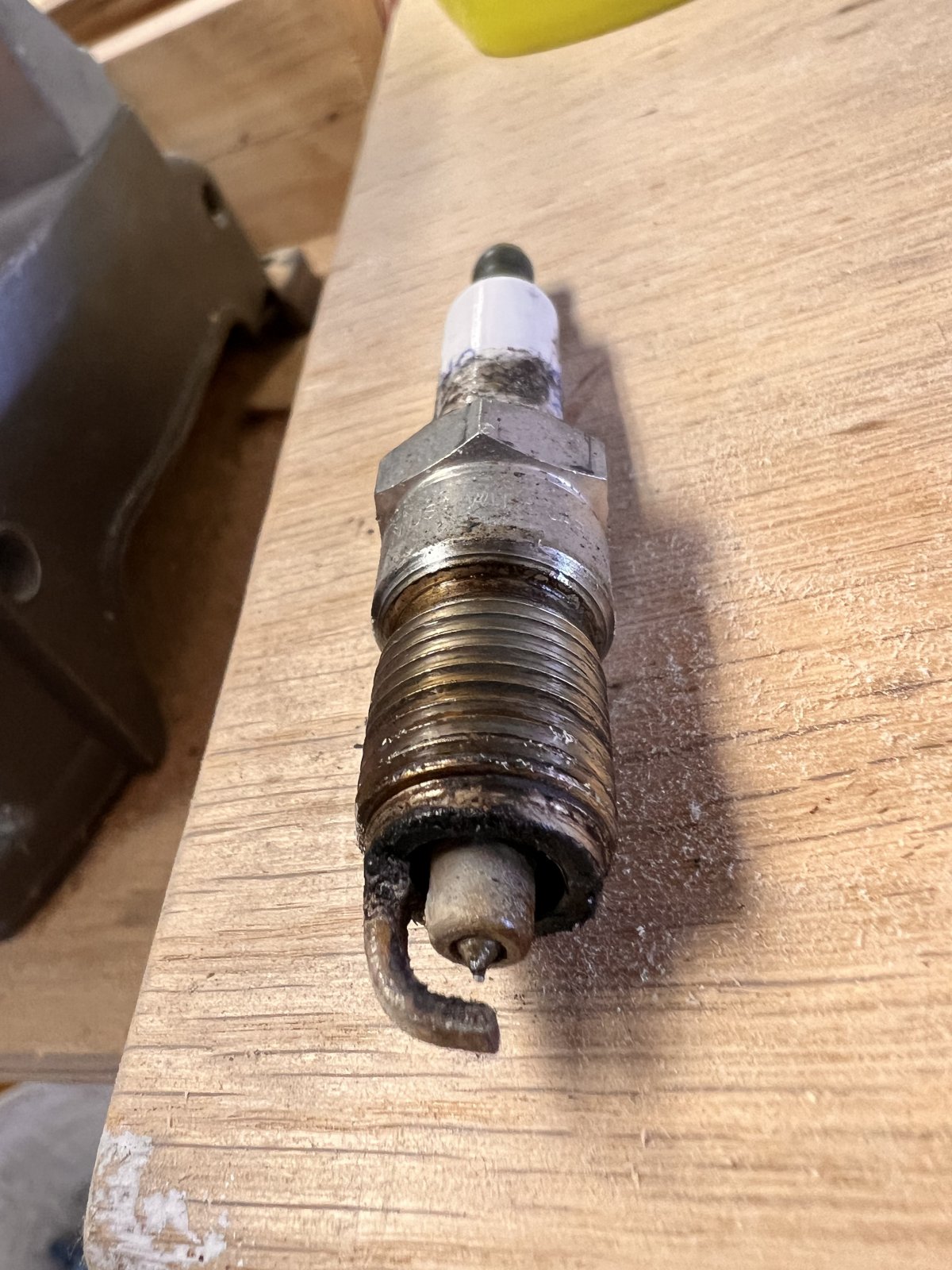

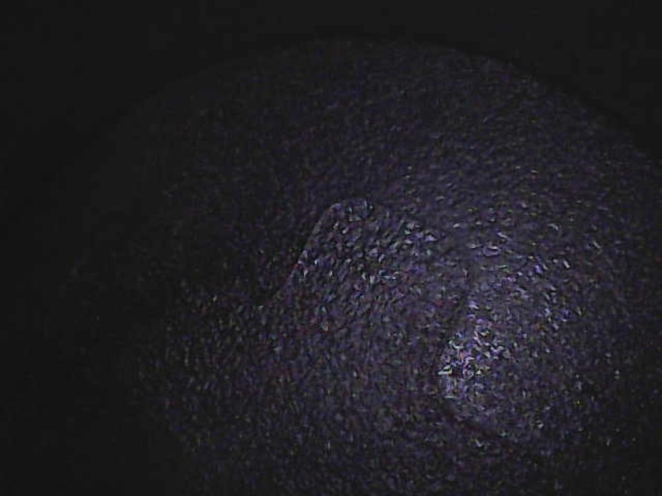

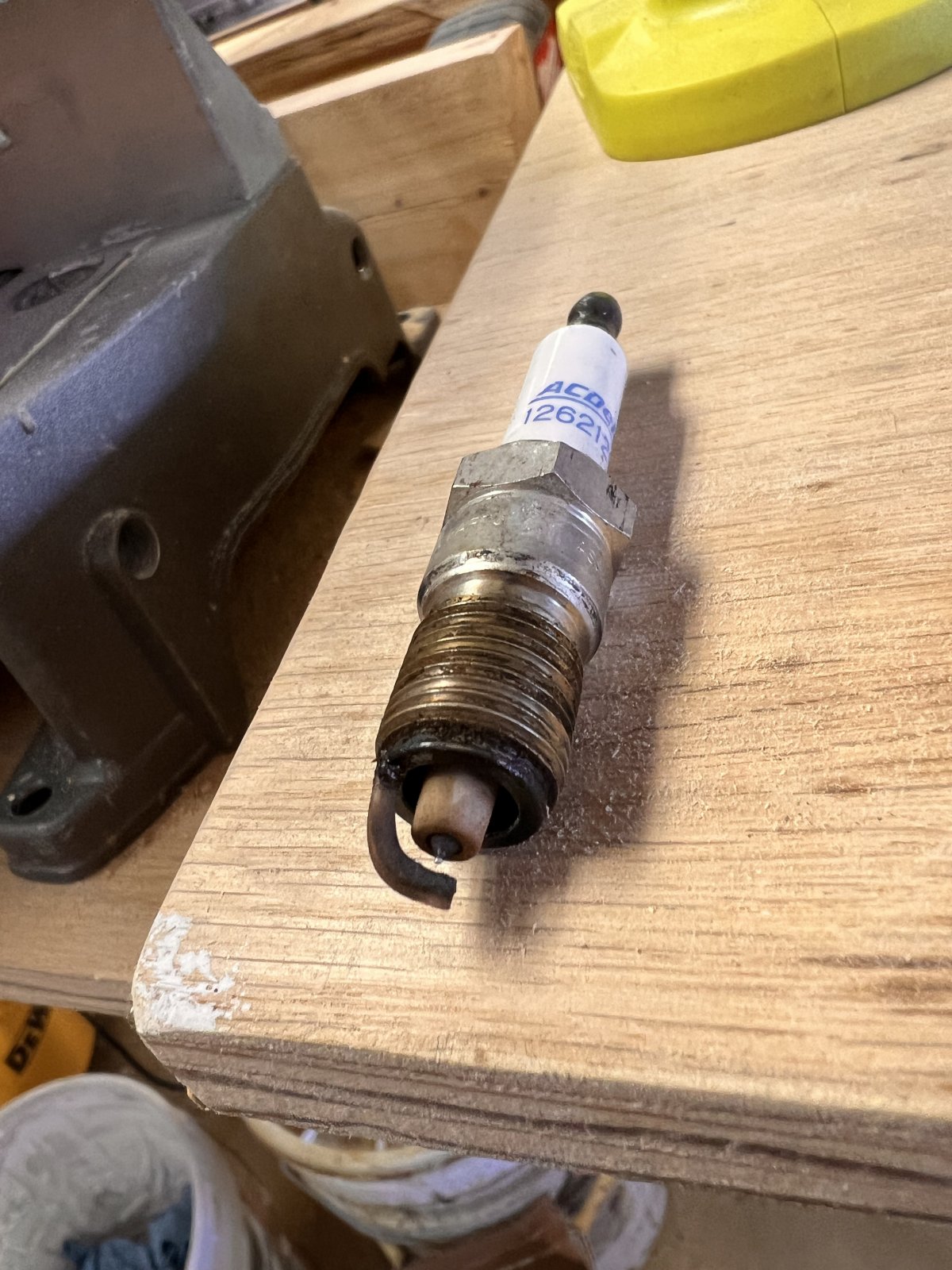

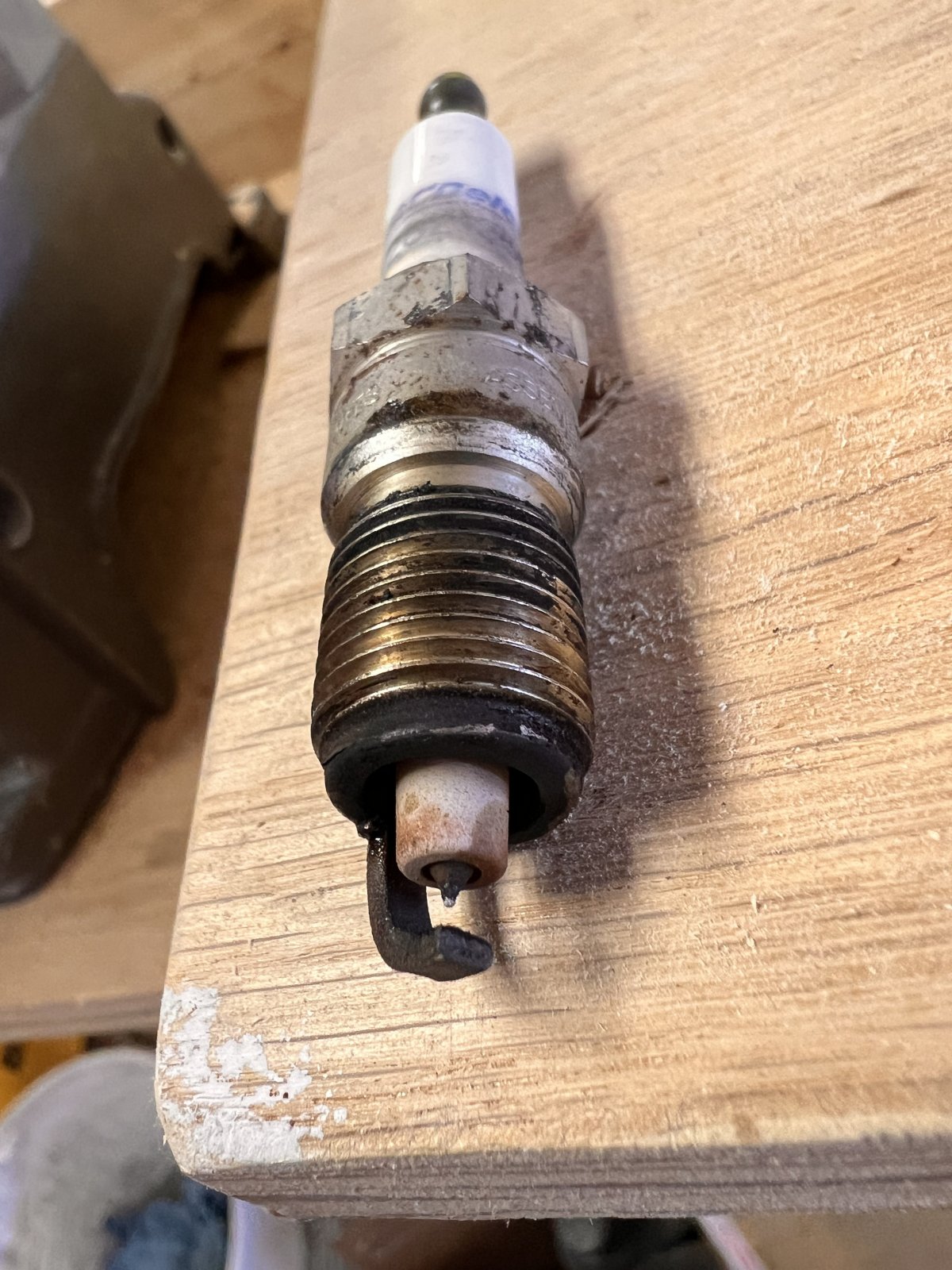

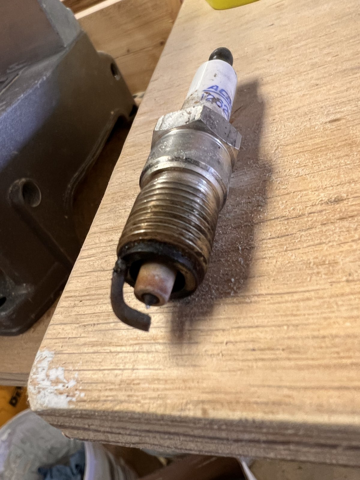

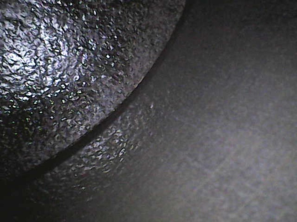

Worked on the truck again today.
- Changed spark plugs and spark plug wires
- MAF sensor cleaned
- Air filter replaced
That #8 plug was kind of a pain, but I decided early on I was going to attack it from the wheel well, removing the liner and everything made that easy.
Old plugs were toast. I've attached some pictures of the plugs and I scoped the cylinders for y'alls enjoyment.
The engine seems to be idling much better, although still some work to be done.

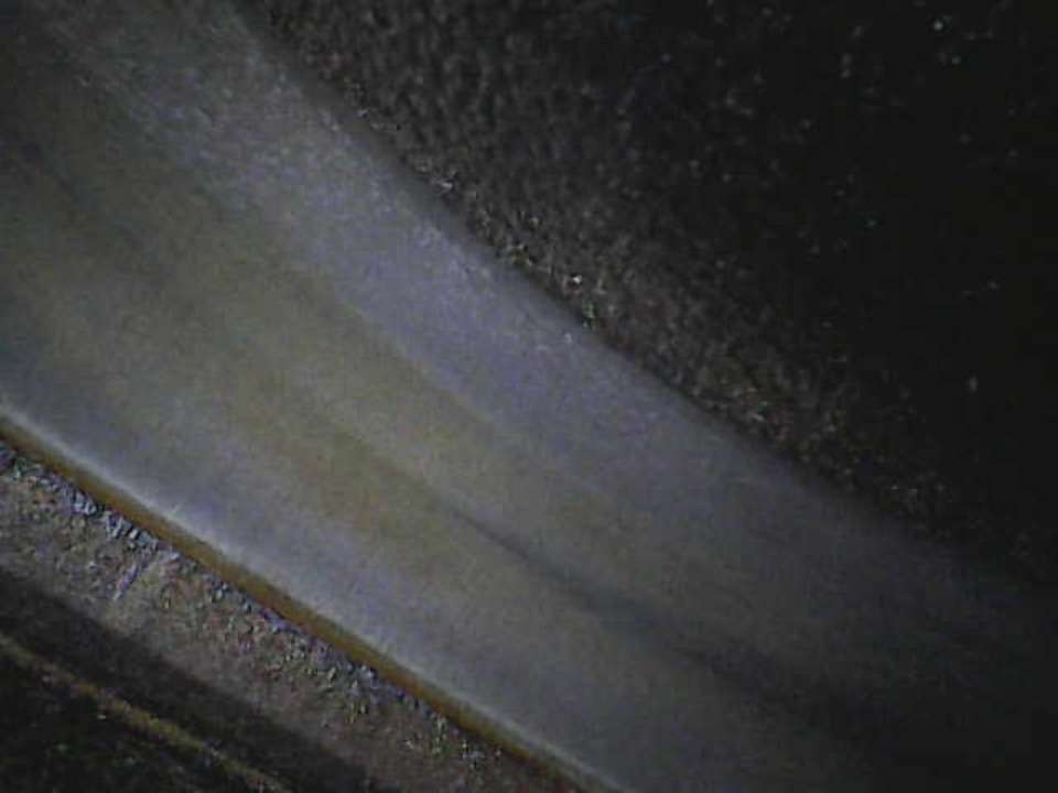

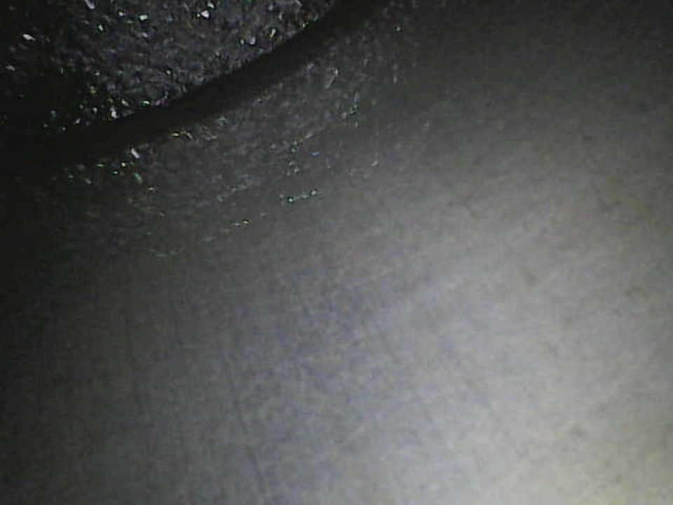

The rest of the cylinders.

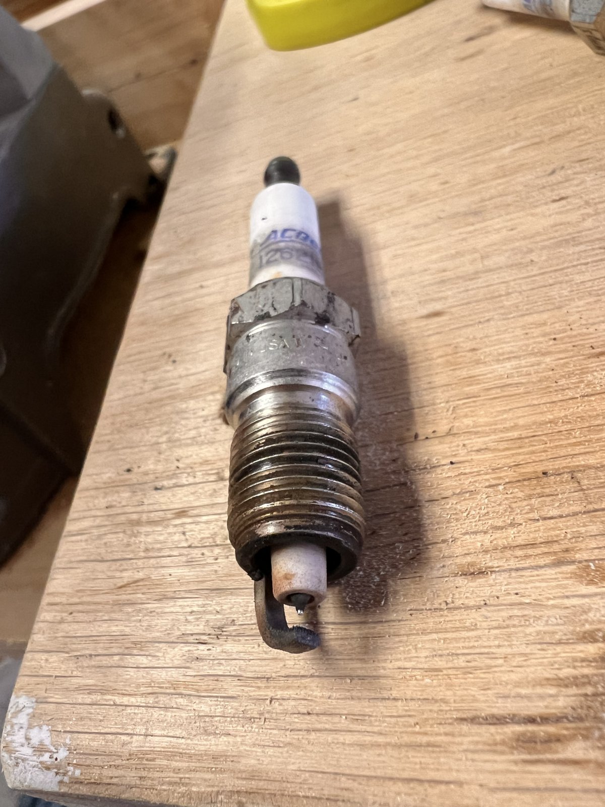

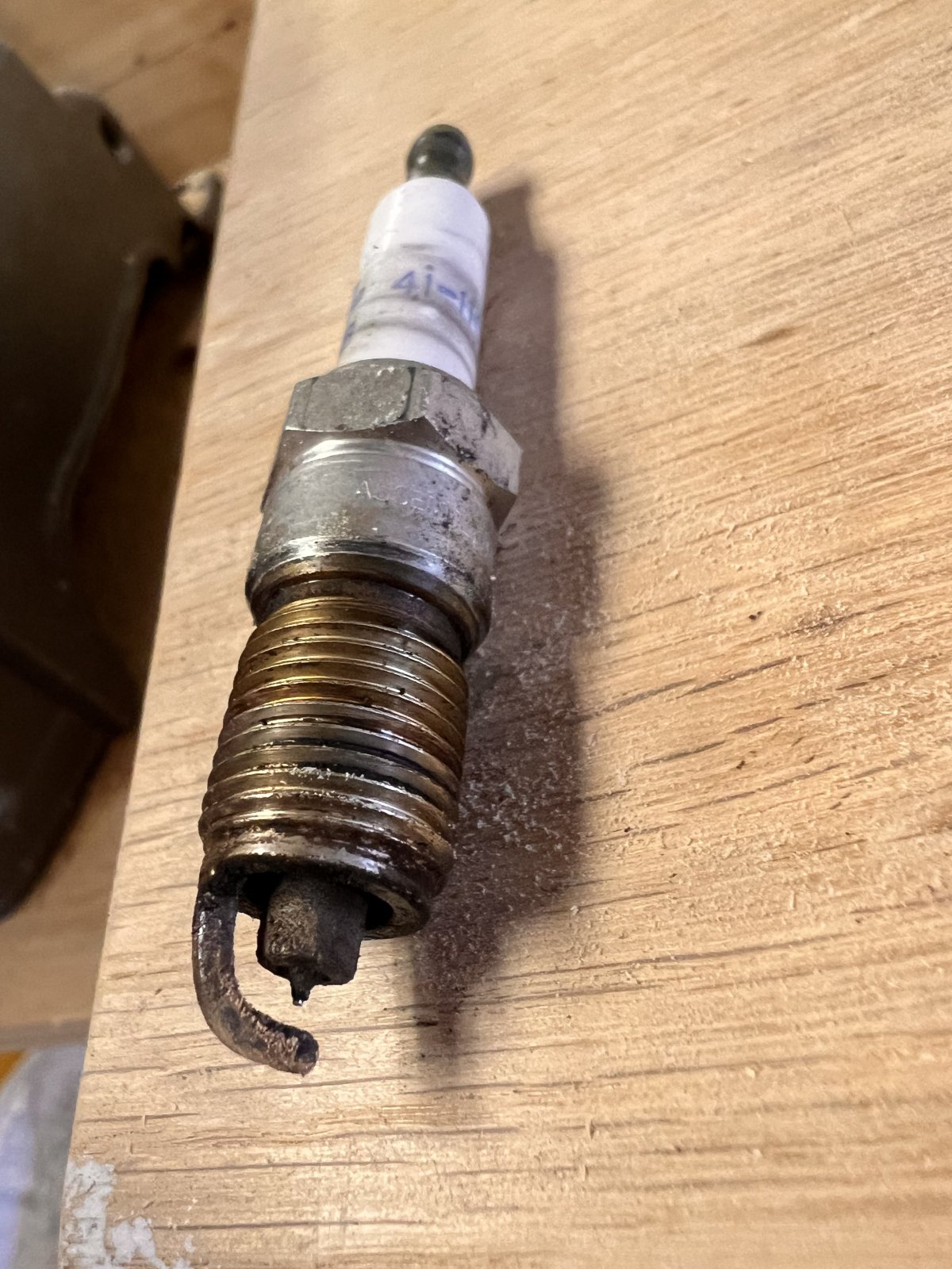

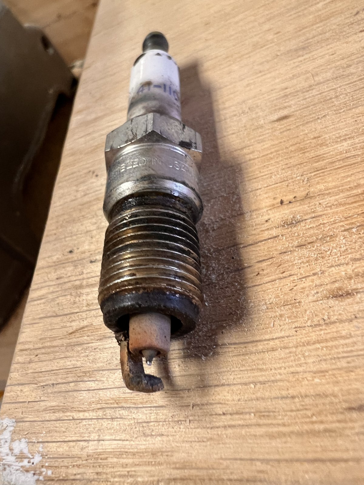

Spark plugs 1,3,5,7

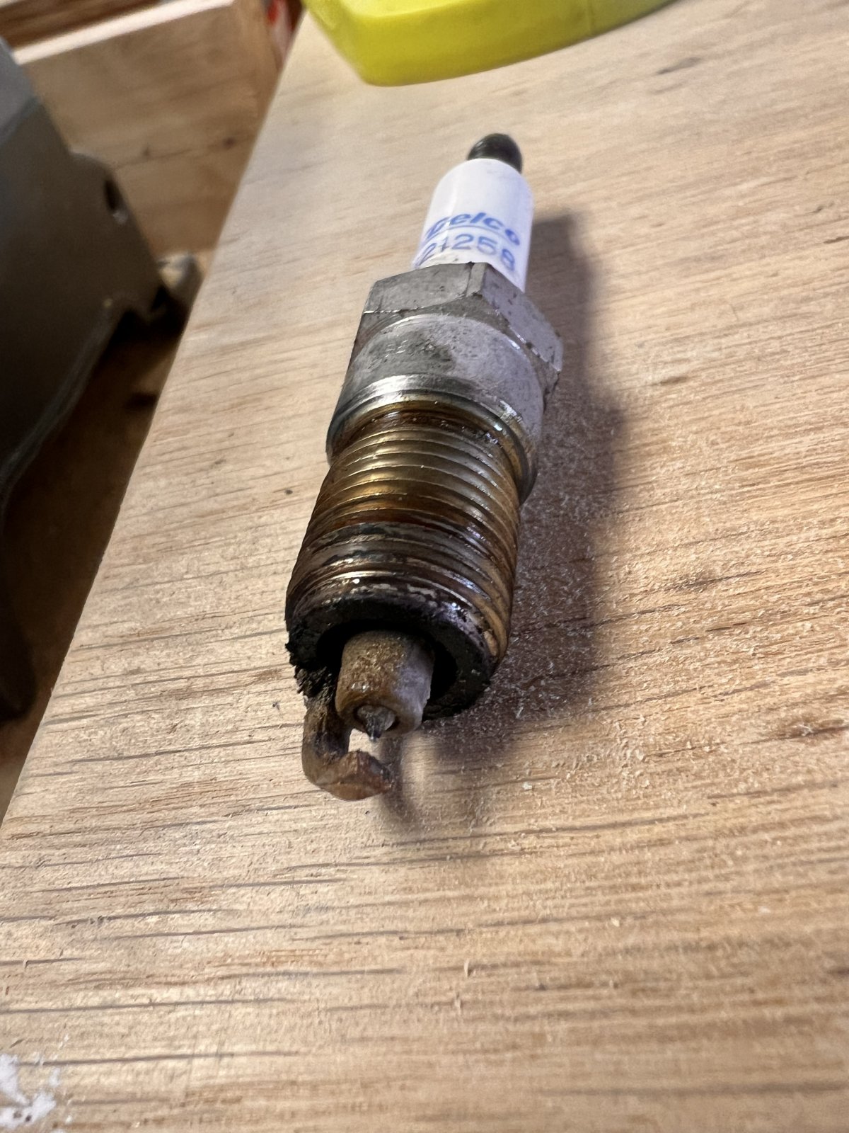

Spark plugs 2,4,6,8
