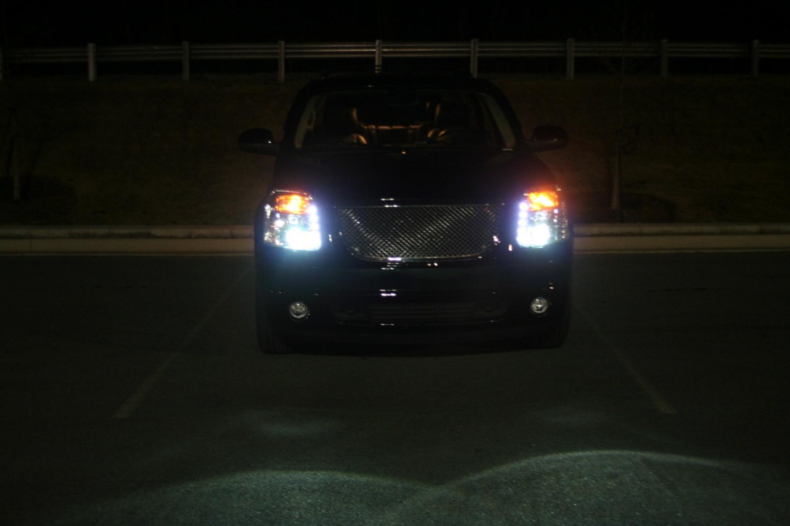

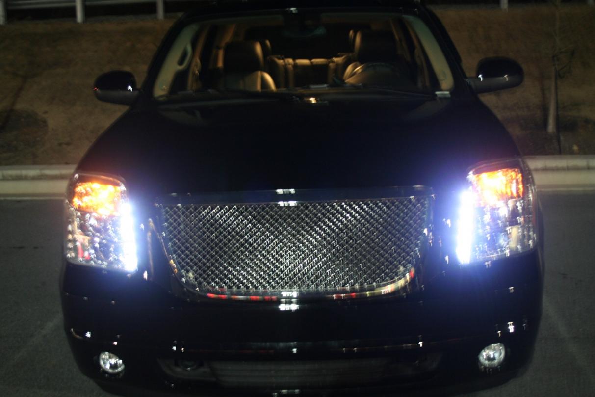

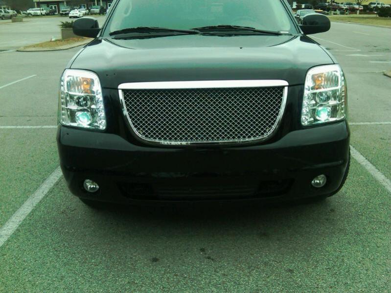

I attached pics of what the Hella halogens that I had in there looked like, then the DDM kit. And some final images of the vehicle.

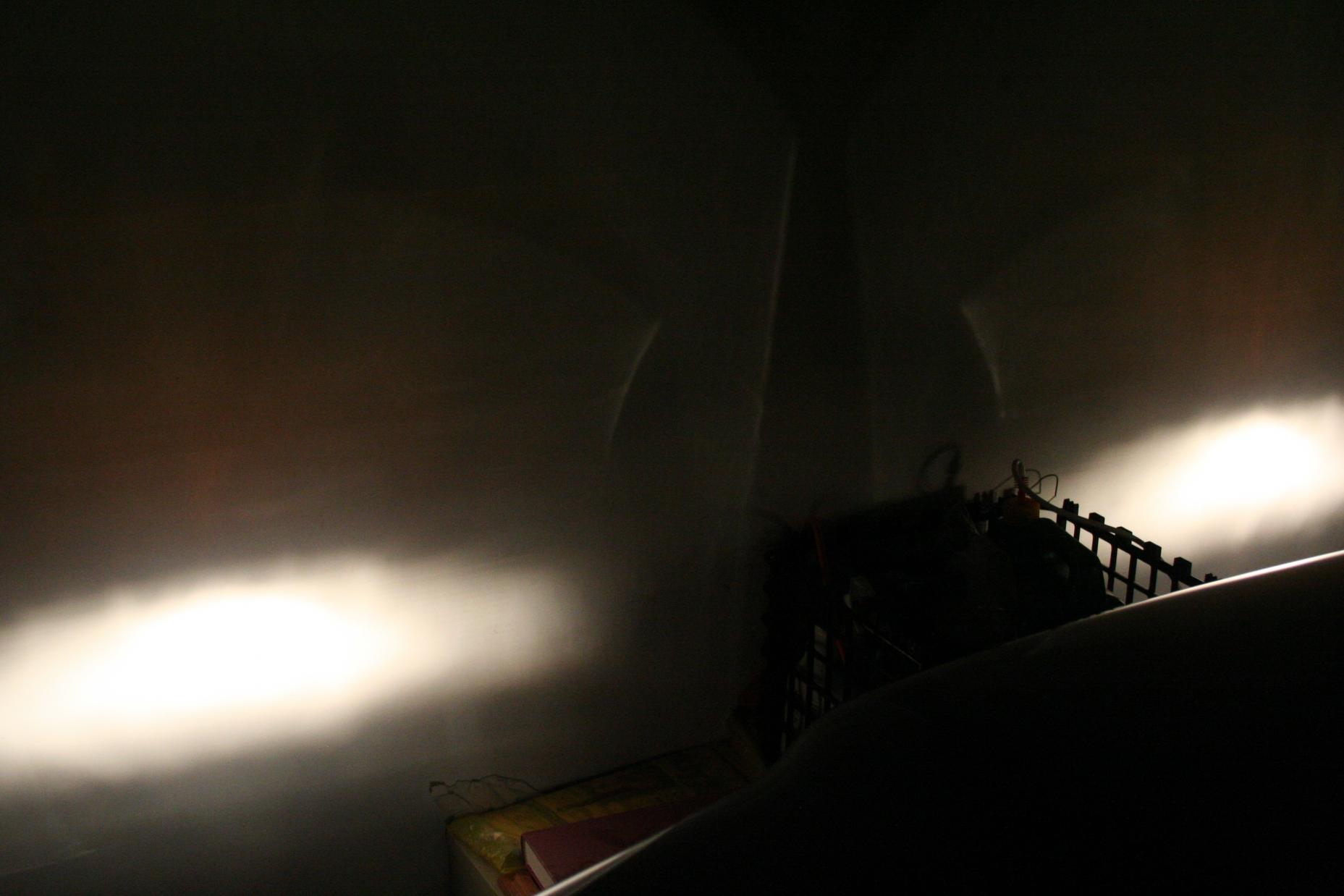

IMG_1813.jpg This is a pic of the stock housing with the 55w hella bulbs.

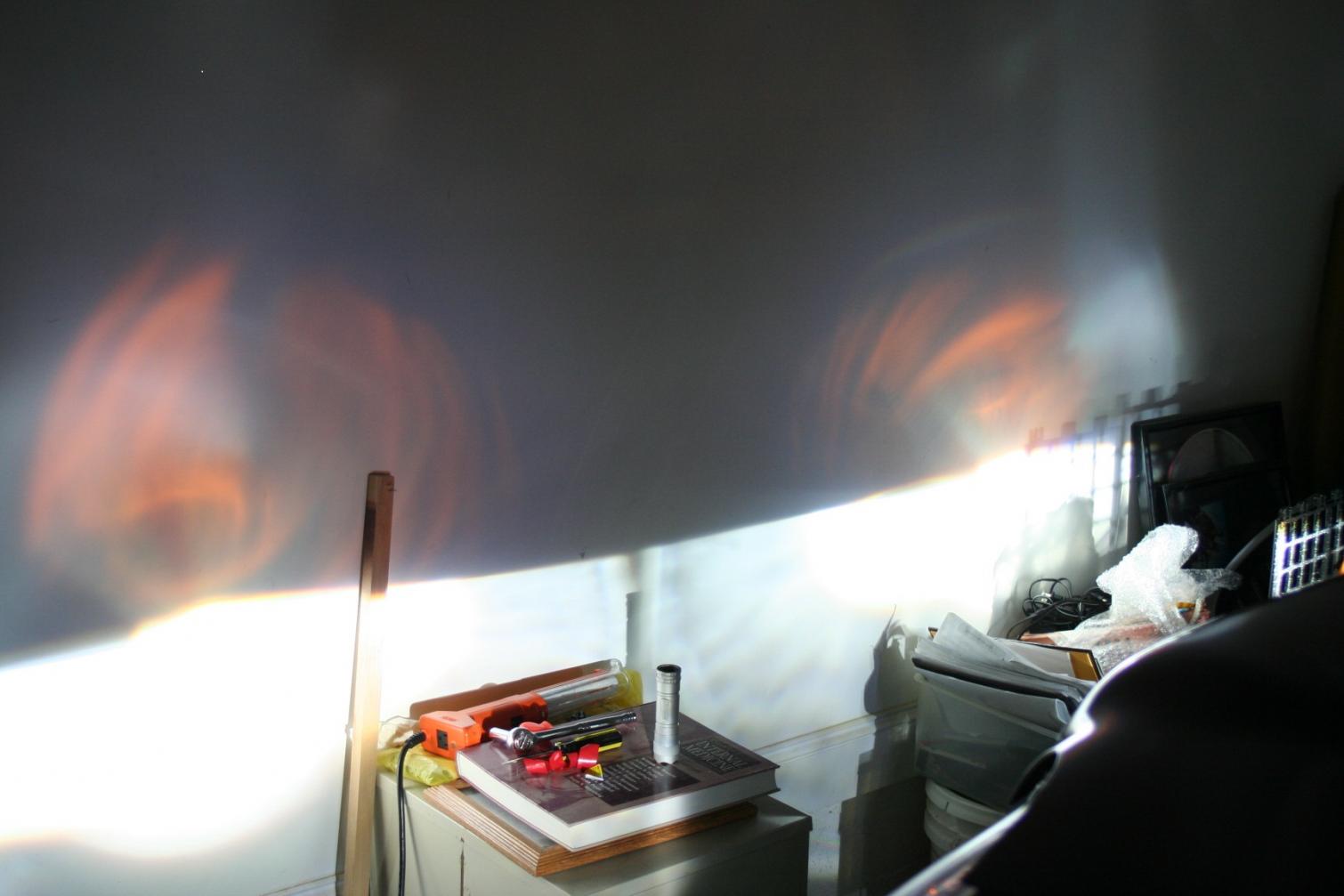

IMG_1815.jpg This is a pic of the projector housings with the 35w DDM kit. Much better output!
