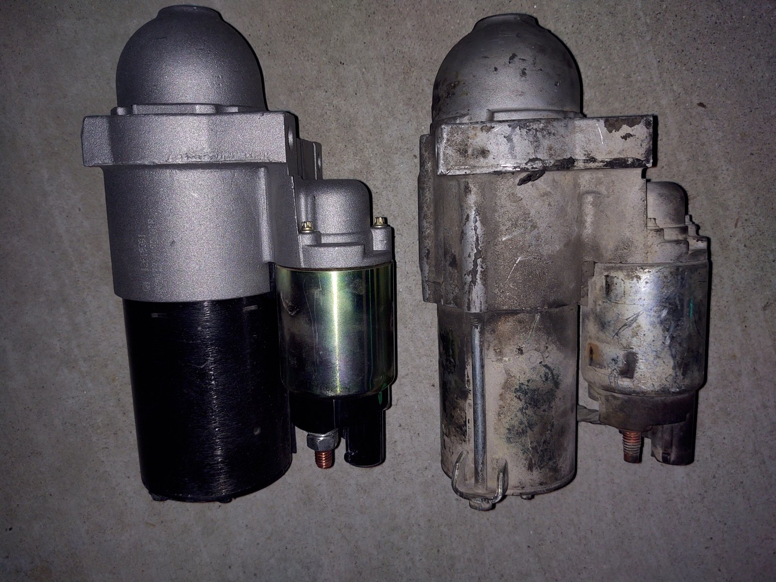

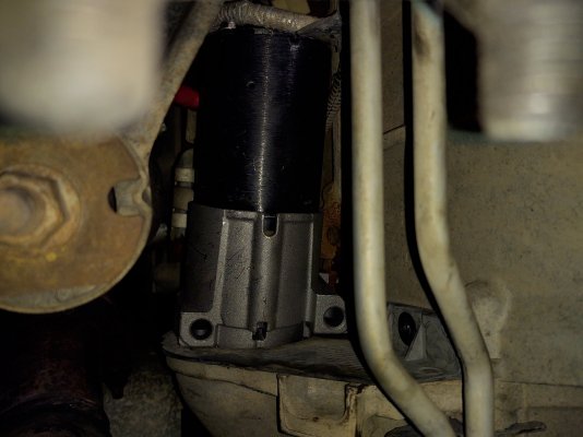

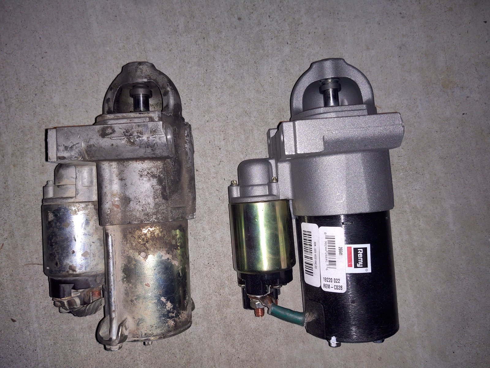

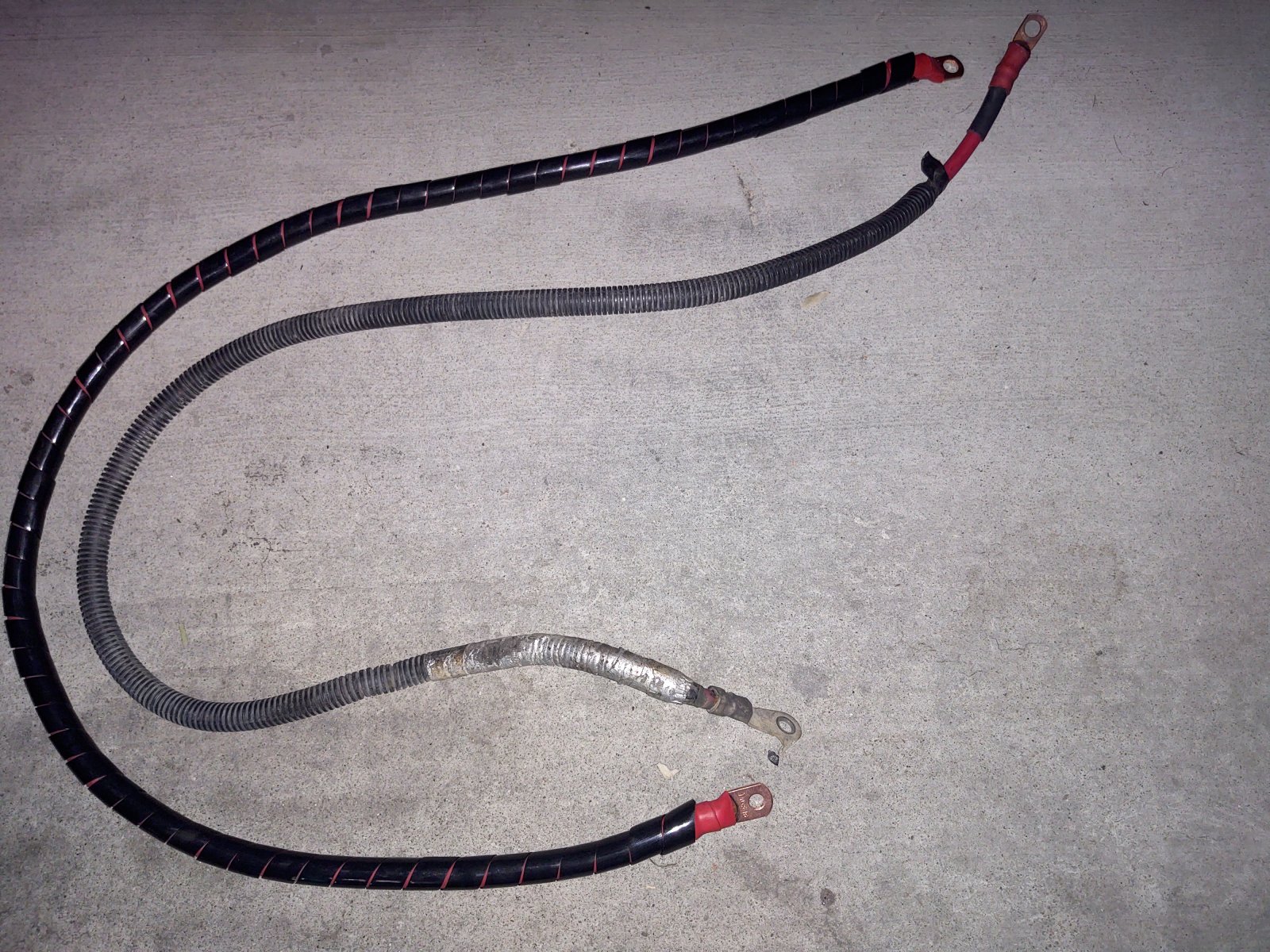

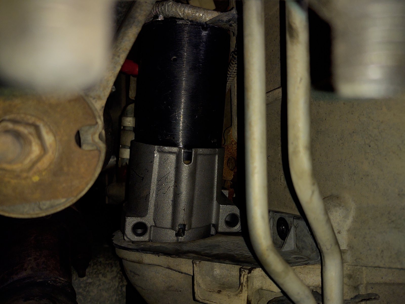

New starter and starter cable.
Made a 1/0 cable and grabbed a starter for a 6.2l. Little bit larger motor, sounds a bit different, doesn't really crank the engine any faster.
I'll have to try to upload a video later.

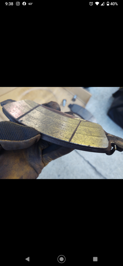

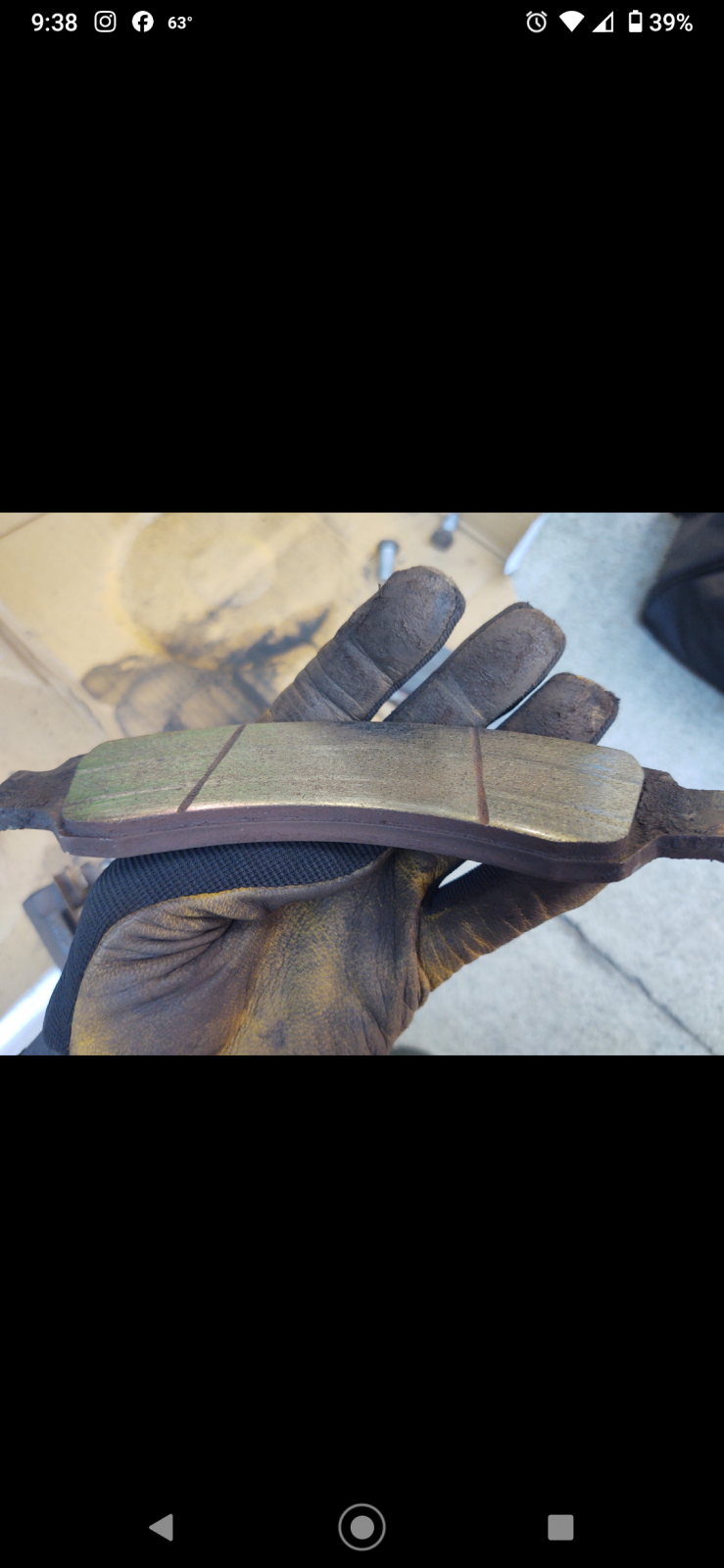

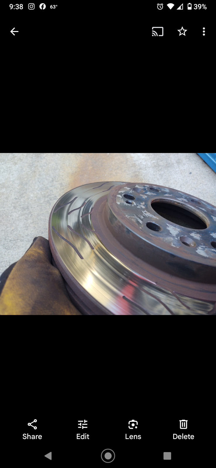

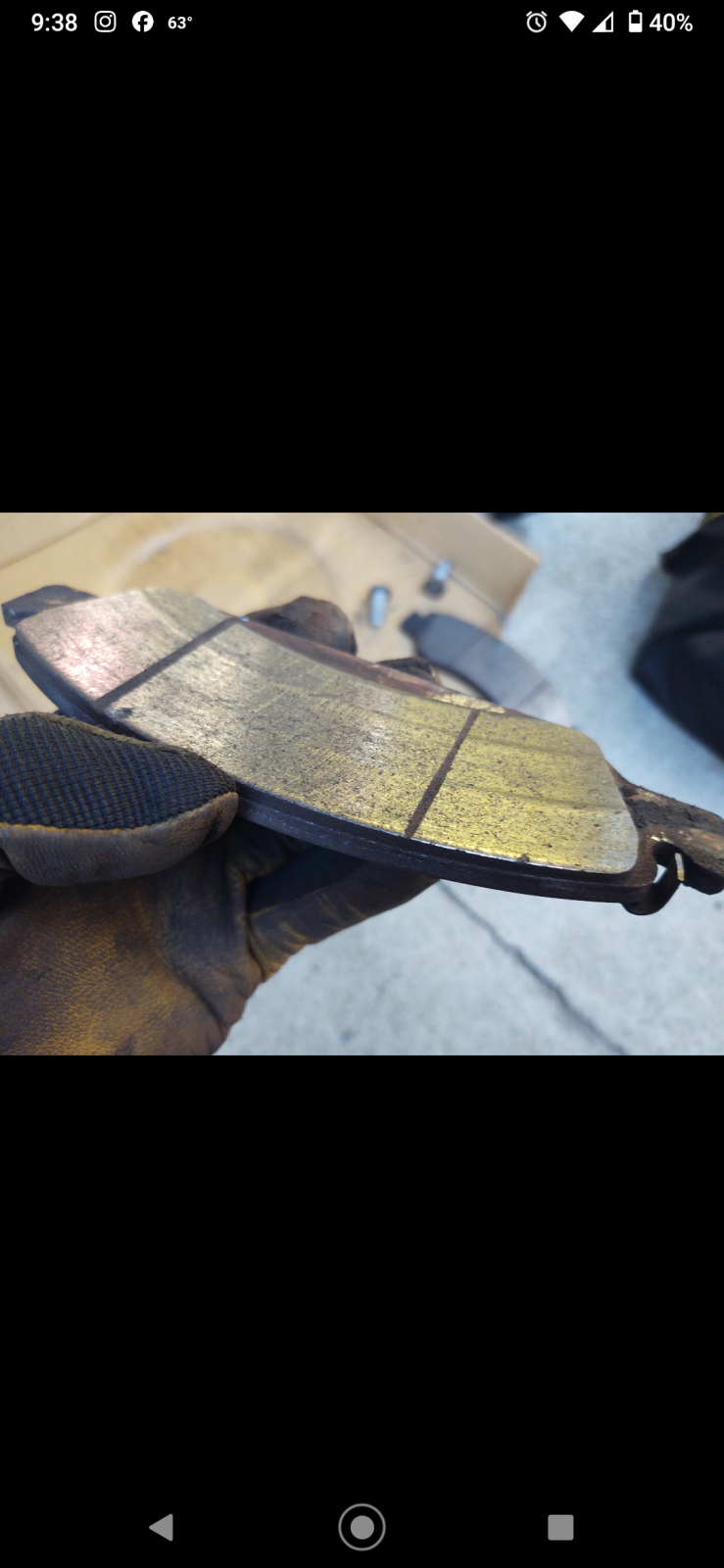

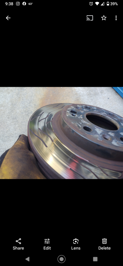

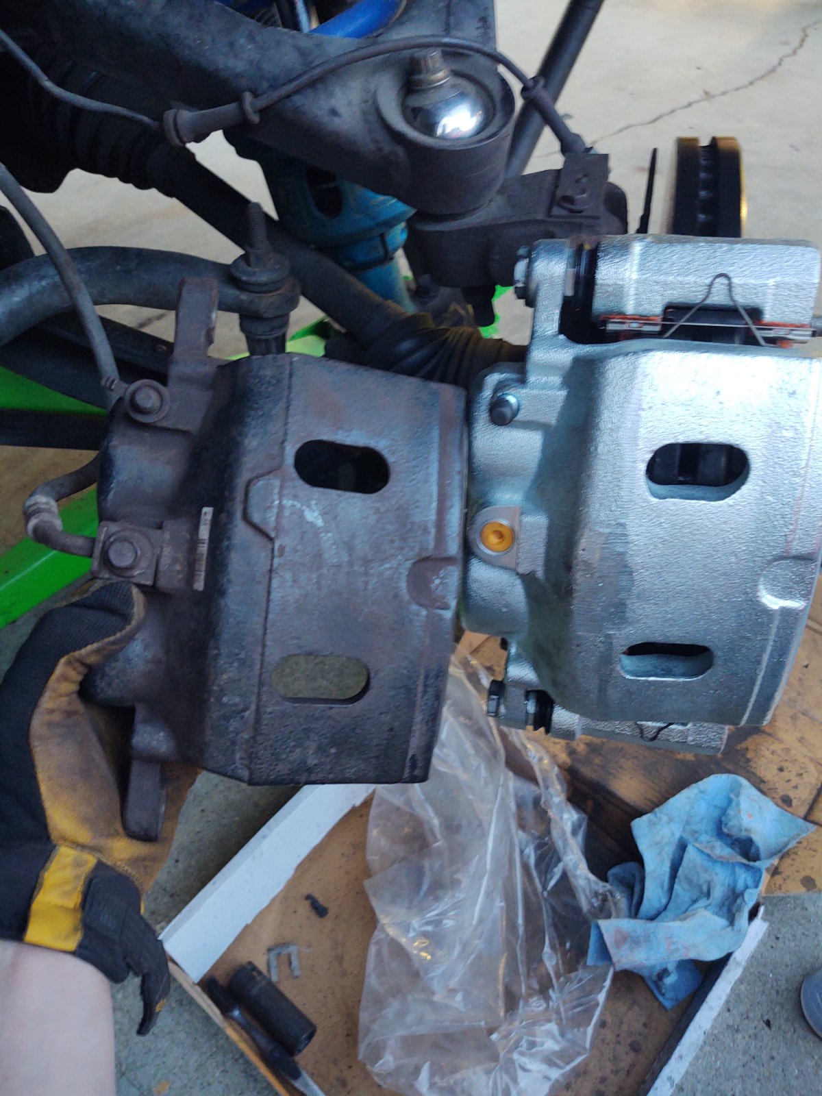

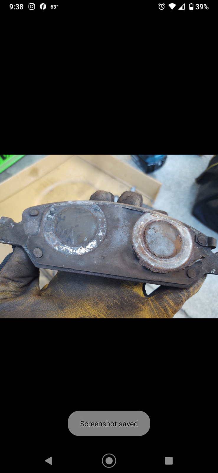

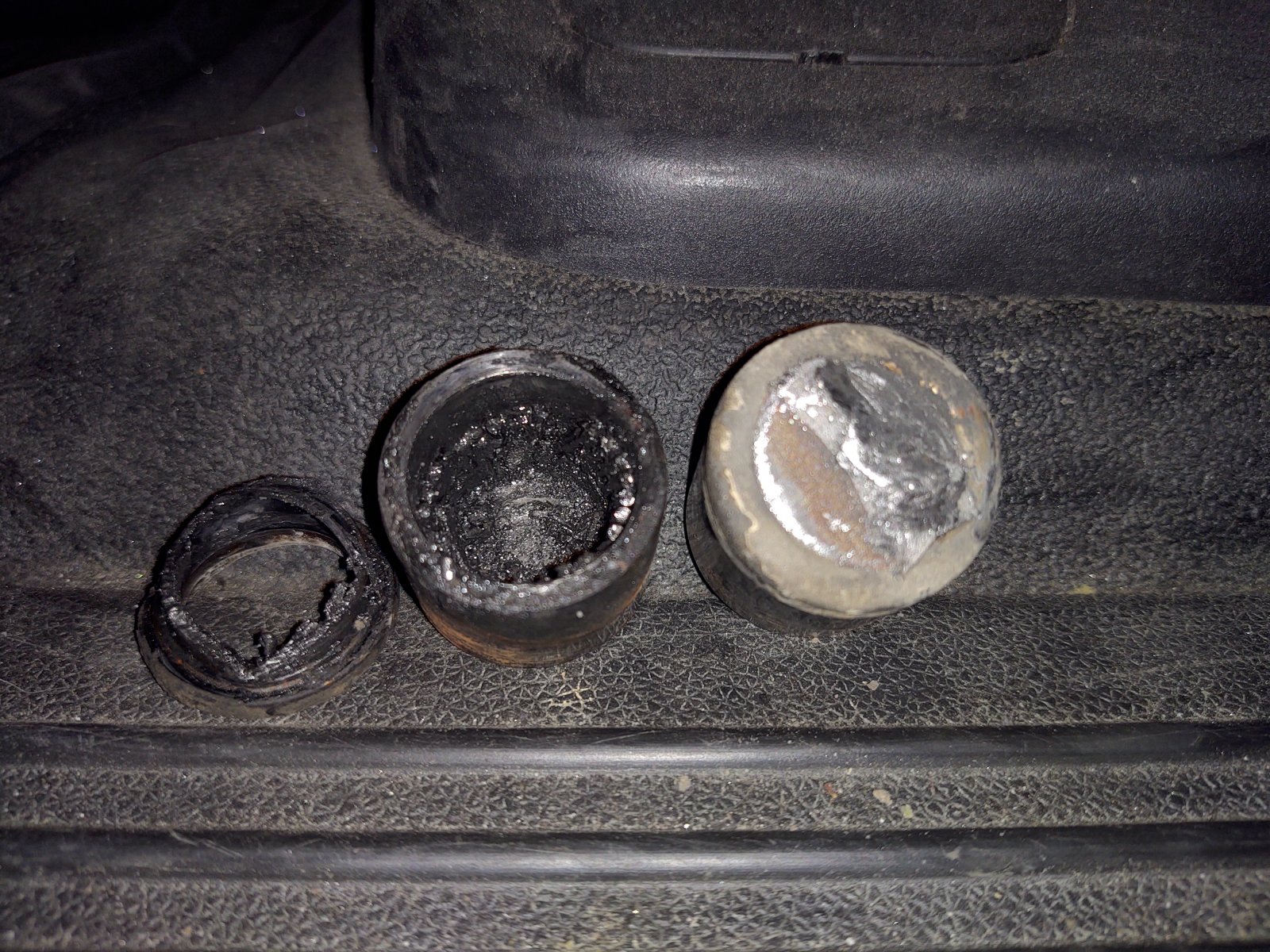

Finally wore out the old raybestos specialty police pads after 60,000 miles
The original calipers at 182.5 k Mi we're starting to make a lot of noise and not function properly. One piston was seized. Causing the pads to wear on one side.
The raybestos r300 rotors fared pretty well, for some reason on both fronts, there were two grooves right in the middle of the pads and rotors, inside outside, passenger side driver side.
And there was a decent lip forming at the edge of the rotor as well.

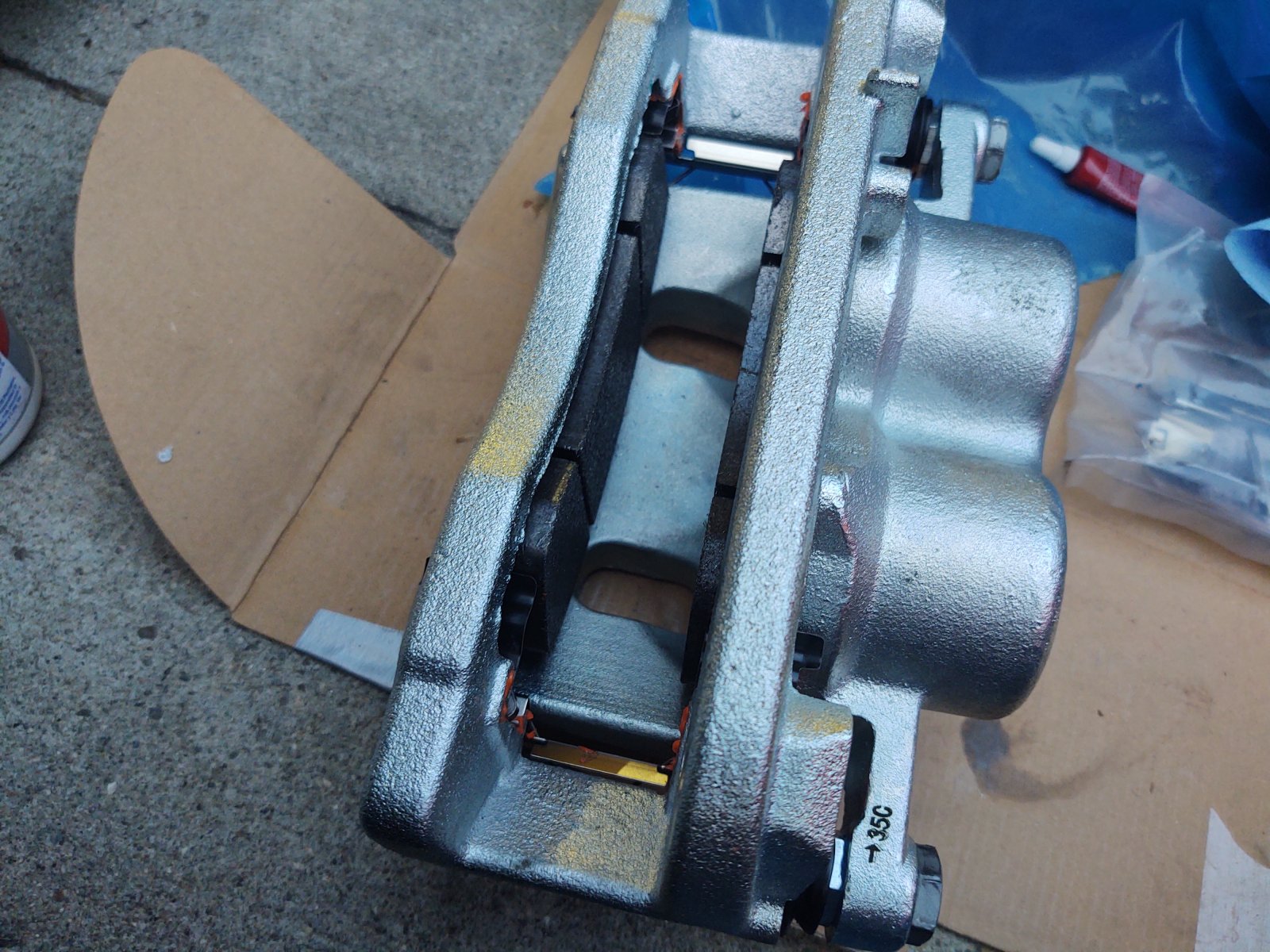

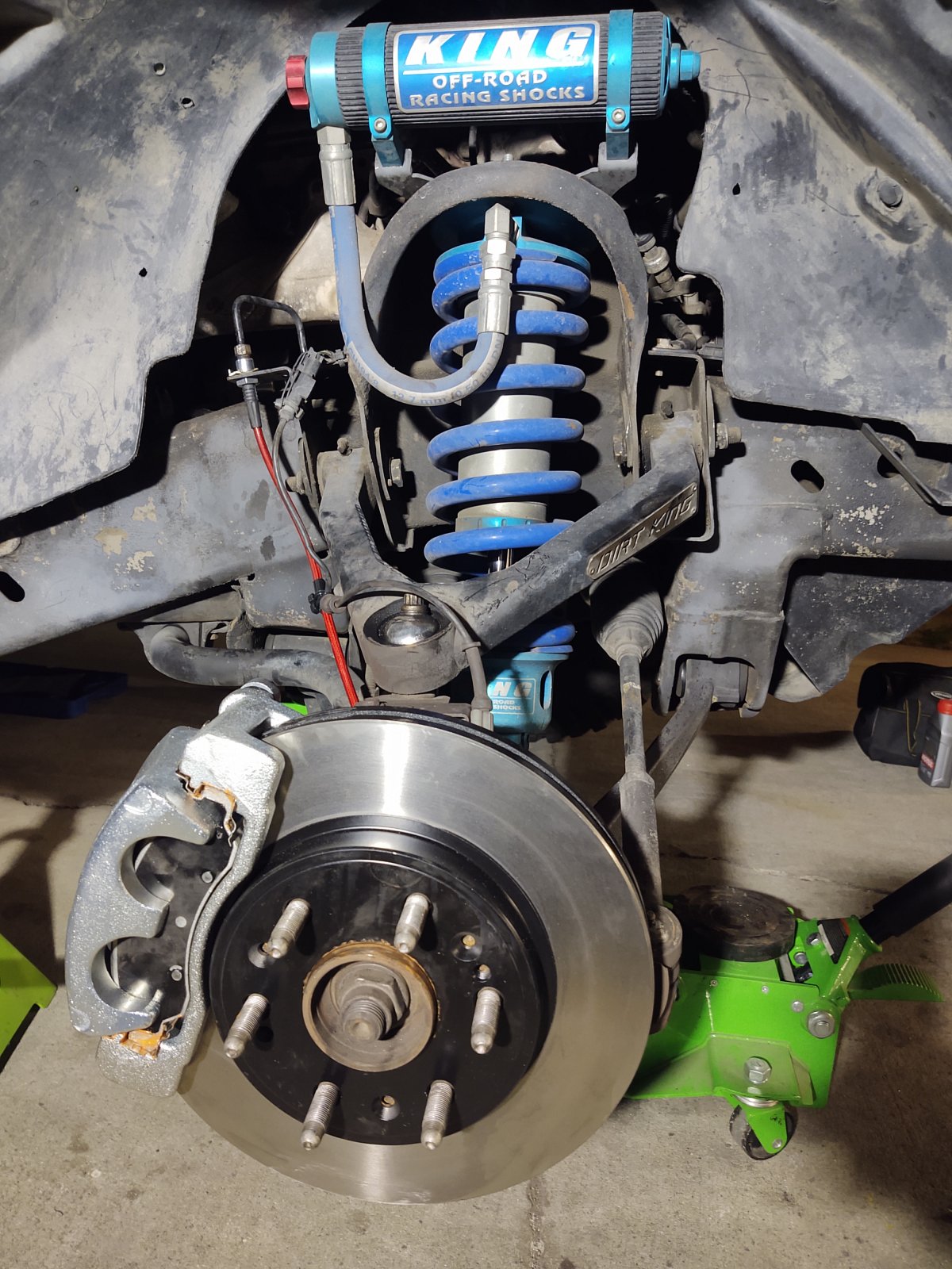

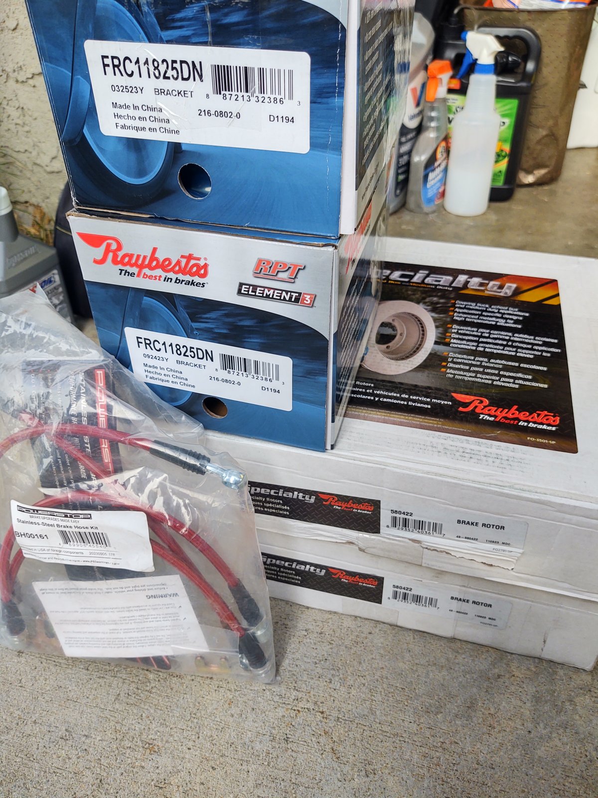

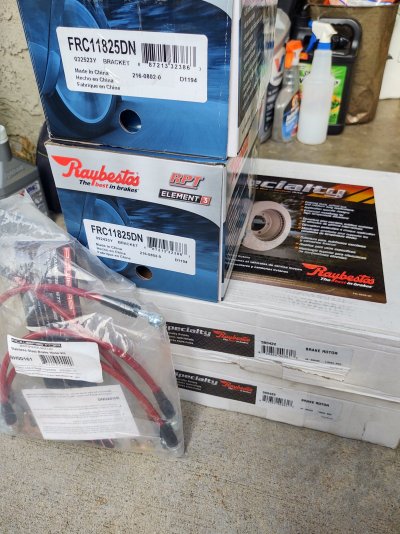

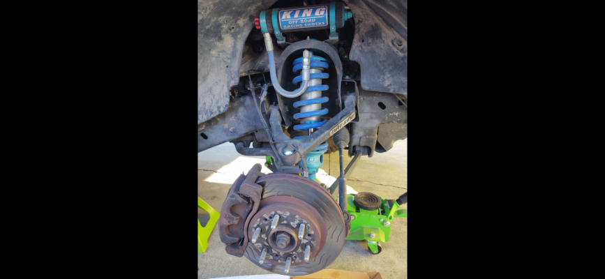

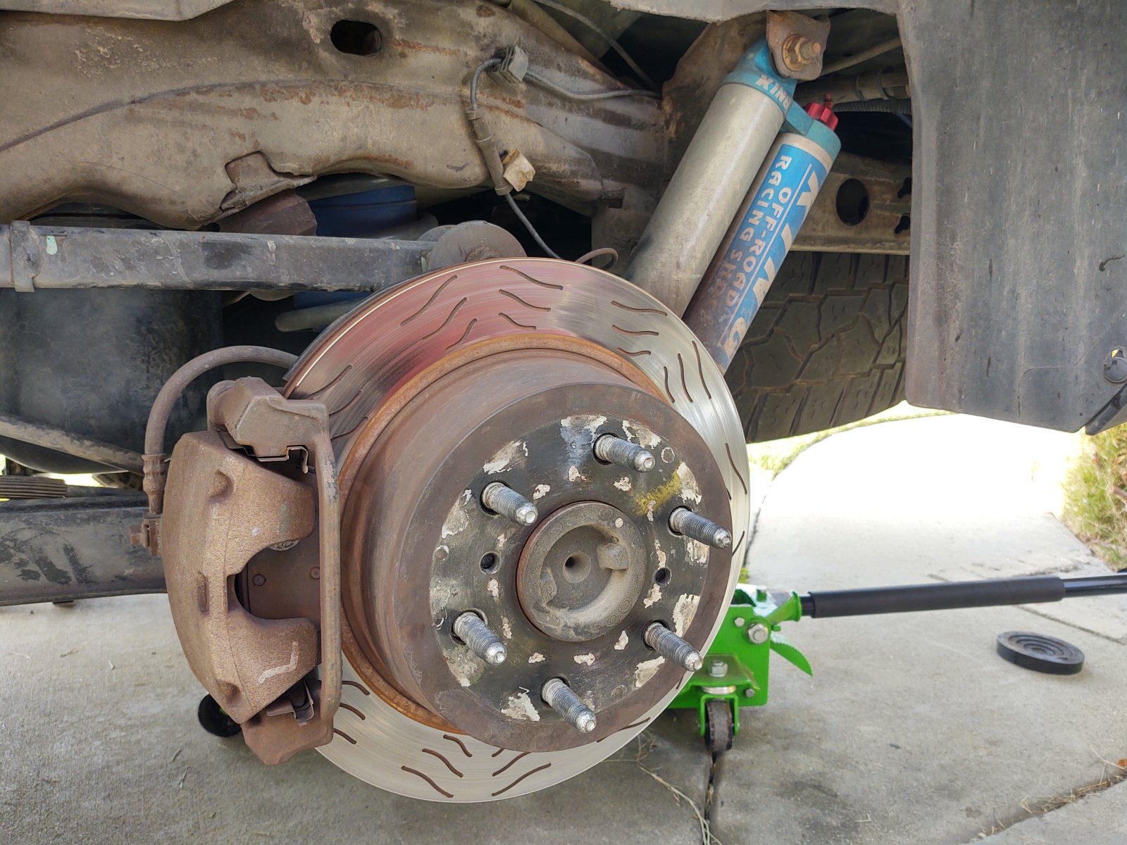

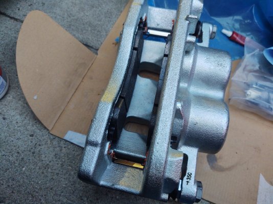

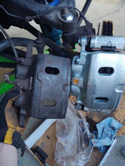

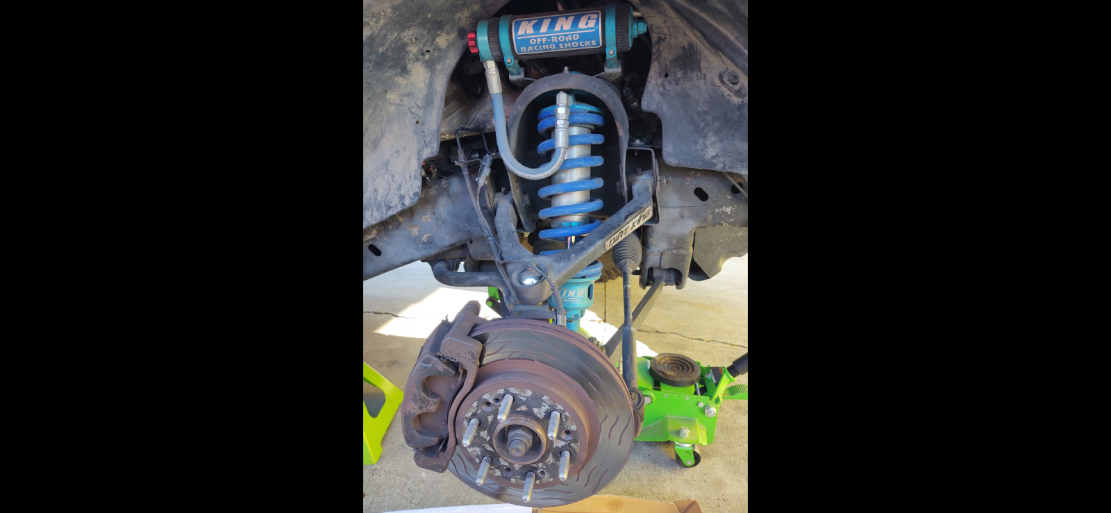

Got some new raybestos specialty police pads again since they served me well, and through on some high carbon rotors this time as well as their E3 calipers.
Topped it all off with powerstop braided hoses, unfortunately, they're red.
Bleeding the ABS module is a very annoying process though(noisy).
And now that I've done those, I can hear the rears squeaking also... And found a coolant leak somewhere around the radiator.
At least the dirtKing control arms and kingshocks coilovers are holding up very well.
Wheel bearings are still in great shape also.

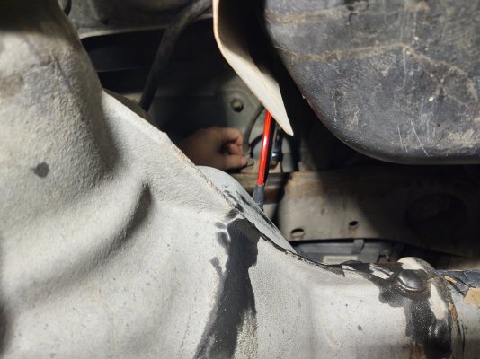

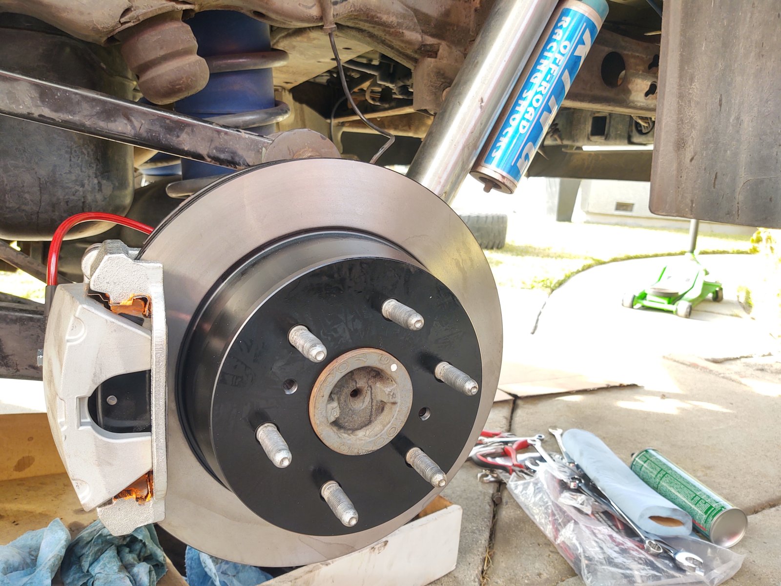

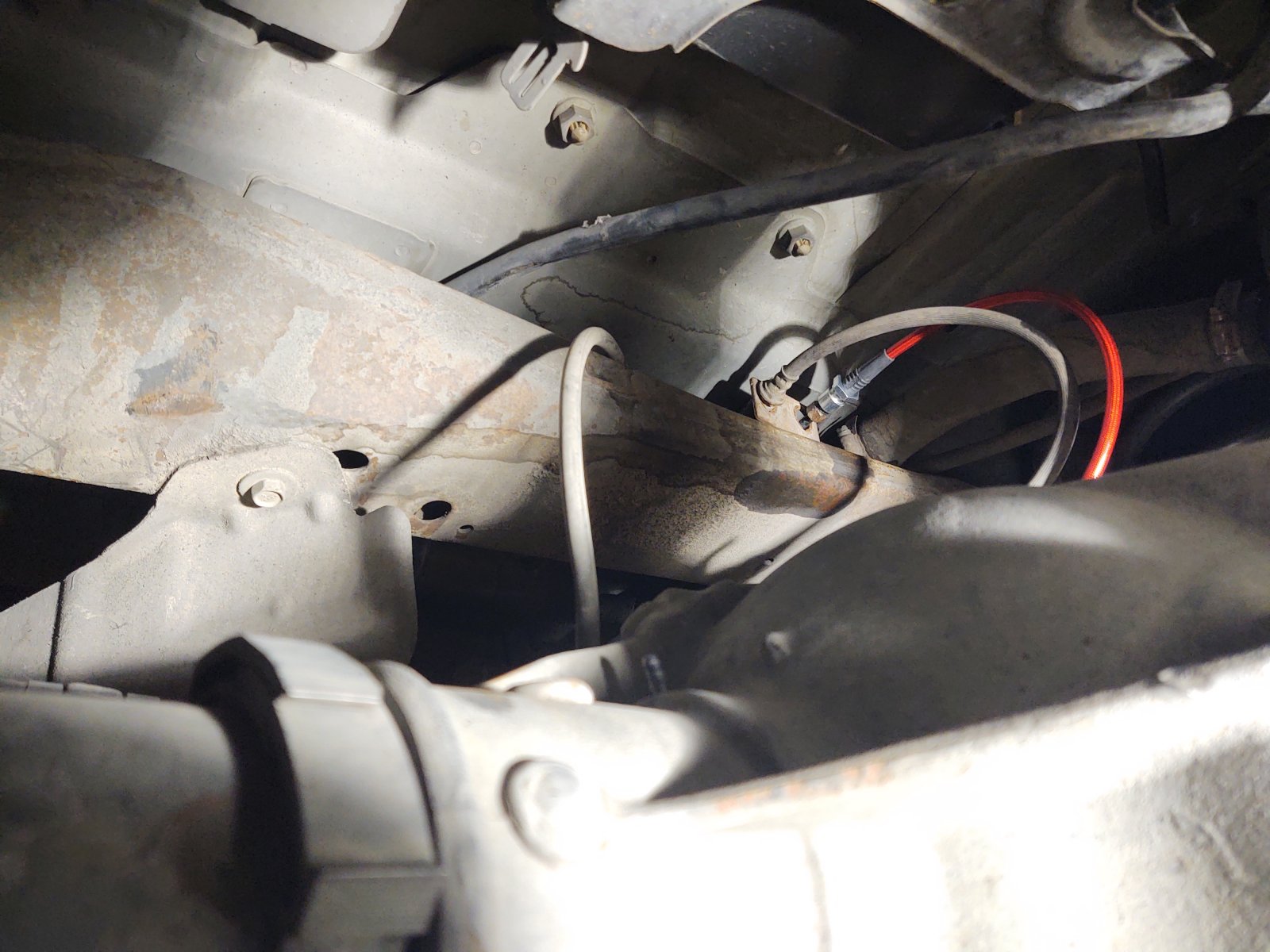

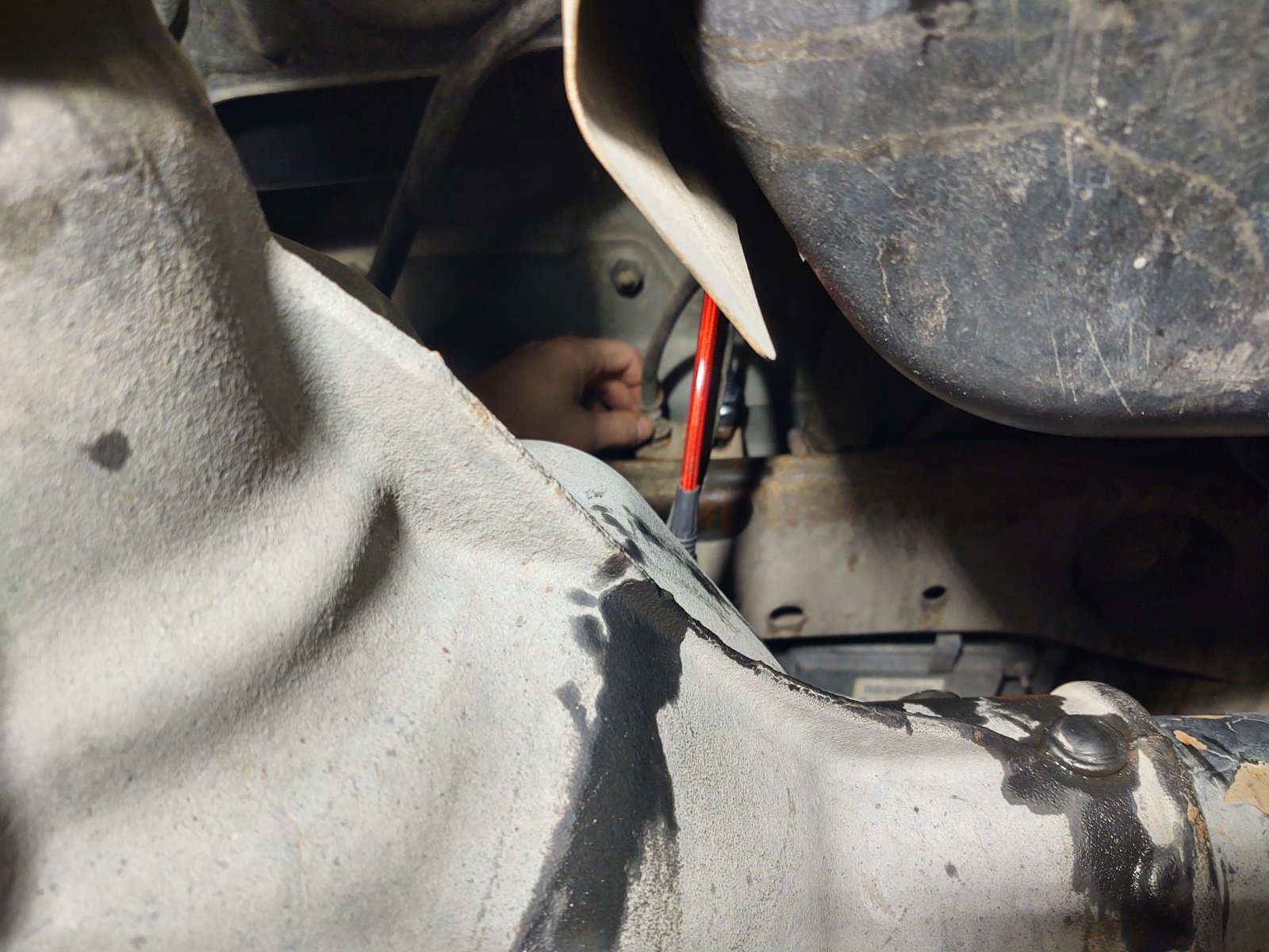

Got the new raybestos e3 Calipers - Specialty Police Pads - High Carbon Rotors, and Powerstop Braided Brakelines on the rear.
My goodness those lines from the frame to the rear end are hard to access. Ended up dropping the spare, removing my tailpipe, and moving some emissions equipment just to get hands and eyes in there.
No more squeaks and a great feeling pedal.
183k

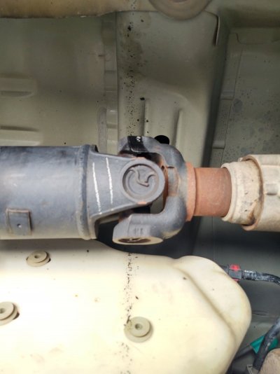

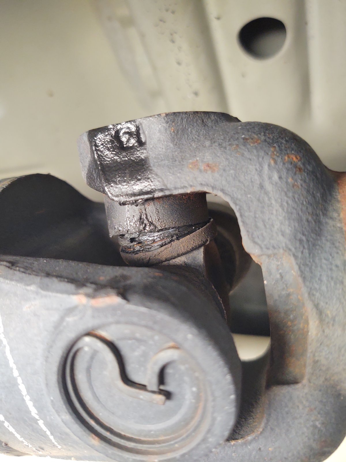

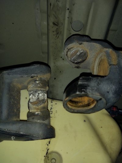

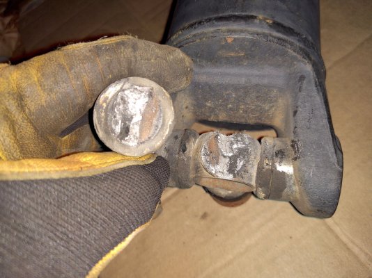

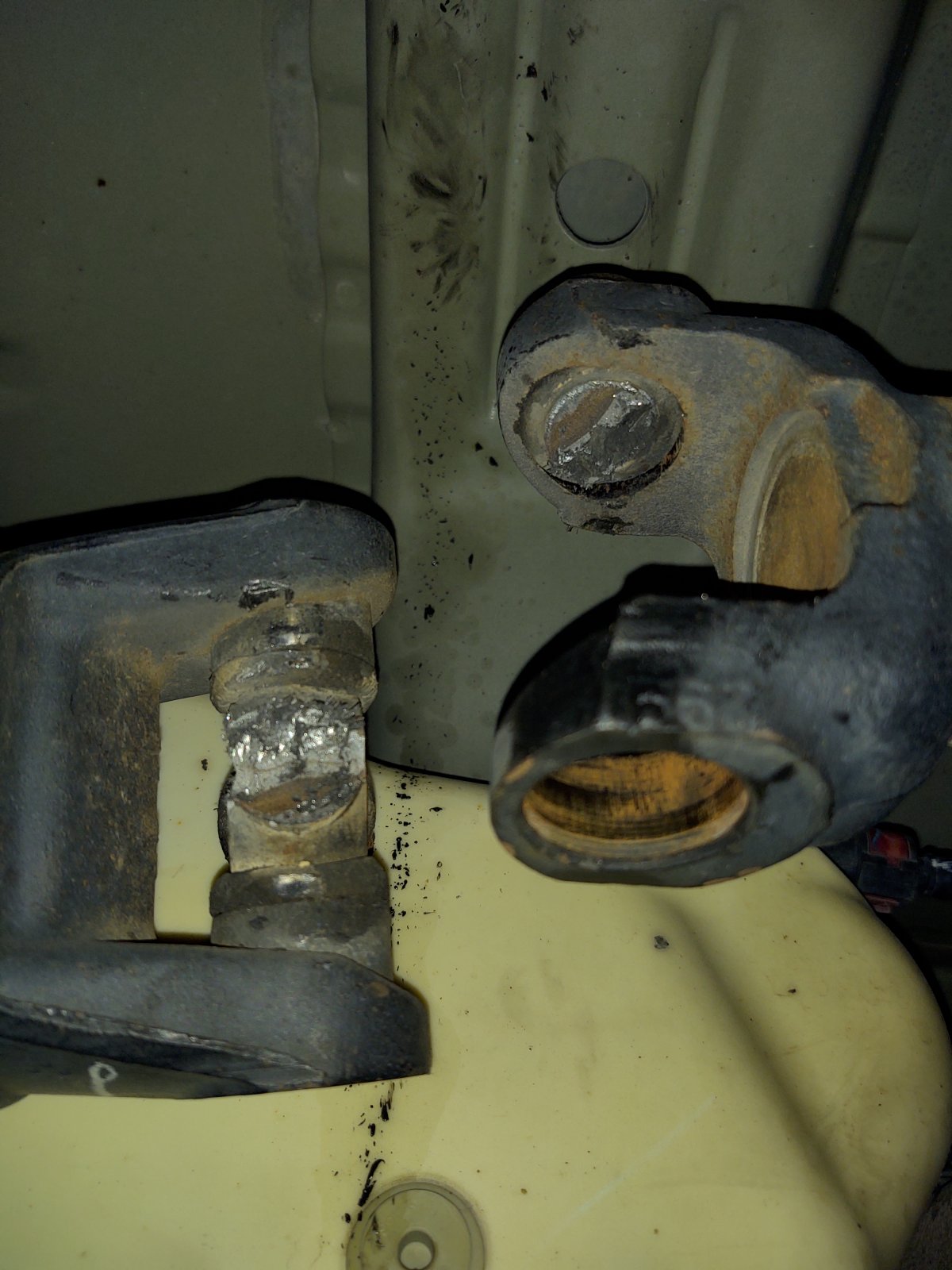

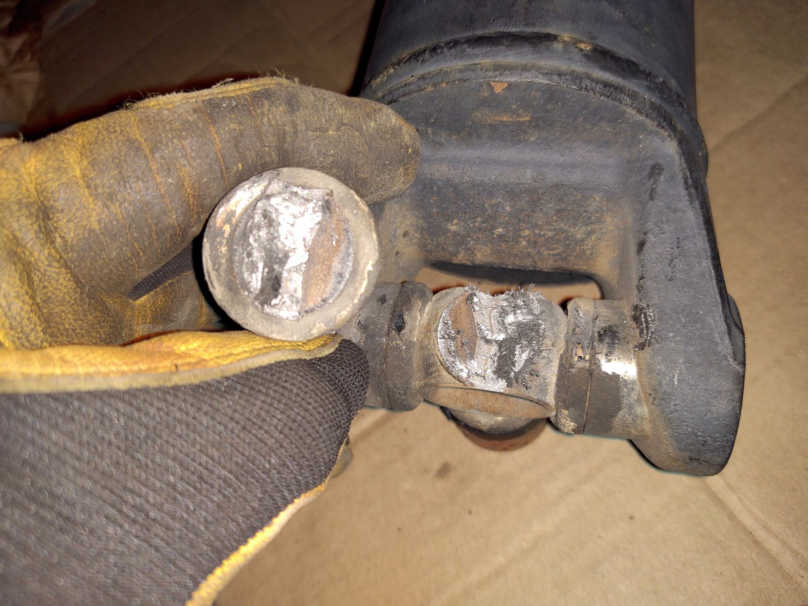

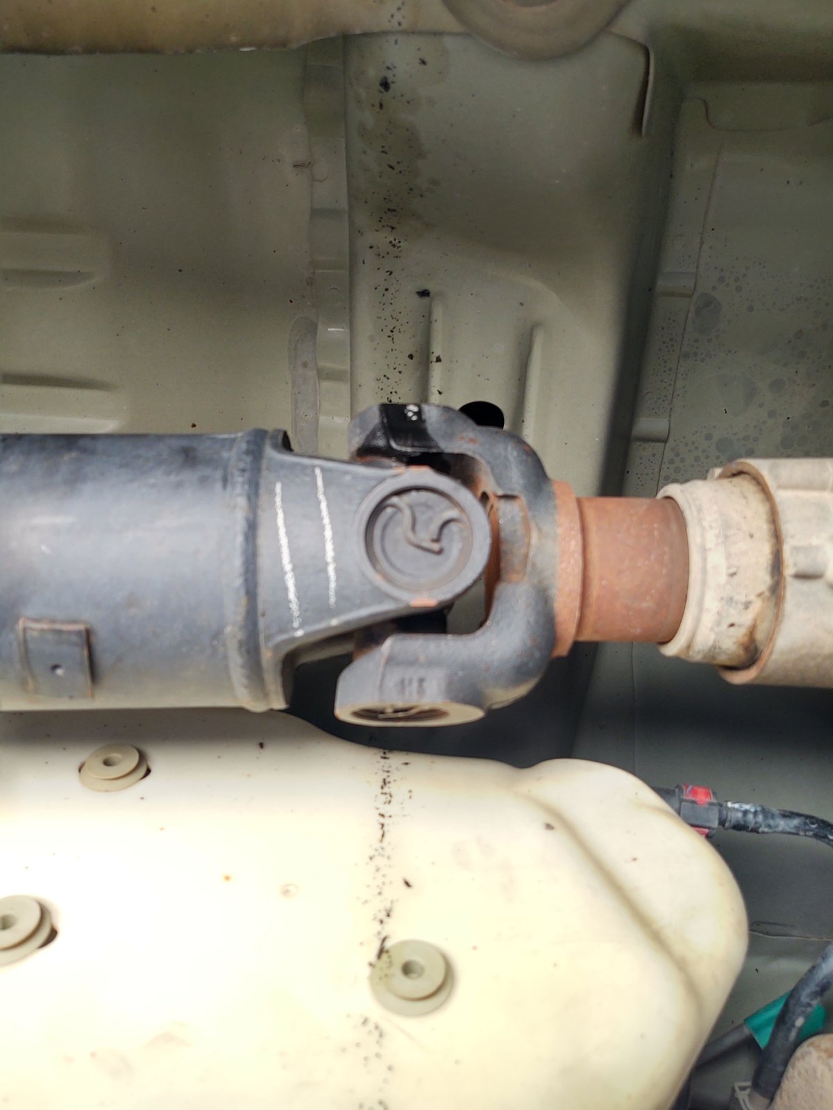

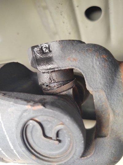

Another fun one.
During the morning commute I started hearing a noise, couldn't tell what is was. On the way home, it got much louder...started diagnosing on the drive. Sure enough, found the original u-joint looking unhappy. Nicely drove to the parts store for a new one and back.
Couldn't get the old one out of the drive shaft. Angle grinder fixed that...judging from the rust where it broke, this joint was cracked for some time.
Missed work today, but she's solid again!

how many miles where on it?

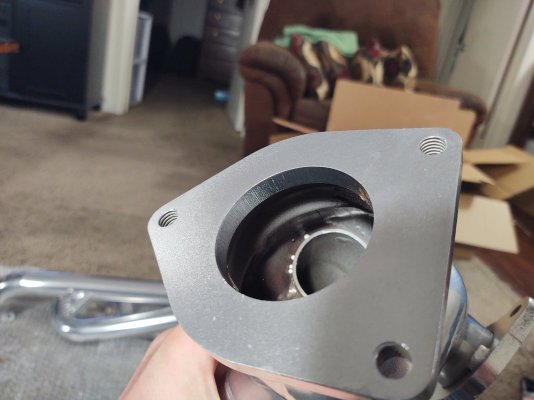

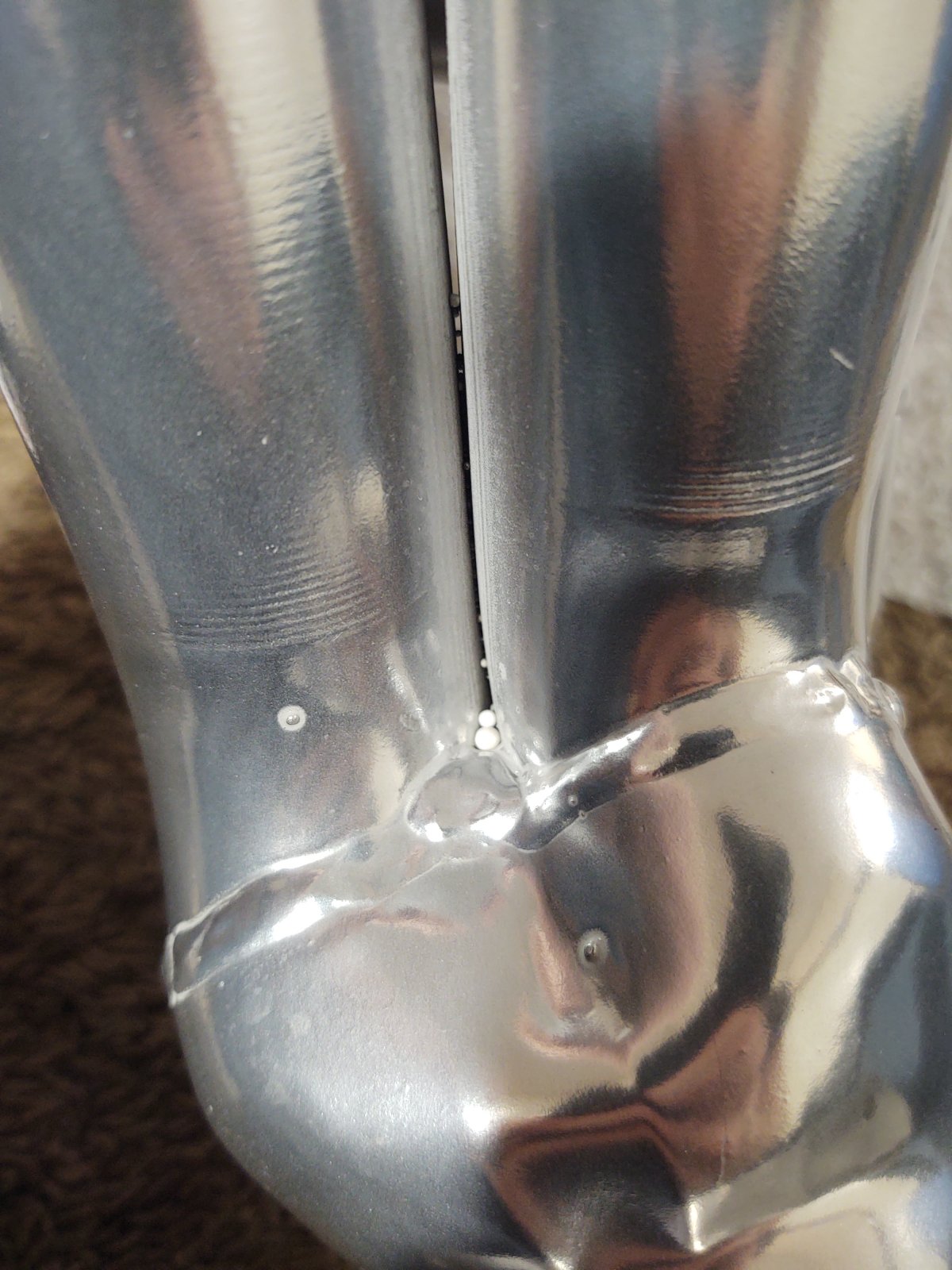

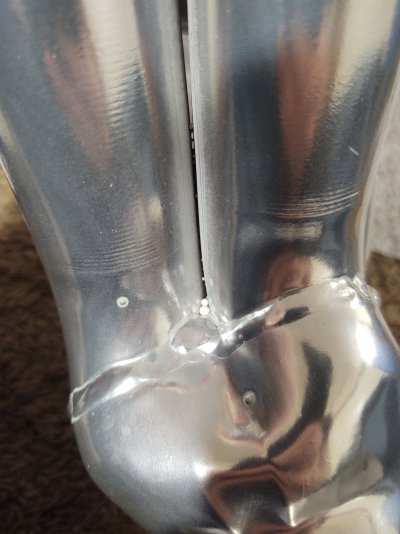

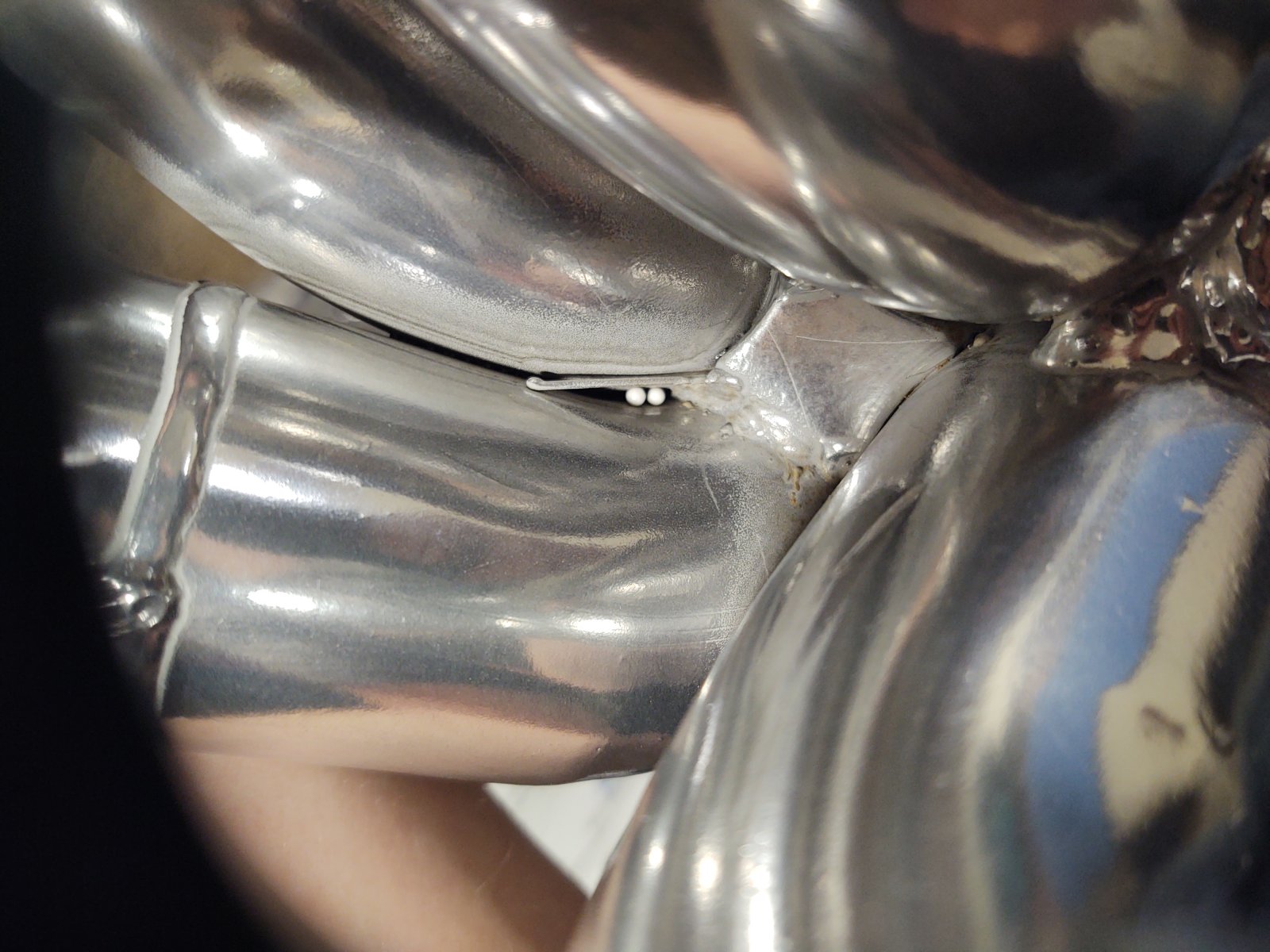

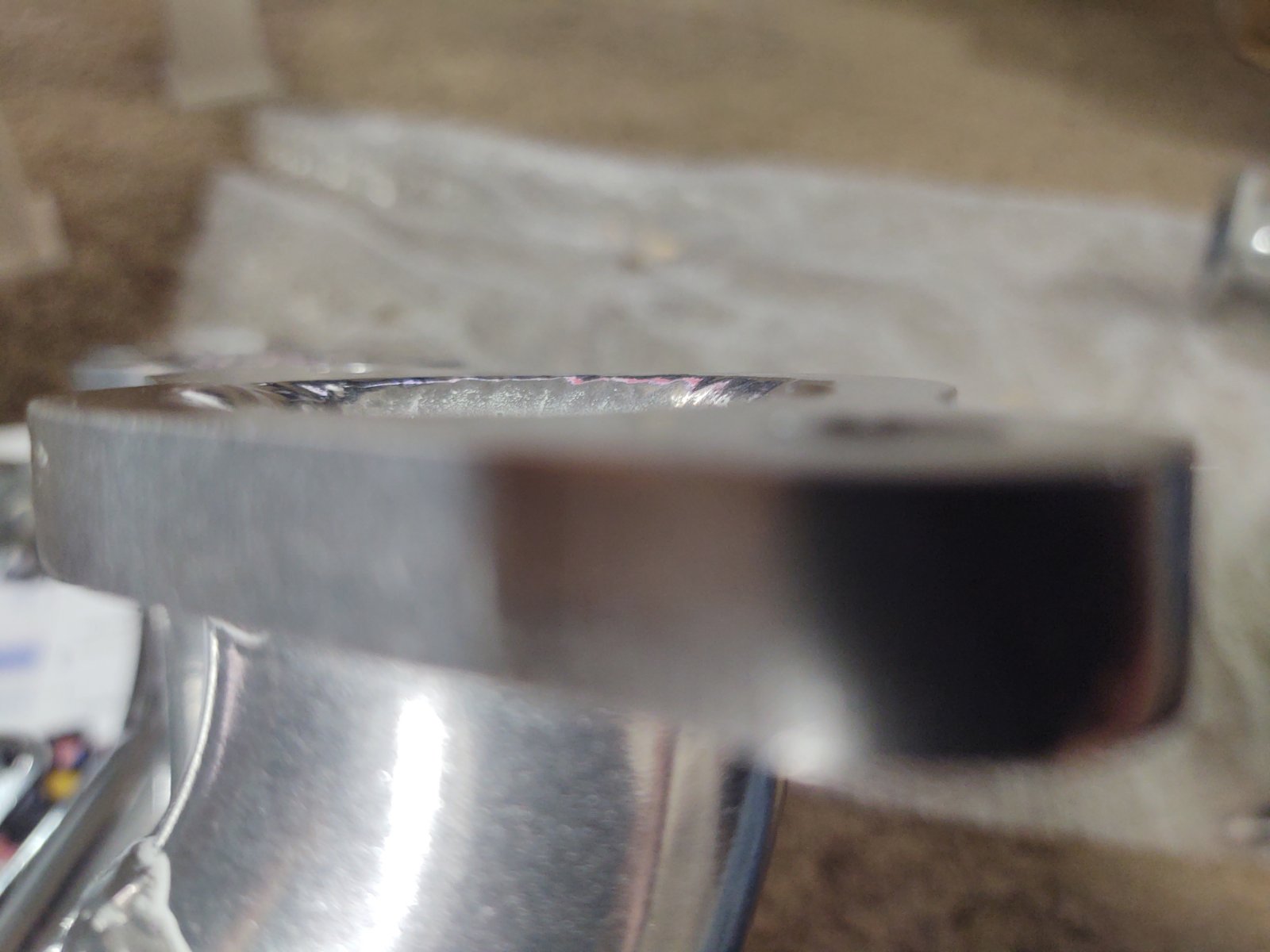

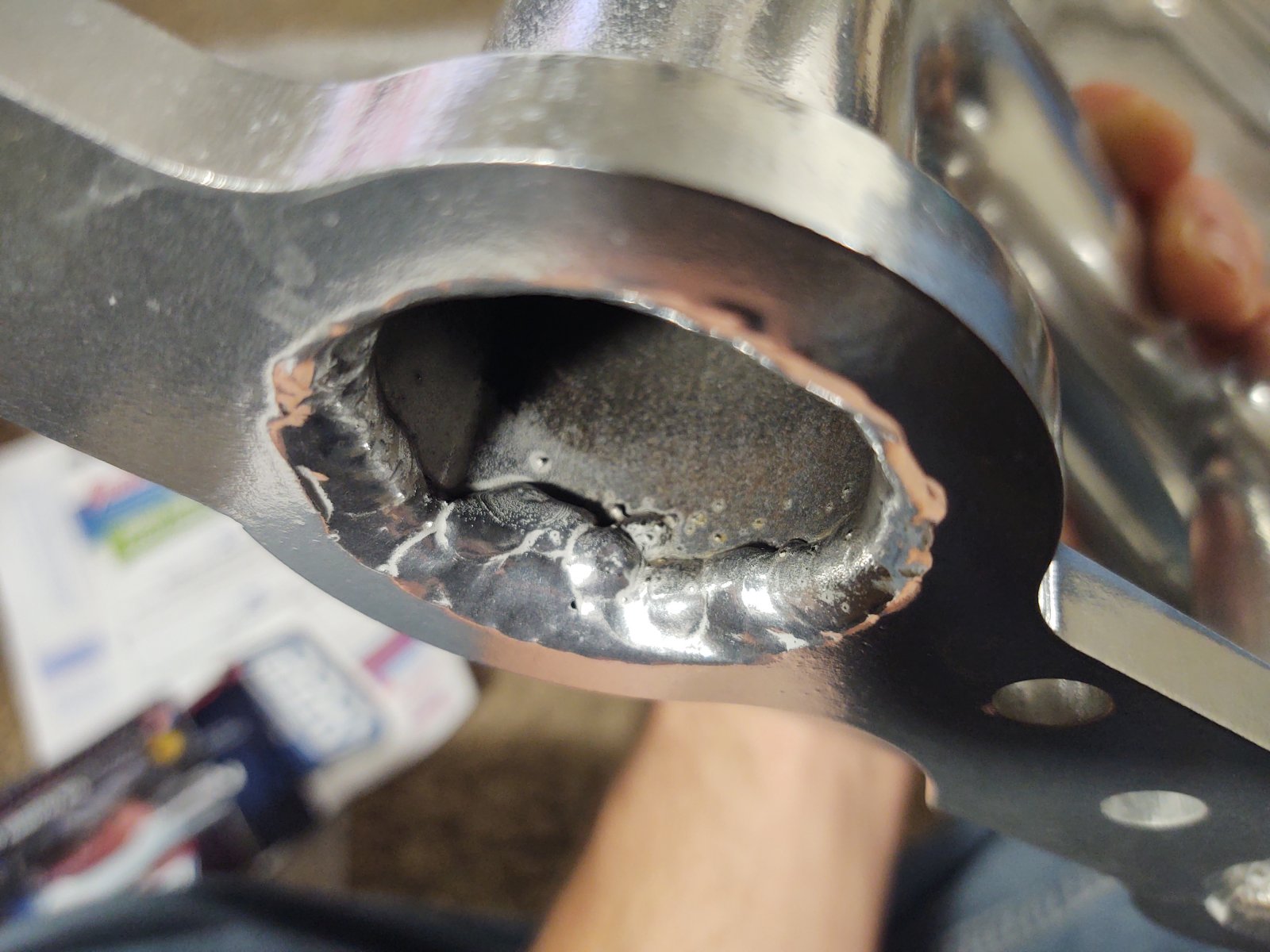

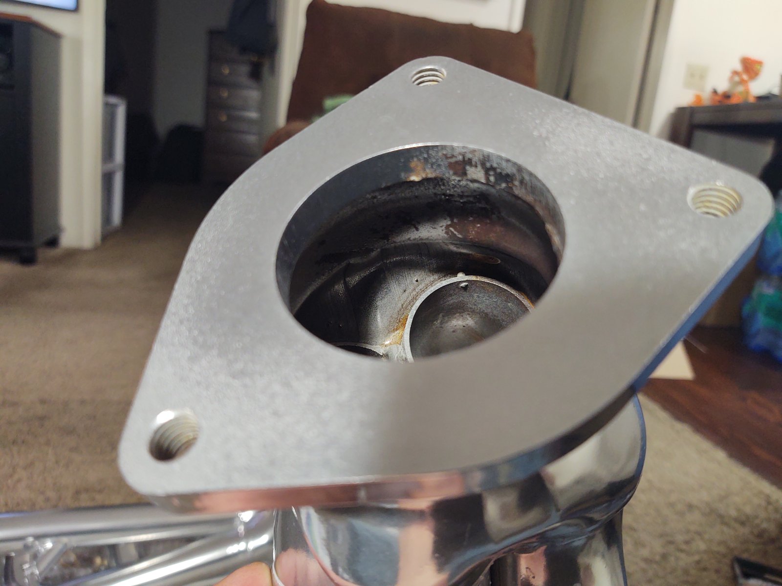

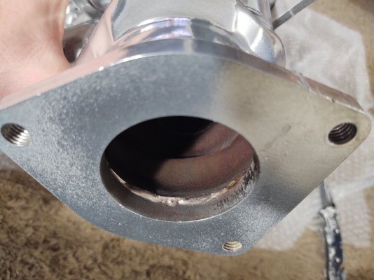

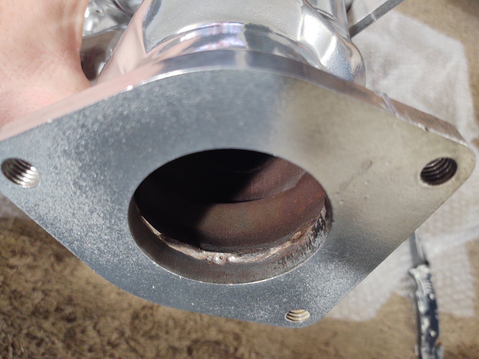

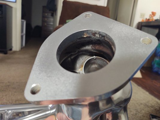

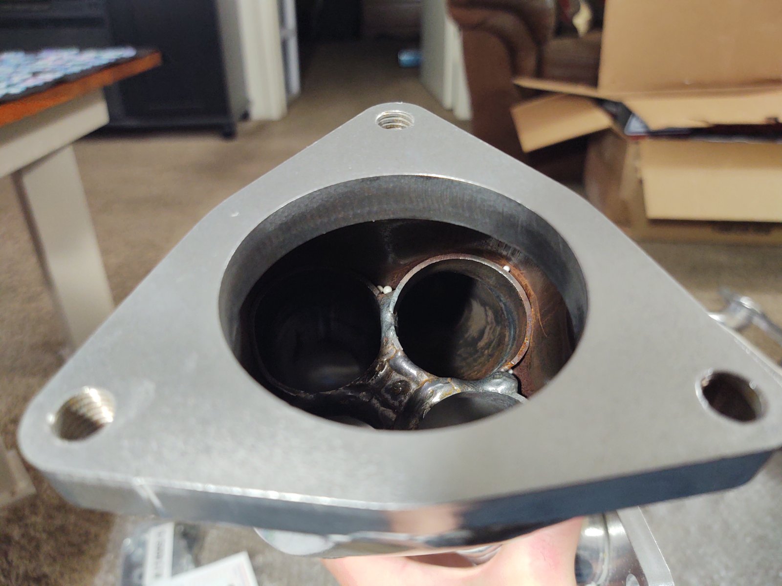

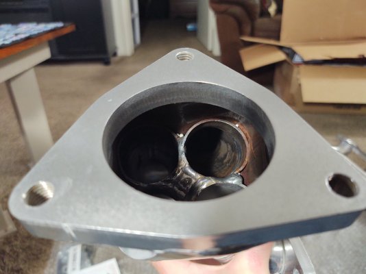

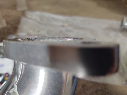

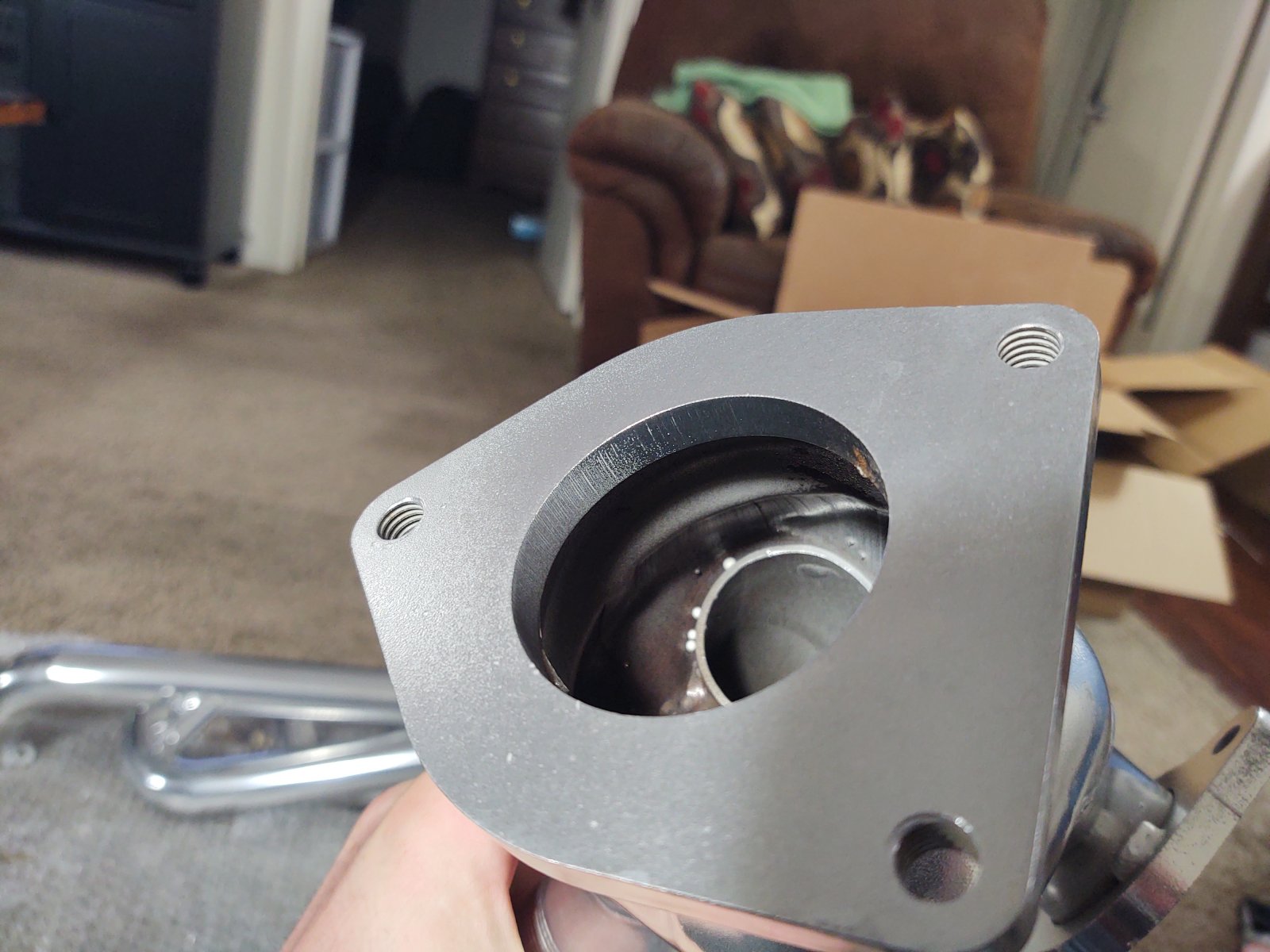

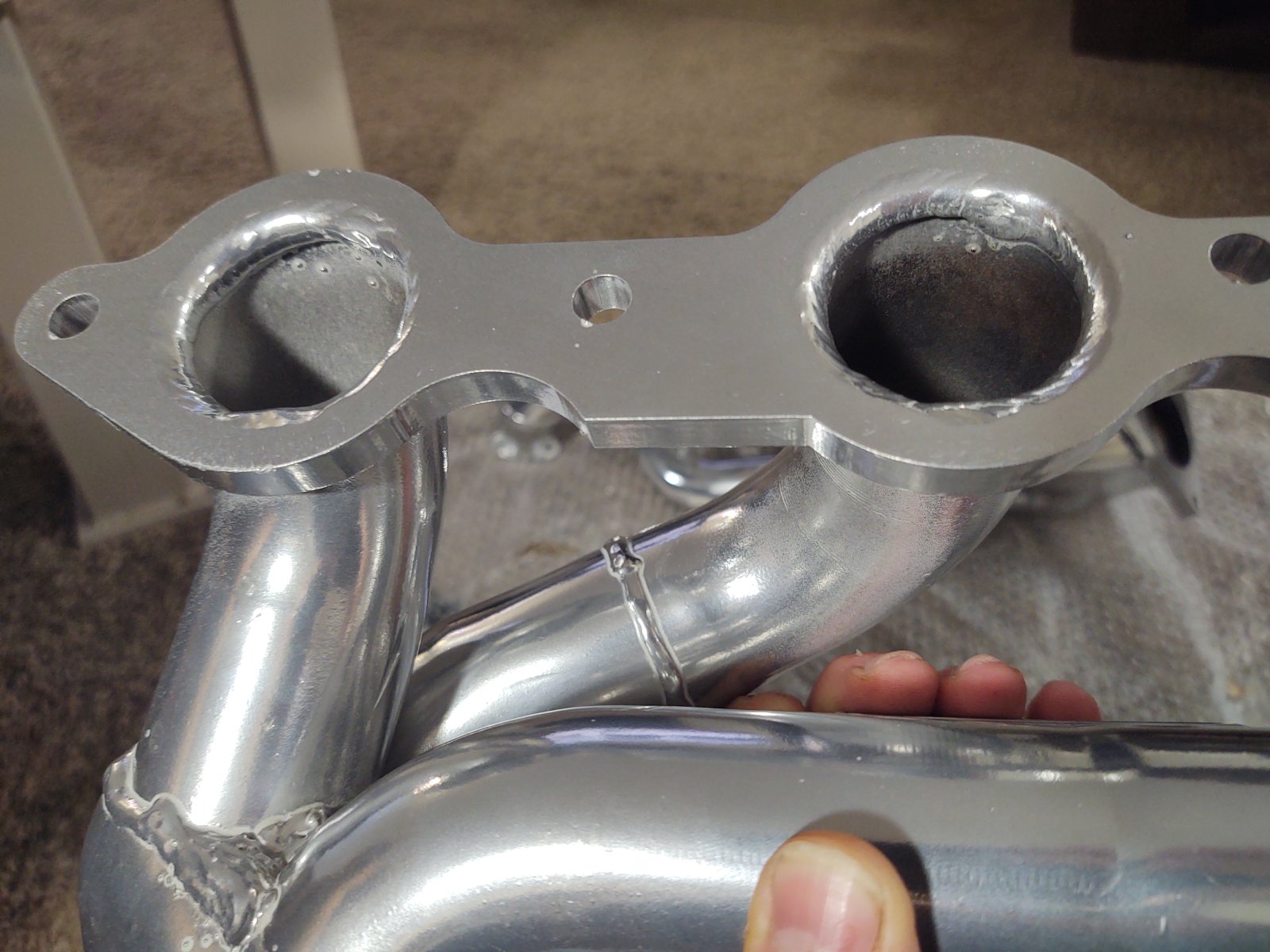

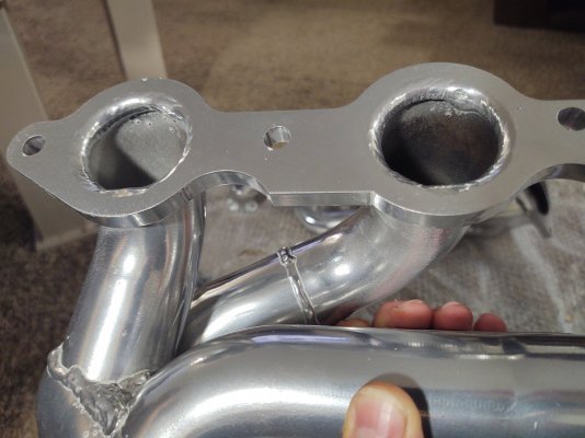

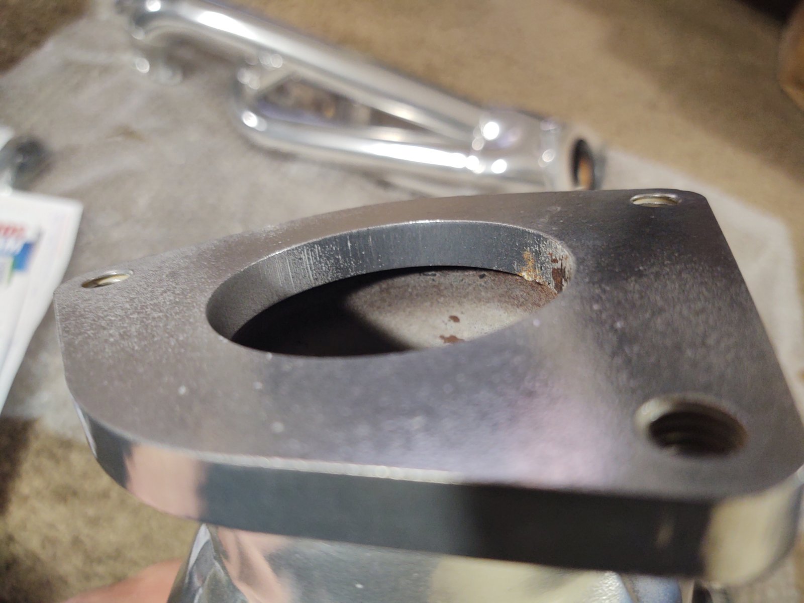

Bought BBK headers...
There's plastic bb's stuck inside and outside of the tubes, welding spatter everywhere including on the mating surfaces. Thick welds inside the tubes, might as well be smaller diameter tubes.
The collectors are anything but a smooth high-flowing transition.
One collector isn't even centered up on the tubes.
There's no ball-joint on the collector flange like the factory manifold or other aftermarket headers.
These were definitely designed for the '99-'06 gmt400, given the 3 egr/air injection ports. They do supply block-off plates for them though.
The threads on the flanges need to be chased to get the ceramic coating out of them.
