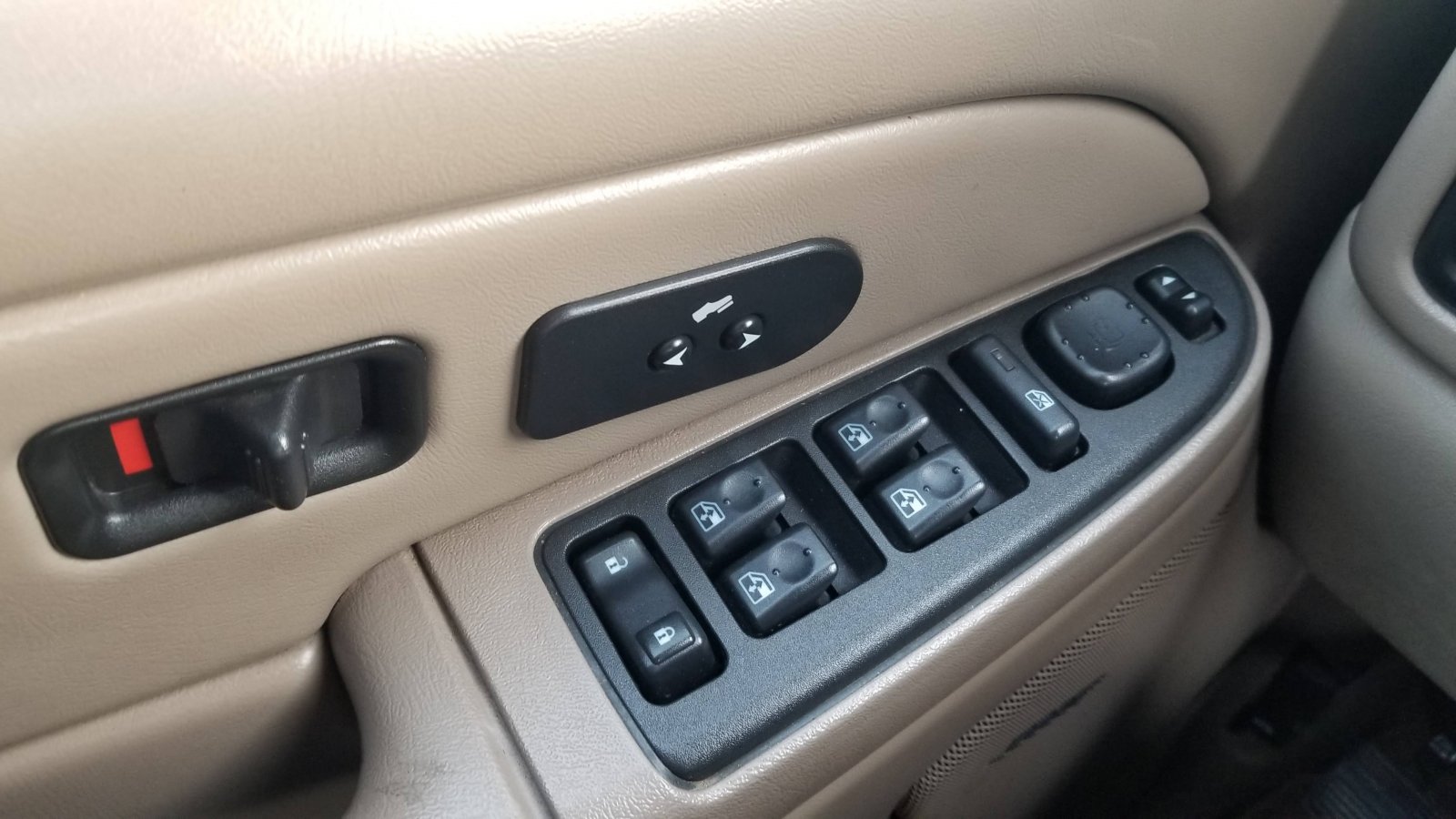

Seats are 6-way power driver, no heat and 100% manual passenger seat with no heat.
I see Driver 1 displaying on the information center, but no buttons to change Driver 1 or Driver 2.
Seemed odd that there are no seat memory buttons anywhere and that with the level of options added, it did not have heated seats... I thought heated seats were standard on the Z71 Tahoe comfort/convenience packages. Maybe not?
Anyone else with 00-06 Tahoe/Yuke Z71 have this configuration?
Are driver settings/seat memory controlled from the info center controls or did I get a unicorn?

You have adjustable pedals. The seat memory buttons and the seat heater switches would be on that door panel if you have them.
The Driver 1 or Driver 2 setting is controlled by whichever remote entry fob you use. The first one to get programmed into the system is Driver 1; the next is Driver 2, and so on.

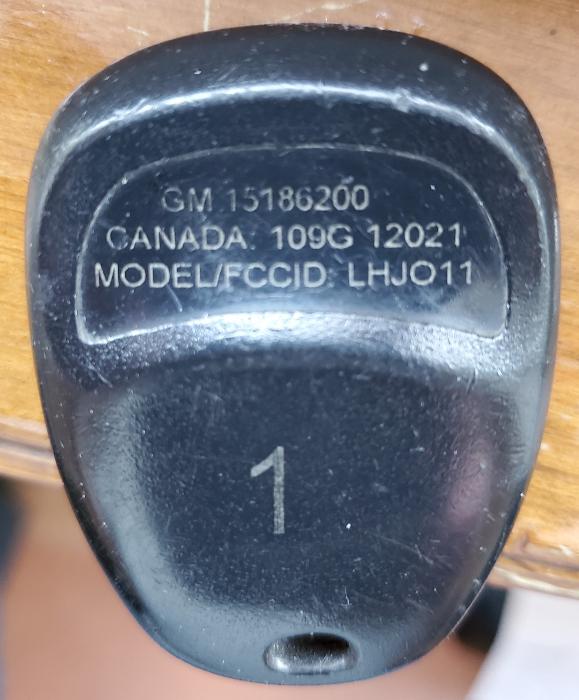

If the FOB you have is OE, it probably has these numbers. Pay attention to them when evaluating aftermarket FOBs for compatibility:

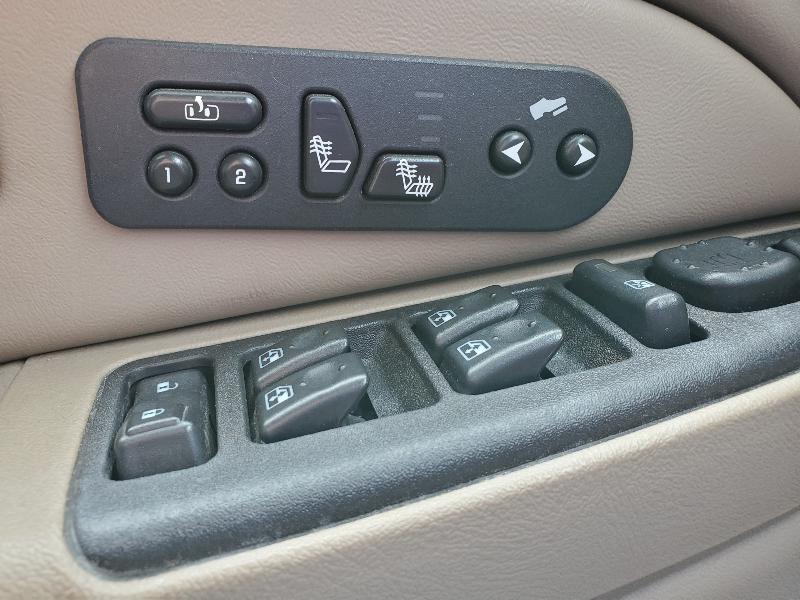

And here's what the driver's door panel switches look like for heated and memory seats:

Thanks! My OE fob does have a big old "1" on the back like the photo. Never knew about the fob and driver settings.
I was familiar with what the door switches looked like for memory/heat/pedals. I couldn't figure out why it showed Driver 1 on the dash, if there was no switches to change anything. I never suspected it was the fobs!
Since I don't have the switches on the door... What exactly will the fob 1 do for driver 1? The seat doesn't automatically slide back when I turn the truck off (exit mode). Is it only customizing the personal trip information (MPG, trip miles, etc.) or will the second remote move the seat to where driver 2 had it set after using fob 2?
