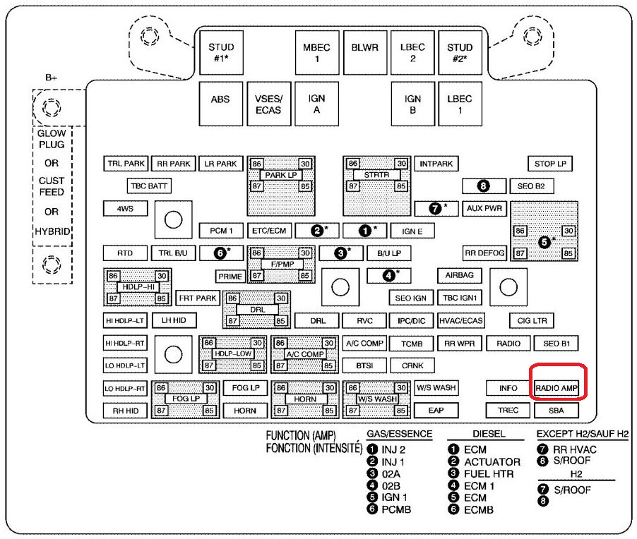

There's a fuse for the amp in the underhood power center:

Thanks for that.
Without being at the truck at the moment to investigate, would you say that fuse is for the radio and amp, or just the amp?
If the latter, then that's probably the culprit.

Well, the fuses were quick and easy to find however they both appear in good shape.
I'll have to get out the multimeter and start troubleshooting.
