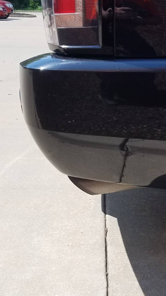

I believe my muffler/resonator/tailpipe is stock, and it almost comes straight out under the bumper. It's slightly angles down and is cut at a 45*
BTW, that's not a crack in the side of the bumper cover, just a reflection of the seam in the concrete and curb.

With that V8 engine a little more sound is a good thing I think. If I were doing this to our machine I'd look for twin side by side stainless steel tips mostly straight out the rear. Not sure the straight out deal would work without having the cutout on the bumper panel though. Looked for pictures but didn't see anything relevant.

I was behind one today and noticed that. I'd have the pipe up higher and angled more downward so the angle of the slash cut matches the bumper cover. Maybe have no more than about half an inch of reveal.
