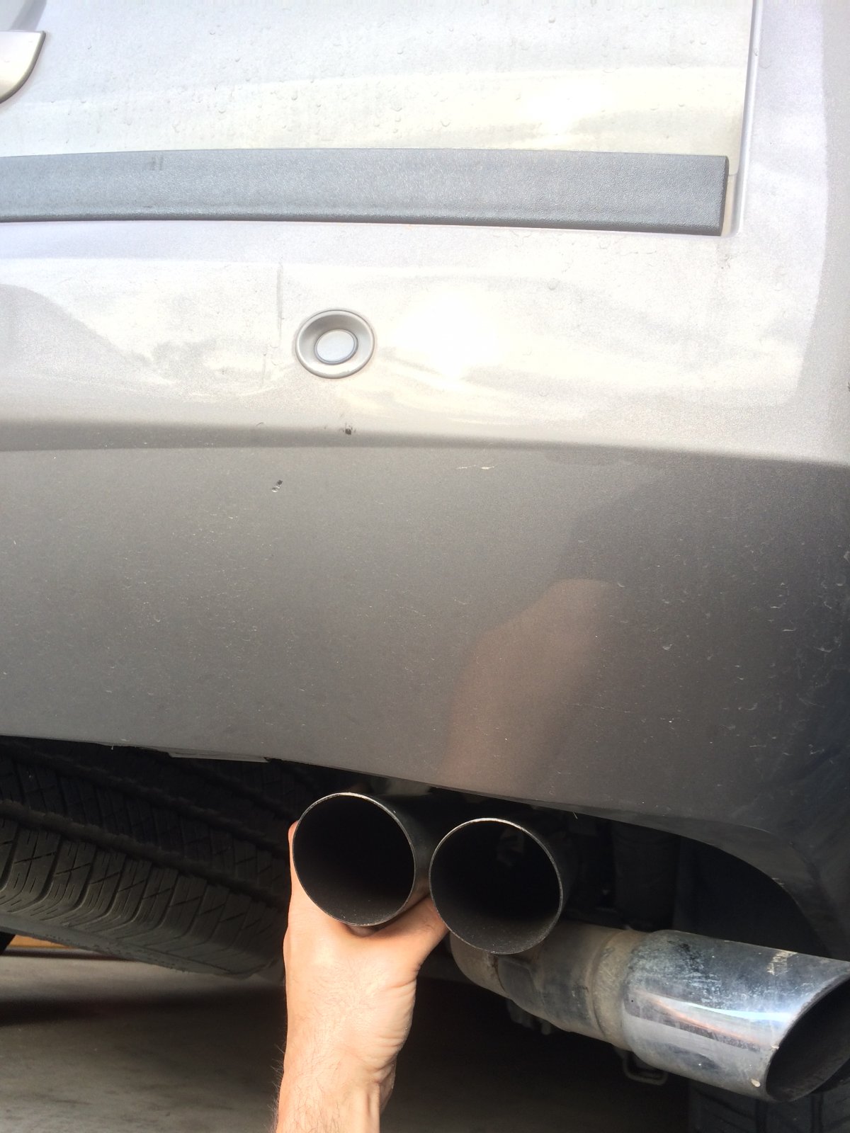

I was behind one today and noticed that. I'd have the pipe up higher and angled more downward so the angle of the slash cut matches the bumper cover. Maybe have no more than about half an inch of reveal.
I don't think this is possible... I remember there being a lot of issues with routing pipe except for a semi-stock location.
It looks fairly easily doable to me. Maybe we're not picturing the same idea.

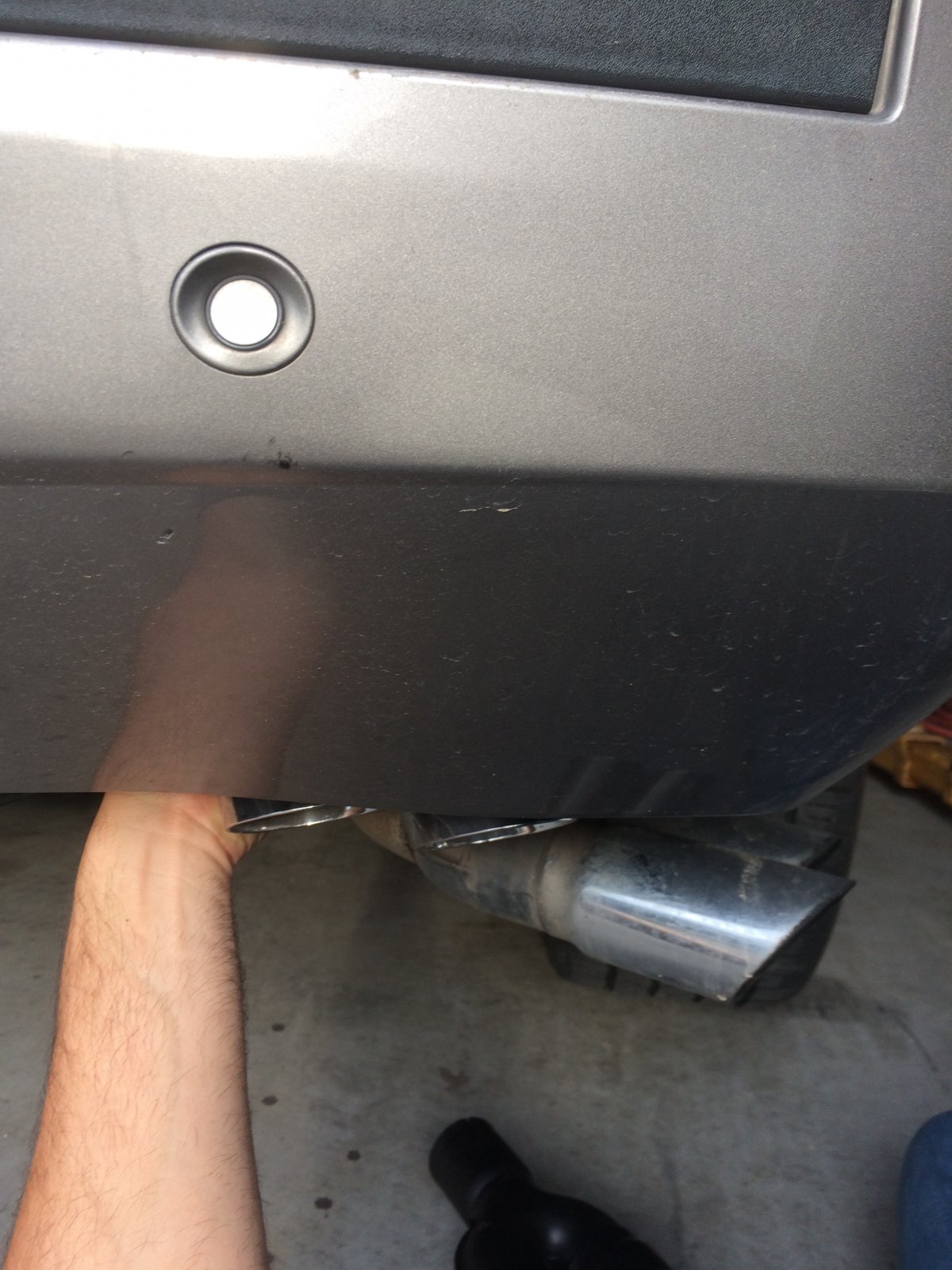

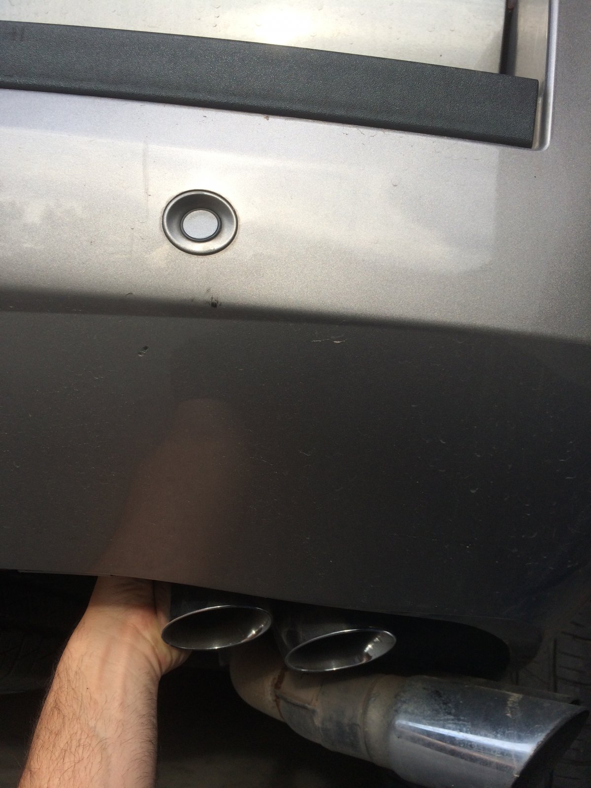

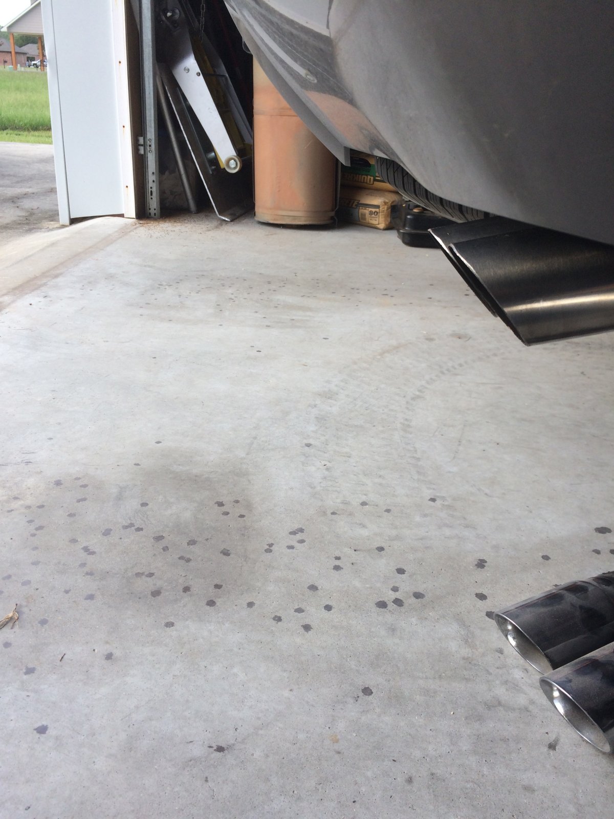

I grabbed a couple spare dual exit tips and tried a few quick ideas. This is what I was trying to describe, except maybe with tips that are even (these are staggered for straight out fitment on the driver's side of a G8) :
It'd be for someone that wanted minimal pipe visible but not a total turn-down under the body to cause that reverberation resonance, but what pipe was visible would be clean and simple:
I have a straight and even-tipped dual exit that I tried going straight out the back with the slash-cut tips following the bumper cover:
I like my side-swept exits, but they look a little funky from certain side angles and the exhaust pipe is visible from the back. I'm thinking of switching it up to duals straight out the back. I'll probably modify the G8 tips for this because they're a little bigger outside diameter and have rolled edges. These plain stainless ones just look like regular cut exhaust tubing.

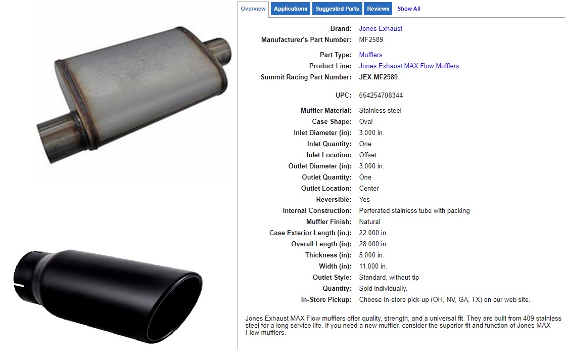

I had a Jones performance muffler on the Burb before I changed everything up when I did the headers... different model and style though...
I had the JFP300...
http://jonesexhaust.com/Product/Jon...ow--Pack/cad21912-aae9-4680-b099-b1719f453144

That muffler a knock off of something?
I was thinking the same when I saw the part number. I have AP Exhaust's clone of the Magnaflow 12259, which is one step more aggressive than the popular 12589. AP's part number for their 12589 clone is XS2589. HERE: https://www.amazon.com/AP-Exhaust-Products-XS2589-Muffler/dp/B004A5OBWE. I wouldn't be surprised if this style of muffler from AP and Jones were from the same factory.
@Jolly Roger , you have a link for that black exhaust tip?
Dannnng...wish I would have seen that on Amazon before buying the Jones...
I spent a few bucks more on the Jones. What makes the AP more aggressive? The Jones, AP and Magnaflow have the exact same measurements.
