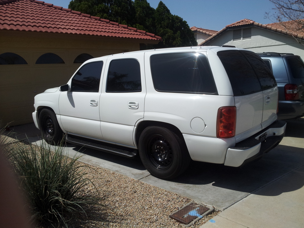

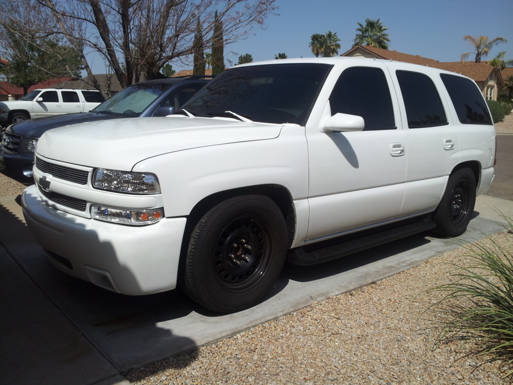

:boxing: :boxed:... I just got home from work so here's a ****** pic, lmao
SS front bumper, Denali rear bumper. Back to black running boards - Jonas -YOU'RE MY BOY BLUE.
And yes, i'm running 18" steelies right now. Can never keep my mind right n gotta flip the script. Still got my 22" custom Intro Billets tho :hat:
All new front end, hood, bumper, grill, fenders headlights ect ect...., thanks to some bit@h pulling out in front of the wife. SO close to totally out. Thank goodness for insurance add ons :happy107:

I'm liking the stealth "state patrol" look. :thumbup:
